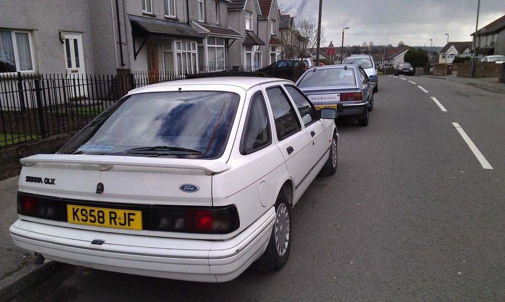

Thanks-these are the photos that the seller put up-I’ll have to take more as the interior is a lot better now and the front valance has been painted. The engine bay has been tidied and it is now running on the original alloys.
The only recent photo I have is it hiding behind my Sierra. Will take a few more.
