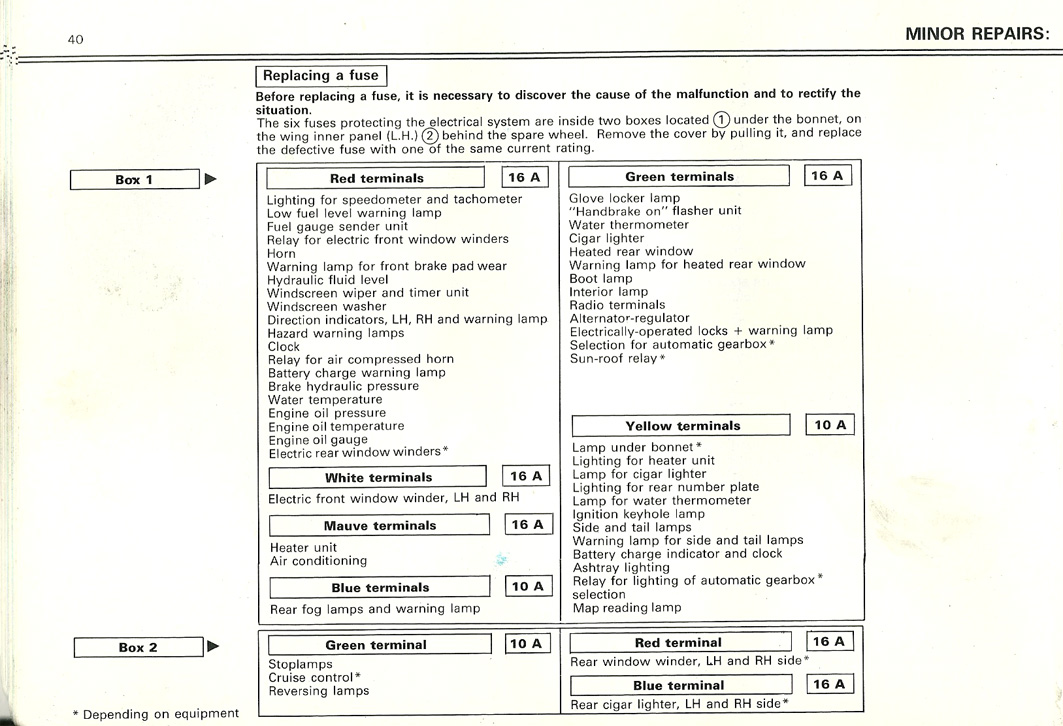

Mine is a 1985 car and this is the fuse page from the owners hand book, heater seems to be in fuse box one.
