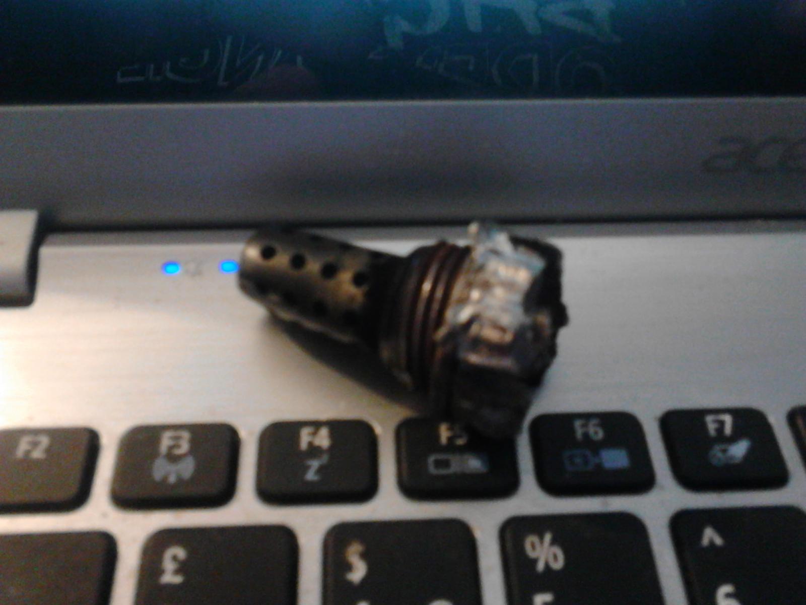

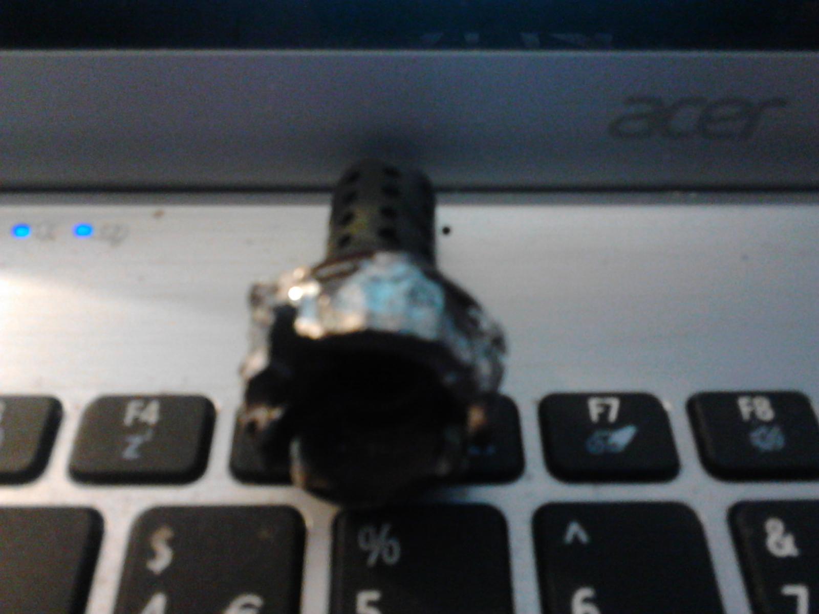

well sorted out the o2 sensor had to remove front exhaust pipe,then grind the hell out of the old sensor,than hammered on 20mm spanner lidls finest no less 7.99 for 20,the exhaust still blowing in middle,waiting on new seal £1.50,fitted a universal four wire sensor £13.00 eml light now going of welding done on one now found bit more!!done abit today,need to keep mobile,hope to finish next week,see picture,s another one saved from scrappers,....bought a cheap interior car radio ariel £1.31 from amazon,just waiting for new cheapie radio from ebay £10..

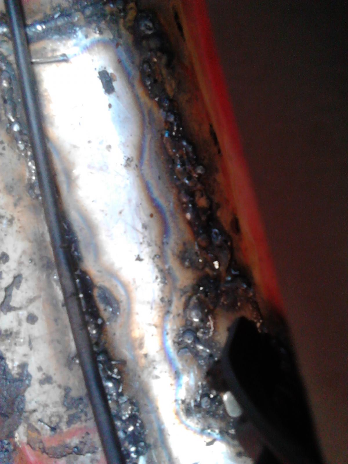

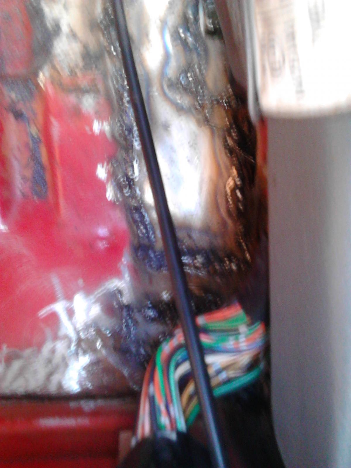

well finished off the welding today,big ish plate from under floor to outer sil :-D l,rear floor inside put another plate,another plate next to seatblt area,another smallish plate on lower sill to floor area,the exhaust seal turned up,dropped middle exhaust,put in new seal,fitted cheap radio,no smoke so working fine,hope to underseal soon,..eurocarparts now open sundays,bought dist cap,rotor arm,they look a bit past it,change tomorrow..will post pictures mon..

just check everywhere,they are like a tetley tea bag :-D ,just finished the last of mine of just finished the last bit off with fluorescent tube metal,needs must ran out,got good weld to floor to inner sill area,will get picture up tommorrow,before coat in red primer,underneath just needs undersealant...stripped of timing belt cover original one on,now fitted gates one,saves the engine,....
all welding finished,sprayed underseal,everywhere,still has original road springs,just loose rust on them sprayed them.and all brake pipes,fuel pipes,front crossmemeber under radiator,,,oil soonish,home bargains semi syth 8.00, finest..sump was looking like surface rust,sprayed that well,
