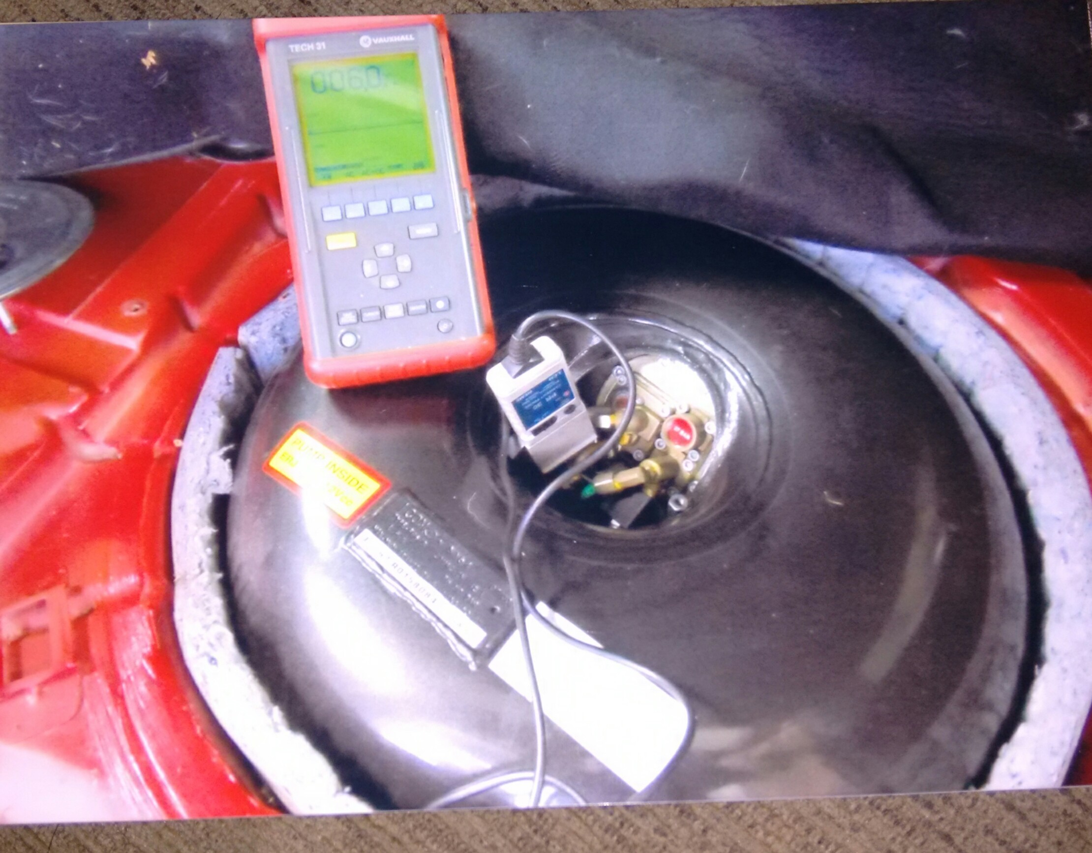

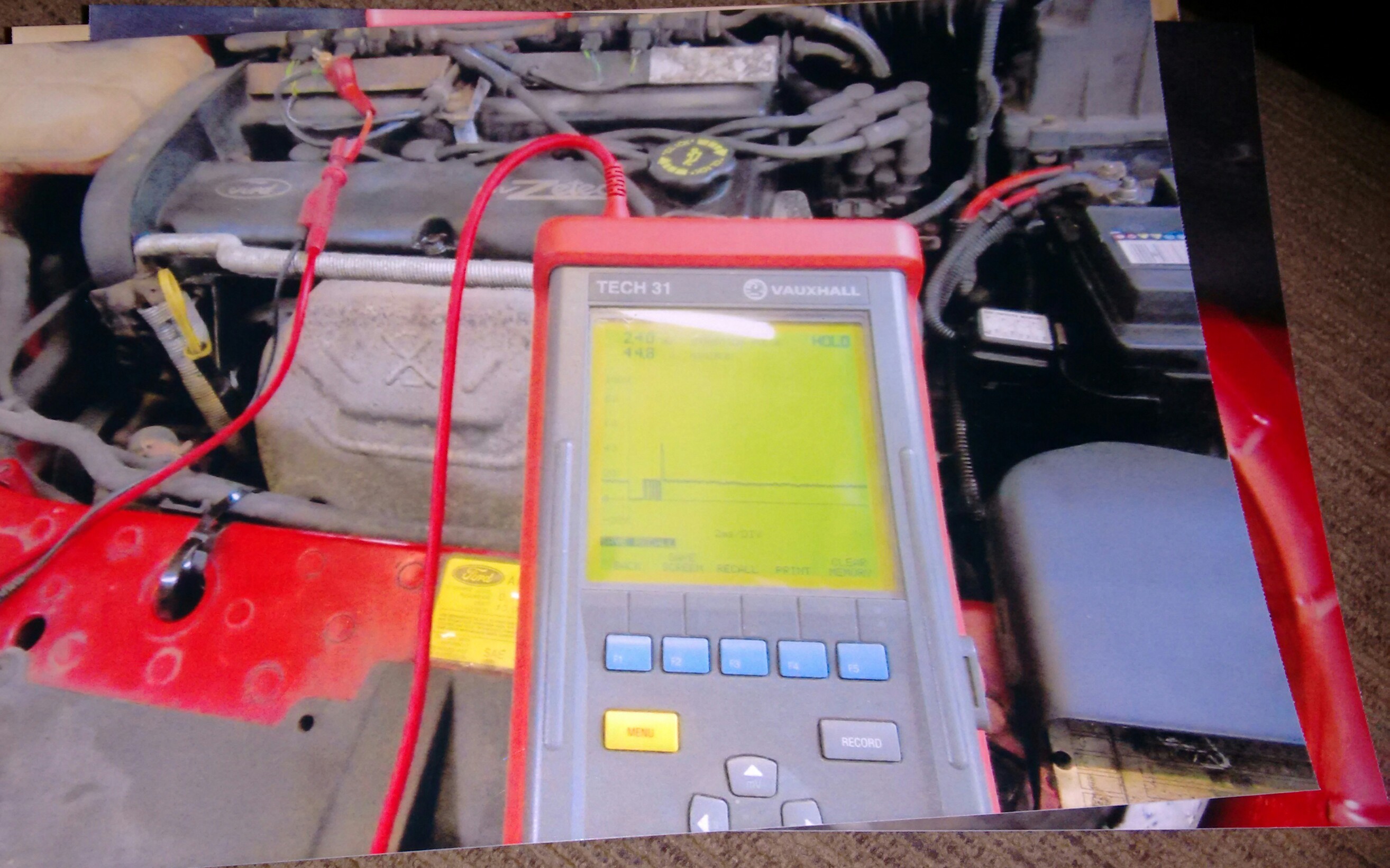

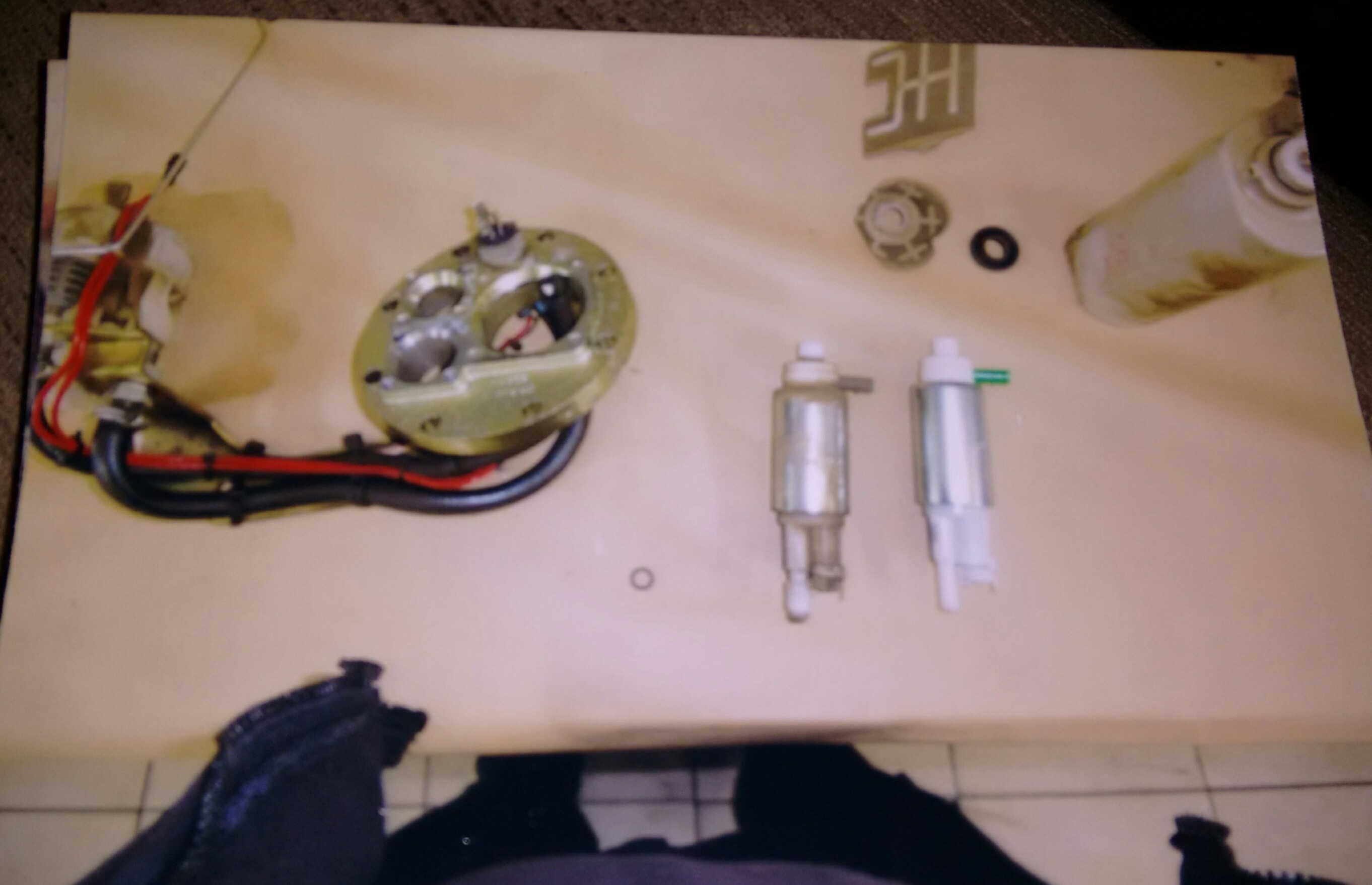

Not sure if anyone is interested but focus is back and fixed. Cost the same as I paid for the car!
So it was the pump. The garage did full diagnostic and service which showed it was not supplying the right pressure.
They replaced the pump and also found out why they think it has failed. There is an issue with the fuel gauge where it won't go to into the red section. Even when empty it still shows a green.
This wouldn't be a mega issue except when the gas pressure drops to empty it automatically switches over to petrol. The ecu then kills the gas pump but only if the gauge is showing red. So it leaves the pump continually running killing it quickly.
Can't recommend the place enough. They took pics of the diagnostic and replacement so you knew what had happened. Took the time to explain the faults and show me what to do if I run out of gas. Also serviced the system whilst they were there.
