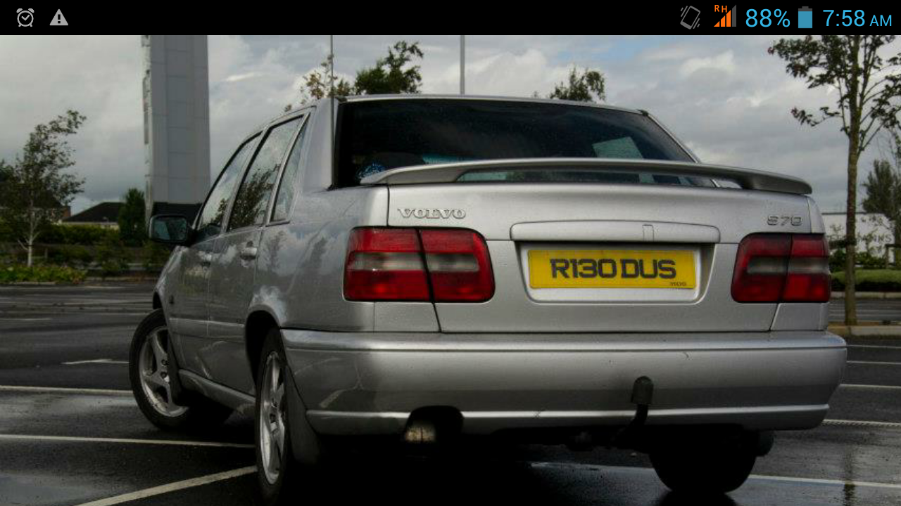

My first Volvo was an R reg S70 TDI manual. Had it for 8 months and 20k miles, which in Northern Ireland means I was practically living in it. Never saw below 45mpg on the (accurate) computer, one time.when I brimmed it and tickled it the 50 miles home it showed 60mpg but that took some work! Could easily achieve 50 on a run though.
As said the headlights do fade but new Chinese replacements are available which my R reg V70R has fitted and they're alright! If you wanted to spend nearer £300 you can buy projector lights from similar sources but they look gash.
Most TDIs are smoky, people blame the pump timing but I think at this age especially its just a part of theircharacter. After a 50mph cruise up the Moira line on my commute every morning it would leave a proper cloud across Nutts Corner, I found it funny, others didn't. Mine also sounded (at idle) like it was about to die at any moment. They have a ticking noise at idle, pump the brake pedal and if it disappears its the plastic cam follower on the vacuum pump. Cheap parts but a big job to do so nobody ever bothers, never going to cause any big issues by being left to tick.

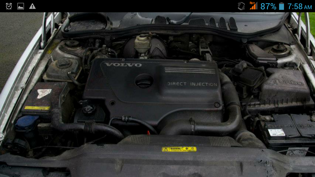

For some reason the Volvo applications with this engine are listed as "2 tank" and VW/Audi applications as "1 tank" conversions by Biomotors/Elsbett, I think it's an error, these are quite similar to the 4-pot TDi that is quite happy chugging away on veg oil, they have a dish in the piston that acts like a pre-combustion chamber in an IDI diesel, so engine oil contamination is minimised.
I've advanced the timing by 1.5 degrees, removed the thermostat for the fuel heater valve (so warm fuel returned from the IP is circulating in the fuel filter all the time), and I unplug the coolant temperature sensor on the cylinder head to trick the glow plugs into running for 30 seconds (I'd like a more elegant solution to this!).
It could do with a larger bore fuel pipe to the tank, new glow plugs, new injector nozzles... I'LL MAKE IT WORK!

They're superb on veg, but mine didn't appreciate starting at winter temperatures on the stuff, even with good plugs and long glows. Could have been the spray pattern (270k) or pump timing or lack of compression (not that I think there was) - but they're very intolerant of out timing which is a micron out.
So I added an engine preheater (240v) as well as the fuel preheater, then added an extra fuel supply line from the tank, and then it went like stink on 90% veg. I realised it supped the fuel very gently most of the time, but when you gave it the beenz, it drank like a fish, so one titchy 10mm supply line wasn't enuf.
Running high veg% on DI engines is ok provided they're asked to work hardish fairly often - that's the danger with 140hp and 200+lb.ft, they're barely trying on many of England's congested little roads.
