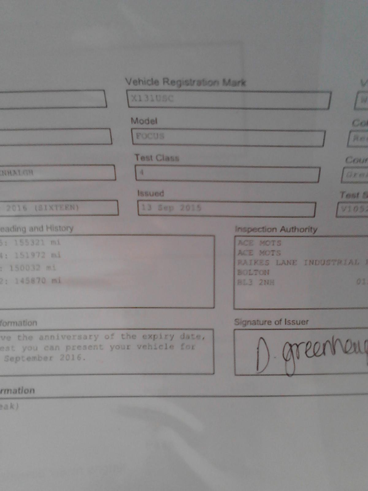

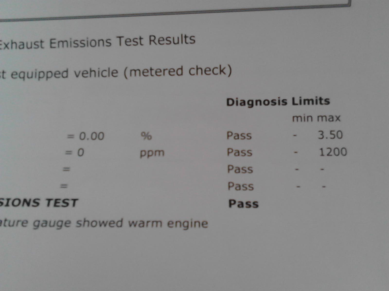

well drove the focus in for its mot,made sure it was on lpg emissions fine,not much to mot certicate now,one advise oil leak,no welded needed,he said brakes are good for old car,will tackle the timing belt tommorrow,not been changed now on 155000 miles,so it needs one got gates one with tensioners,£32.00,have had spare key done chipped £40.

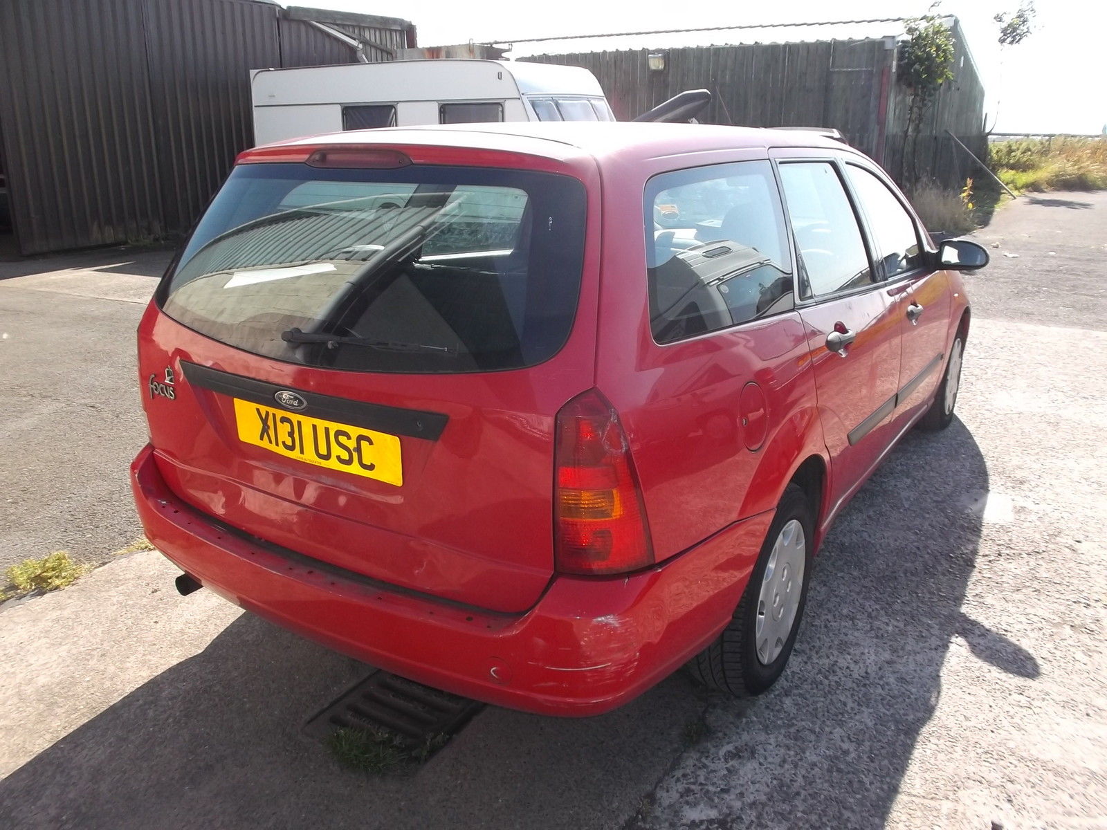

well all is done,new thermostast housing turned up yesterday,postman must have had a lie in,turned up at 5pm,...well gone as far as i need to,will be up for sale soon,£499,cheap factory fitted lpg runabout,still needs clean,but better than it was ,,,,,still using every day... :-D8)
may be keeping it yet,just testing the water,have got s/hand rear light coming soon,will fit that,i soon get bored of later stuff, :mrgreen:
