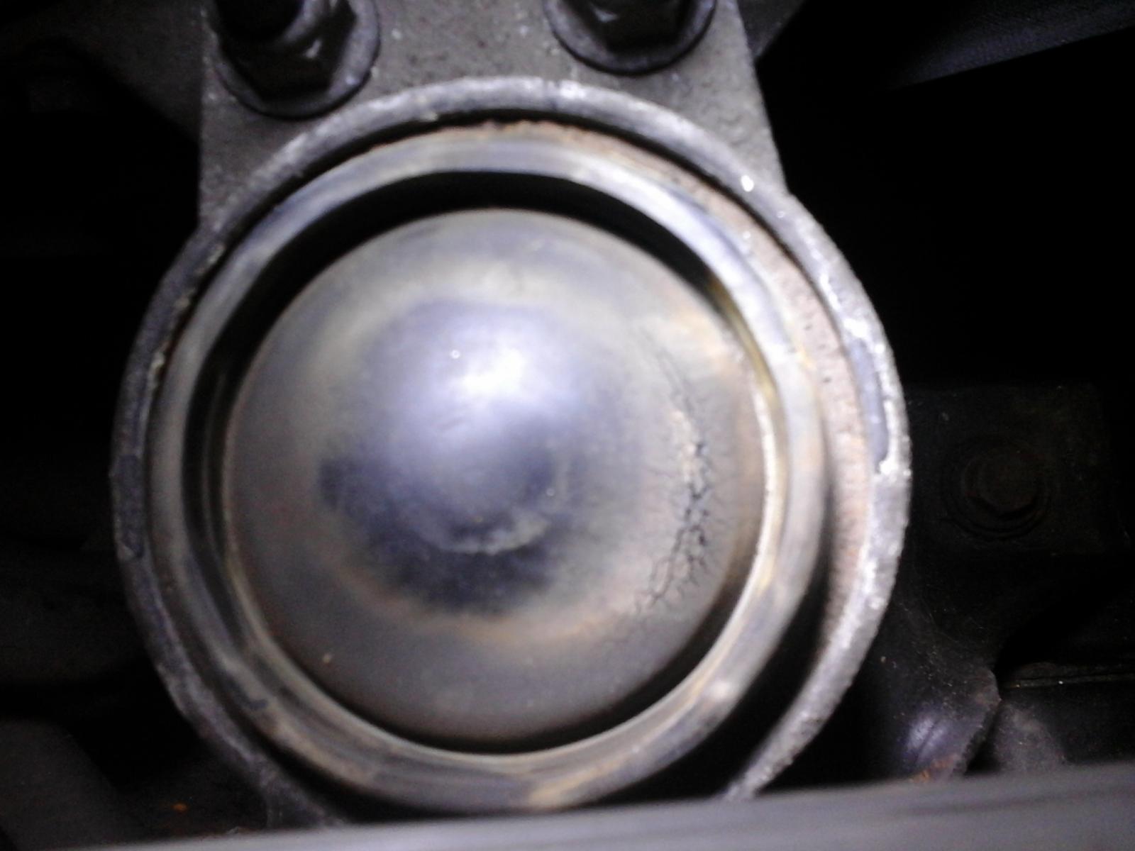

I have a knocking from the drivers side, ive ruled out the suspension as theres no play in any of the bushes nor the track rod end. It knocks when you turn sharply and over undulations. Ive had a look at the engine mount, its the hydro bearing type, the top of the mount diaphragm is perished but i can still feel some grease inside. Could this be my trouble?

Ive looked at the d bushes, no perishing or movement in them, which is a good thing as you have to drop the sub slightly to swap them. Ive a picture of the engine mount...as you can see the diaphragm that holds the grease is perished. Dont know if this means its fucked or what, ive tried rocking the engine but its not moving excessively, though im hardly a heavy weight...

With the picture of the perished diaphragm above am I barking up the wrong tree?
