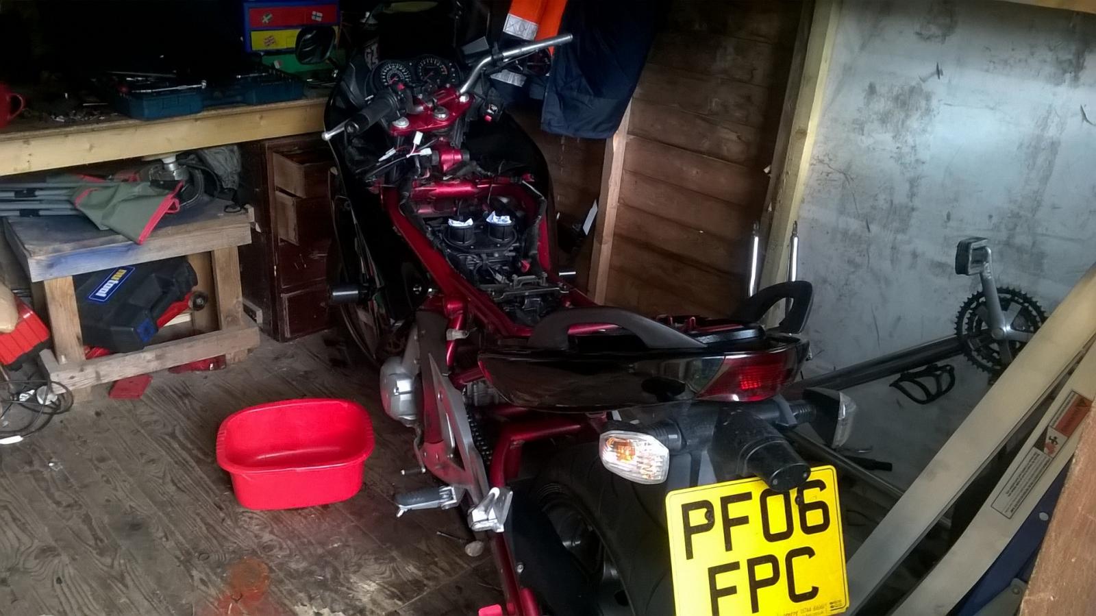

Being between jobs for a week I agreed to give a mate of a mates Bike a good going over- a tidy looking Kawasaki ER6-F, one of the first on an 06.It's done just over 20 thousand, and has never been touched by anyone except a proper bike shop. Looks like they did absolutely feck all. I assembled all the service stuff, stripped off the fairings and got to work. The push fit stick coils wouldn't come out with a pull, nor with a screwdriver, nor with a pair of Vise grips, and even a 4 ft lever. I ended up having to take the rocker cover off with the coils in place, break them up in place and hammer them out.....The metal sleeve had corroded,swelled and welded itself to the alloy rocker cover. Once out I found someone had had a go before, gave up and siliconed up the crack they'd left. Fork oil was black and stinking, plenty of seized bolts,rusty pads... just a mess.
