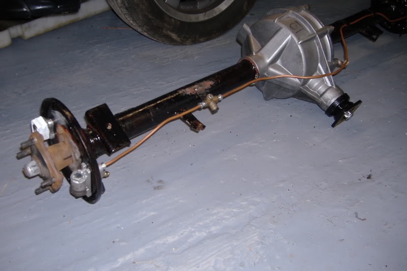

oldcars Posted August 24, 2016 Author Posted August 24, 2016 Greased and cleaned up the hand brake linkage and its helped a bit but one drum still seems to bind a bit.Want to take the drum off to have a look inside, do i have to take off the bolt in the middle of the hub? Looks like the whole hub will come off if i do. Rear drums on the Kia has two screws and the front come off easily this looks different.
Asimo Posted August 24, 2016 Posted August 24, 2016 A google search for images of Reliant axle found this. So no: centre nut holds the hub to the half shaft. Drum probably just needs a tap with hammer to free it (or a massive struggle with a puller.)Probably neccessary to wind brake adjusters in first because of the usual rusty lip at the inside of the drum. (No Reliant knowledge here, just generic brakedrum stuff) RayMK and oldcars 2
oldcars Posted August 24, 2016 Author Posted August 24, 2016 Thanks for the picture, makes it easier to understand how it works. Just need to see how i get the drum off.
oldcars Posted August 24, 2016 Author Posted August 24, 2016 Just found this on youtube. Its for a bond bug but looks like Edd takes off the middle section, not sure if i need to or nor as he puts it on first when rebuilding then the other bit after.Â
RayMK Posted August 24, 2016 Posted August 24, 2016 As others have mentioned, there is no need to touch the centre nut or remove the hub. Â The drum has probably rusted on to the hub, so it will need a bit of persuasion to release. Â A drop of PlusGas on the join will help (i.e. the slight step towards the centre nut), then gentle tapping with a mallet. Â If the drum releases a bit then feels springy, the shoes are catching on the wear lip. Â Back off the adjusters to allow the shoes to clear the drum. Â The adjusters are little square section protrusions on the backplate. Â If everything is re-usable after cleaning and inspection, remember to adjust the shoes after reassembly of the drum. Â Usual procedure is to wind the adjuster until the wheel is too stiff to turn, back off the adjuster a bit until the wheel turns with only the tiniest amount of binding, and assuming the other drum is still on the hub, press the brake pedal a few times to centralise the shoes then readjust as before. Â Same for the other side, of course. Â If the shoes or brake cylinders need replacement, photograph everything before removal, particularly the placement of the springs. Â The springs can be a bit of a fiddle to get back on. Â I find that shouting and cursing helps that task. Eddie Honda, CGSB, oldcars and 1 other 4
