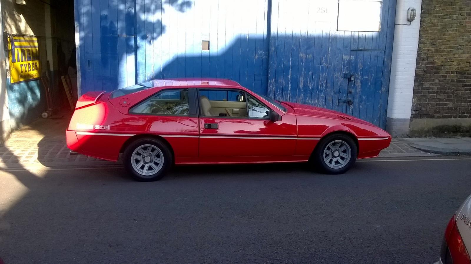

Guest Breadvan72 Posted July 10, 2015 Posted July 10, 2015 Cheerze all. In the cool of the early morning, I drove the car gently from Marylebone, via Regent's Park and Camden Town, to Islington, where the spectacularly ace two Johns took it in for a look. The car didn't overheat on the way, although it was getting quite hot by the time I reached the garage. One fan has seized. This almost melted the wiring and also blew out the override switch. One fan is now working, another is to be ordered. Car staying in London for the weekend so that the Johns can look at it some more next week, attending to some other niggles that need doing anyway, and fit the fan when it arrives. skattrd, inconsistant, Magnificent Rustbucket and 3 others 6
Magnificent Rustbucket Posted July 10, 2015 Posted July 10, 2015 WP_20150710_07_40_55_Pro.jpg This picture looks like it has escaped from one of those high concept photoshoots beloved of Car Magazine in the Eighties. Well, it would do if Autoshite let you quote pictures, so you'll have to guess which one I was talking about!
