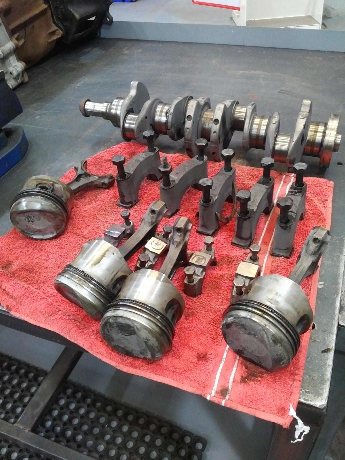

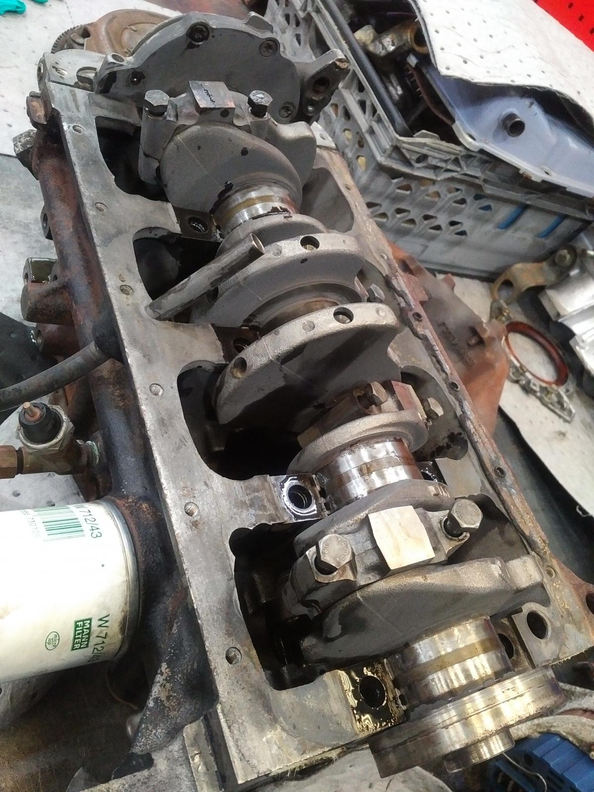

After an FTP this morning I found time to have a look at the CVH engine from the Kallista. A decent washer at work made a good job of getting things clean. Have some engine photos;

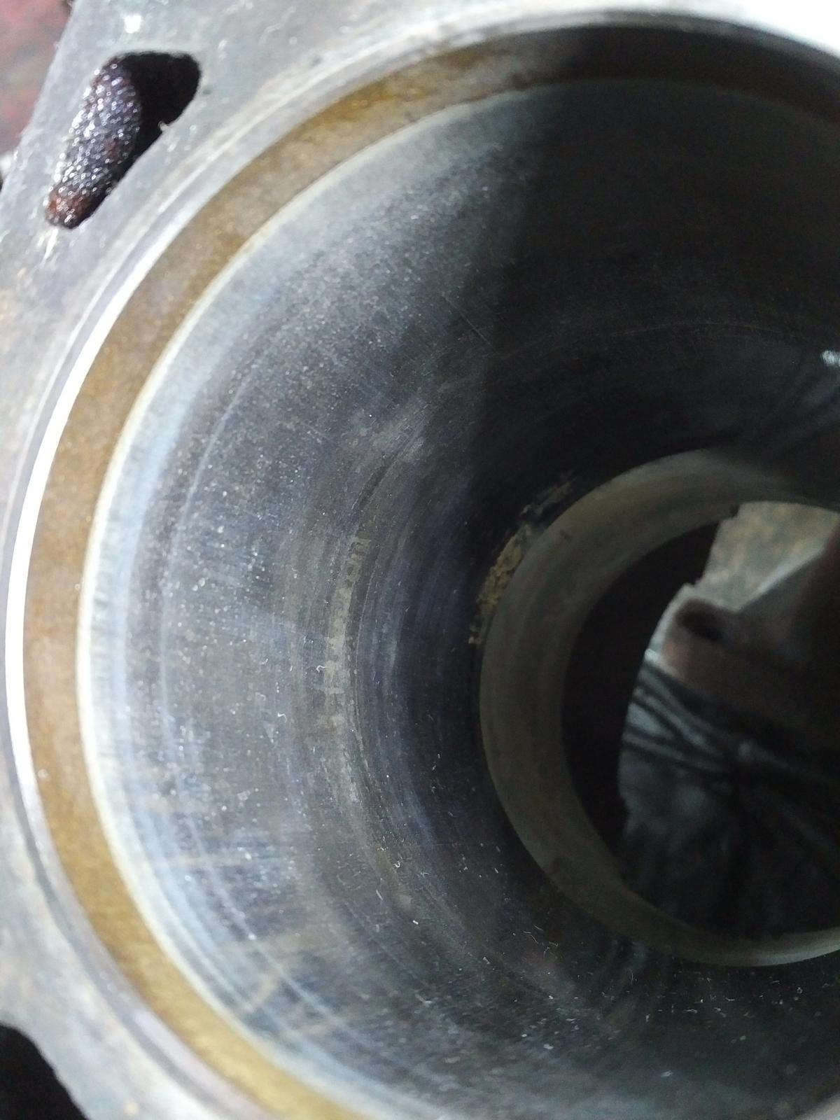

Residual oil had a carbon / burnt whiff about it, evidence of carbon deposits around the engine and bores polished due to carbon build up on the piston crowns. Usual CVH issues where owners neglected service intervals and often used incorrect oils.
There is bore wear present, meaning a rebore is necesssry. The additional capacity will come in useful for the tuning aspirations.
Need to find time next week to get the cylinder head assessed.

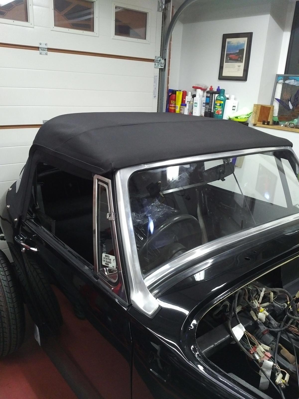

Fetched the car back from having a tailored hood fitted, ooh suits you sir!
Looks a nice job.

Got a bit of a shock today, CVH pistons for the hemi head engine are made of unobtainium! No one has oversized pistons in stock and Mahle as well as Federal Mogul no longer manufacture them. There are some non descript ones on eBay but I'm not sure I'd trust them.
The option is to fit lean burn pistons and procure a corresponding head with kidney shaped chambers. Therefore I decided to measure the bores properly with an internal micrometer. The worst wear step measured at 80.13mm and quickly recovered to 80.02mm for a bore size of 80mm. There was no ovality and the gap of an inserted scraper ring was perfectly acceptable. Other wear steps measured at 80.08mm.
The bores cleaned up well with dressing stones (glaze buster) so new Goetze bevelled rings will be fitted to the standard pistons. Not all is lost, head and camshaft to sort next, engine wise.

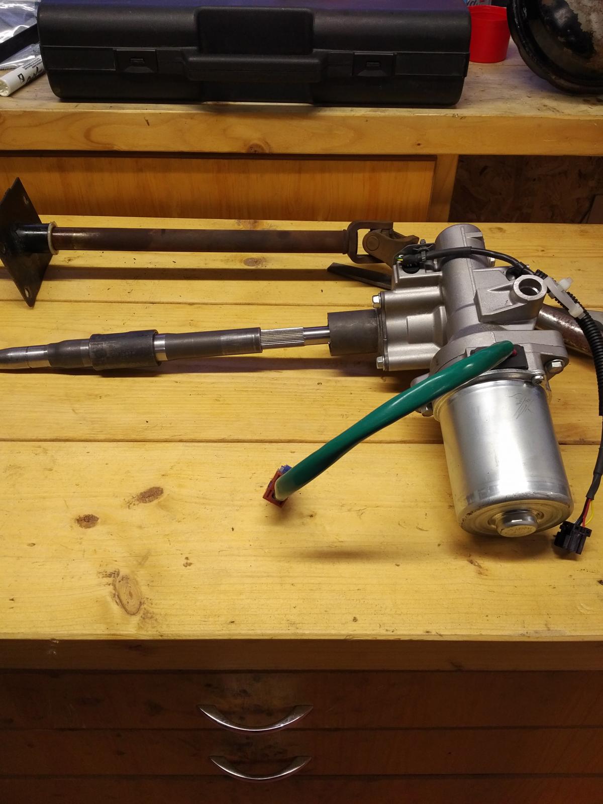

In other news the steering column is out to have EPAS motor inserted.

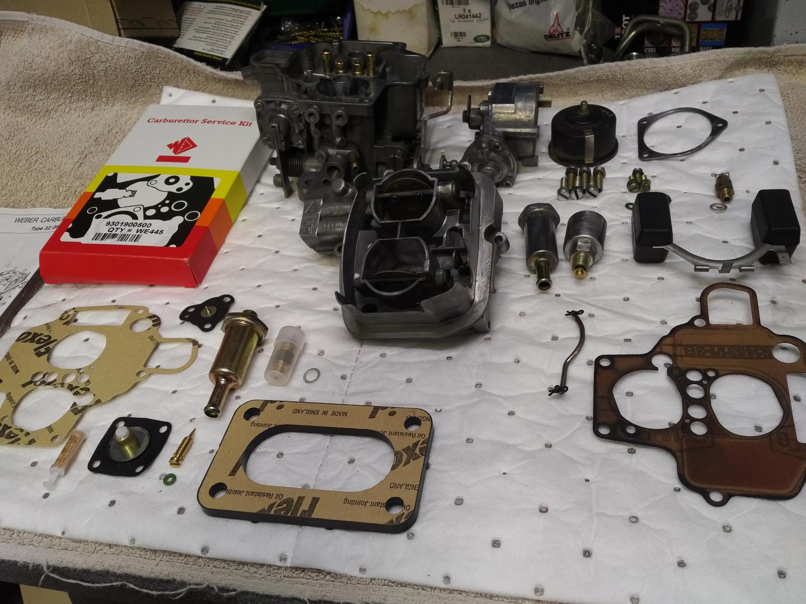

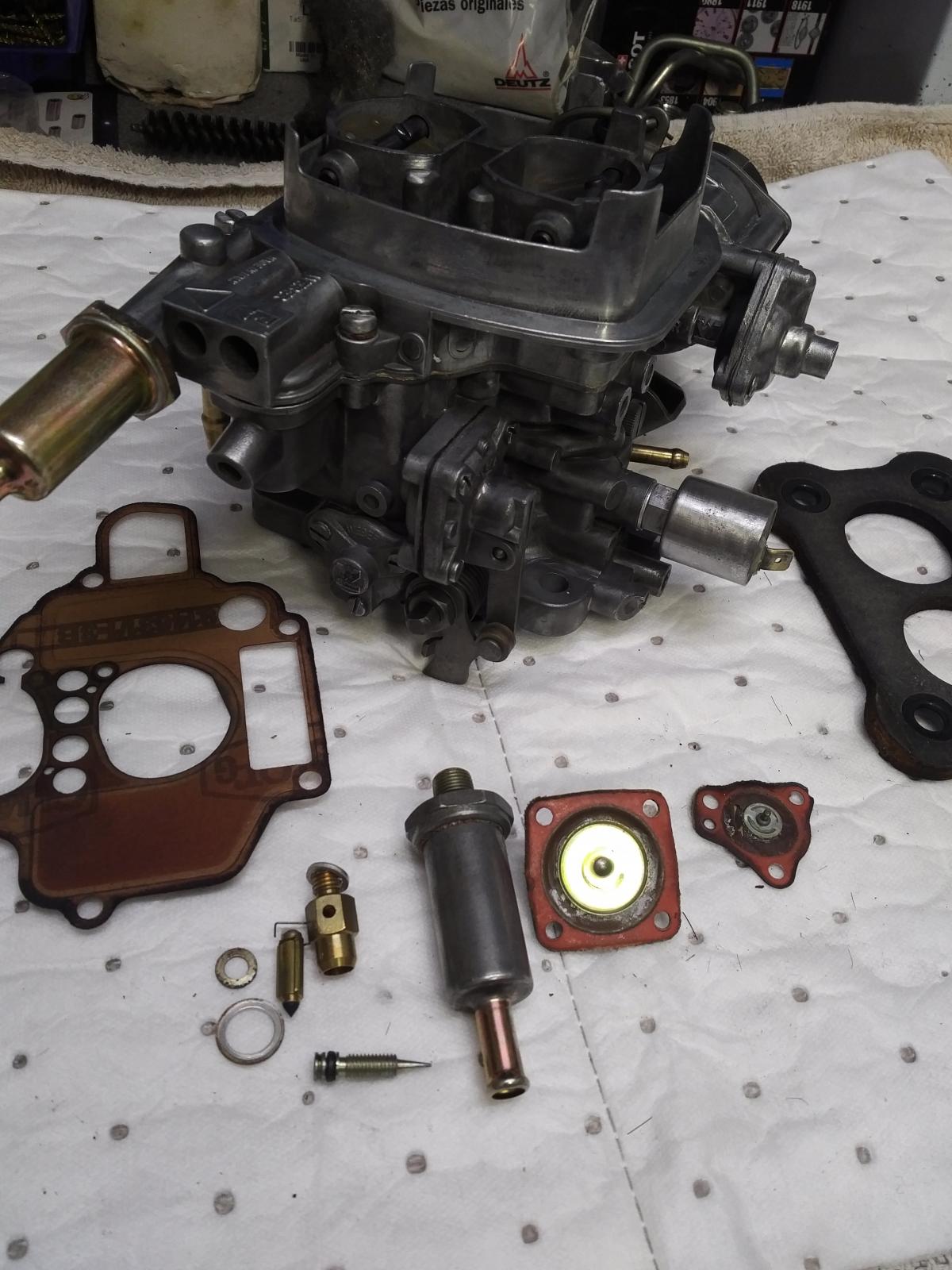

Spent some time on the Weber carb this afternoon. It has been patiently sitting on the bench at home, having been cleaned and the barrels polished. A new rebuild kit and it's now ready to fit.

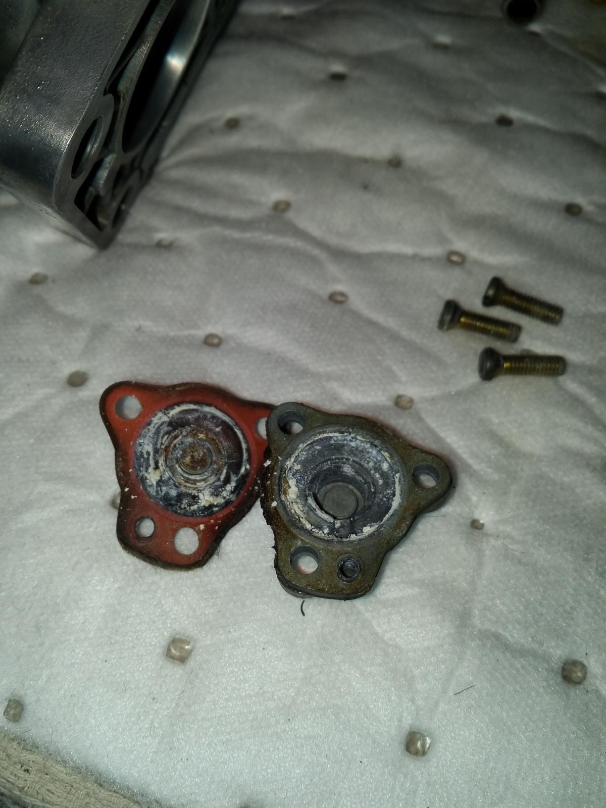

Found some cruddy fuel remains in behind the diaphragms.post-19581-0-11842200-1485704076_thumb.jpg
Seems strange that there are people around now that don't have a clue how to strip and set these up.

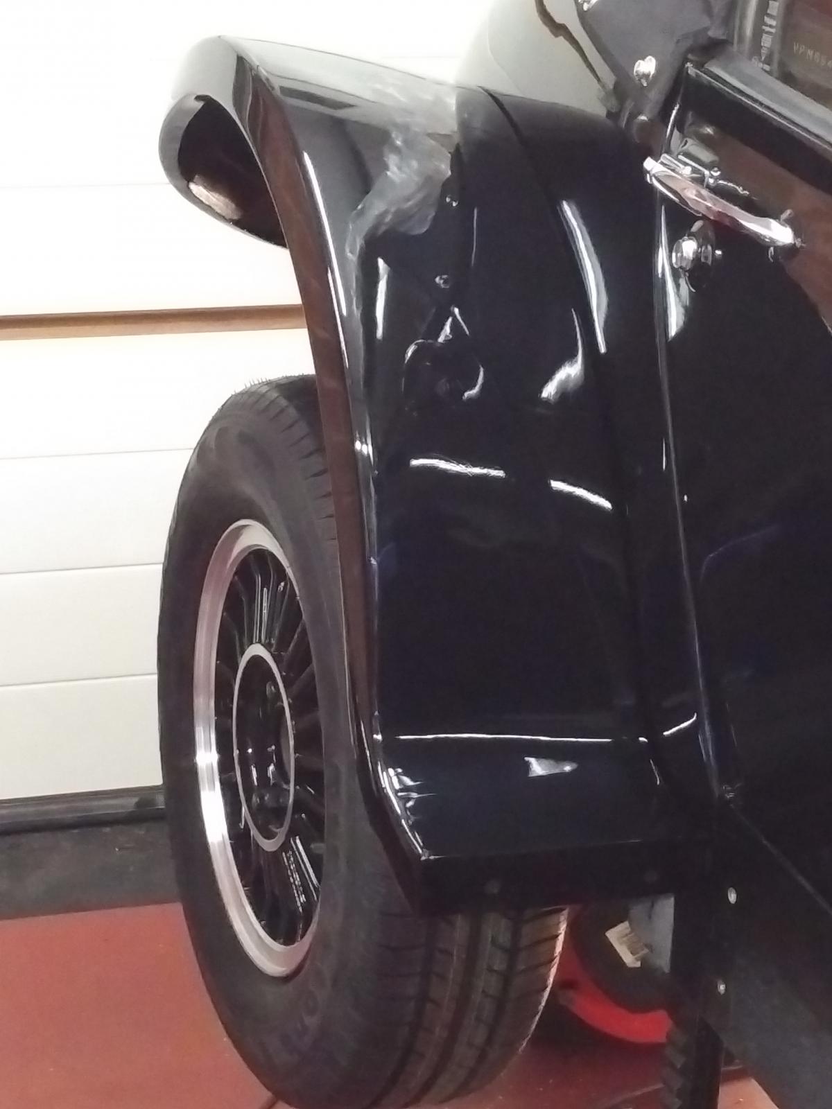

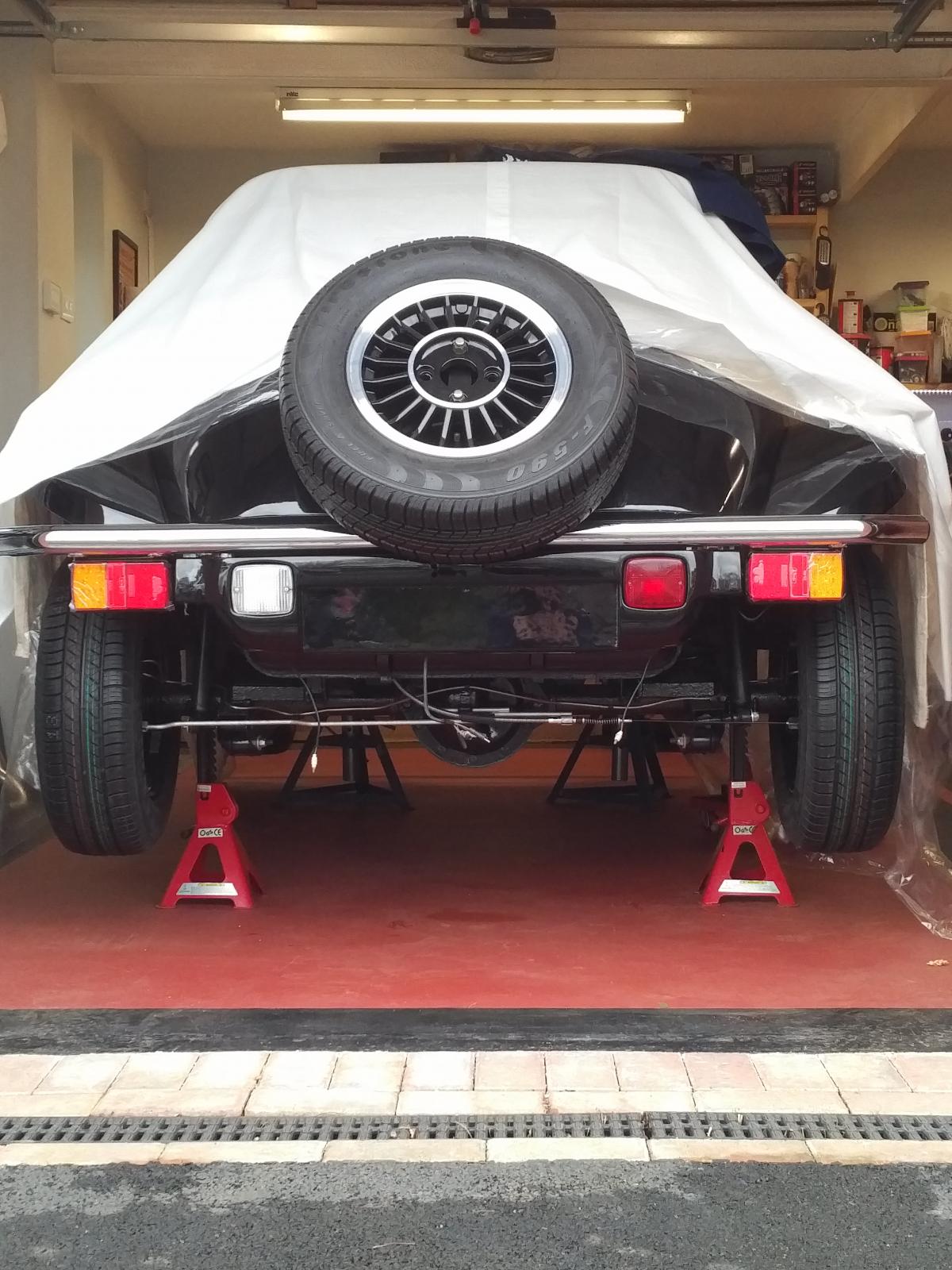

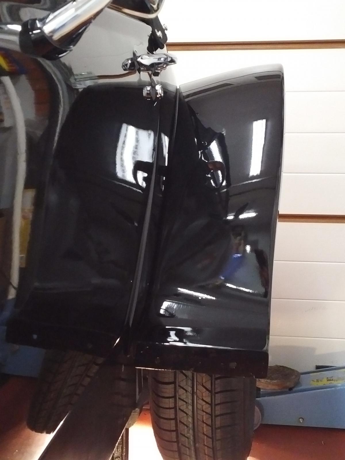

It's not just Red Bull that gives you wings, the rear ones are now fitted!

32/34 Weber? I seem to recall the XR3 had 38/32 with square chokes
I seem to remember the 38/32 being on Pinto's, but I could be wrong. Scimitar SS1, XR2 and XR3 CVH engine I had to deal with were this carb. The 38/32 could have been fitted as an upgrade though.
My memory might well be wrong, but I know I got a square choked webber off a XR3 to fit to an Onion 1.6, along with the 1.6i exhaust and manifold it made it go like a 1.6i.
I shall be fitting an XR3i exhaust manifold, I understand it is one of the best CVH mods and cheaper than a four branch. I'm looking at ceramic heat insulation coating too.
Yeah the 1.6i manifold looks like a four branch, the carbed motor got a flat square thing obviously designed to choke it so the injections were quicker.
From memory the injection manifold is longer, so you'll have to sort the exhaust to fit. But I doubt that'll be an issue with what your already doing.

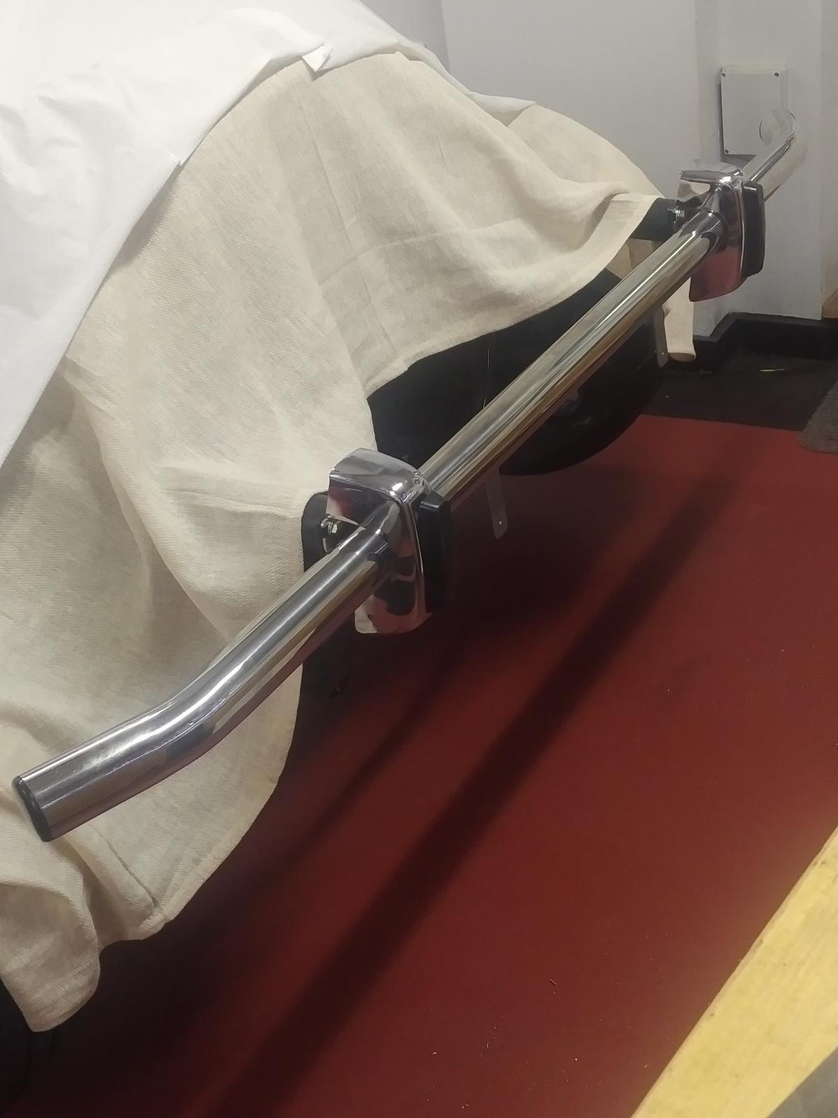

Electrical work undertaken and front bumper fitted and modified to take over-riders from a Maxi. Looks better than the bulky old plastic items akin to ugly US 70s crash regs work around.

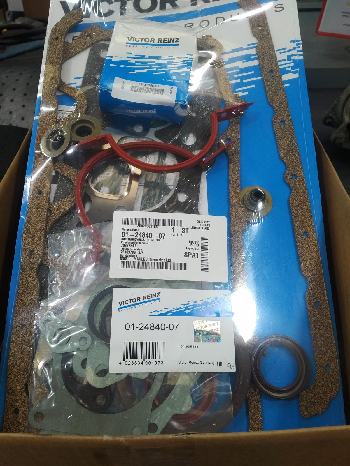

Gaskets, bearings and rings procured, engine rebuild next.

Rear end coming together nicely, really need to make time to build the engine now.
