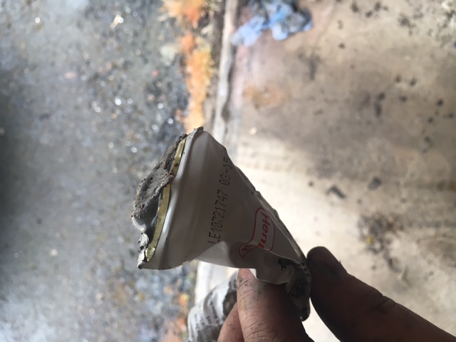

cort16 Posted June 11, 2016 Author Posted June 11, 2016 I tried and failed to get a new stat for this thing to day. However being a guy who just don't give a fuck about nothin' YO I drilled a hole in the old one and re-fitted with the hole at the top as per the various old wives tales I found on the internet. I was squeezing out the sealant for the stat housing and thinking, "blimey not much of this is coming out given the effort I'm putting into squeezing it". The I saw this. The tube had a prolapsed rear end and had dumped all the sealant in several large dollops all over the engine bay as I'd squeezed it. I didn't take any pictures as myself, the car and all my tools now had a 5 mm layer of sealant all over them. I did manage to use some of the excreted sealant to seal the stat housing at least.. Once I'd put the radiator back in I ran it up to temp until the stat opened even though it was steaming, spitting and farting everywhere well before that. I opened the heater, put it up to fast idle, let it run for a few minutes then topped it up to the brim and put the cap on. It was already up to temp so i took it for a 2 mile blast and performed an awesome* one wheel, wheel spin on the wet road down at the harbour. It's done this before when I think it's been cured then I've gone back the next day and it's overheated within a mile. Conrad D. Conelrad, LC Torana, nacho man and 4 others 7

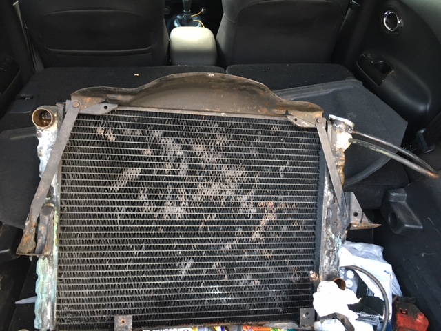

cort16 Posted June 12, 2016 Author Posted June 12, 2016 I got a chance to take it for a proper spin today. It started off okay then did the normal and heated up and chucked all the water out the overflow. I got it back to my lock up and had the bonnet up contemplating the mysteries of the universe and felt water on my leg. Is it raining? No , weird. Then more water on my leg and then a pouring sound. The radiator had sprung a leak and it was literally pissing on my leg. Conclusion, life is too short, this thing hates me I need it out my life for my own sanity. SamR380 1

jonathan_dyane Posted June 12, 2016 Posted June 12, 2016 What I'd do: 1) If the thermostat isn't opening until over 90 degrees its fucked; try a new (tested) thermostat. I'm sure these started out with an 83 thermostat although personally I'd fit a 74. You could remove the thermostat for testing purposes. 2) The radiator sounds fucked. I'd be getting it re-cored. I'd love to buy it off you but I can't cort16 1
cort16 Posted June 12, 2016 Author Posted June 12, 2016 What I'd do: 1) If the thermostat isn't opening until over 90 degrees its fucked; try a new (tested) thermostat. I'm sure these started out with an 83 thermostat although personally I'd fit a 74. You could remove the thermostat for testing purposes. 2) The radiator sounds fucked. I'd be getting it re-cored. I'd love to buy it off you but I can't How far do you go though? If it was running fine I'd not have any problem putting a new radiator in it but it's not..
jonathan_dyane Posted June 12, 2016 Posted June 12, 2016 I guess it depends. I had the impression that other than the terminal overheating it wasn't too bad? You sound ready for a Toyota... cort16 1
