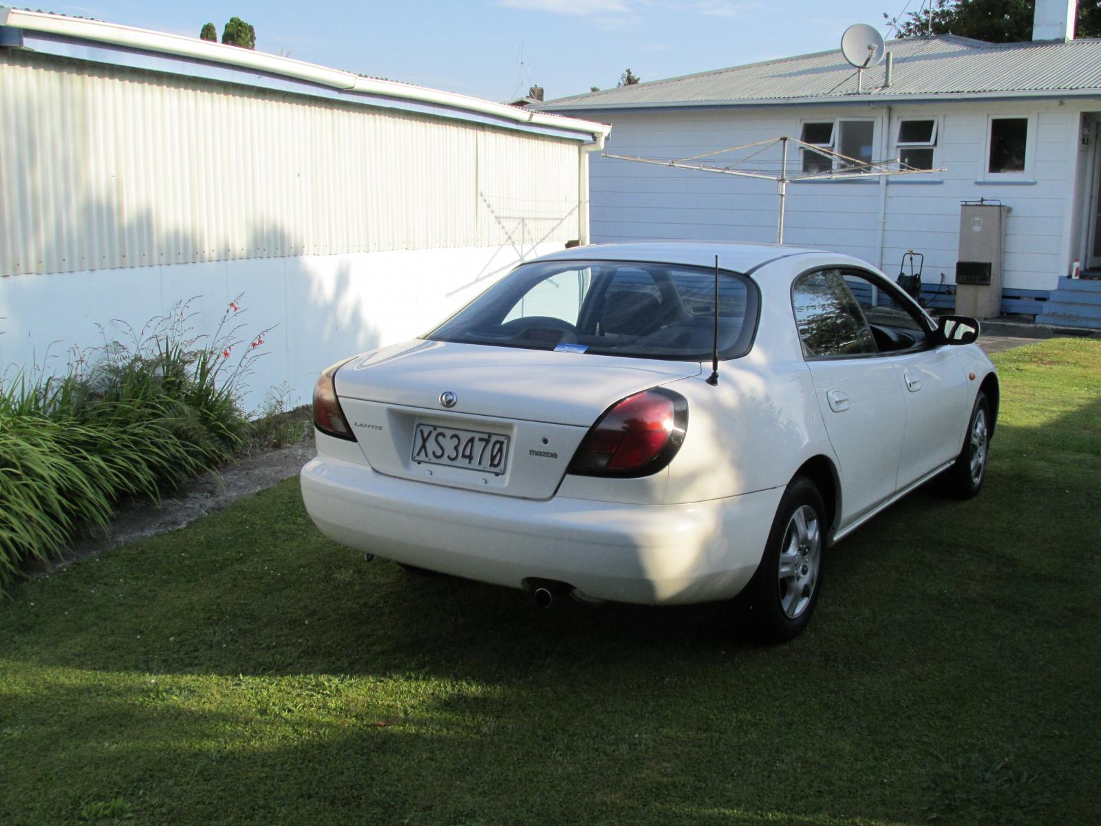

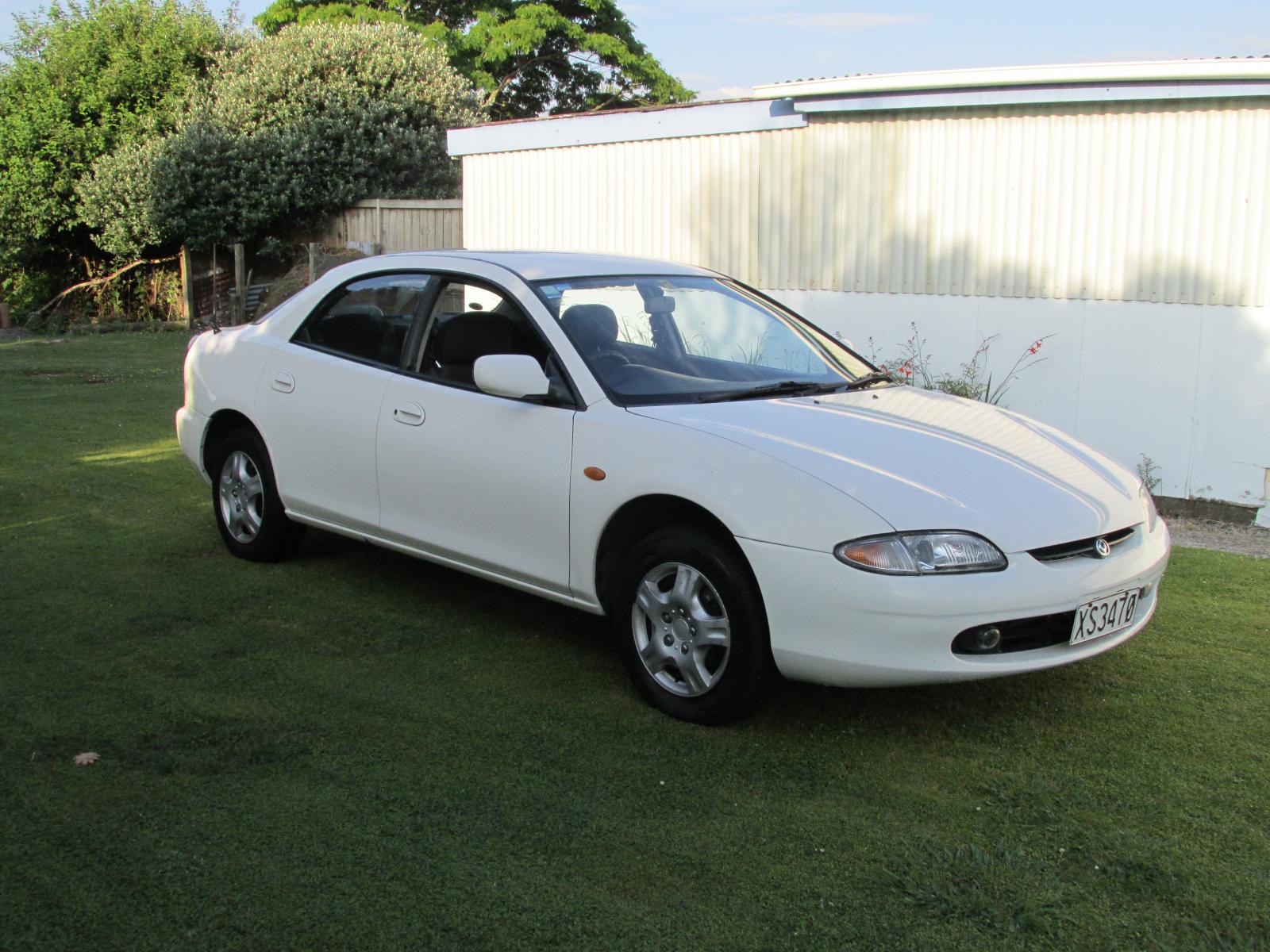

To refresh memories a couple of photos taken after giving it a good wash. It looked like a barn find before !

Looking good.
