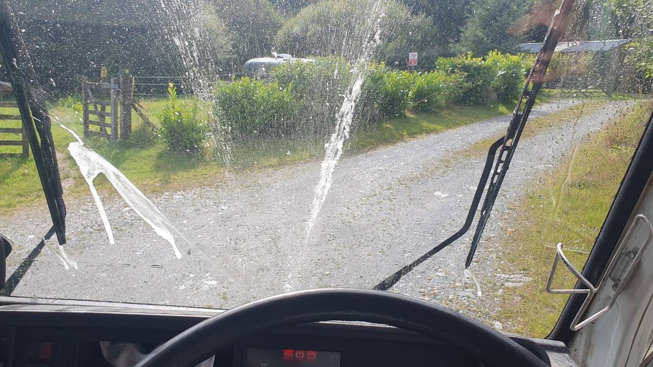

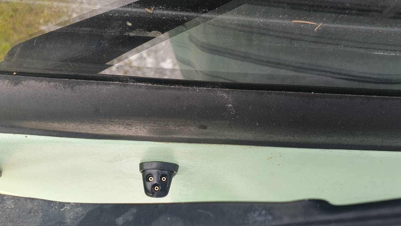

Just realised that I'd missed the 'money shot' with this job! There is about 1 degree difference between hitting the bottom of the screen or spurting over the roof, so adjustment took a while.
But eventually got there!
The downside is that it drains the already undersized reservoir more quickly - I actually used half a tank just doing the adjustments...

Yeah, I know how to adjust them - it's just that with the jets being in the same plane as the screen, any adjustment is more sensitive than if they were bonnet mounted aiming at a screen at a different angle.

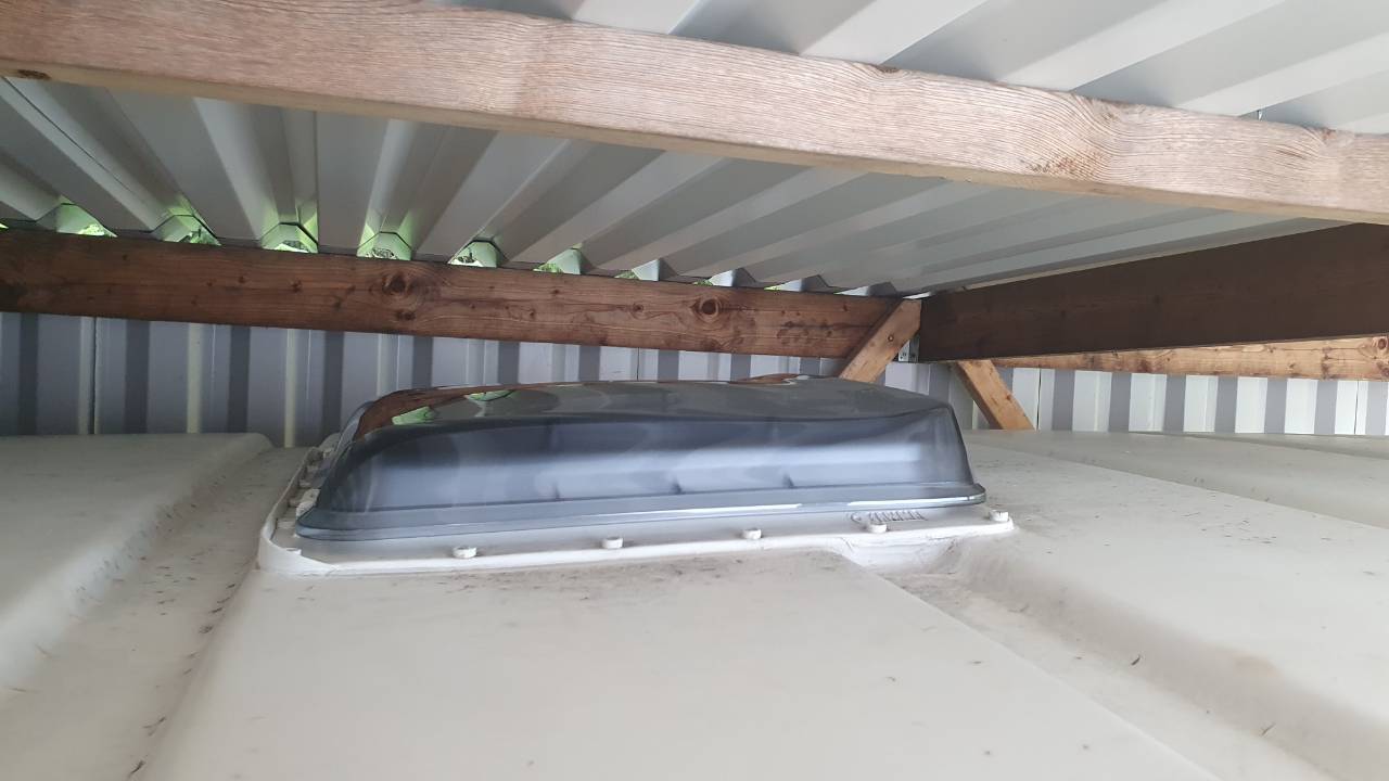

On the subject of angles, I'm reminded not to leave the roof vent open when under cover, and then drive off before closing it...20240729_165013.jpg.acc0e7484fef3f566b96901534f74fdd.jpg
At least replacements are available, and easily fitted.

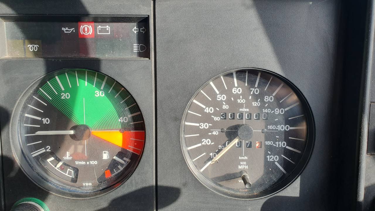

It hit a bit of a milestone on Friday, and finally clicked over 300k miles.
There's a few things which are showing signs of wear, but on the whole it's held up well.
A worthwhile upgrade might be wiper-arm mounted sprayers.  Not dis-similar to your BX, or 405s of the same era, although there are now "better" systems used on things like sprinters and other vehicles with limited locations for fixed spray nozzles.
You go through a lot less screenwash with that sort of system.

I'm embarrassed to say I didn't even think of that, as it's a better system IMO. There's quite a few neat little engineering touches on the BX (and some dubious ones also!)

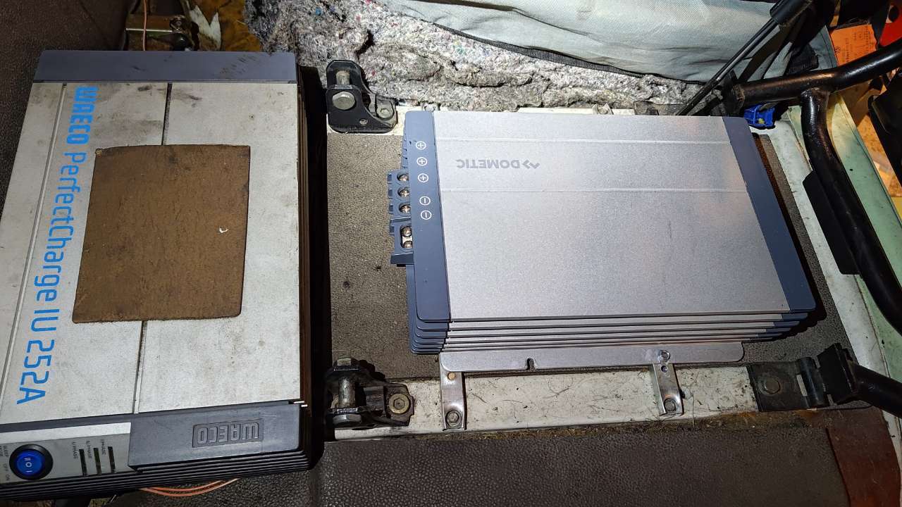

Also the fridge has stopped working on 12V whilst travelling. Not had chance to investigate fully, as I've just run it on mains via the inverter on the move (which is actually handier when we're regularly stopping, as short stops fine without the need to light it on gas).

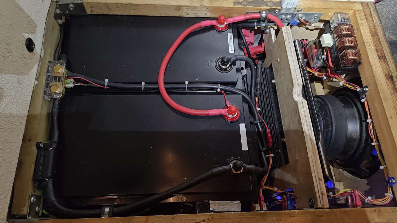

Finally got round to taking a look, and yes, no multimeter needed to diagnose this one!
Where I've mounted the relays is a bit awkward, and this was not visible until it was removed. I have a plan to redo the 'house' electrics, so hopefully will be able to resite the relay bank somewhere more accessible.
