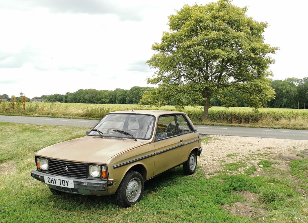

So, yeah – Things didn’t go quite to plan.
A couple of months after my last post back in 2021, the ‘living with Covid’ era began, which also meant the ‘return to the office’ edict was issued to me. This entailed much travel and I suddenly went from being at home 24/7 to being out of the country five days out of seven.
The LNA remained stuck in the garage until Spring 2022, when I dragged it out one weekend and attempted to fire it up without success – Not a dickie bird.
Being an idiot, I decided it was some sort of ignition switch / fuse problem and went down that particular rabbit hole. I’d started a new job by this point, which meant I at least got to sleep in my own bed every night, but it was also all-consuming, meaning I had zero headspace / mojo to tinker.
Eventually I sussed out that the battery was stone dead, so a new one was procured – Which made no difference, as bridging the starter with said new battery fitted finally proved that it was the starter which was knackered.
Those who know X-series engined cars, will understand this is a bit of a pain – The engine is canted backwards with the rocker cover at a 45 degree angle, brushing the firewall. The starter is situated low behind the radiator with access underneath blocked by the subframe , meaning that the fan and rad require to be removed to get at its upper mounting bolts (the lower is accessed from the OSF wheel arch).
The coolant system was a bit murky and really wanted a flush. The fuel tank was full of old E10 from when brimmed it in April 2021. Meh.
Cue shoving it back in the garage for another 2+ years, filling it full of junk and forgetting about it.
I changed jobs again at the end of last year and found myself WFH 99% of the time – Not having a 3-4 hr daily round-trip commute has helped greatly in mustering the energy to tackle the LNA.
