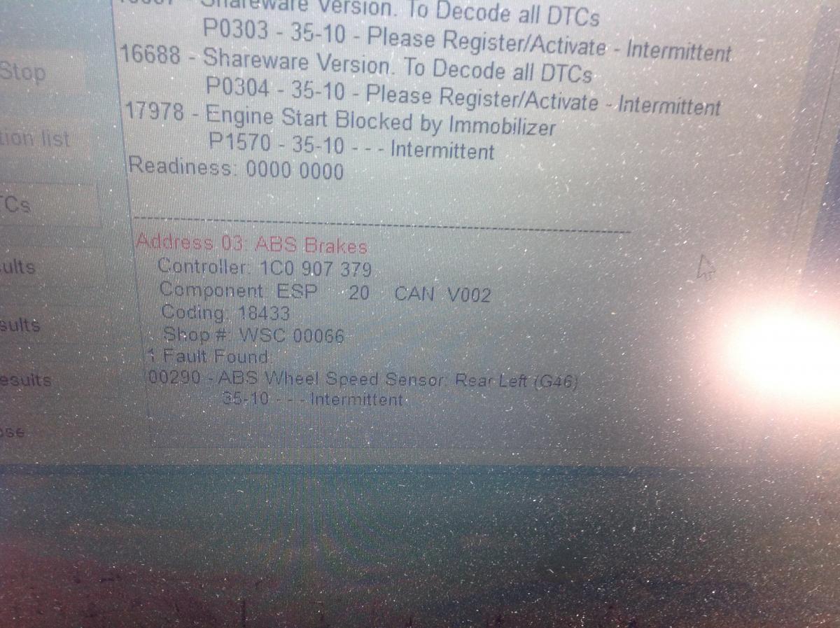

Cheers for all your help it does look like a dodgy sensor as I managed to get my cheap eBay Vagcom lead working today and it came up with this..post-9282-0-11489300-1404296541_thumb.jpg
A quick reset and all seems well at the moment... :)
