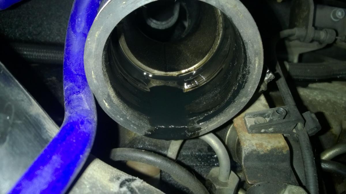

Today I decided to change the oil on the Xantia. After a battle to get the undertray off I got access to the sump plug. All good except nothing but a tiny dribble came out. Bugger.
I took off the intercooler to inlet pipe and found this.
Now I am assuming that it is Turbo seals that have gone and it is Nom Noming the oil. Which again brings me back to the crossroads of what to do with it

Perfectly normal and nothing to worry about.
My xant did this and the mondeo that replaced it.
Carry on.

Awesome. I am used to petrol turbots so not had oil literally pour out intercooler pipes.
Will ignore the rest of it then and keep oil topped up.

WHS up there, there is always some oil in the inlet pipes of TD XUD's
