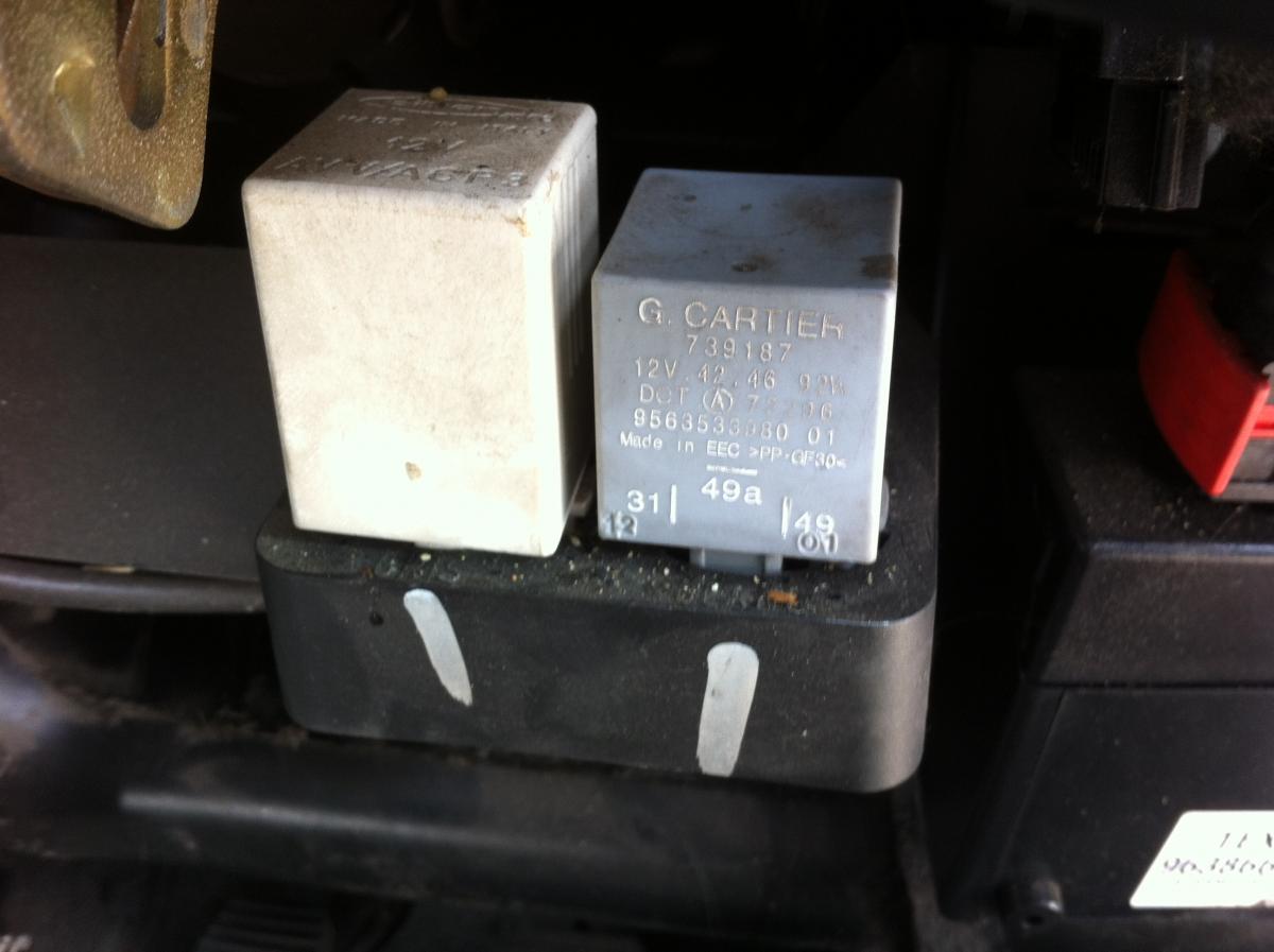

I pulled this "relay" out of the dash and asked my Peugeot dealer for a price.
£70
So I took the cover off
It's a bit more than a relay and actually only has one set of contacts.
In the photo you can see a circle in the solder above the "691" which is a crack in the solder.
I resoldered just that joint and now the AC works perfectly  8)

I am having an identical problem with my 2001 Citroen Synergie (Peugeot 806 in all but name), would you mind letting me know, how  I can  get to your relay? and where is the pressostat?

to the left of the clutch pedal but a bit higher.  I would say about the same height as the pivot point of the pedal
Did you clean the contacts on the relay up whilst you had it in bits?
Looks like it's gotten wet, that's driven the resistance of the contacts up, it's gotten hot and caused a cold joint crack in the solder.
If you didn't, there's a good chance the same problem will manifest again (typically at the point you need the aircon the most, when the thing's been on and passing current the most).

Hi I couldn't find anything to the left of the clutch pedal, but these are above it, am I getting warm?
Guest rocks
post-17875-0-78587300-1399647579_thumb.jpgpost-17875-0-78587300-1399647579_thumb.jpgI mean't these sorry!
You are indeed getting warm if the A/C isn't working.........
