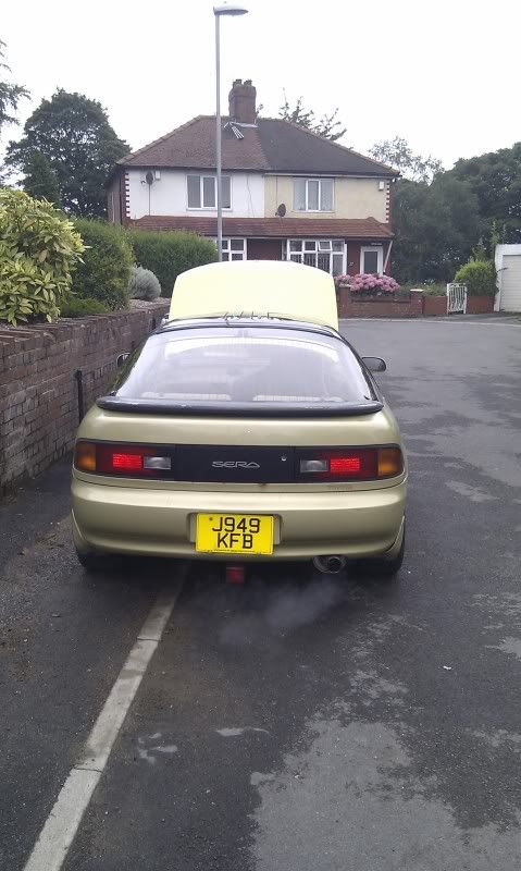

HillmanImp Posted January 19, 2012 Posted January 19, 2012 The Sera had an aftermarket fog light fitted for the same reason. Bit newer I know.
