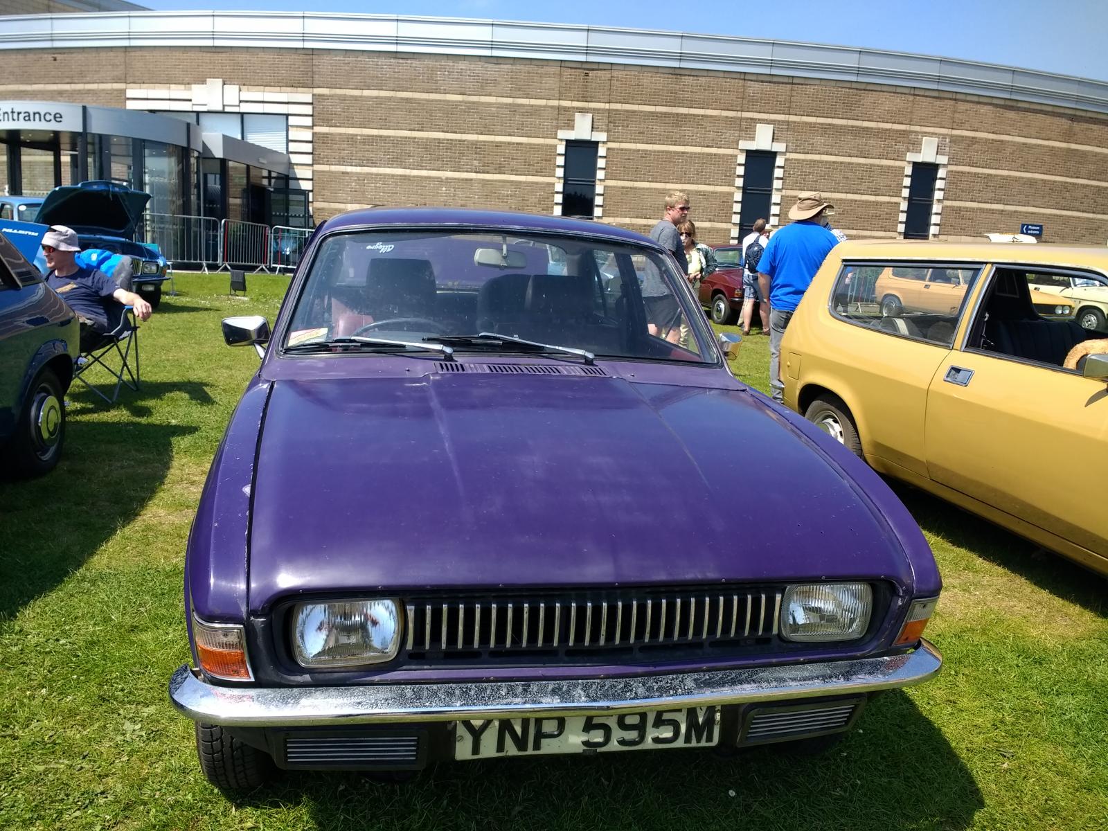

Four weeks ago we took the Applejack green Allegro to a BL/BMC event at Cowley to celebrate 50 years of BL.

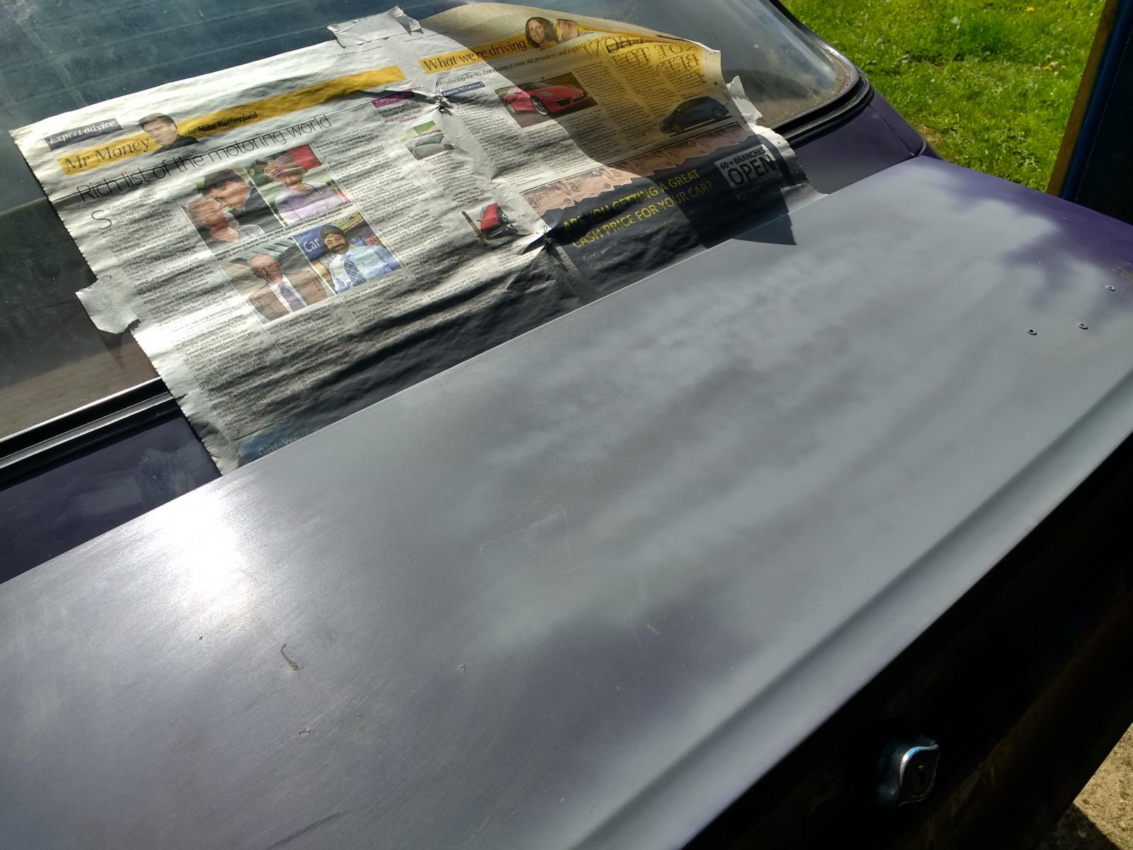

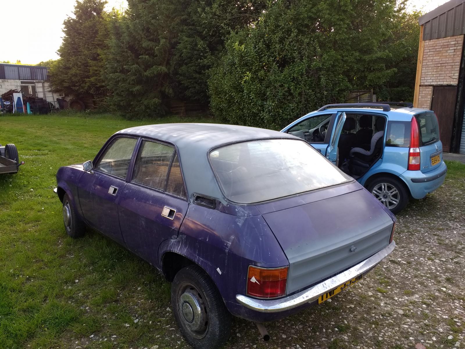

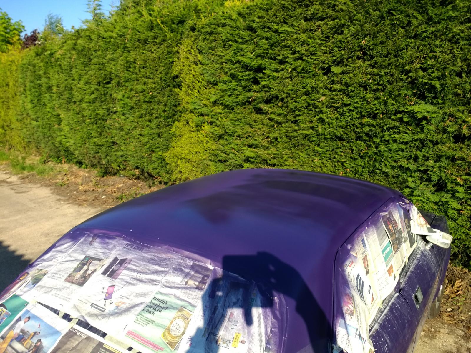

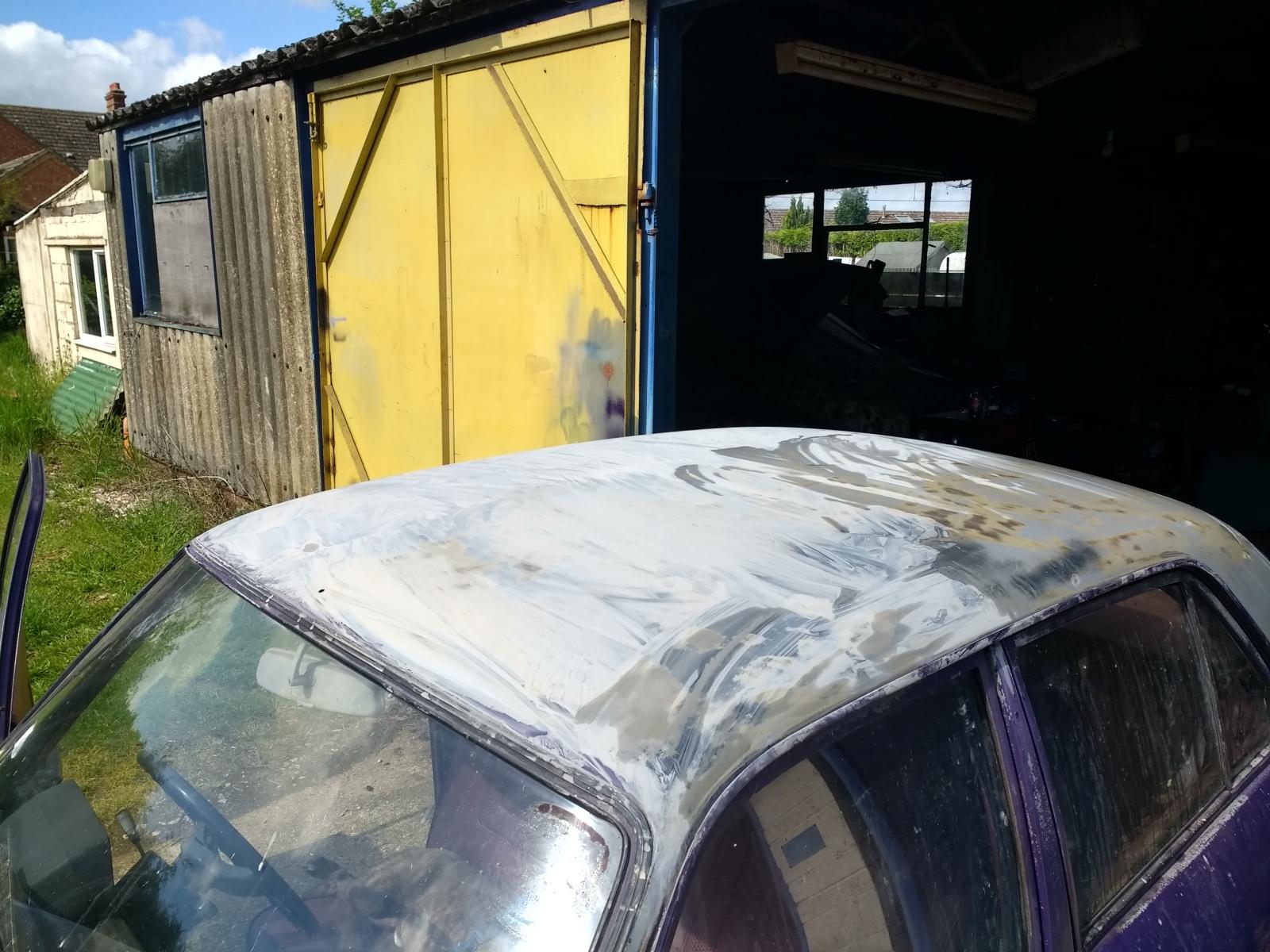

We got taking to ritchieg about the Aconite Allegro we've owned since 2004 but never had on the road. We did lots of work to it in 2005, then had welding done to get an MOT in 2009. The car drove back from the MOT station and waited while I rubbed down the bonnet and roof as the paint was falling off.

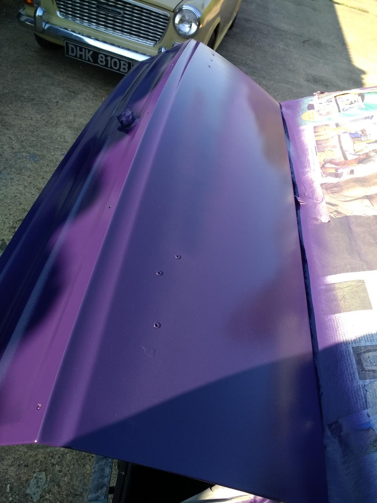

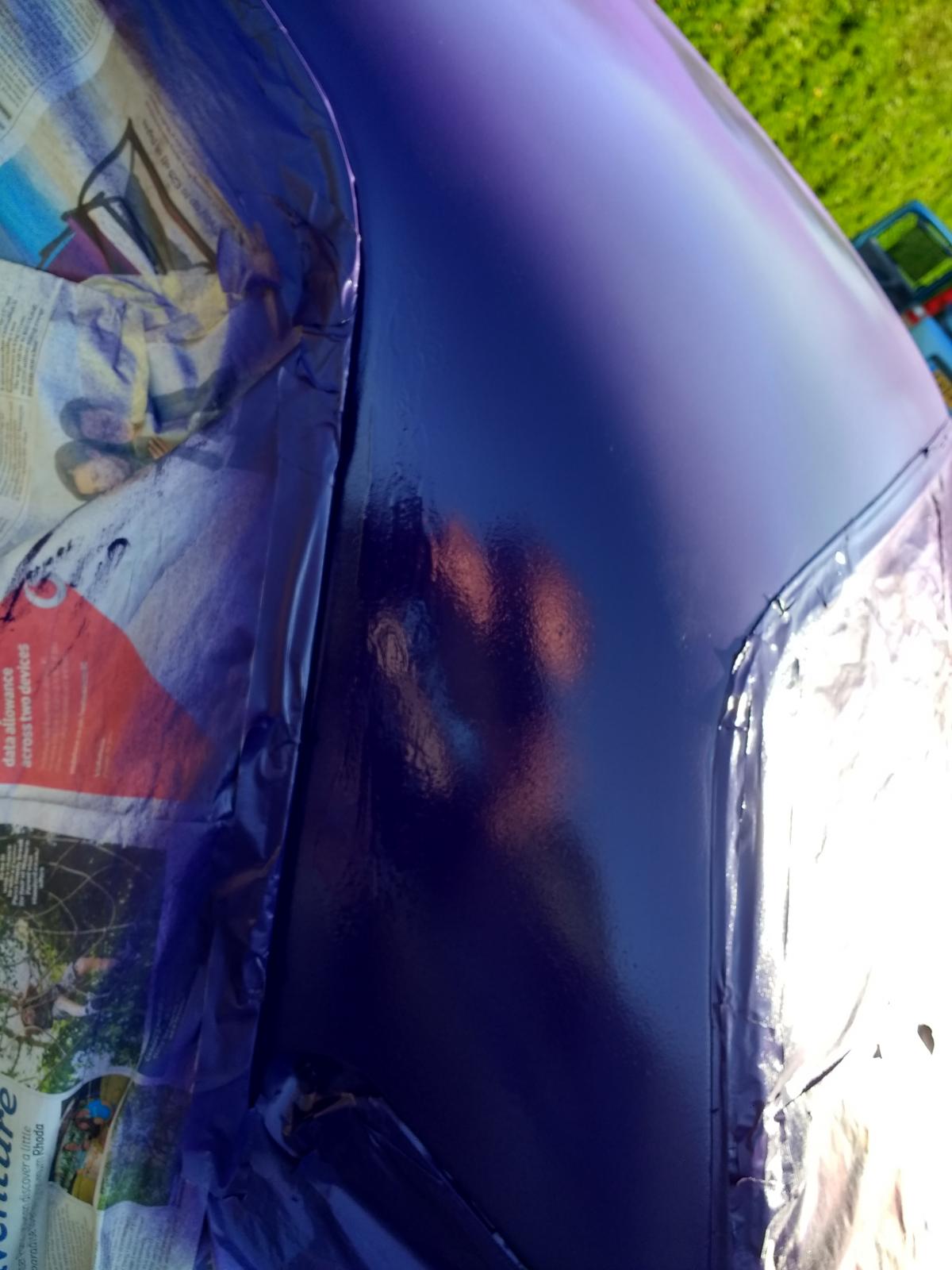

Anyway we decided to try and get it on the road. Massive thanks to beige1100 for doing the mechanical recommissioning. I rubbed down the bonnet (needs at least one more coat of paint) and painted the roof (needs more rubbing down and mopping).
The old but little used Clarke 25 litre compressor did a much better job than I did (and I expected). post-4915-0-39652200-1526842879_thumb.jpg

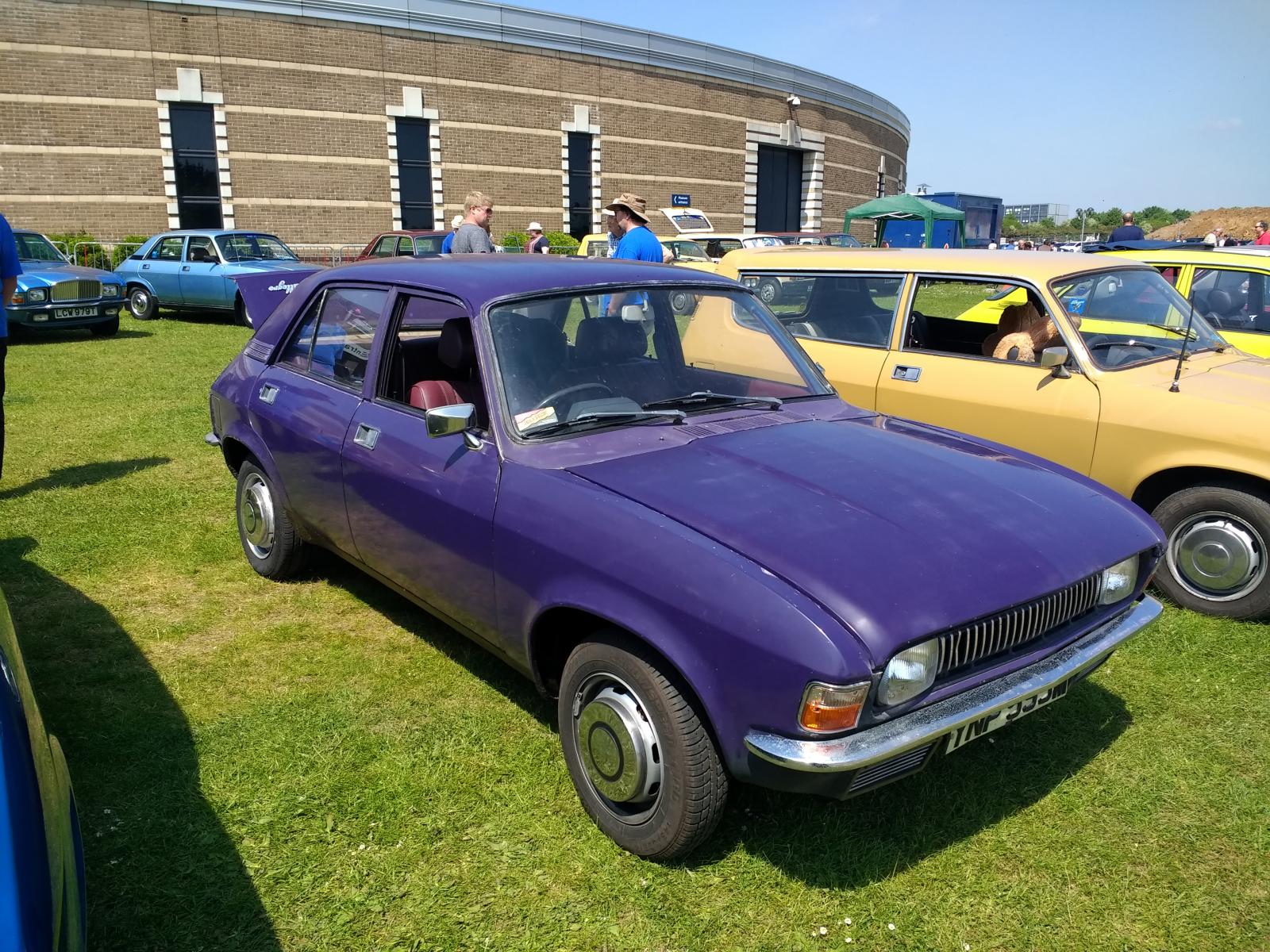

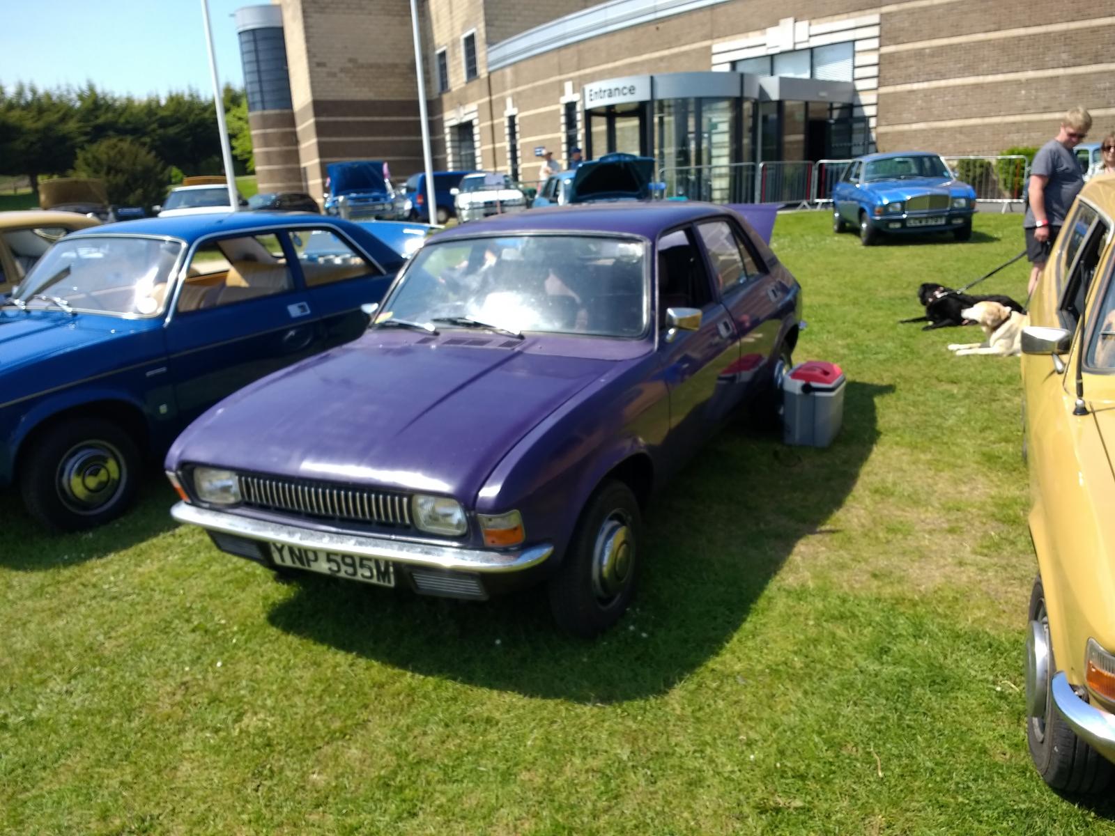

And it made it to Gaydon fur the Allegro Club national only losing a bit of clutch fluid.
post-4915-0-52066600-1526843079_thumb.jpgpost-4915-0-37790500-1526843106_thumb.jpgpost-4915-0-94791000-1526843133_thumb.jpg
It drives really nicely (with an occasional burning smell of pushing on) and is tax exempt now. Really pleased with it, even if it still looks a bit crap.
Despite being off the road since 1991 it covered the 230 miles without fault. Sadly the round trip was 240 miles, the last ten felt like running out of petrol despite still having fuel. After pulling over with no load on it we managed another couple of miles before doing it again.
