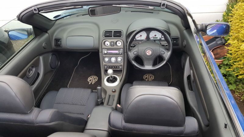

JohnK Posted January 24, 2016 Author Posted January 24, 2016 Interior pic, just for you Ken Coprolalia, oldcars and purplebargeken 3
