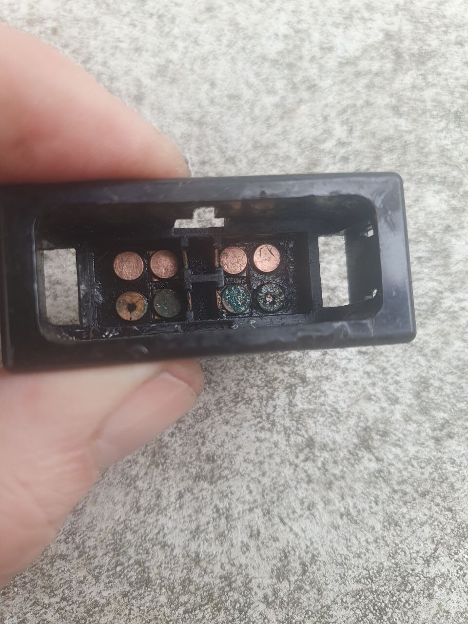

as seen in the flower farm meetup thread the Kitten Reliant (sic) had it's first run out over the weekend.  I was working then out on Friday so Saturday I gave it a bit of a once over, fixed the non working wipers which turned out to be a very furry switch seen here part way through cleaning

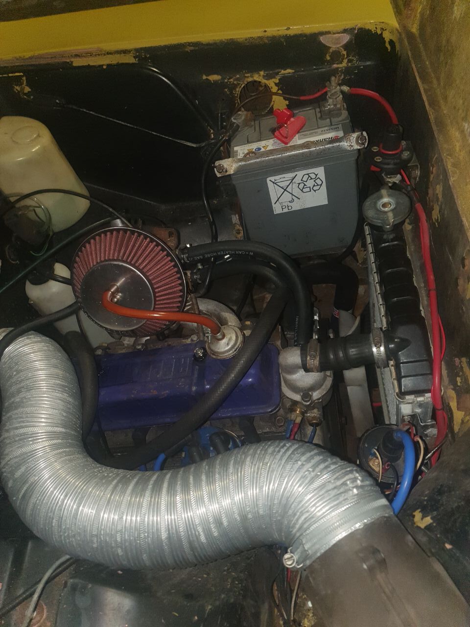

I also detected a faint smell of petrol around the fuel pump area. I wasn't sure if the top of the pump was weeping or it it was the pretty old looking inlet pipe. It was too late to do anything about the pump so I just cleaned it and nipped up the top fixing bolt and then replaced the pipe.  It took a bit longer than I'd hoped due to needing to drain the tank so I had more time to get the new rubber hose on the thin plastic fuel hose without fuel pissing at me. Seems to have sorted the fuel smell now but I think there's possibly a very tiny weep from the pump which I'll look to address
By now it was getting late but had my first run around the local area on Saturday night. Its pretty hilarious to drive around town.  Loud, small, snicky gear change, revvy engine. Nothing broke or fell off so I called it good to go for Sunday morning.  Did notice once warm the engine is a bit tappy/rattly.  They do suffer from chain tensioner issues so hoping that's the rattle and they can also be a bit tappy, I'll check the valve clearances and inspect the tappets which can wear and get noisy
