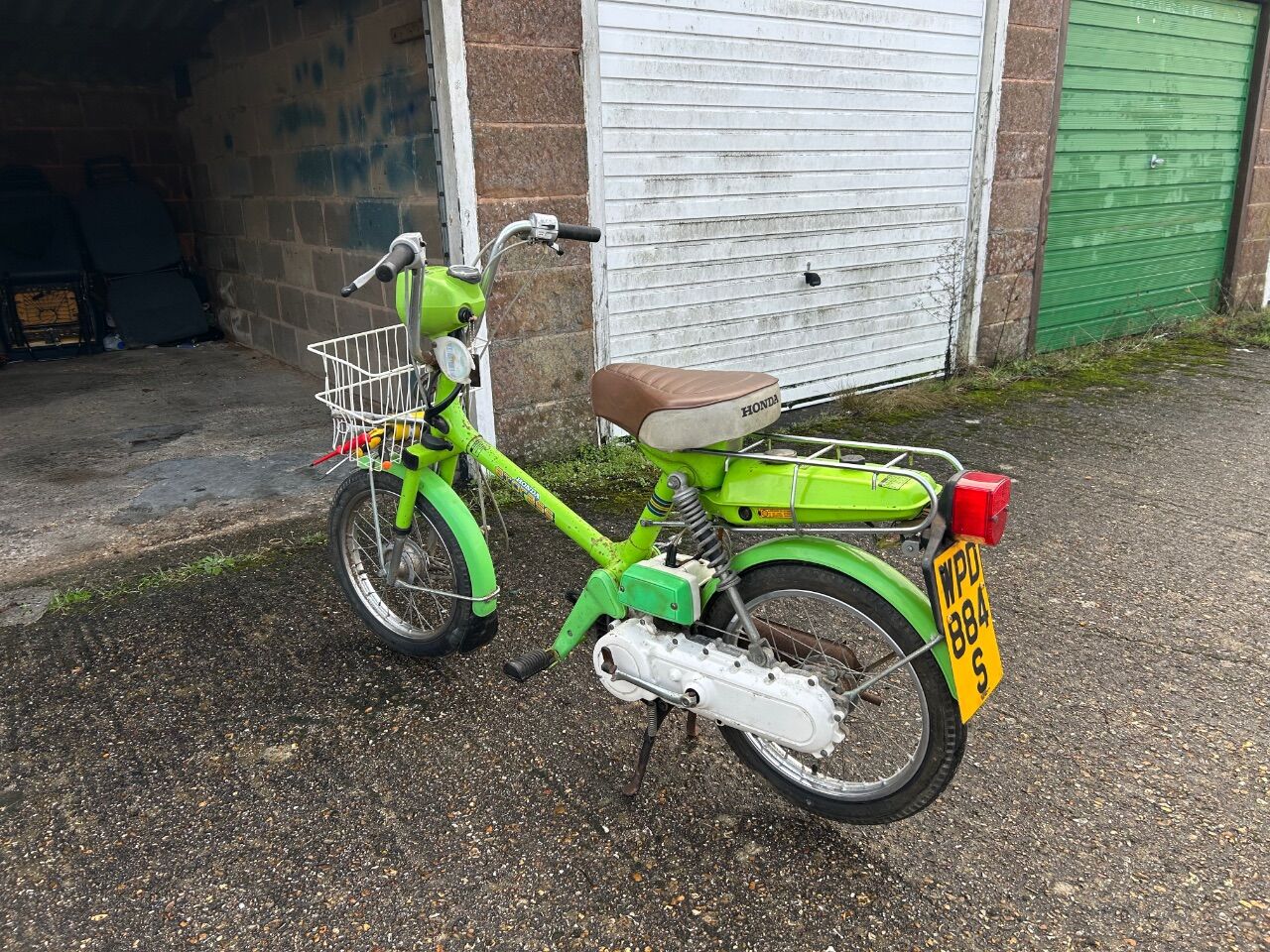

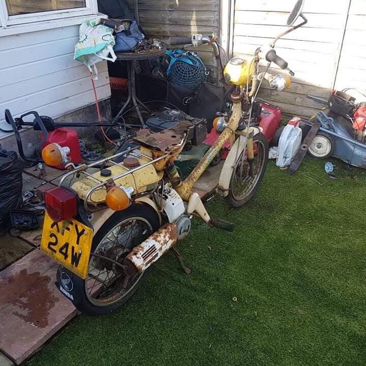

calebaaront Posted June 21 Posted June 21 Back in 2019 I purchased this little mean machine from a chap in Liverpool who owned it since 1989. With help from my Dad and Sister it was restored. In 2022 the engine decided it had enough after I did roughly 3k miles on it. So I left it at my parents house, I think now I’ve got a bit more free time and money I’ll try and restore it again and document it on here. I’m planning on a full top end rebuild and possibly bottom end, the cylinder has been exposed for 3 years so I think a rebuild is defo necessary although the engine isn’t seized. This isn’t going to a be a quick restoration and will take a few months. Stay tuned for updates on here. eddyramrod, LightBulbFun, 500tops and 13 others 16

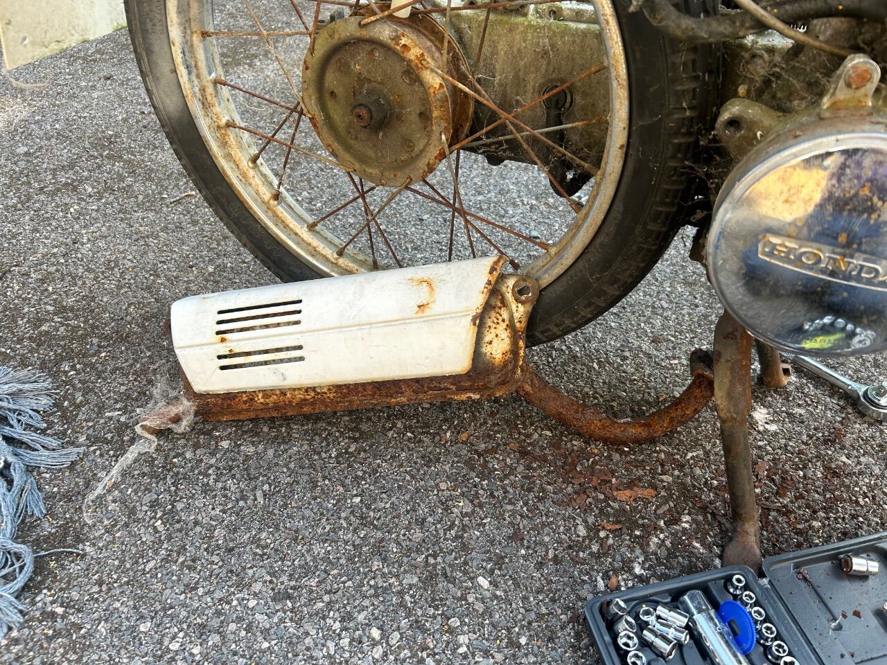

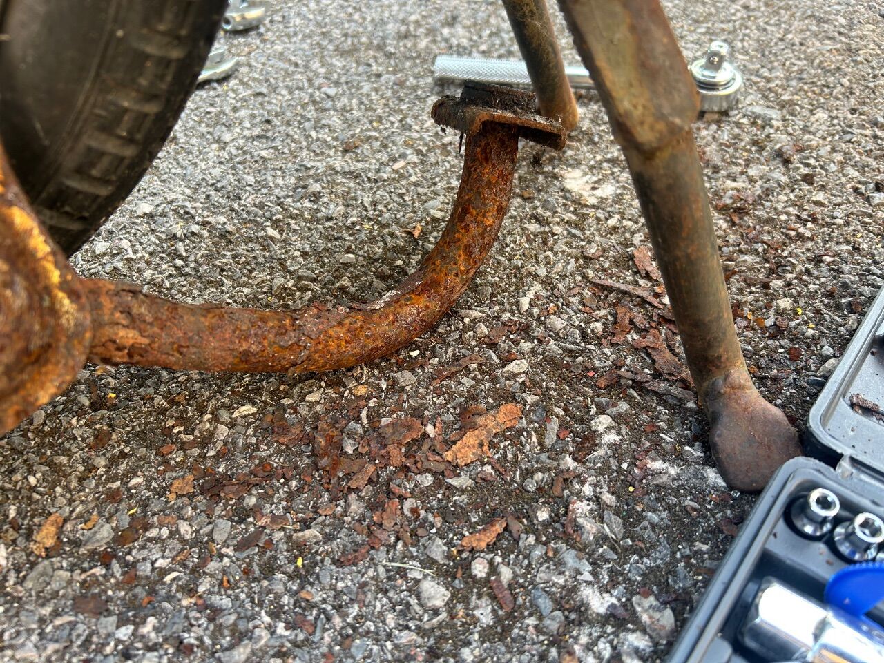

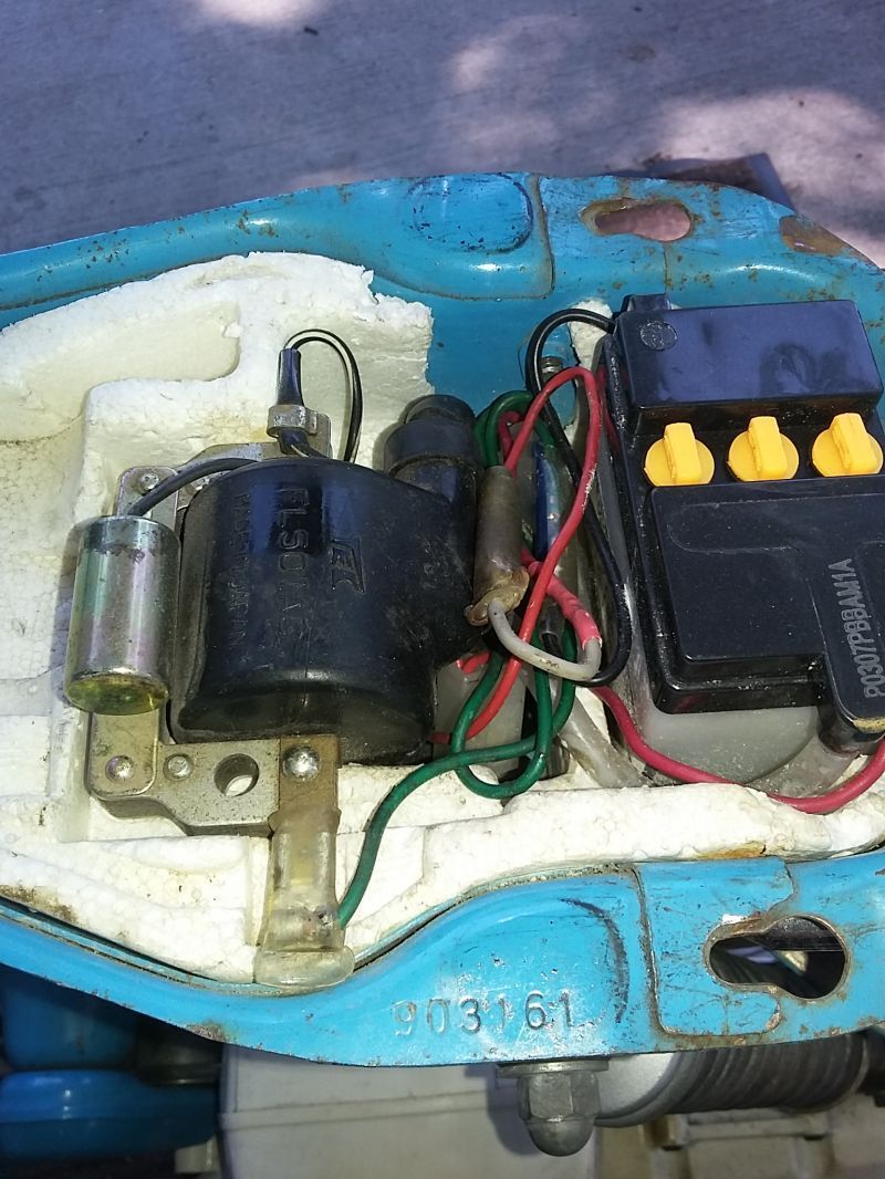

calebaaront Posted June 21 Author Posted June 21 Already made some progress, managed to unseize the brakes. I’ve tried to get some spark but had no luck. I’ve cleaned and taken off the points. Re-gapped them and cleaned the spindle they sit on. Checked all earths going to coil and ignition. Still nothing, any ideas? Also took the exhaust off and found out it was quite rusty 😳 UltraWomble, Weird Car and D.E 3
petermcpete Posted June 21 Posted June 21 Are you looking to keep it original, or have you considered fitting an electronic ignition (if available)? If you're using it a lot i've found on other mopeds they can be a massive reliability upgrade. calebaaront 1
calebaaront Posted June 21 Author Posted June 21 4 minutes ago, petermcpete said: Are you looking to keep it original, or have you considered fitting an electronic ignition (if available)? If you're using it a lot i've found on other mopeds they can be a massive reliability upgrade. I’m not too fussed about originality, I retrofitted a 2 speed engine a few years back. I’ve got a feeling my no spark issue may be the stator or coil/condenser. I’ll ask on the Honda Express FB group if anyone has fitted EI to an Express.

castros_bro Posted June 22 Posted June 22 Your points picture doesn't show the rotor which needs to be fitted for ignition to work. Sorry if that's granny sucking eggs info. Mine rotted an hole in fuel tank after being left outside over winter.
calebaaront Posted June 22 Author Posted June 22 28 minutes ago, castros_bro said: Your points picture doesn't show the rotor which needs to be fitted for ignition to work. Sorry if that's granny sucking eggs info. Mine rotted an hole in fuel tank after being left outside over winter. Even with the Rotor on there was still nothing, I took it off to take the points off and clean/regap them. I’m going to investigate the stator with a 6v bulb and see if I’m getting any life. If there is life I’ll put it down to the coil being toast
