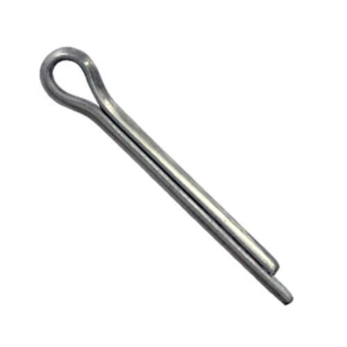

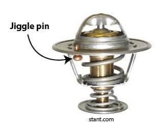

46 minutes ago, grogee said:
Giggle pinpenis-movement-jiggle-video-demonstration-v0-Mjd1MHp5N2tuZHNjMaQfNmArC7g0gKoVg1y64eQ_h8m4LP899MpRxRfD3j3L.jpeg.4965085df932ec5087ceb42019c94b74.jpeg
The politics section makes more sense now.
