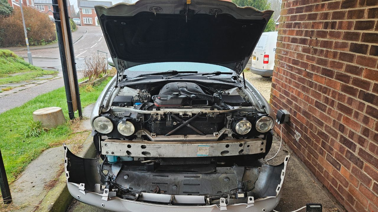

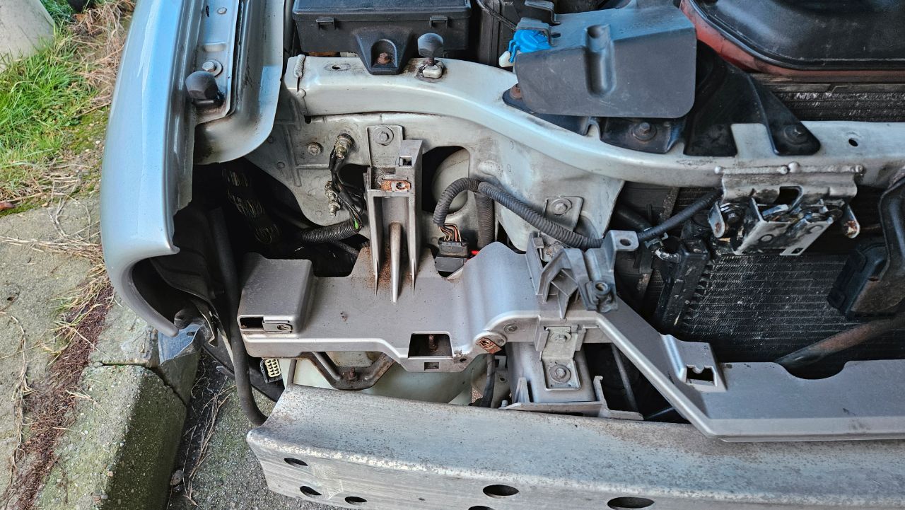

Tiny update for today, bonnet wasn't closing easily, so adjusted the brackets/hooks on the bonnet, passenger side shuts fine, drivers side...nope, nothing. Tried activating the latch with a trusty screwdriver and yeah, drivers side just pings back to open, no latching mechanism on it for some reason. So £20 to Autoreserve Jag for a spare one, hopefully I can get that done and save the bonnet flapping about!
Well, so much for it all being sorted....
Restricted performance popped back and dissappeared again the other day, EML on but no codes on a basic reader.
Oh, and got a new latch for the bonnet as advised, and nope, not that. The cable is knackered, seized up so it wouldnt return to lock the latch after opening. Middle section has rusted out of the sheath and is all bent, have done an AS special and filled it with half a bottle of 3in1 for the time being, but looks like its going to be a new cable job, why Jag couldnt have made the cable between the two latches a seperate piece is baffling, instead you need to redo the whole thing.

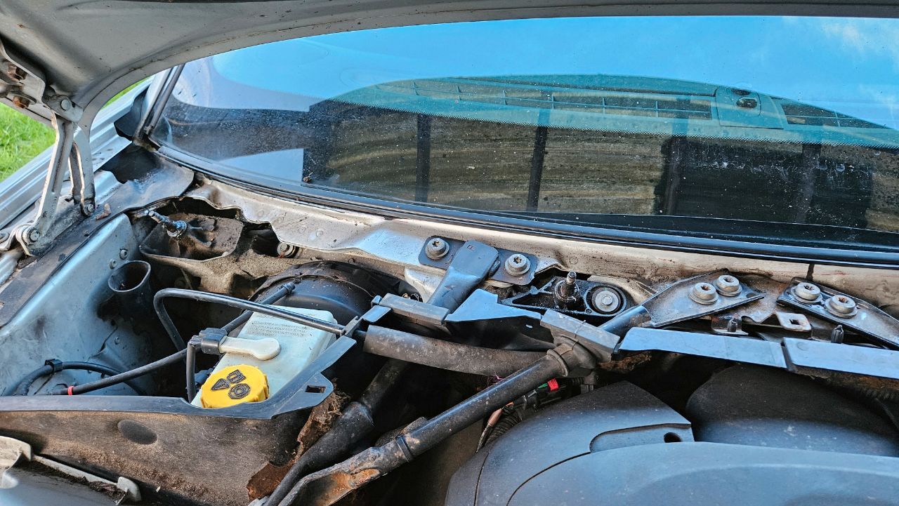

Oh and the wiper mech is now screaching, so got to get the scuttle panels apart to lube everything up 🙄

On another note, the wiper mechanism is having a good screech as it wipes. When the BMW did that the arm and mech came off at 70mph on the motorway, hoping this one doesn't do the same because it looks a horrible job!
