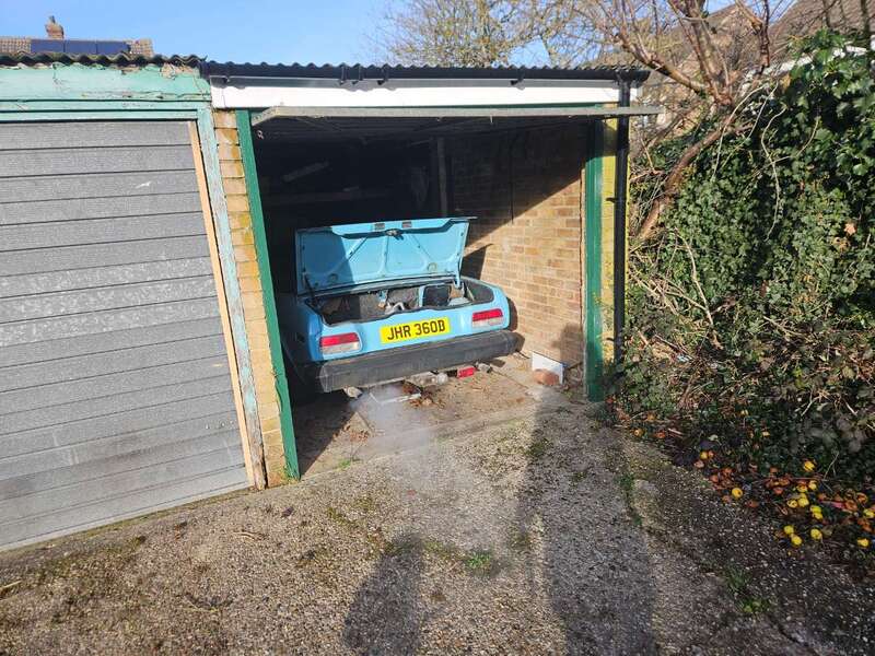

went and had a look at the TR which also hasn't been used since well before xmas,  connected the battery, turned the key and hey presto.
Thats steam not smoke!

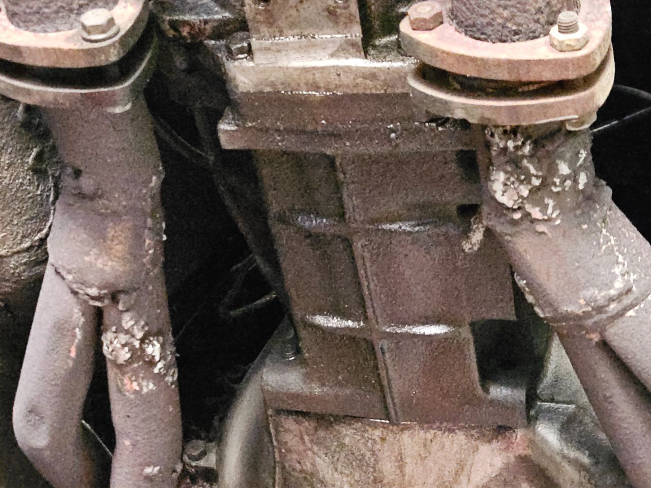

 A couple of issues to sort out, it was very slow to crank, the exhaust downpipes leaked through rust pin holes and I wondered if the gearbox had any oil as it was not leaking as much.
up on the 4 poster and the gearbox oil was fine, the slow cranking seemed to be a poor connection on the battery isolator, the downpipe had already been patched many times, and adding a few more bits of weld got it gas tight but what a mess.
then I found it also had a significant leak at the downpipe to manifold flange, looking for new gaskets led me to spend £250 on a pair of new downpipes too in the end,   so waiting for those to arrive now.
If i get time tomorrow I may swap it with the minor and get that on the ramp to identify its ailments (I know one rear shock has gone and its losing brake fluid, also has some heavy clonks from the front and a leaking rear side window)

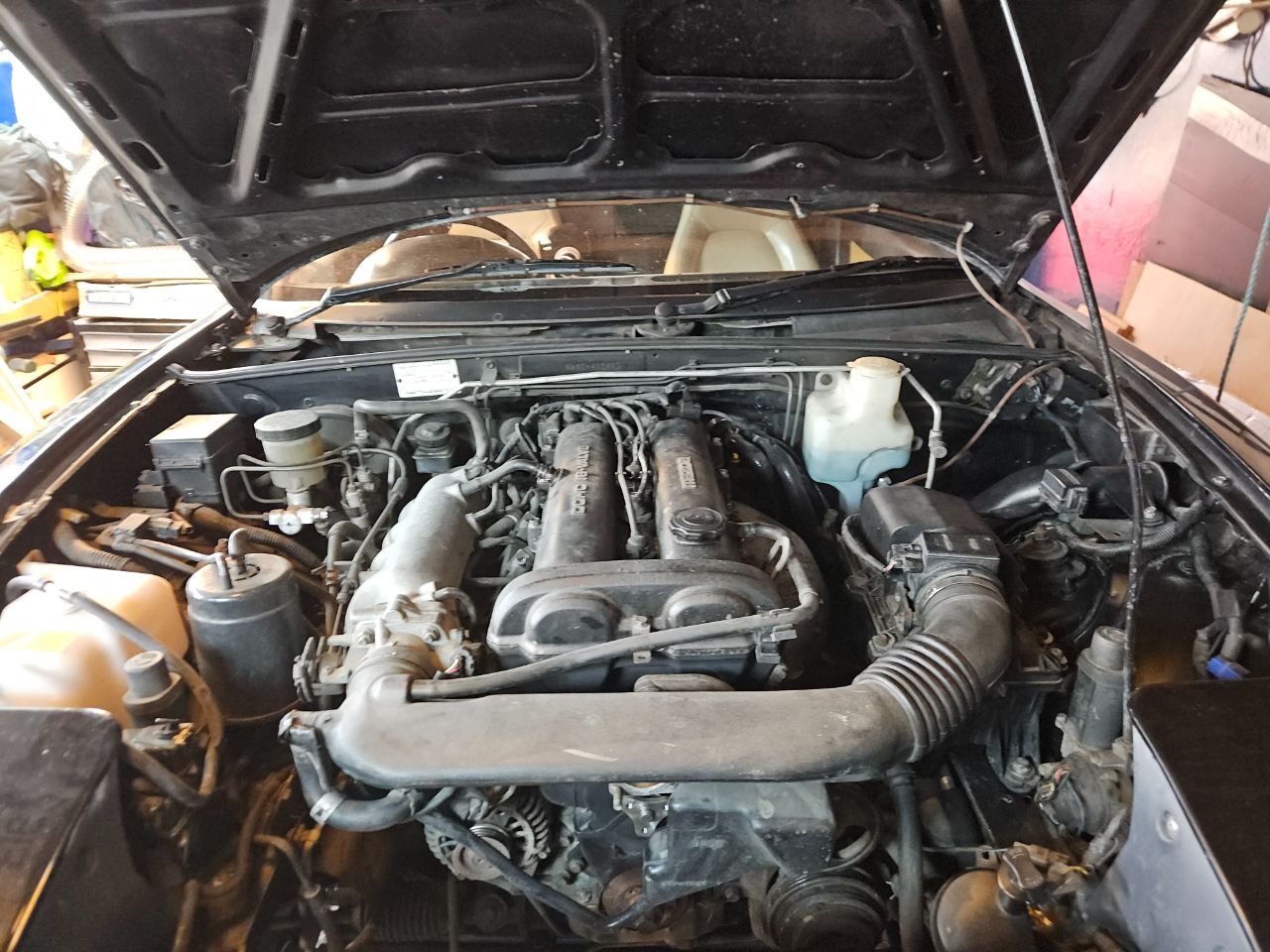

the other thing I've done is give the Mazda some attention, it was due a cam belt, the water pump has leaked for ages when parked and my wife wanted the aircon to work.  The problem with the aircon on these mk1 eunos is the condensor is nla, I eventualy found a U.S.  miata one was very similar and only £80 delivered to the UK from rock auto.  Armed with this a universal drier and some hose fittimgs from car builder solutions and a splice frpm Amazon U.S.  I set to.
cam belt / waterpump went as per manual with no issues.
old condenser was pretty knackered though
new one fitted directly to the cbs drier at the top and had to be spliced to the original hose at the bottom, I made a new #6 rubber hose to join the drier to the car feed line.
(pic is upside down red splice is at bottom new hose is cpming from drier at the top) To be honest I wasn't expecting much but it held a vacuum so I introduced some R290 (otherwise known as Propane) as a trial to see what happened.  Lo and behold it worked and after 6 weeks still is!

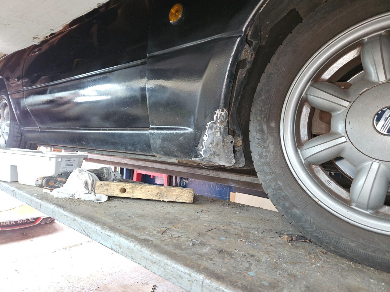

spurred on by the above I set to fixing the only significant body issue, rust holes in the bottom of the wing where the mudflap once was.
next made a masking tape 3d template
set to some steel til I had this.
20250609_194450.jpg.dc5216ebf6fd078b6d560db469ed69ec.jpg20250609_194532.jpg.0f262b7246a3727067080f3340e35828.jpg
welded it in
primed, stone chip and topcoat.
20250611_185211.jpg.1e3aa9423f532951368f291c76f0f03b.jpg20250612_113606.jpg.58e17c89a45e17a1047ae642570fd582.jpg

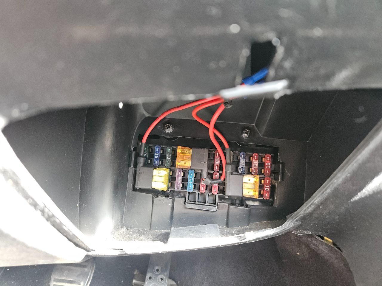

Street ka MoT'd only thing it needed was tyres, one failed on a cut and the others were getting towards the end f their life, I also finaly wired the heated screen in the hardtop up and gave it a coat of underbody wax.
Used Piggy back fuses rather than cut into the loom.

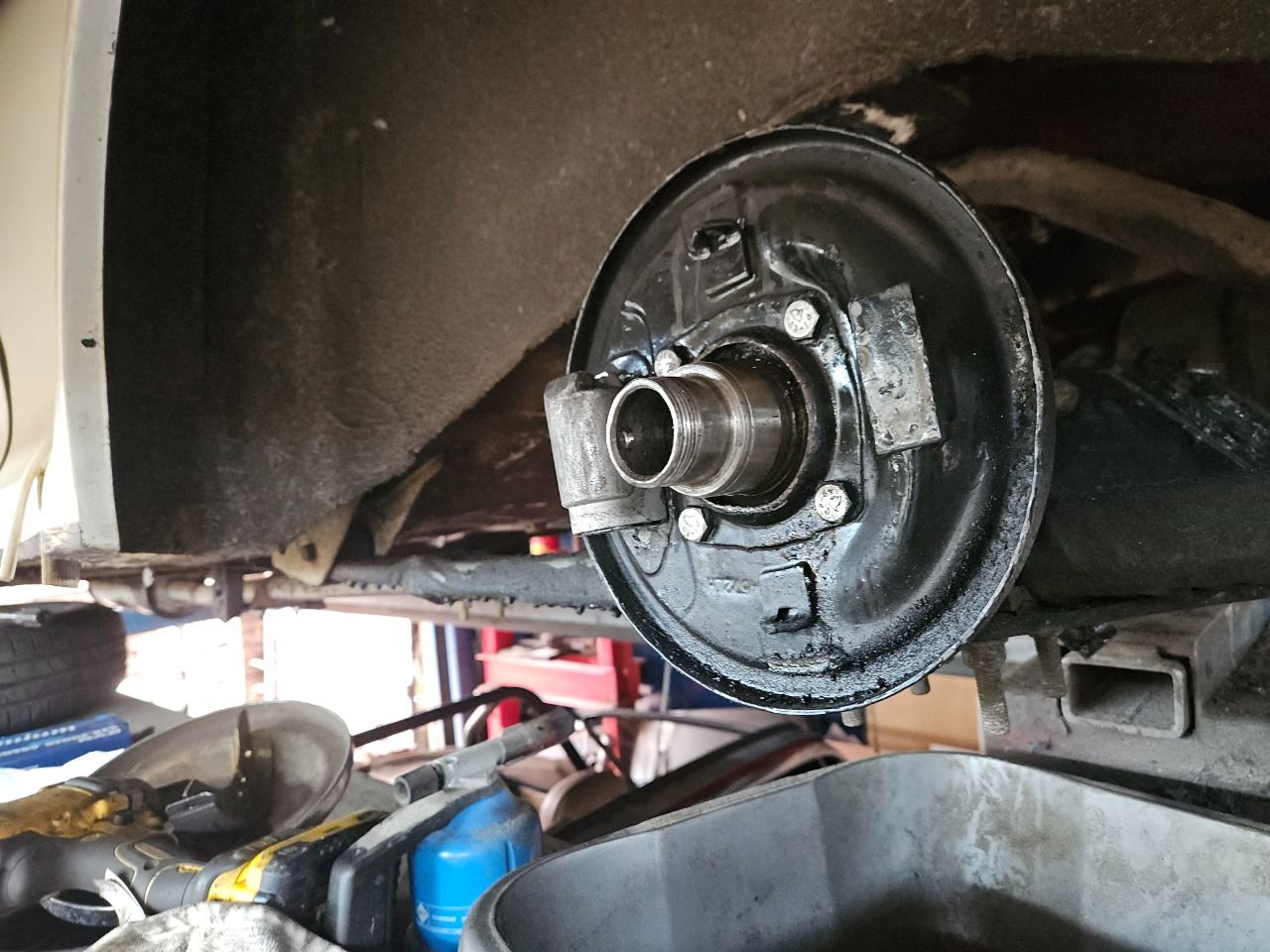

finally the minor, been busy on this, replacement traveller 7 leaf  springs,  telescopic dampers and poly bushes on the rear. currently fitting new poly bushes on the front and raising the ride height one spline as its only a few mm off the bump stops.
Ride height with new rear springs, happy with that.
Also fitted a speedi sleeve to the axle as the hub seal kept leaking.
Speedi sleeve. Wow, ive used them at work but never in that small an application. Generally we prep a seal land in a lathe, metal spray and then grind back to a size. Not really an option for most of us with the car job mind.  Good to know SKF are doing this stuff for automotive.
East sussex minors sell them for virtually every leaky seal on the minor, I've also fitted one to the crank pulley on the TR7V8 a couple of years ago which seems to have stemmed its incontinace.

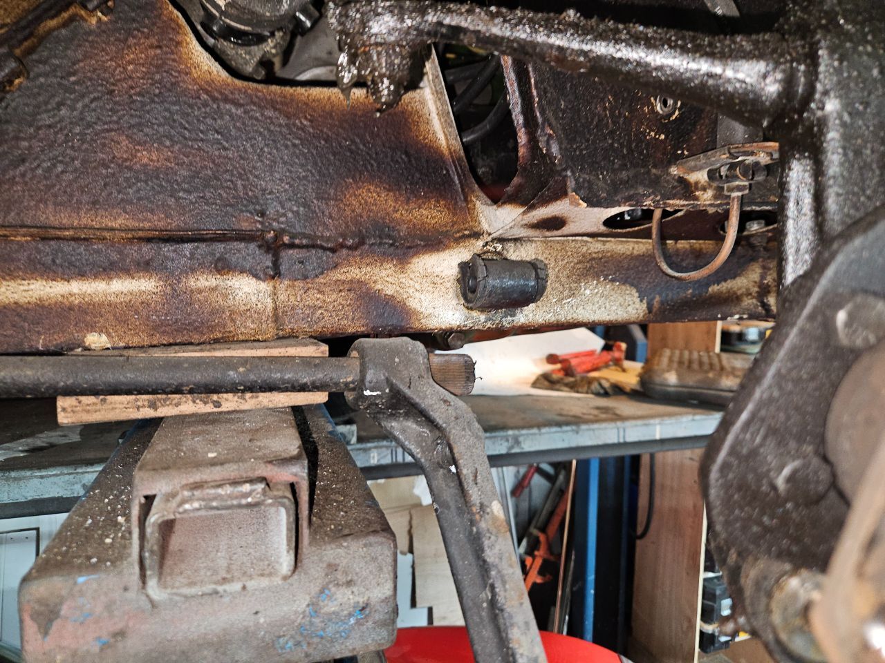

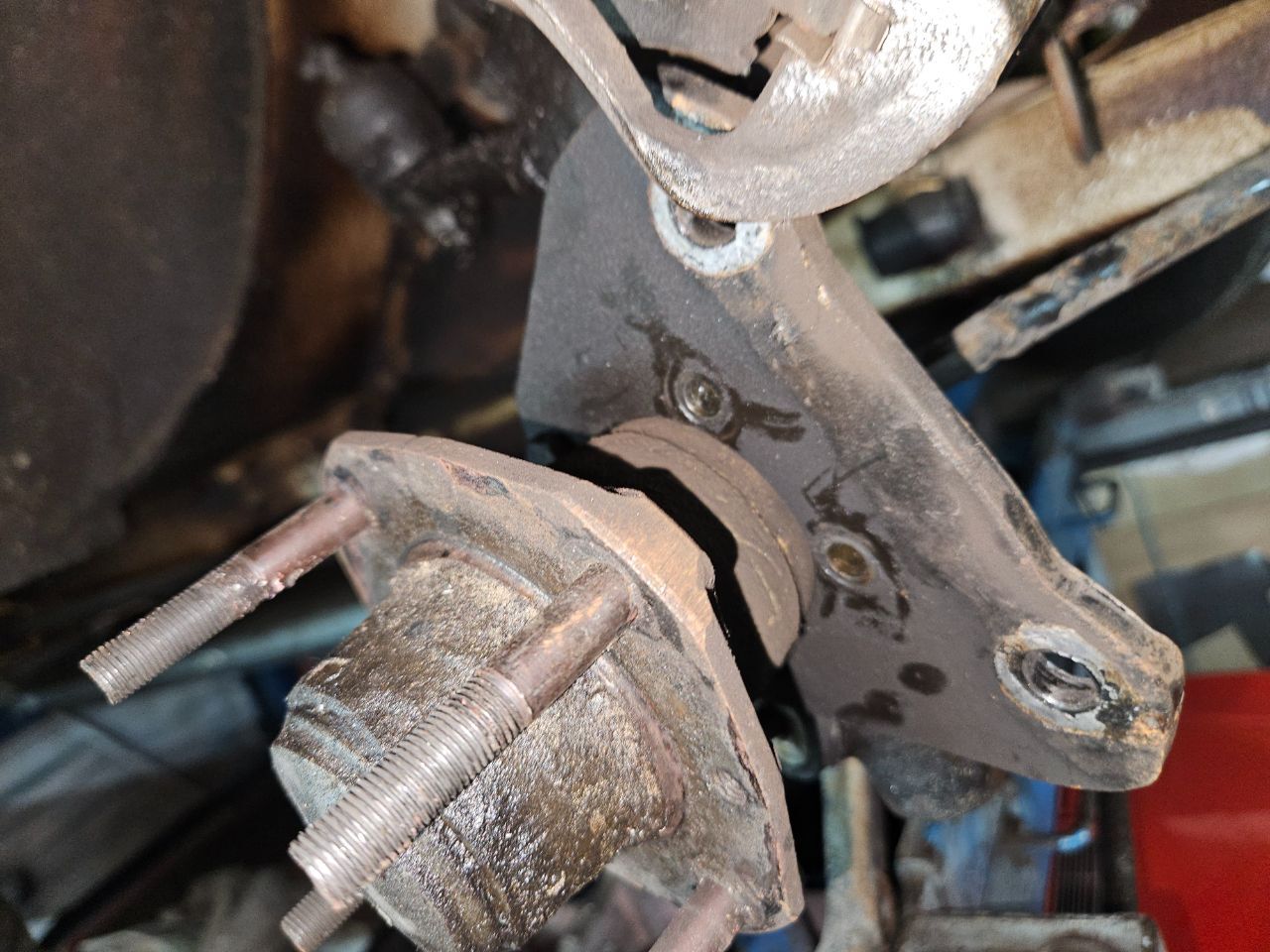

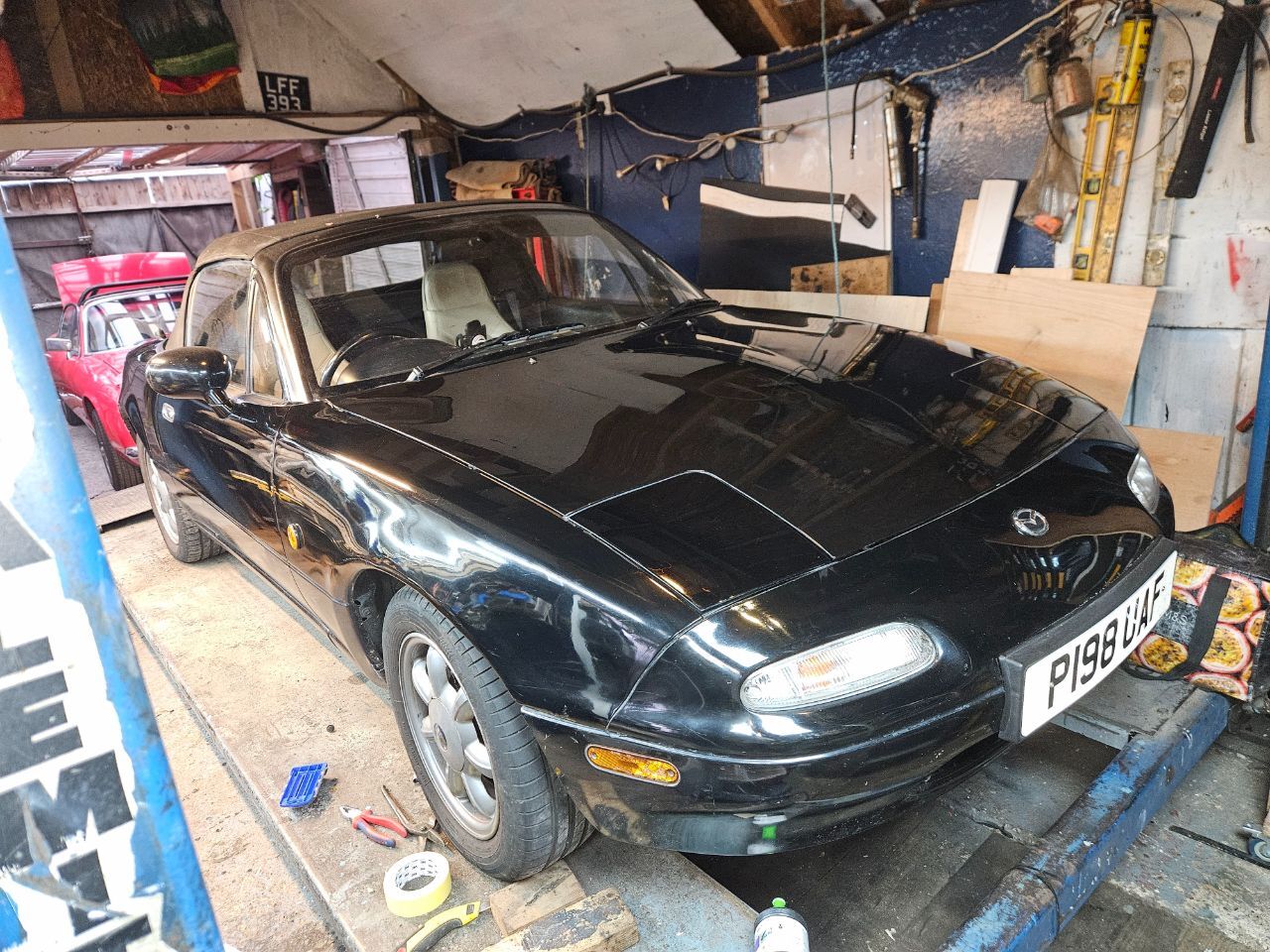

Anyway, thats all history, I've been busy on the minor, all the front bushes replaced with poly.
Found the cause of the knocking under braking, the brake caliper bracket bolts had lost tension (I'd removed them in picture) , I think it was due to paint, so I cleaned all the paint off and fitted new high tensile bolts.
Also tried adjusting the torsion bars up one spline but it was too high so I've put it back where it was and  I'll have a go at using the intermediate adjuster on the centre crossmember.

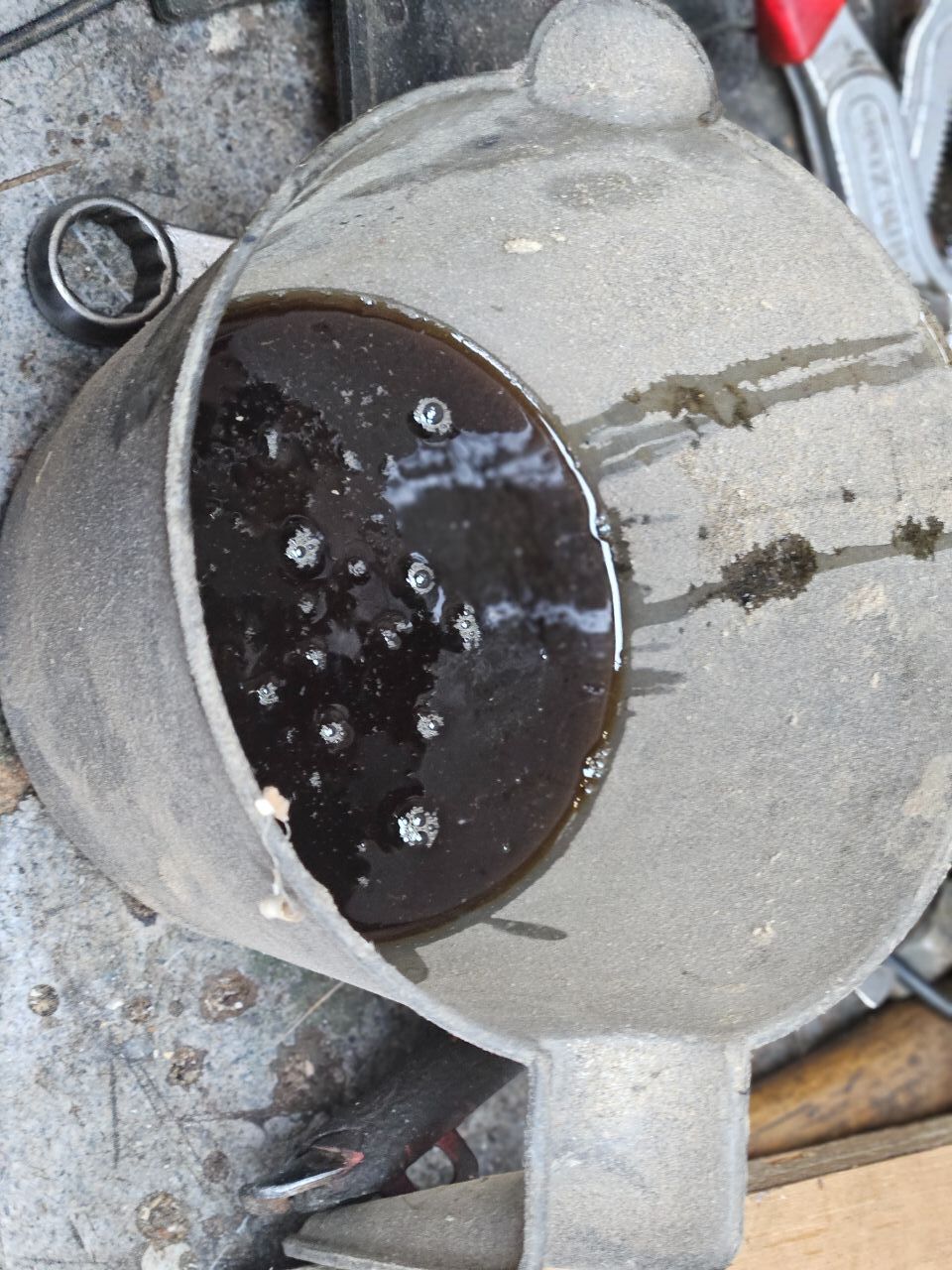

Today I looked at the dissapearing brake fluid, as there were no external leaks and we've always had an issue with white smoke at idle I theorised it could be the servo.  Took it off today and this is what was inside it.
at least half a litre of brake fluid, it looks like my theory was correct.  For now I have just joined the two pipes together and I'll see what its like without a servo.

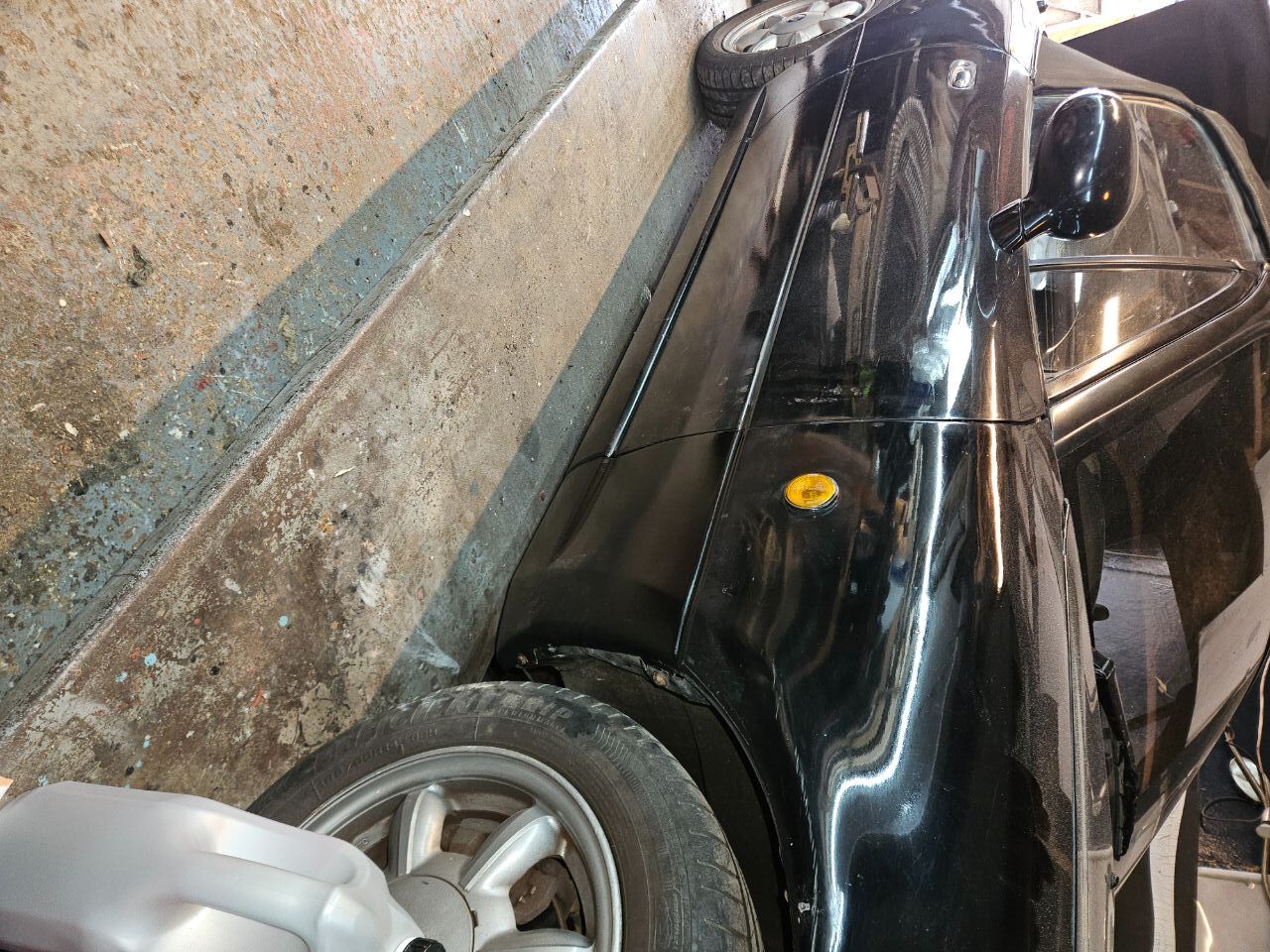

Easy mistake to put the wrong nozzle in with them both having the green sticker.
I always have a panic on filling with vpower unleaded, the vpower diesel looks similar at a glance.
