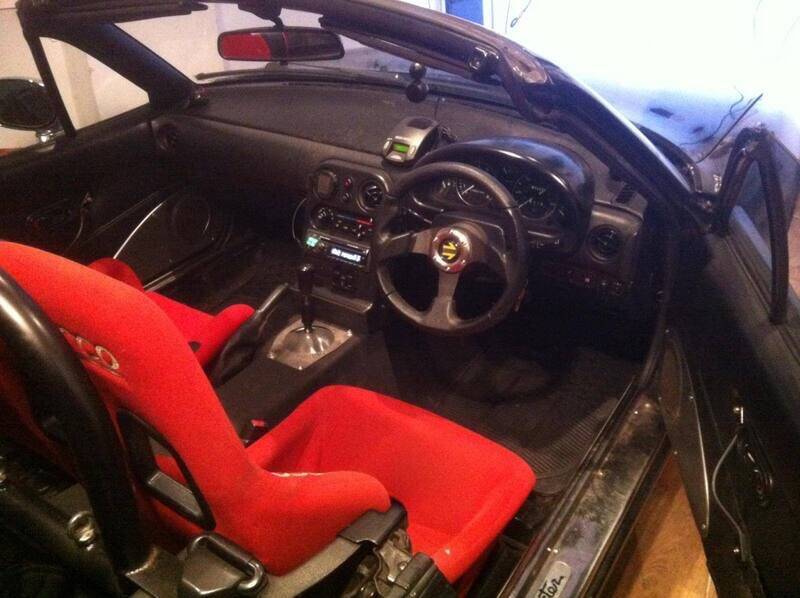

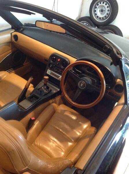

motorpunk Posted January 26, 2024 Posted January 26, 2024 On 17/12/2023 at 23:08, kevins said: Next was the Mx5 (more accurately a Eunos Roadster) as it is a grey import. we got this in 2015 when my daughter passed her driving test, she drove my company car which was insured for her anyway and my wife bought this with what would have been the insurance cost for a car for my daughter. Aside from service items a clutch, a new soft, top and some accident damage when a gate post stepped out into the car it's needed nothing else, it's a great little car that my wife used every day and we have been all over the UK in it, a couple of months ago we retired it from daily winter use when we got the fiesta but it will continue yo be used all summer. plans for the future are to change the cam belt, repair the air con, and fit new seat covers, There are also a few bits of bodywork which could be improved. That looks like a V Spec car, very desirable if you keep it as standard. Loving your fleet 👍🏼
kevins Posted January 26, 2024 Author Posted January 26, 2024 Yes it is a V spec, we plan to keep it pretty much standard, it does have a mk2 hood with the glass rear window and some black bits of trim to break up the original tan (somewhat orange in places) everywhere colour. It gets well used so is far from perfect but I do seem to be managing to keep the rust at bay. On the minor , over the last couple of days I have knocked these up to go behind the carbs The countersunk holes will have countersunk 5/16 unf bolts welded in them then we will forge a couple of bars to go down to this boss (the one just below the fuel pump blank). Also continued striping the cream paint off the mazda, it was never supposed to be this colour, and we are going back to tan and black, later this year I'm going to blow some of my redundancy on new tan leather seat covers too. before. During After rainagain, mercedade and Matty 3

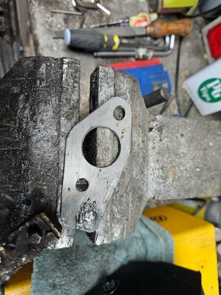

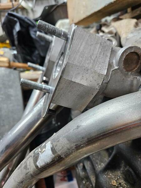

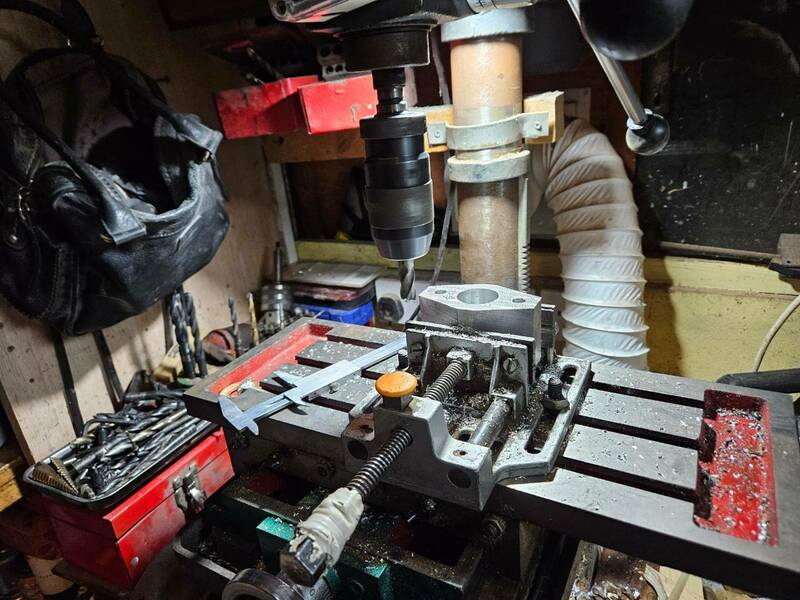

kevins Posted January 28, 2024 Author Posted January 28, 2024 Not much free time over the weekend but I did get round to milling the carb spacers down to accomodate the support brackets and gaskets. I've had a cheap chinese 2 axis table for a couple of years and decided to turn my pillar drill into a mill for little jobs like this, drilled and tapped the taper to lock the chuck in and tightened all the other adjustments up FT. At first it chattered badly but that was the milling table leadscrew nuts loose on the frame, tightened and loctited these and it worked a treat, only taking about 1/2 a mm at a time. I'll experiment different speeds and depths on scrap once these are done. It needs something to keep the table in the same orientation as you raise it if I want to cut a slot and the bearings may need re-engineering at some point but for the moment It does the job all be it slowly. Dyslexic Viking, Matty, mercedade and 1 other 4

kevins Posted January 28, 2024 Author Posted January 28, 2024 Thats a Maestro 1275 that one day we plan to build up with a mx5 gearbox to go in the minor, I'm using it as a stand to build the carbs up on as it's been sitting on the engine stand in the corner for a year or more. The carbs at least initialy are going on the tweaked 1098 that is currently in the car. Matty 1

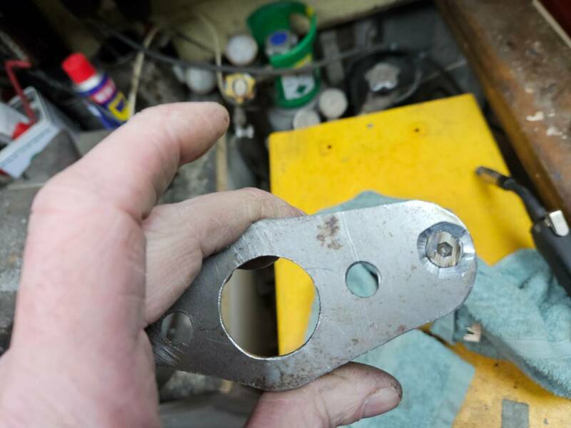

kevins Posted January 29, 2024 Author Posted January 29, 2024 Finished milling the spacers today then used the belt sander to round the corners off. before that I finished the support brackets. cut the head of a countersunk screw down and secured it to the bracket with some washers and a nut. 8 then welded it in and ground flush test fitted. Also realised the engine block in the car doesen't have the boss tapped I plan to use, I will use the stud on the fuel pump mount instead. Dyslexic Viking and mercedade 2
gm Posted January 30, 2024 Posted January 30, 2024 On 26/01/2024 at 19:40, kevins said: Yes it is a V spec, we plan to keep it pretty much standard, it does have a mk2 hood with the glass rear window and some black bits of trim to break up the original tan (somewhat orange in places) everywhere colour. very similar to how my green v-spec looks the black one was also a v-spec but i did this to it great little cars mercedade, rainagain and DVee8 3
kevins Posted January 30, 2024 Author Posted January 30, 2024 Ours is basically the same but it doesen't have a wooden steering wheel it has the leather momo one. Got quite a few things to do to it this year, Cam belt, Fix A/C (fit aftermarket condenser, drier and make suitable pipes), re-cover seats, attend to some surface rust in rear arches (done one already), rust proof it again, re-cover seats and possibly change or repair the front wings (they have rusted behind where the mudflaps were). Probably will end up only doing half of the above and just driving it though!

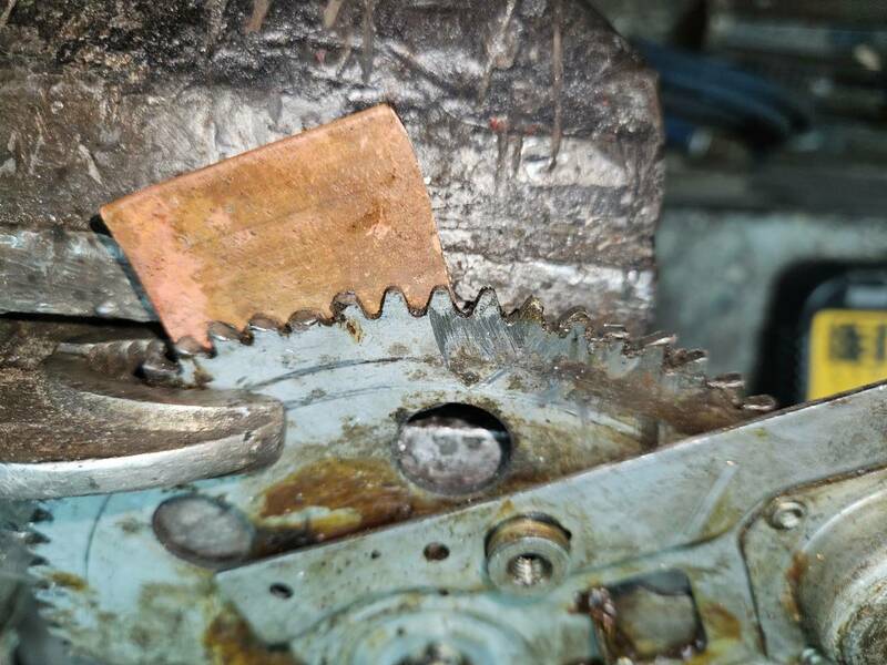

kevins Posted February 14, 2024 Author Posted February 14, 2024 there was the problem with the TR window regulator failing to rise to the occasion, pulled it out and the issue was fairly obvious. so cleaned it up clamped a piece of flattened copper pipe under it, then built it up with weld. using a combination of the grinder and file got the arc and thickness OK. then just a matter of re-cutting the teeth using a slitting disc and files. seems to work OK, just need to shuffle the cars around so I can re-fit it.7 auntiemaryscanary, mat_the_cat, catsinthewelder and 10 others 13

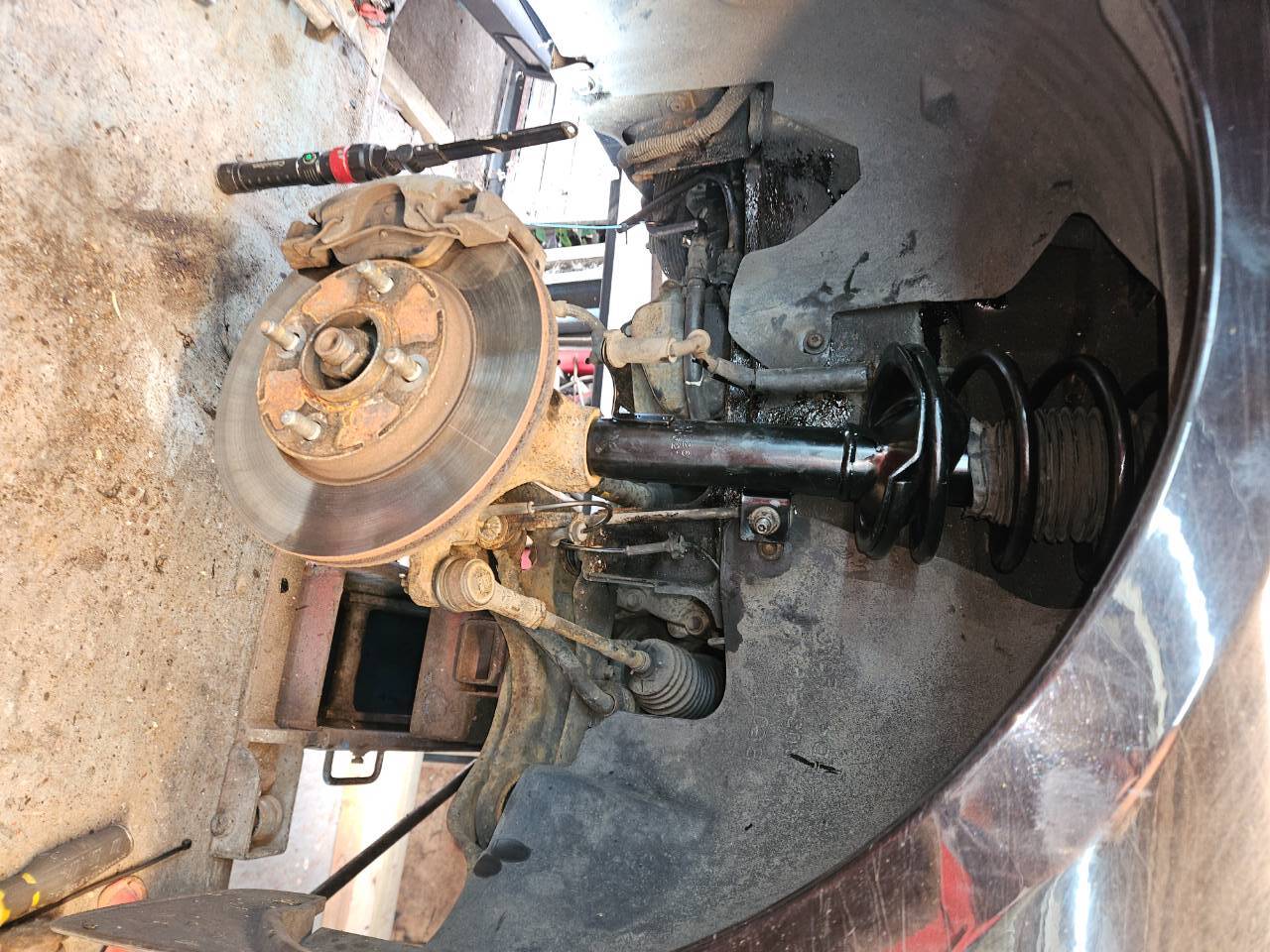

kevins Posted May 27, 2024 Author Posted May 27, 2024 Think the fiesta may also need new lower control arms, noticed today you can get the heavy knock when parking against a kerb, they have been replaced fairly recently (no rust) but that means nothing with the shit pattern parts out there, I've ordered a pair of heavy duty ones from. compbrake, don't want to spend ages messing around so will just do everything which looks vaguely worn. At the end of the day we bought it instead of a new car, I could replace every bush, dampers and springs for less than a couple of months payments on a new one. (Springs and dampers are fairly new though so no need to do them just yet). Also thimking about outing the 16" wheels for 15" ones in the hope they will be more compatible with the state of our roads.
kevins Posted May 29, 2024 Author Posted May 29, 2024 Been away for a few days and thr mrs has picked up a nasty stomach bug, so with that and the need to get the bathroom done (even more so while she is spending half her waking hours in the other one), I haven't done much but I did order some new control arms, roll bar bushes and drop links for the fiesta, came to around £160 so not too bad. Also took a look at the Street Ka, excessive torque steer (and badly worn inner edge on tyre) is almost certainly down to there being no rubber left in the front control arm bush. The arm is only a couple of years old, shit pattern parts again. A new SKF one was £35 hopefully that will last a bit longer, new tyre will cost twice as much.
kevins Posted June 15, 2024 Author Posted June 15, 2024 Between fitting a bathroom and my wife catching some awful bug I've not got anywhere the cars, but necesity is means some things must be done, the Street car had started pulling violently to the right on acceleration, a quick look and it was obvious the front control arm bush was knckered, so friday morning it was time to get the tools out. As the arm was only 2 or 3 years old it all came appart easily enough, I managed to get a Borg and Beck one so hopefully it lasts a bit longer. bush doesent look to bd in the pics but you can easily move it around. Fiesta has also developed a heavy knock which I'm sure is the lower ball joints so I have 2 new arms from compsport hopefully they will last longer than the regular pattern parts. Hopefully I'll find some time this week, but the Bathroom isn't quite finished and I'm supposed to be fitting a new kitchen round the in-laws............. Matty and mk2_craig 2

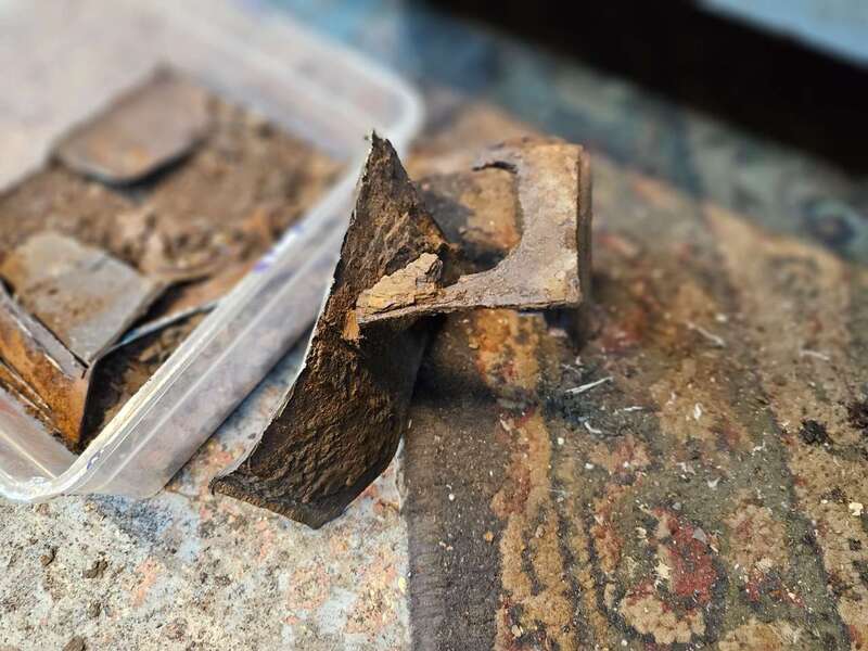

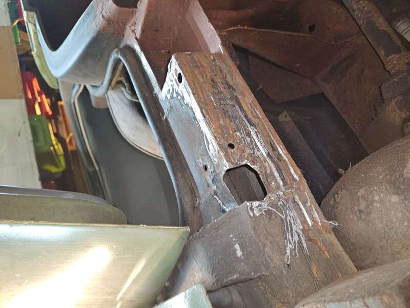

kevins Posted October 13, 2024 Author Posted October 13, 2024 The other car I have worked on is the 2010 fiesta. Firstly it was rust, I had typical "to MOT standard " repair on one sill as always this had just encouraged further corrosion, net result of chopping it all back to solid metal and replacing bottom of inner arch was. then a new outer was fabricated seam welded in and ground flat to give. 8 no idea why its rotated the pics . tht was then given a coat of epoxy and both sill stone chipped with gravitex. I'll go over it with gloss black when I do the underbody/ cavity treatment. Then it rewarded my efforts and failed the MOT on 3 of the 4 almost new tyres having cuts in them, so £200 later it had an MOT. I then found a mint set of mk7.5 half leather seats for £150, as ours were getting a bit saggy , the passenger one had some dubious stains and the drivers a burn hole I bought and fitted them. They bolt straight in but there are some electrical issues, basically its the heated seats and the airbag. the mk7 has a seat connector block with 6 individual connectors and the mk7.5 7 connectors. the individual connectors can easily be swapped beween the seats but for the airbag the mk7 uses a orange connector and the mk7.5 a yellow one (I believe in some markets the mk7.5 used the orange for pyro seatbelts). Fortunately it's pretty easy to de-pin the connectors and fit the orange housing to the mk7.5 seat, with that all the airbags etc work fine. the heated seats are another complication, basically they are completely different, the mk7 uses a switch in the seat which directly controls the heaters the mk7.5 a temperature control module on each seat and temperature selection switches on the dash, the mk 7 is also fused at 7.5A for both and the mk7.5 15A each. The result of the above is I am going to have to make a new loom just for the seats which takes it's power directly from the battery via a relay switched by the original power supply, probably only a couple of hours work, just need to find the time. Only other things are the climate control didn't work, easily fixed with a £30 interior temp sensor, and it's started throwing up faults on cold mornings with the throttle pedal (clears with a key cycle). I've bought a secondhand pedal 8to try but notice in Forscan it says the ECU voltage was only 11V(on key on before crank) when the fault was set so it could be the battery too. Semi-C 1

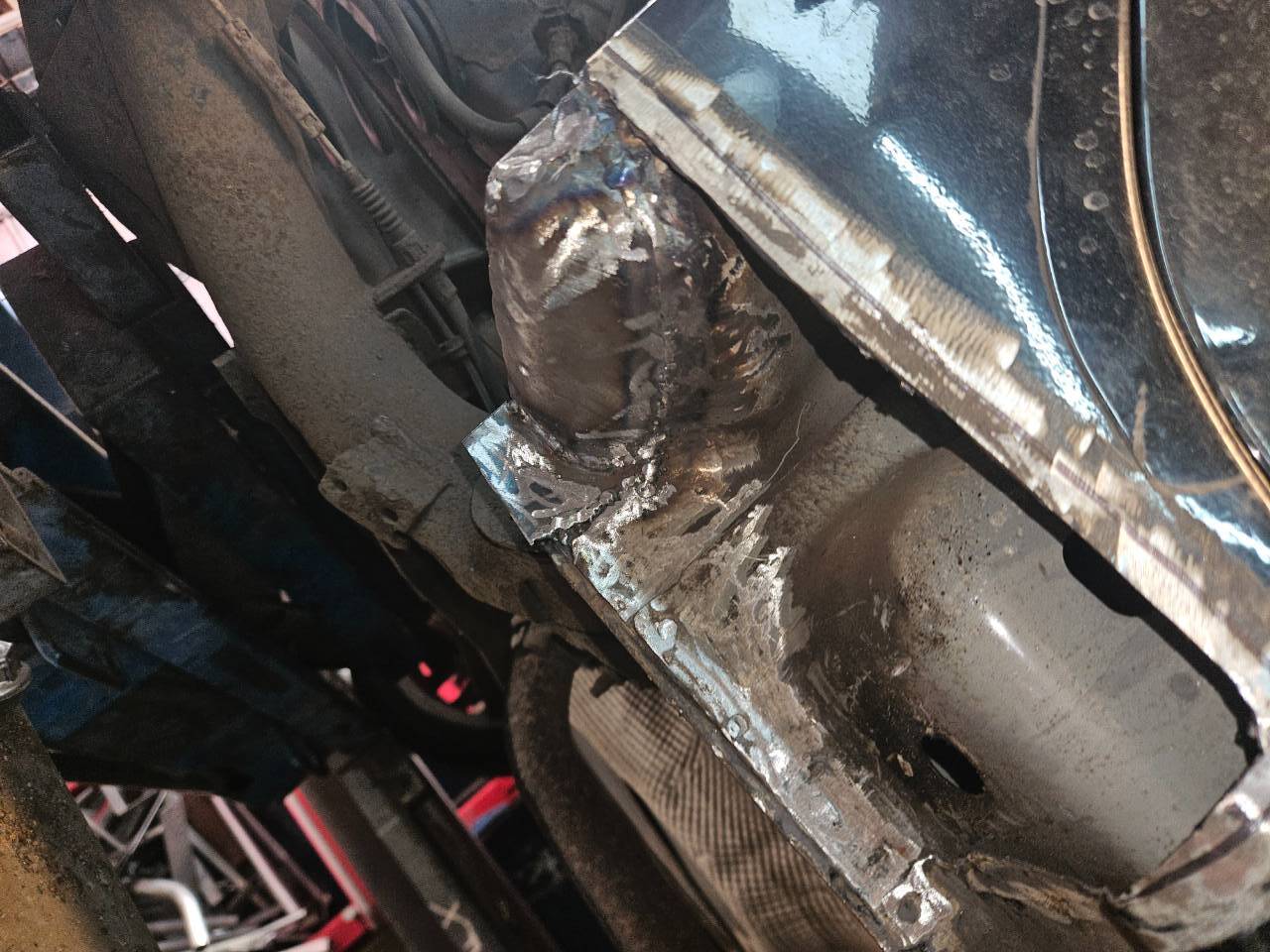

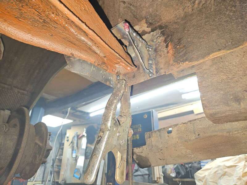

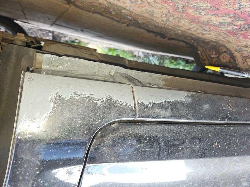

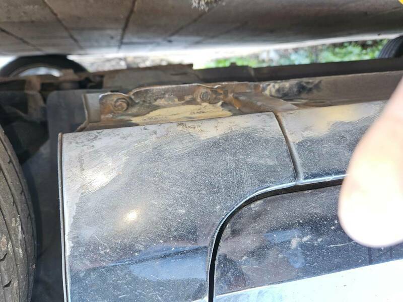

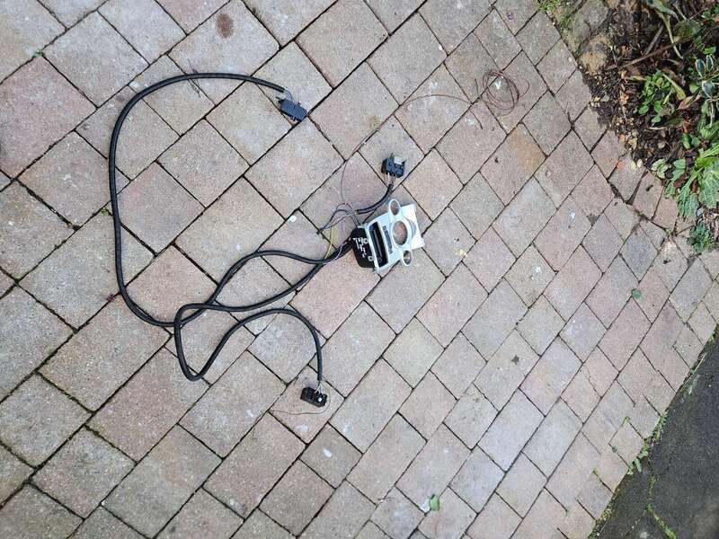

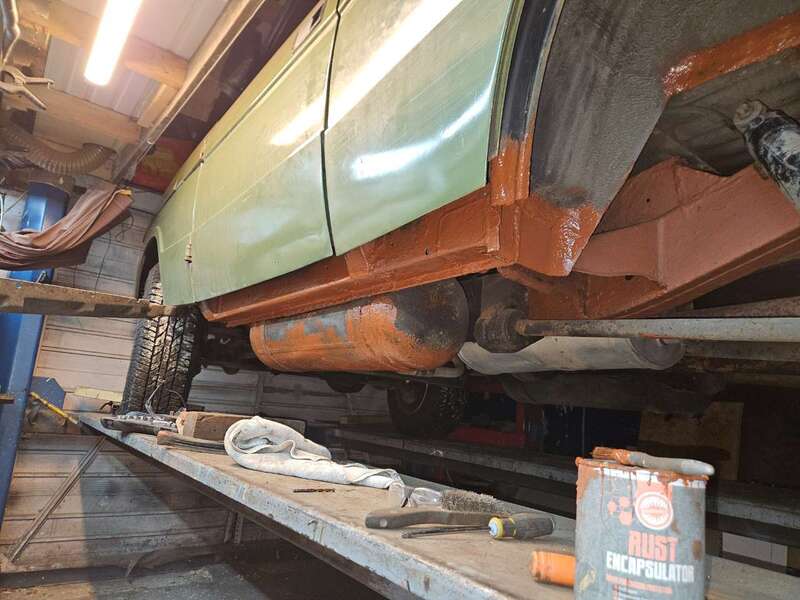

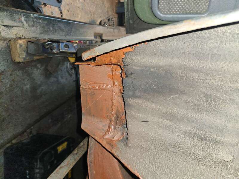

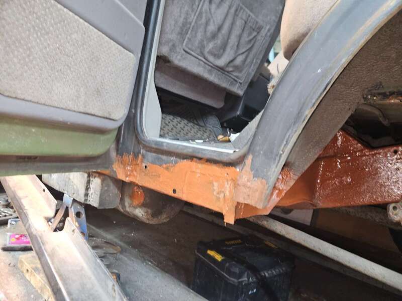

kevins Posted January 12 Author Posted January 12 slow progress, the heated seat wiring on the fiesta is almost done, This is the wiring loom I've made. its now in the car just need to route the main power feed to the battery and connect it via a fuse. did do some work on the Range rover prior to its imminent MOT. issue was rust around the body mount at the rear of the sill on the LH side. after it was cut out. new part made. all cut out. new parts welded in a small hole was also found at the base of the B pillar. repair sections made and butt welded in whole lot painted. Can't see any other major issues (this was an advisory last year) so i'll get it booked in and see what it throws up. also bought some new wheels for The TR, have some new tyres, just need to get them fitted. Marshall2810, mercedade, High Jetter and 2 others 5
