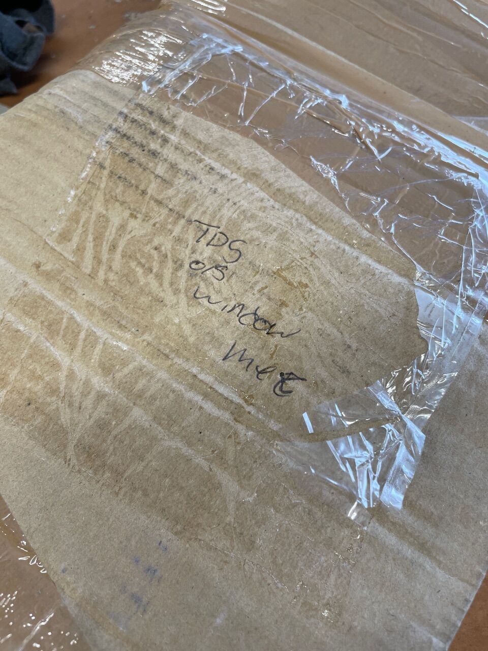

Now, this car came with a box of spares, so instead of ordering a new one, let’s check that box first.
I don’t believe it…..
but I gots to, I’m looking right at it!
you little beauty!
winner!!
without further ado, I pulled the only regulator out.
the plug was missing, have I worked on this before?
nope. Oh well, everything refitted and attempted to fit the door card but broke the lock rod off. Found a spare green toggle thing and broke that off too! Running out of ideas, I found a spare door lock and luckily it had a good one fitted! Can’t believe I broke it twice.
hopefully tomorrow’s run to work starts ok and doesn’t rattle!
