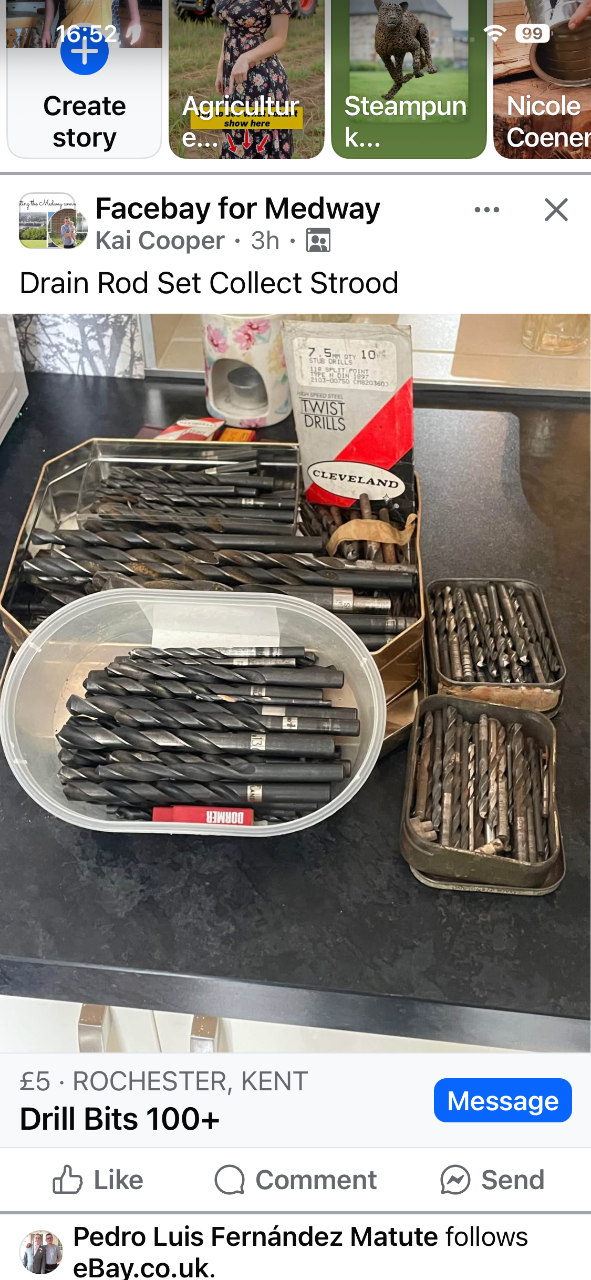

I also collected a Marketplace purchase after the paint shop.
I paid £5.00 or $6.50 for this whole lot.

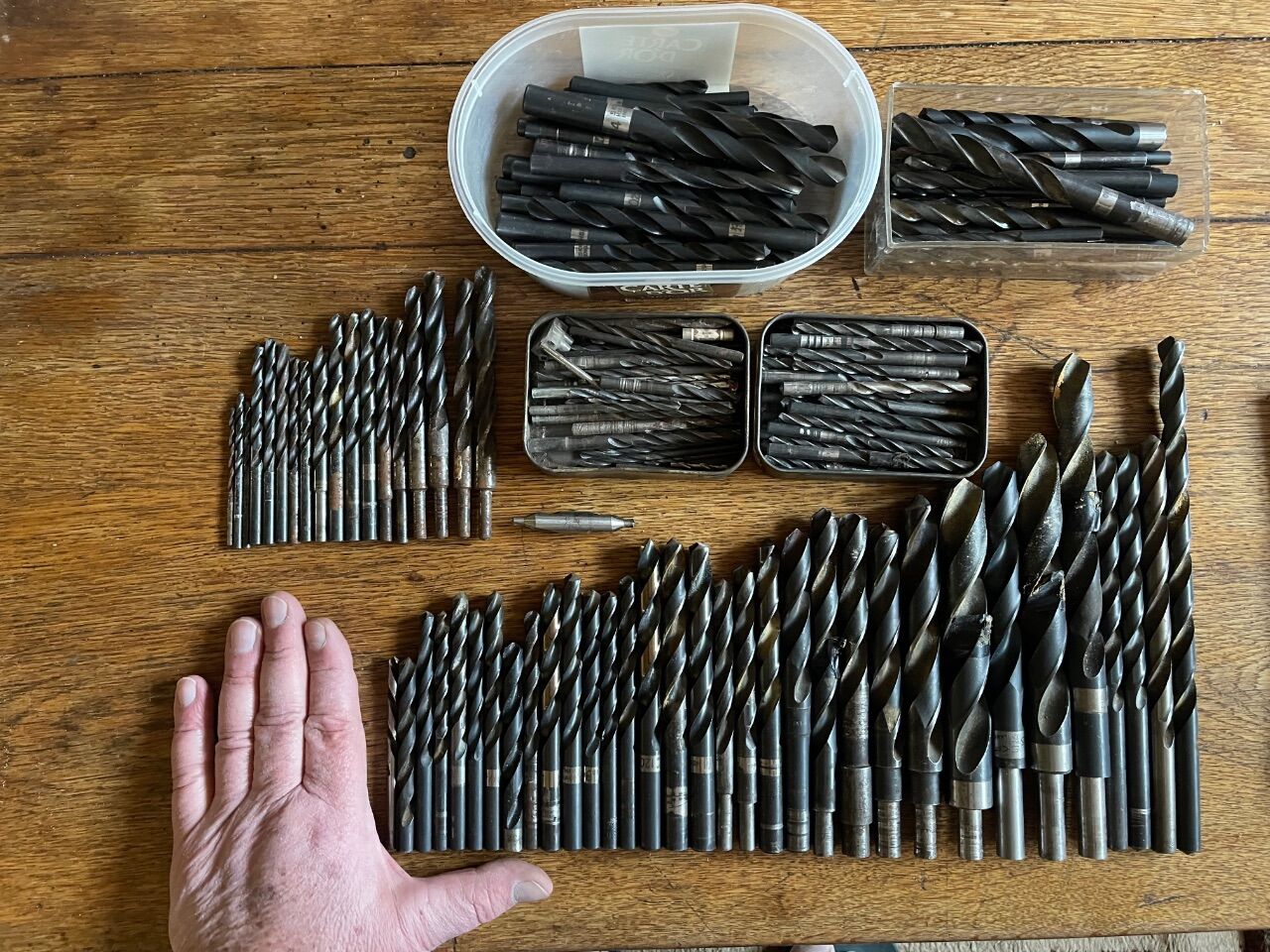

Mostly New, Unused and clearly came from somewhere that they bought in multiple sizes.
Over 100 drill bits in this lot, which means I paid around 5p per unit, regardless of size.
Comments on other forums sometimes bring more clarity and information.
Check out these two screenshots.
Open the photos and read the content, then pick up your jaw…….
I started counting and there’s way over 100 of them.
Mostly unused.
I think I may have bought the deal of week.
If you look at the other screenshot further up, the description was completely wrong, so maybe that helped, or else less people do their own engineering and repairs.
Chuffed for sure.

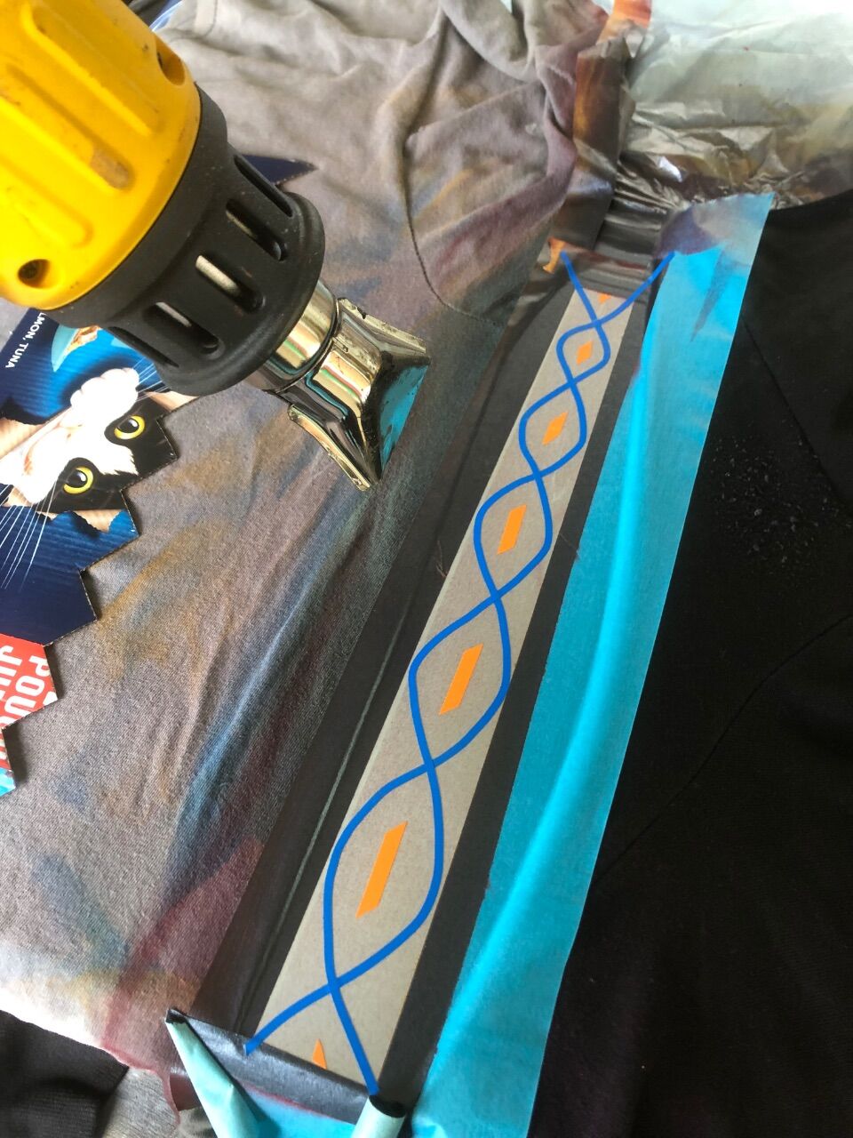

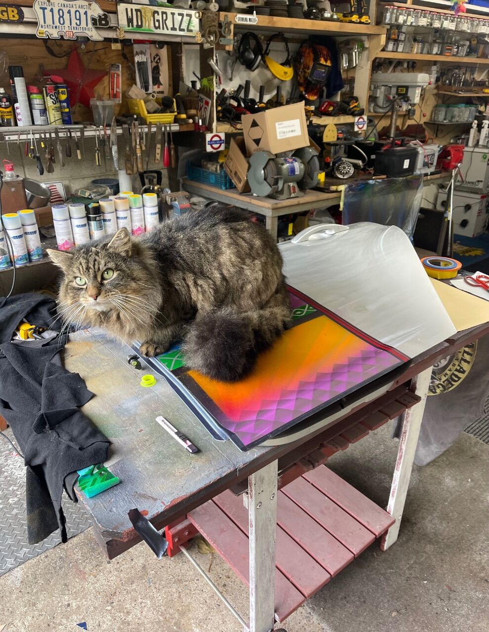

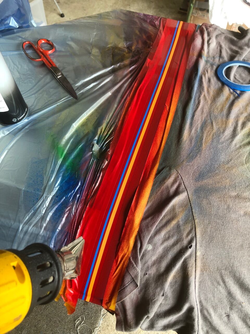

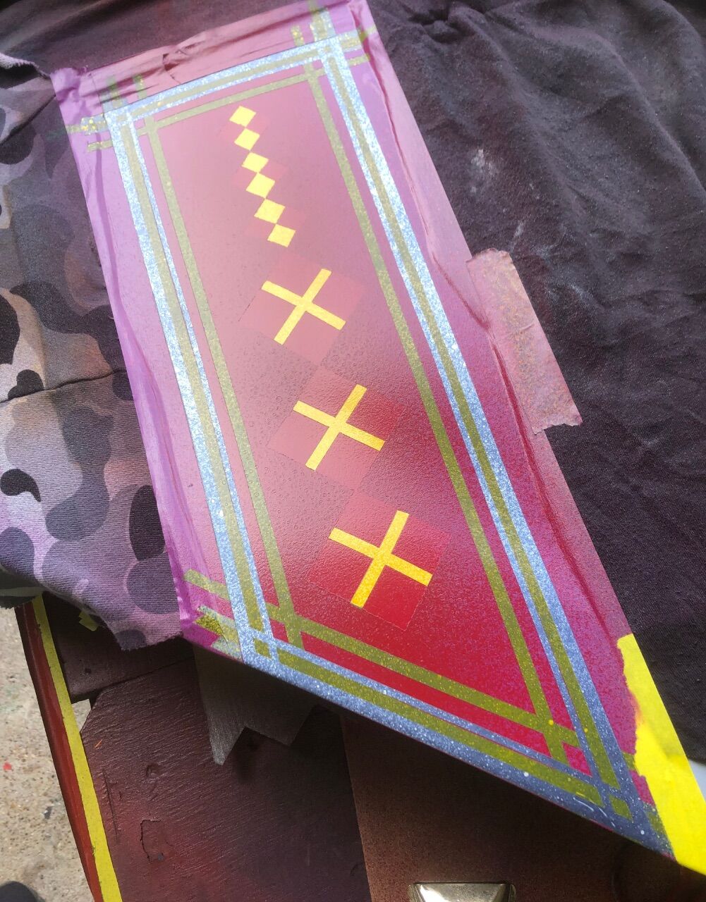

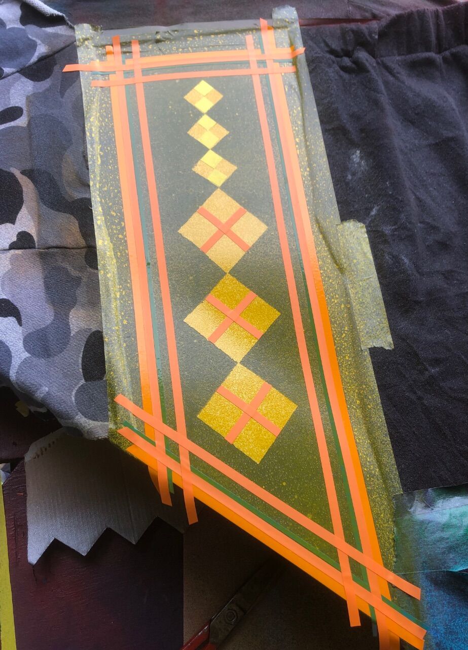

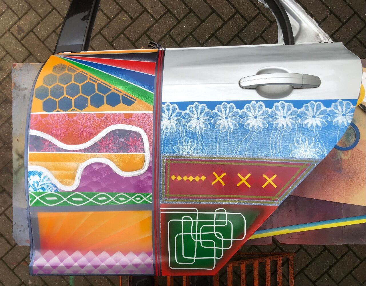

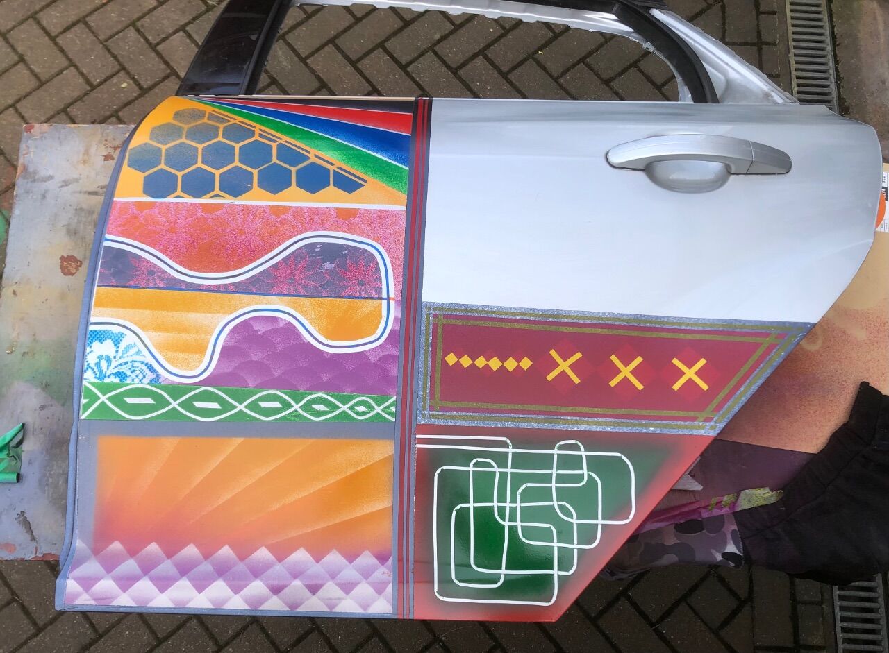

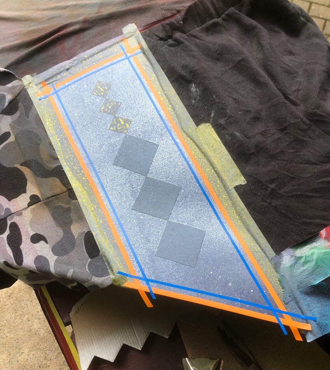

So yesterday I tried out a few more “techniques” to get an idea of layered masking. One of the things when you look at lowrider paint, is the complexity of layers. This means layer upon layer of masking

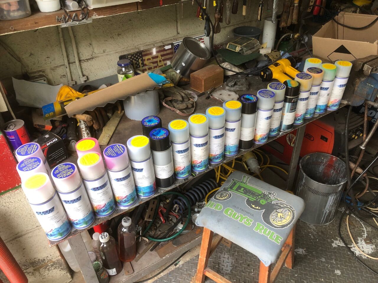

First load of pictures shows my stash of 23 cans of paint  At £1.20 each, quite an investment .
And some of the masking done
  • Like 7

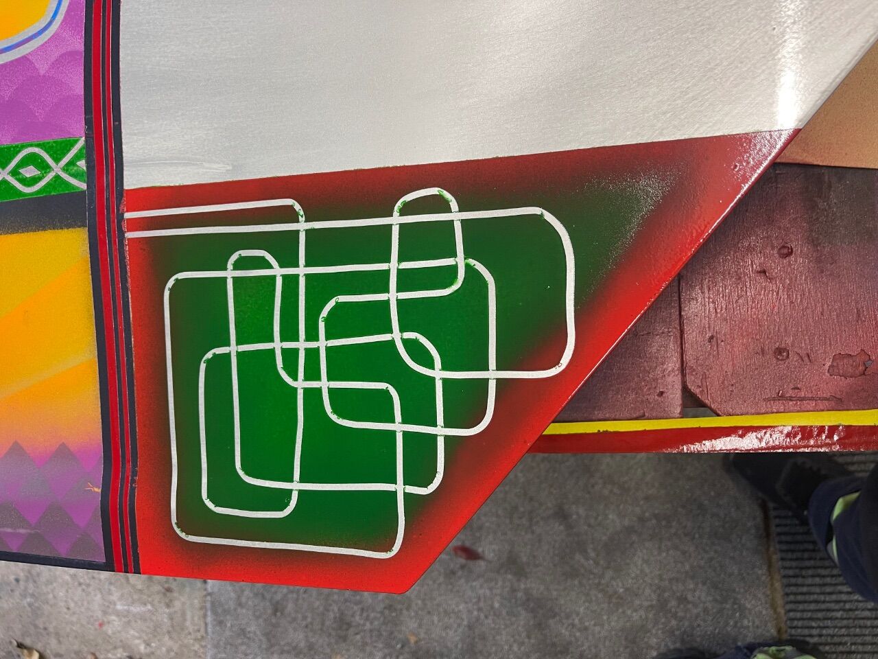

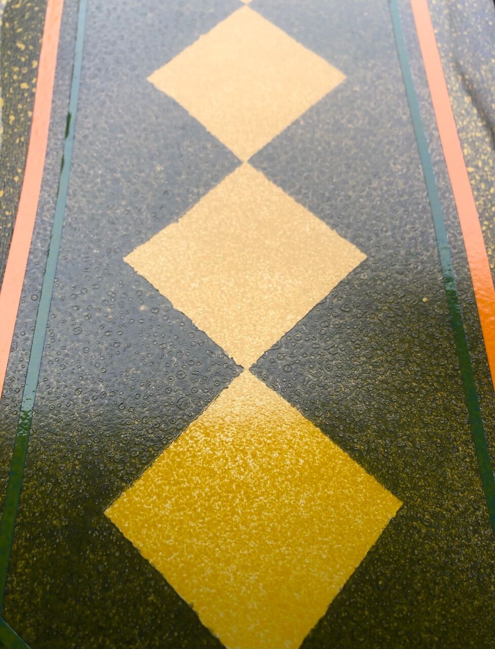

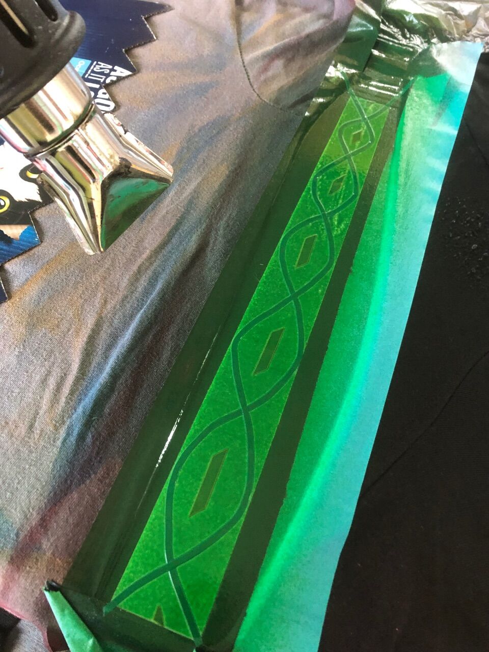

Few photos of the bits that I had done minus masking.

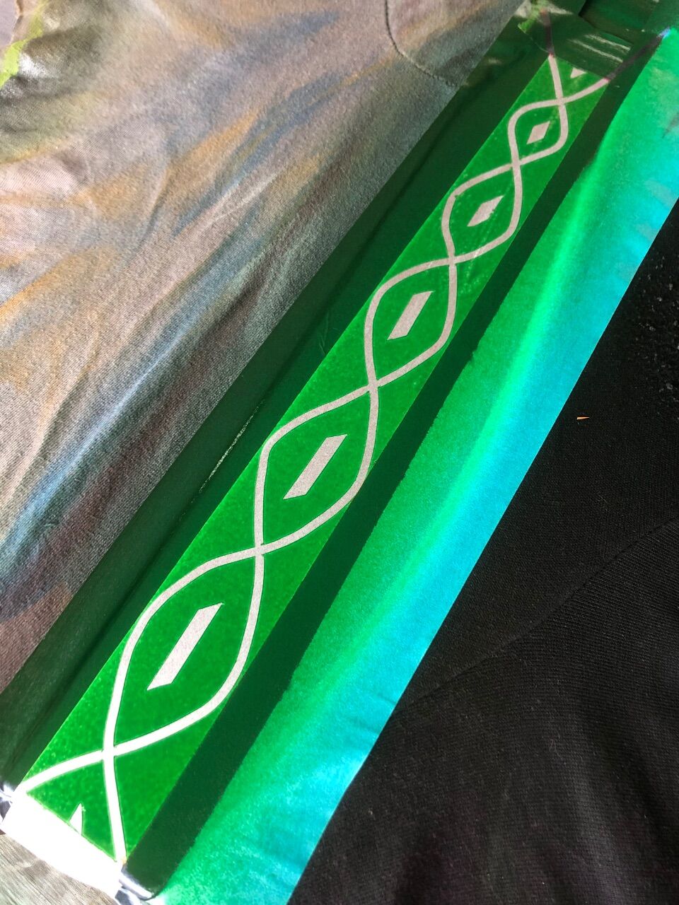

My favourite continues to be the continuous line or infinity line.
The problem as you will see is that the vinyl tape and cold, along with tight curves, doesn’t quite work.
But it works well for illustration of what I want.
with an airbrush gun the outcomes are very different.

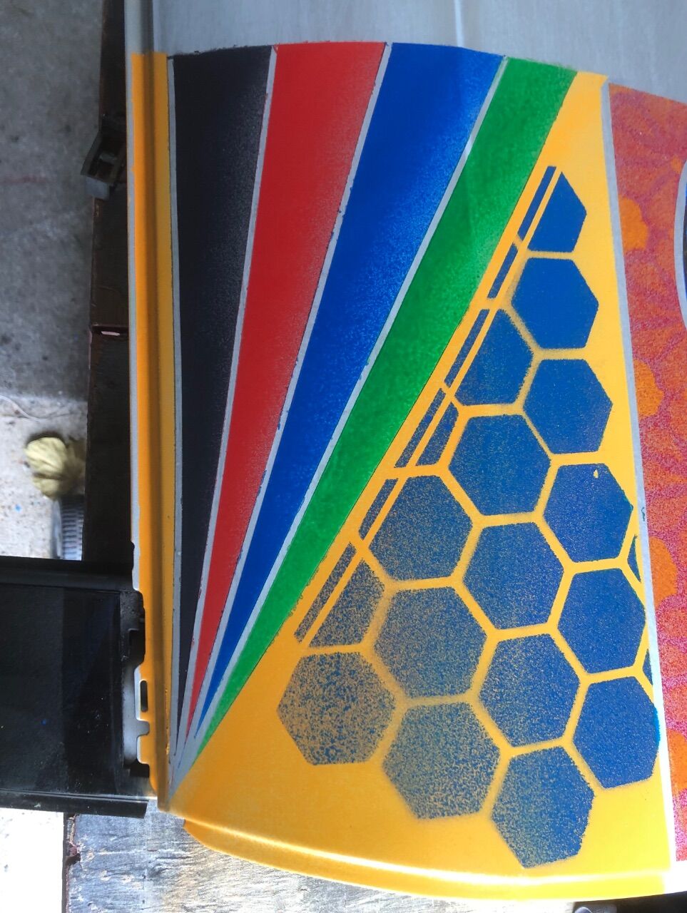

I also used the new honeycomb stencil and a fade.
I like how it works.
And at £12.00 it’s an expensive piece of kit.

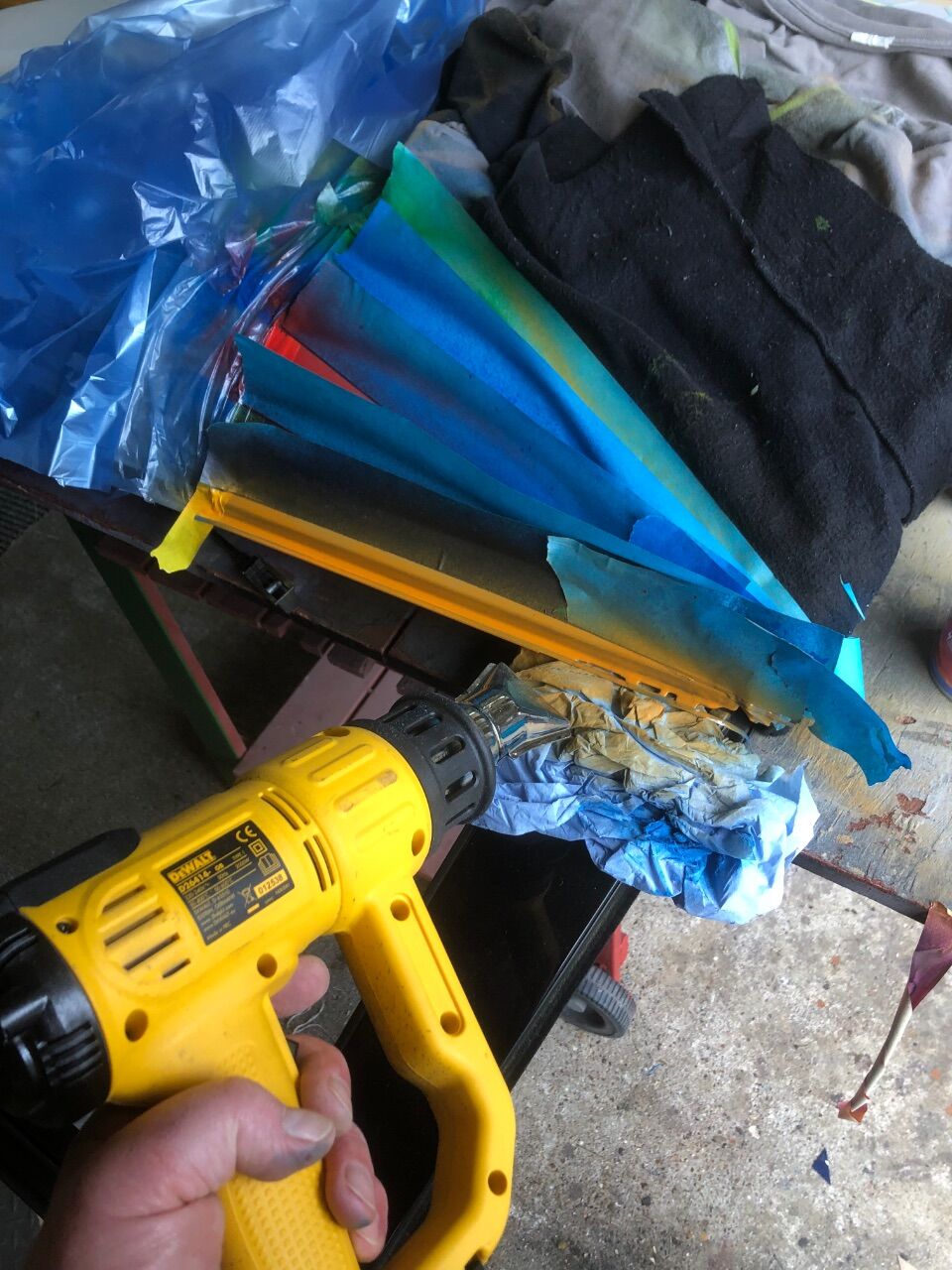

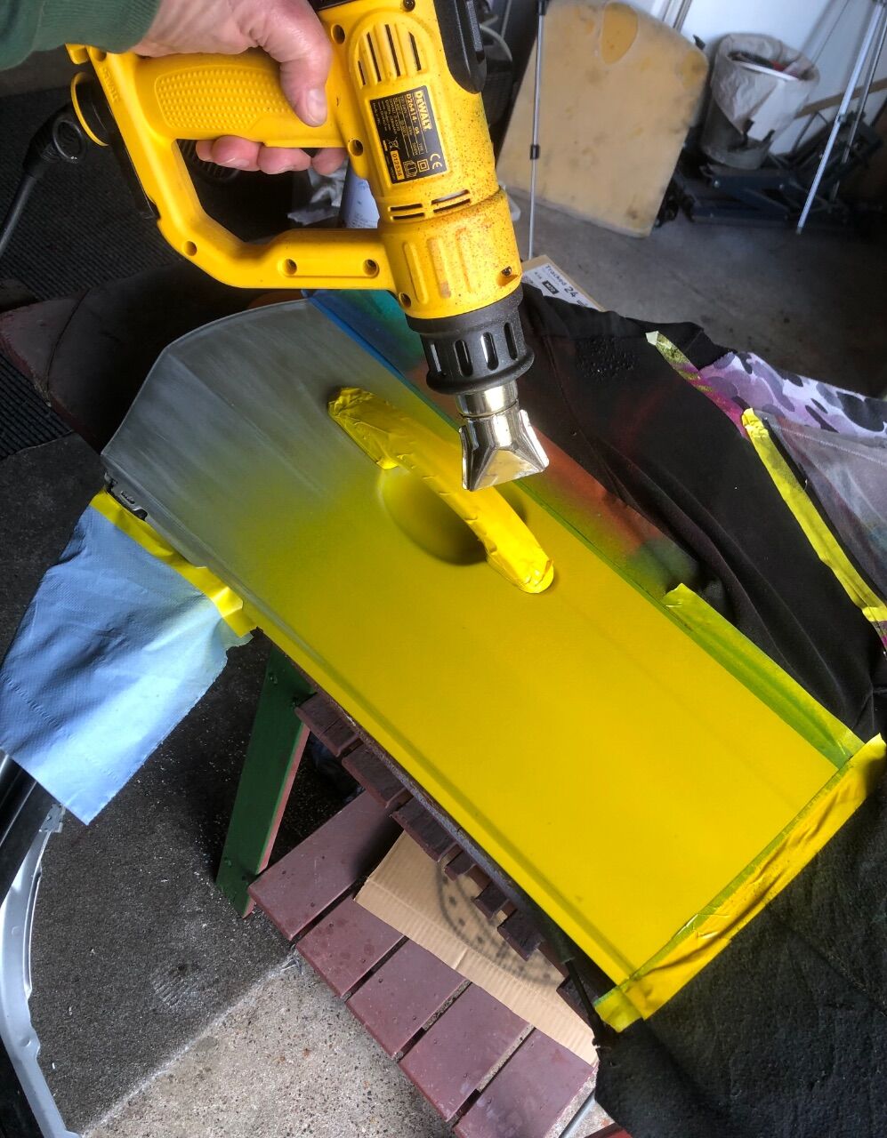

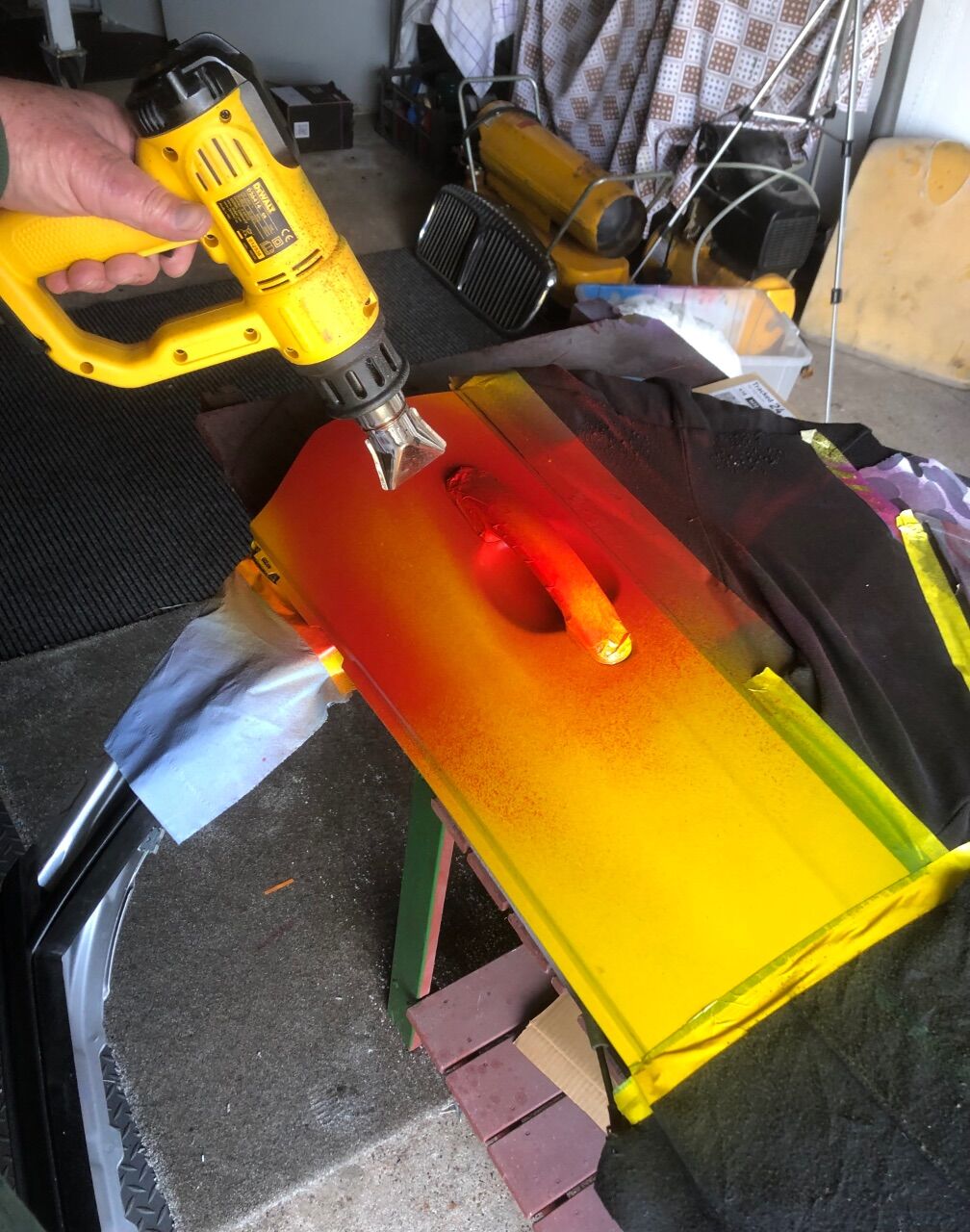

I used my Dewalt hot air gun all day to  preheat the metal, dry the layers of paint.

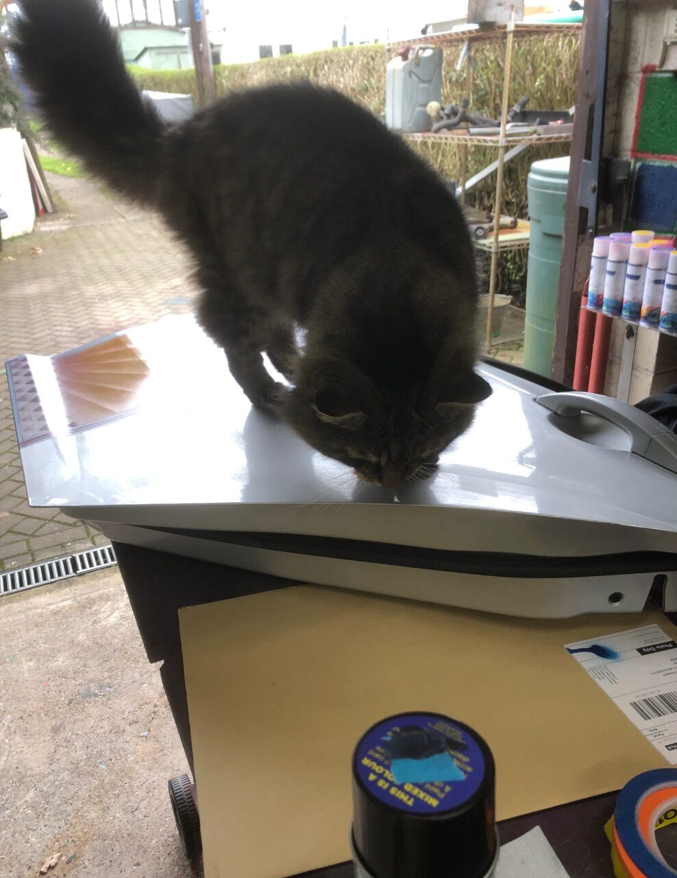

It just wouldn’t be a good day in the garage if George didn’t come in to inspect everything and approve of my efforts and progress.
Of course there’s some space left on the door.

First go at infinity lines looks good, I also like the pyramids - almost three dimensional... and the sunburst (brighter colours ???)
Are all the panels going to be different (random)  or is the offside going to be (exactly) the same as the nearside etc?
Random as can be.
Not sure what yet
I do like these split panels
Since the 1/4 fine line doesn't give tight enough radii, try getting a couple of thinner rolls 1/8 and 3/16
Might it be an idea to draw a grid with Chinagraph pencil when doing the endless lines to help keep them square and parallel
Ttfn Glenn
Ttfn Glenn
It is the 3mm version that I used.
Grid is a great suggestion.
I was going to pencil marks on the section where the lines were going.

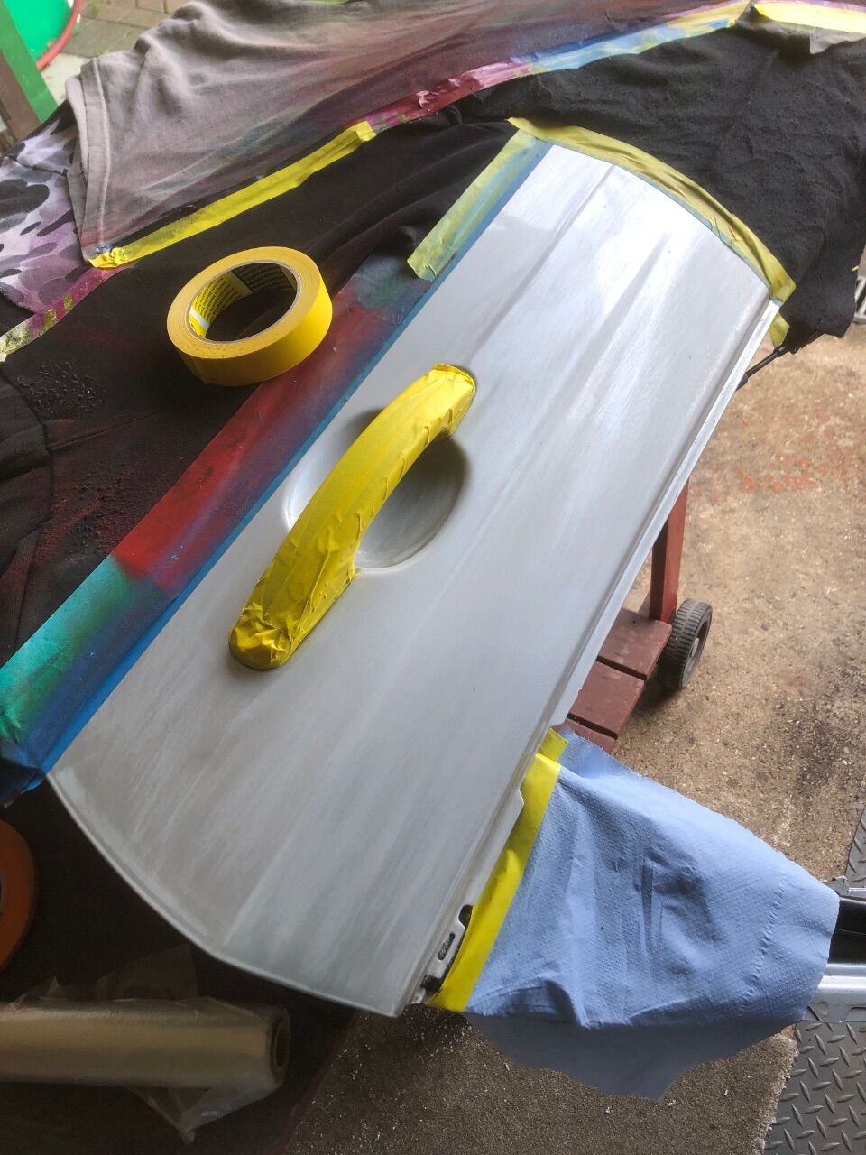

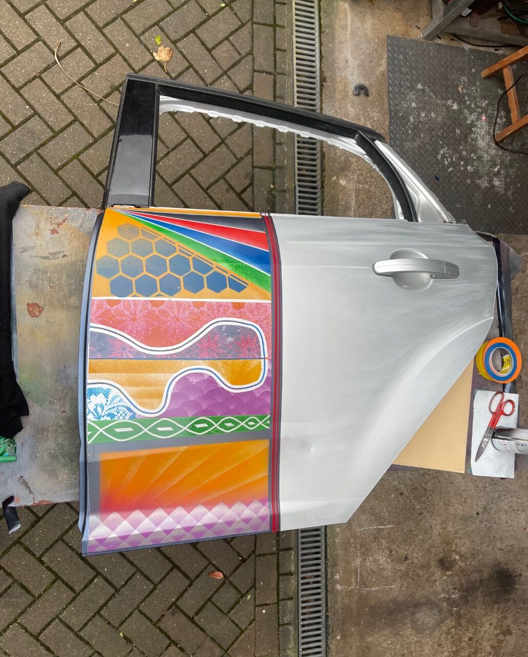

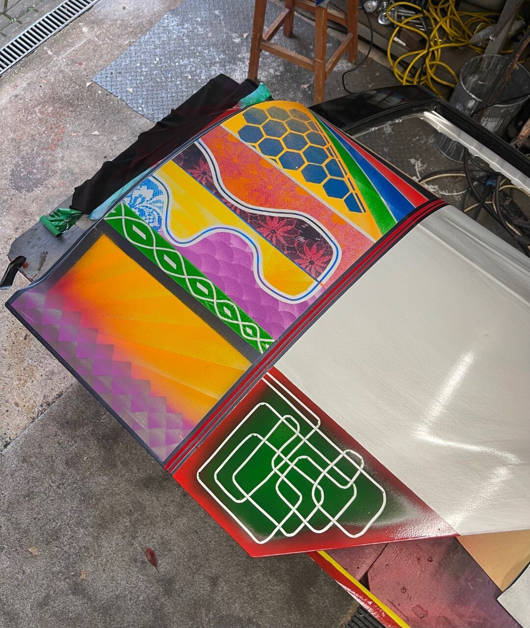

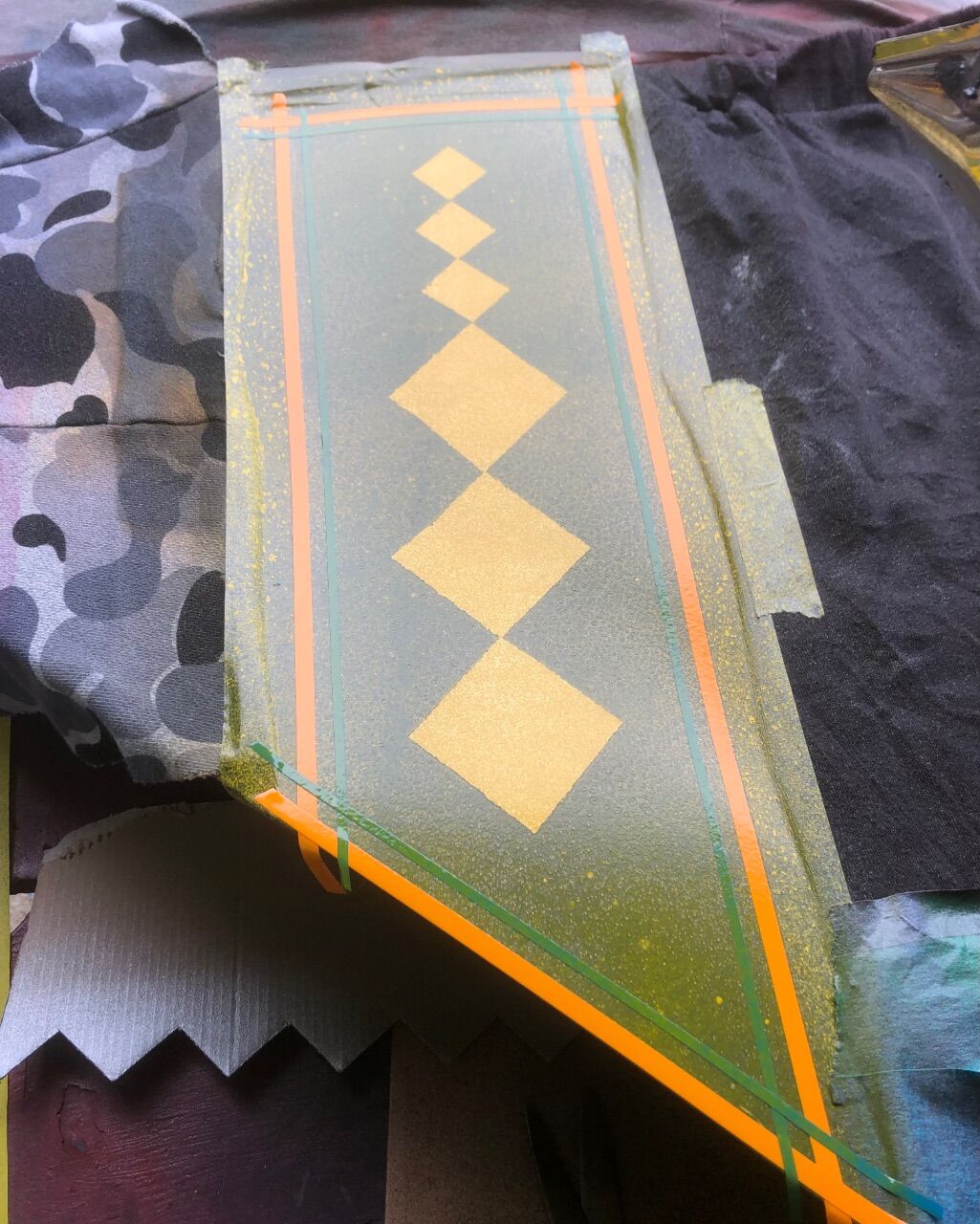

Mostly used the Dewalt heat gun to do a few more small panels on the door this week. Paint wants heat and dryness.
Keep in mind all of these bits are just to figure out what works and how to get around some of the techniques to deliver the look I am hoping for.

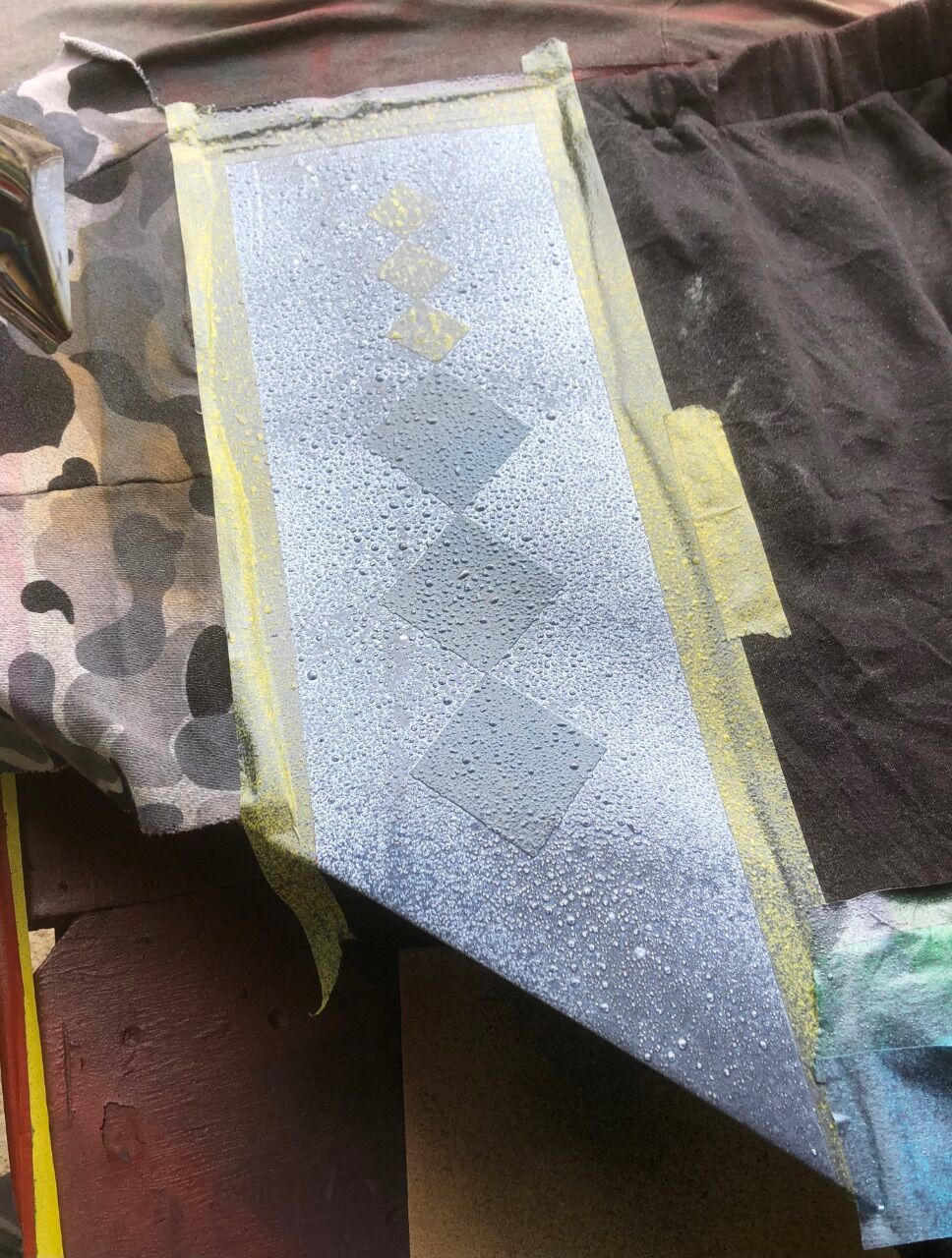

The next panel was me trying out layering and how to multimask stuff.
You have to actually go in reverse to keep the colours and designs you need to end up with.

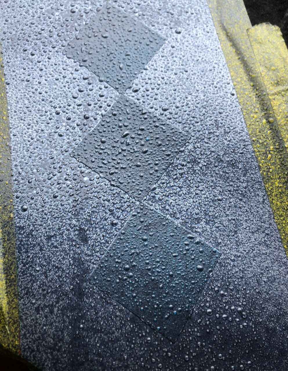

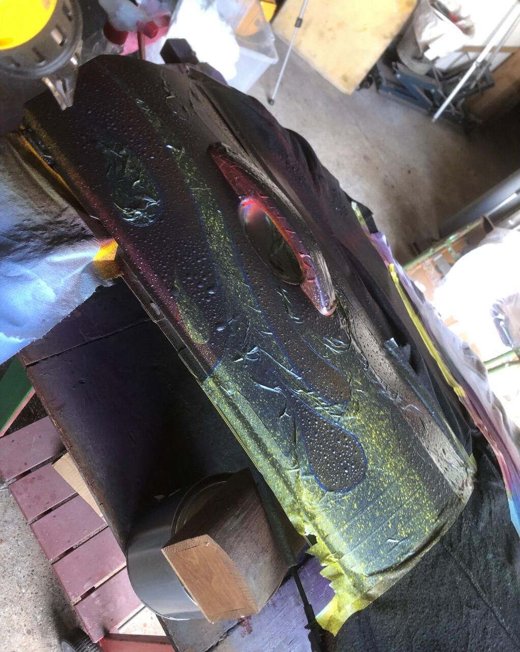

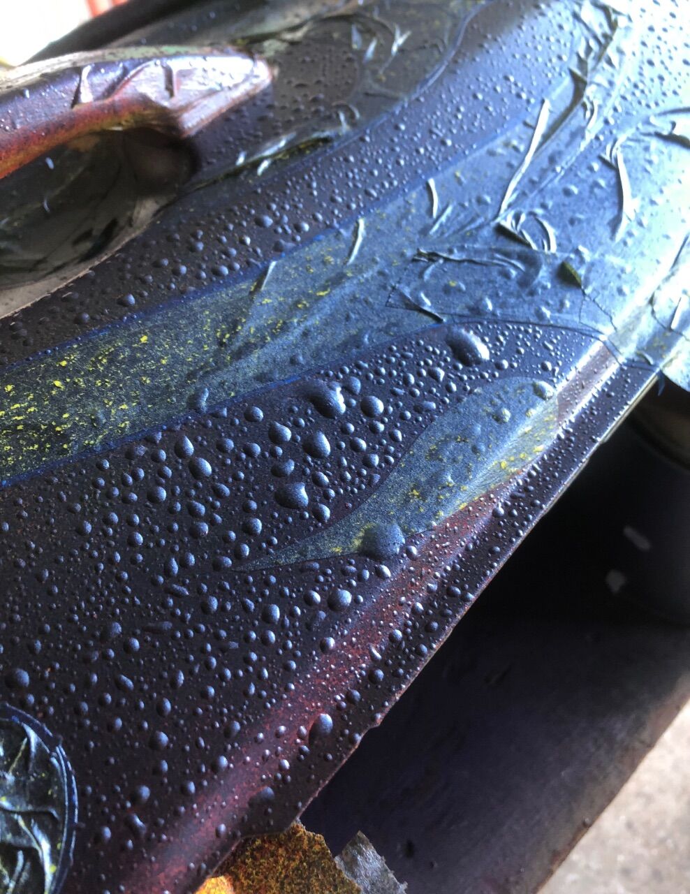

I also experimented with straight water to try creating a water droplet effect. And failed (twice) so I think I should try finding a YouTube tutorial on how to get the effect right. Because done right, it really screws with my mind. .
I am usually a look and learn type learner. Monkey See, Monkey Do.

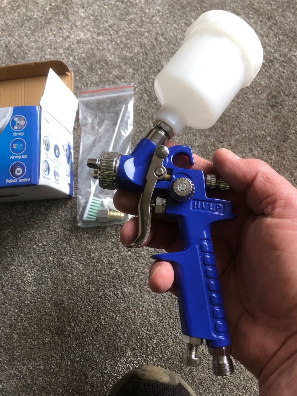

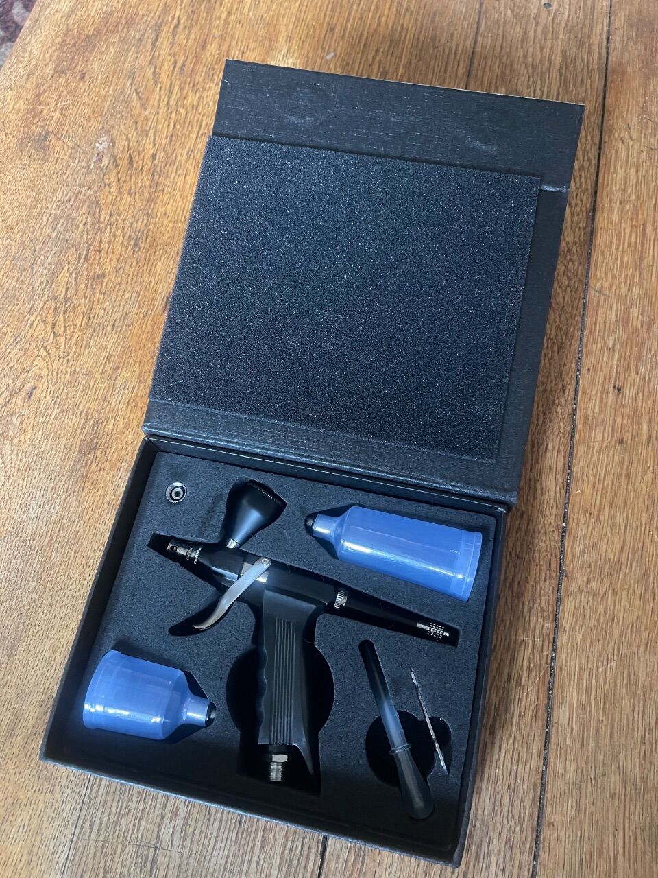

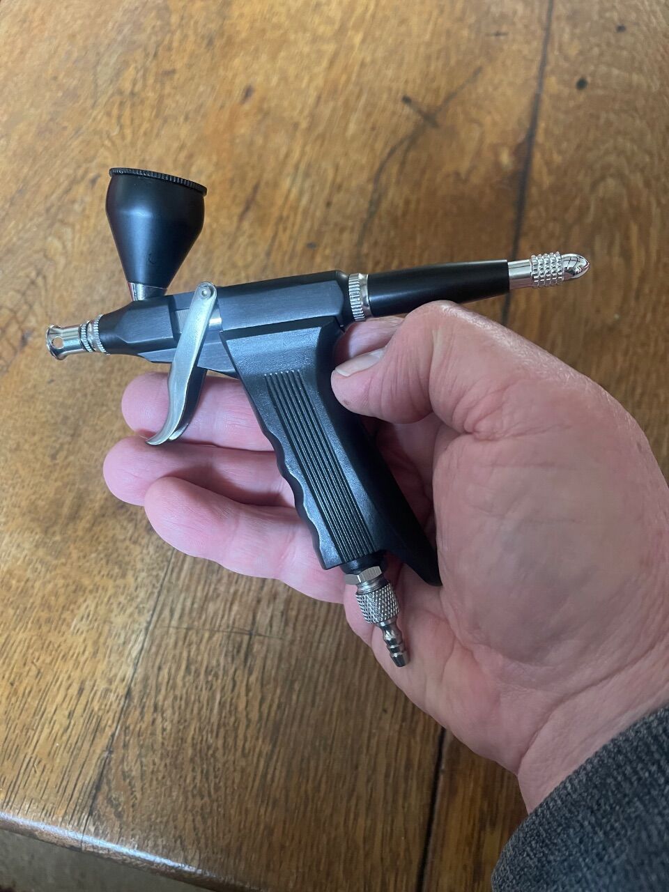

I also took delivery of my new £30.00 triggered airbrush gun. I did try it out but totally failed on all levels.
I may go sit down in the garage with it again today and try figure out how to make it deliver what I want.  Setting up, handling, technique

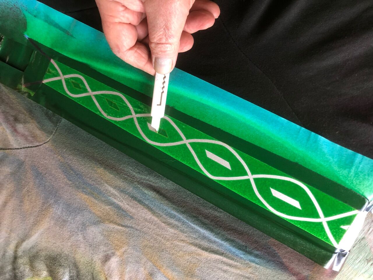

After the layering exercise, I needed an easy win.
So back to single colour lace.
Light blue over silver.
Made a nice contrast to the darker, more complex colours previously used.
One more, slightly complex panel left to play with.
I have an idea of what I want to try here
Every now and then you find something useful.
This tutorial is great.

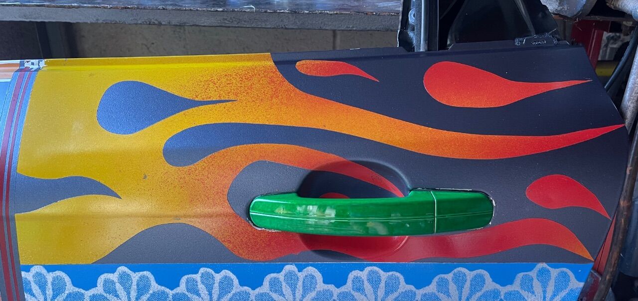

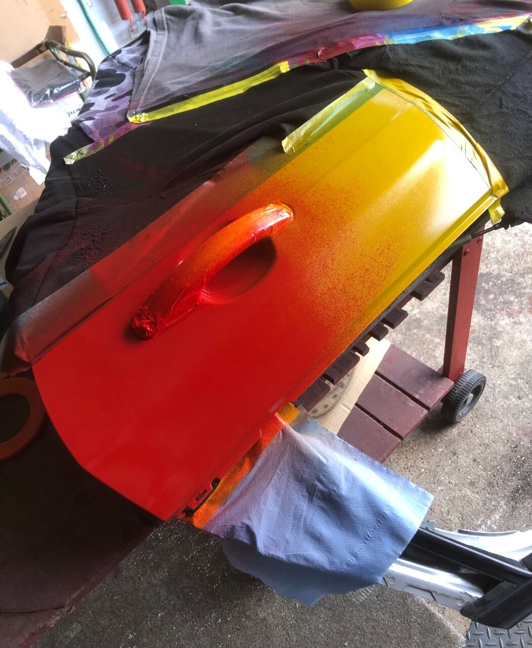

Last bit of the door painted.
I decided to go for a traditional hotrod style of flames.
And I wanted to try out the water droplet technique again (spoiler alert- Failed)
I have no intention of adding flames to the Oldsmobile.
After completing the last panel, I counted the amount of styles or techniques and it seems like I have touched on about 15 or more.
Some pics that include the prep and droplet fail.
I really liked the final result of the whole door.

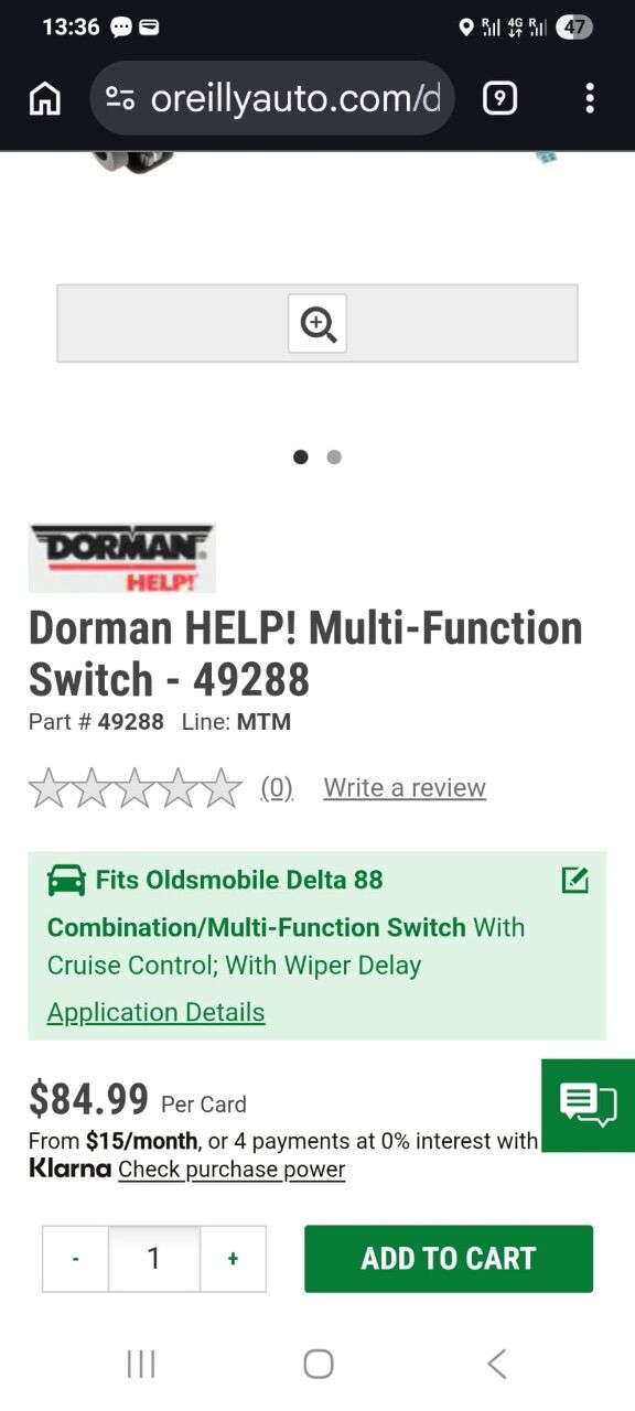

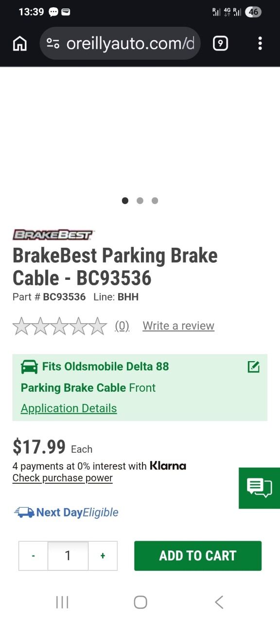

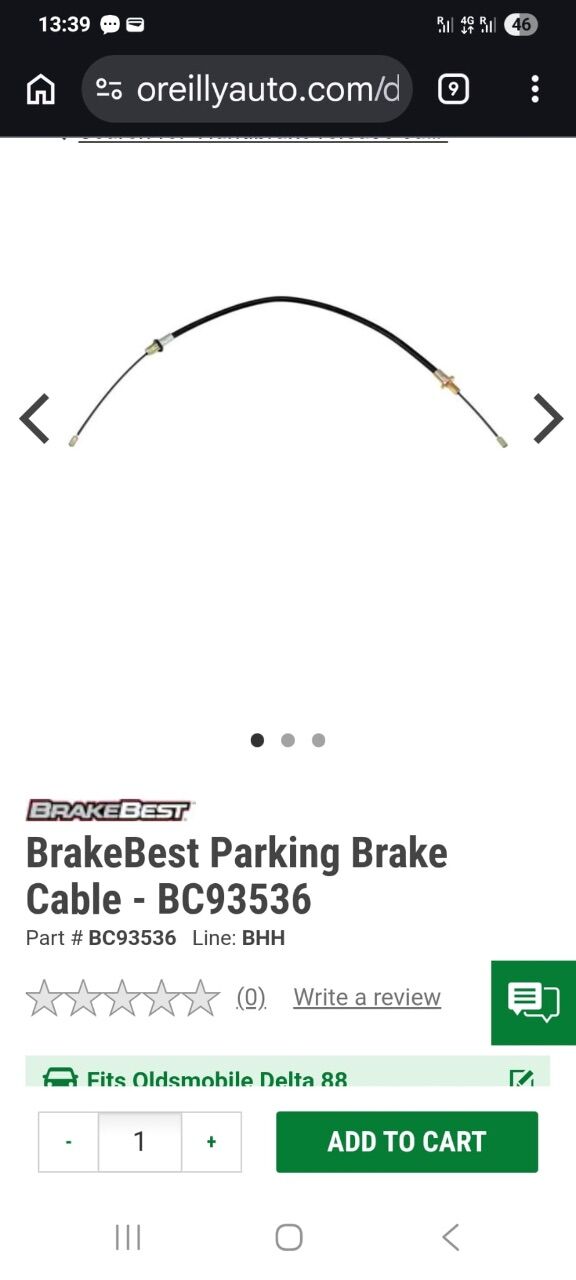

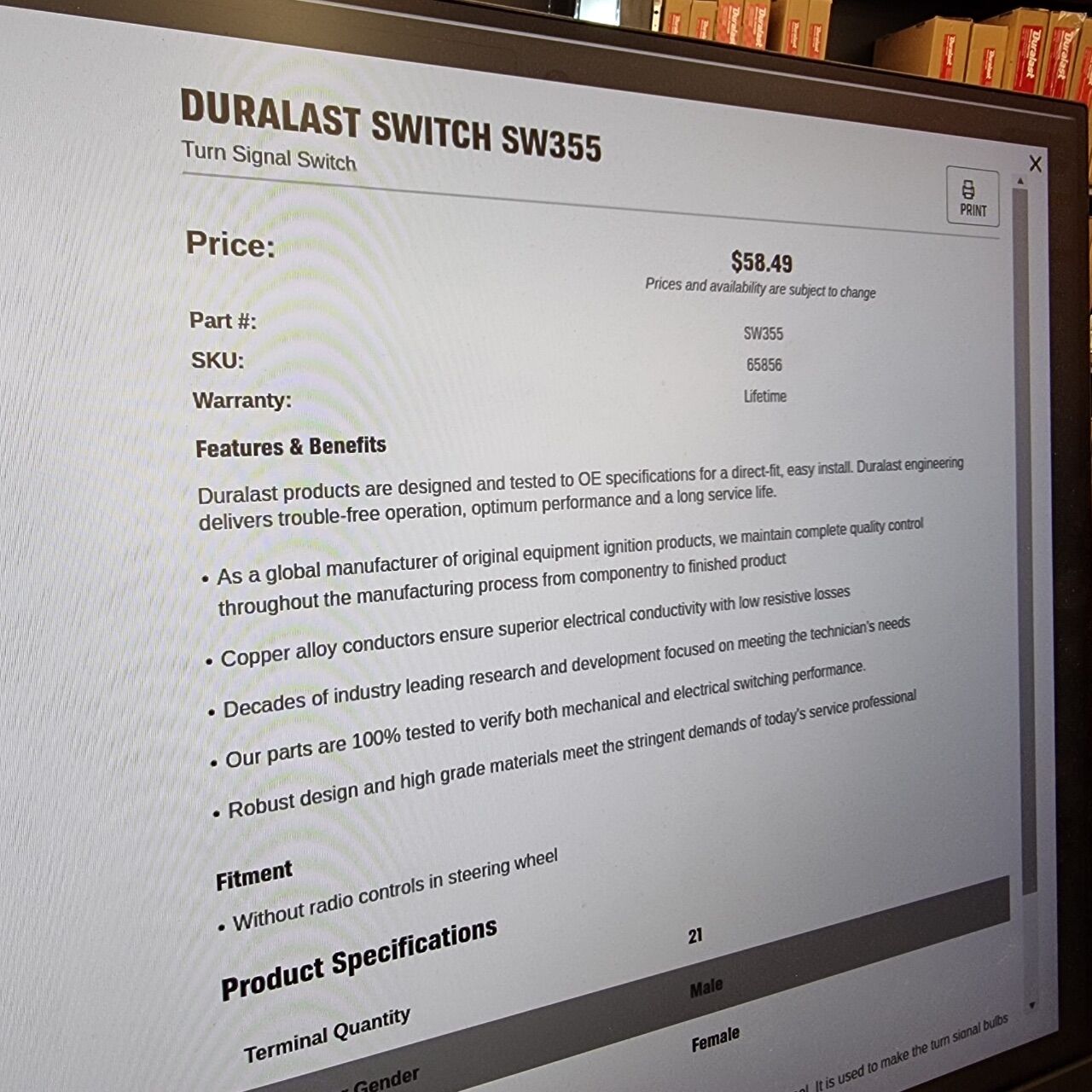

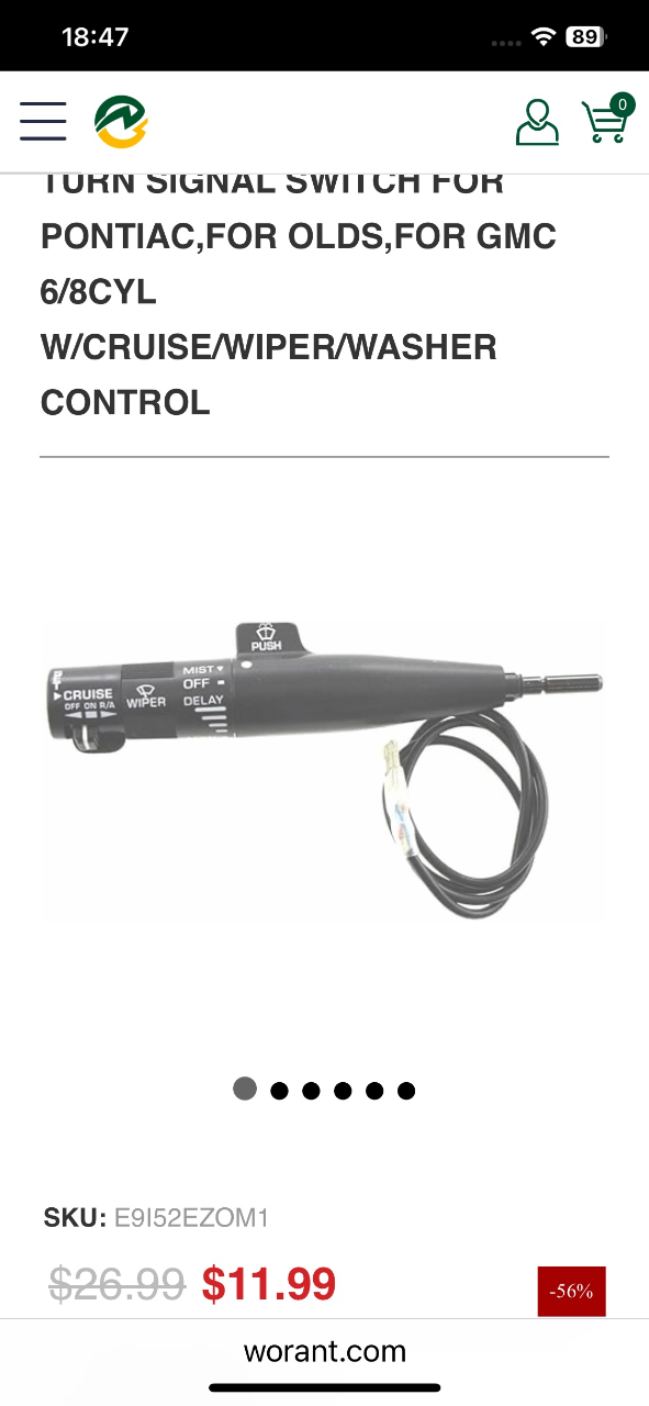

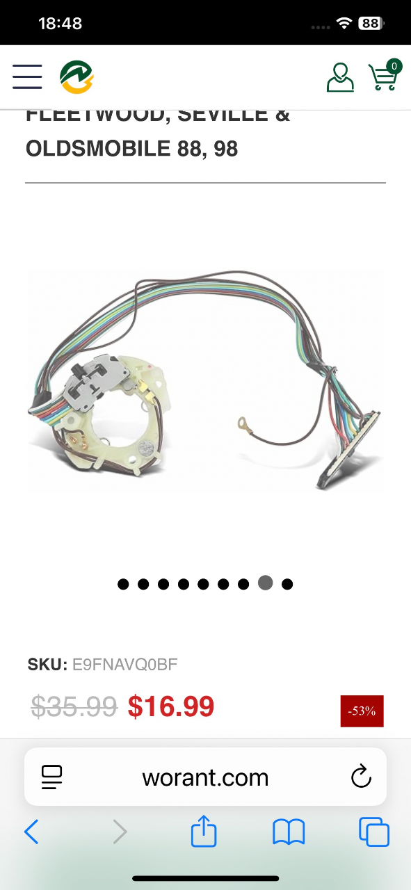

The car needs a few parts to make it operate properly. This includes an indicator stalk and switch mechanism on the steering column. Mid January I priced it them up. Admittedly this was the best price shown.  But yesterday a friend on vacation in Florida walked into an Auto Zone to enquire about the same parts. And later checked online…….
These prices are way beyond belief.

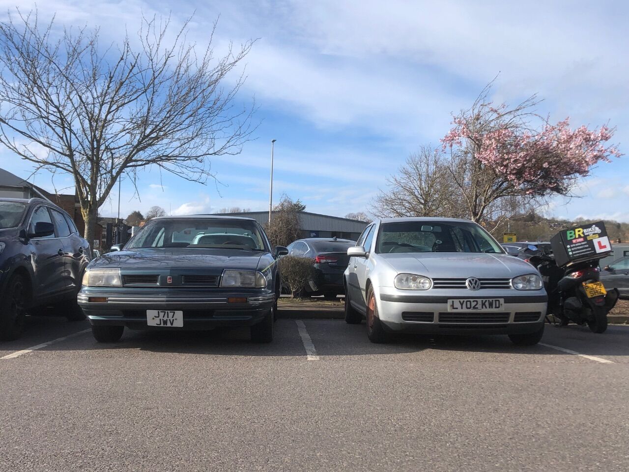

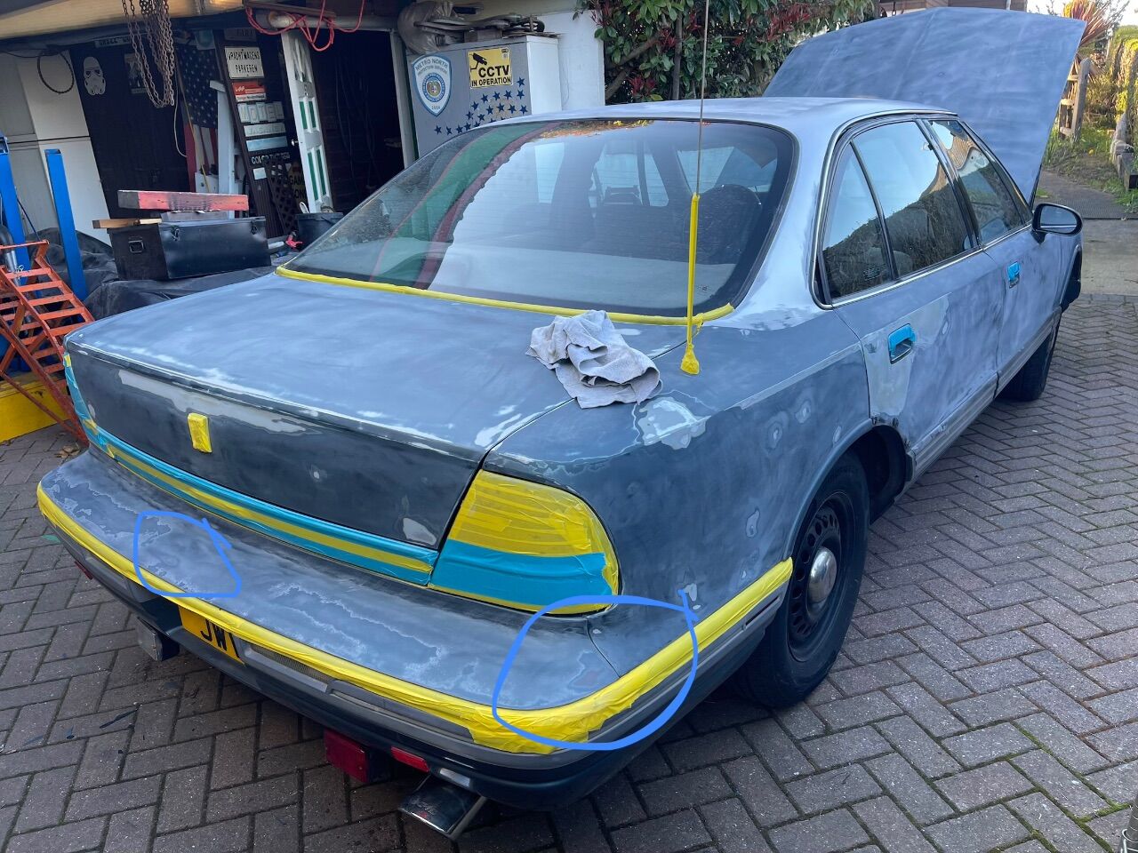

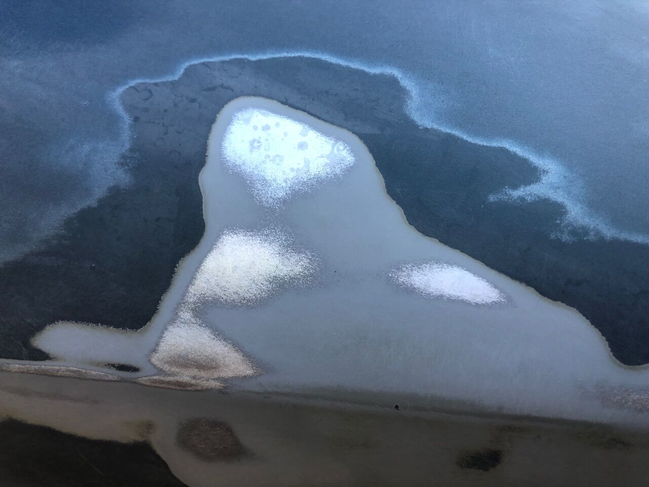

Monday morning 10.30 I was out in the Oldsmobile and when I got back to the carpark, it made me smile.
So I took a photo.
As I often do.
Little did I realise that it was to be the last photo of the yellow visualisation stripe displayed down the side that I would take.

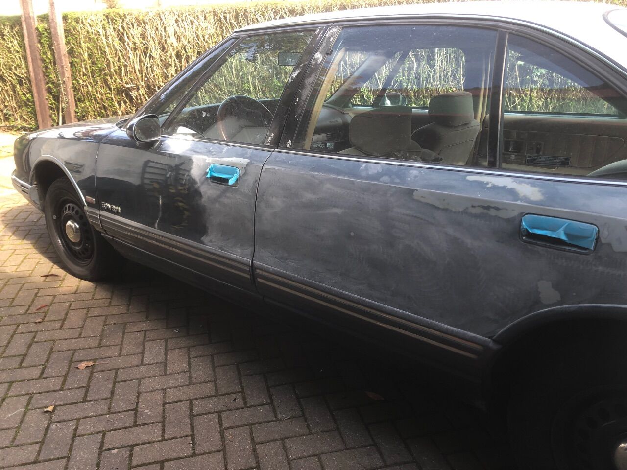

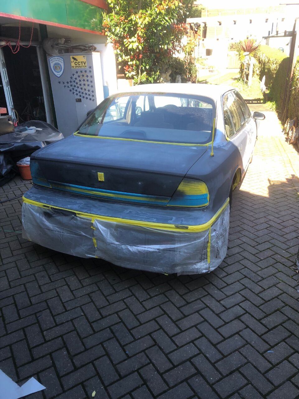

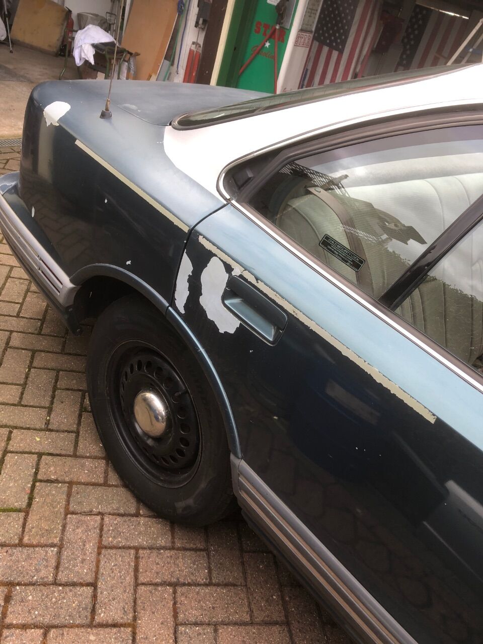

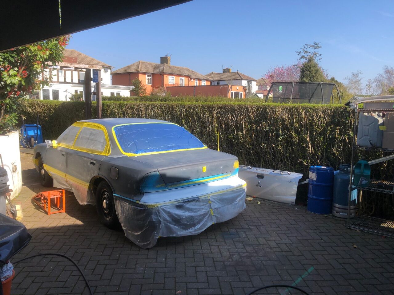

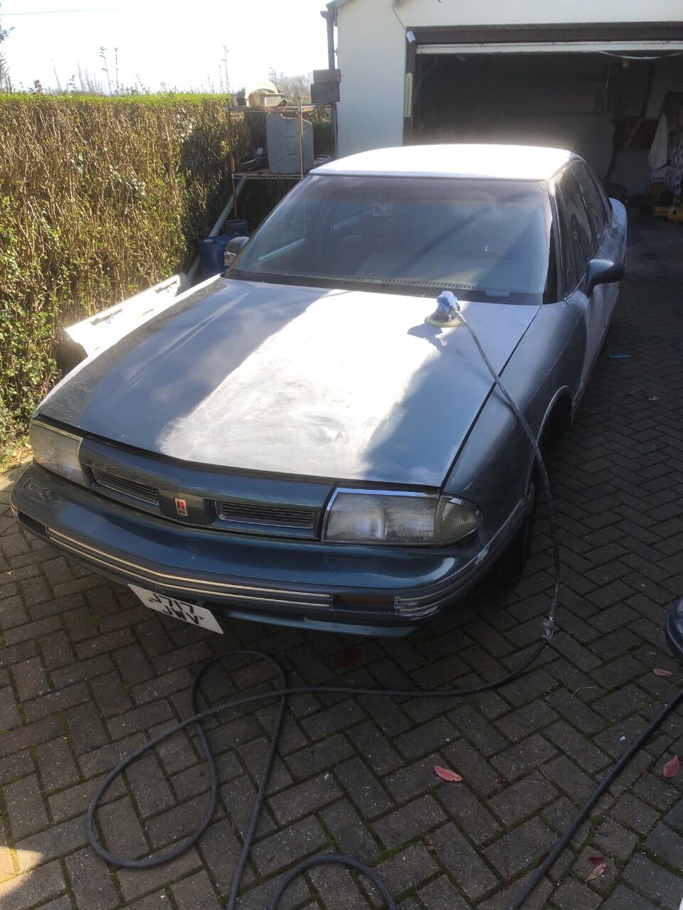

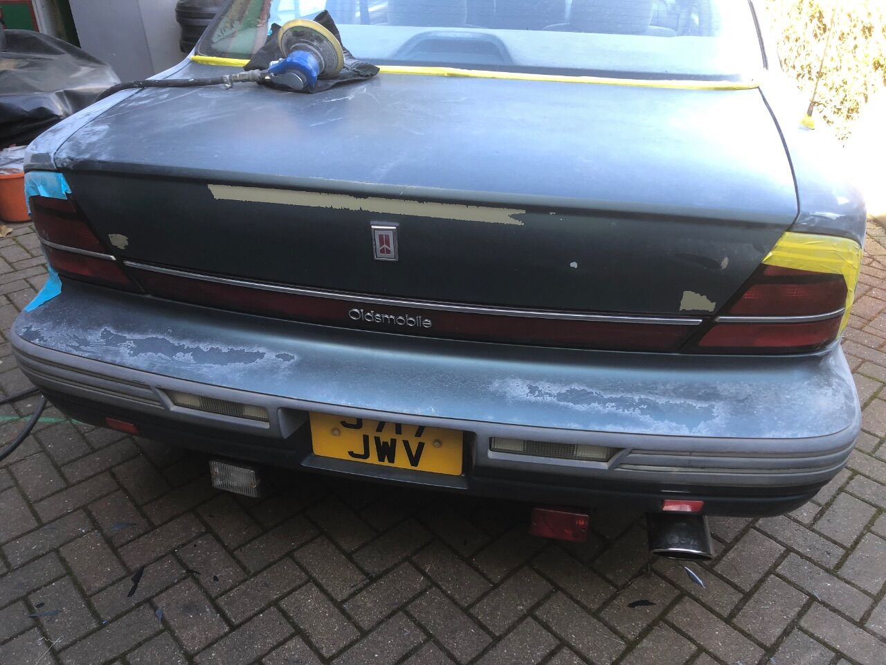

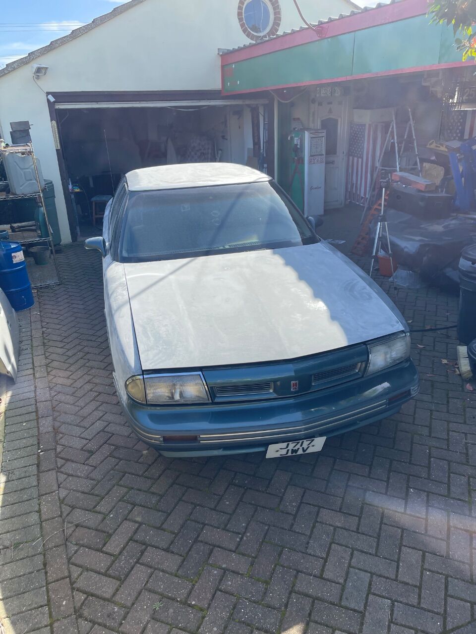

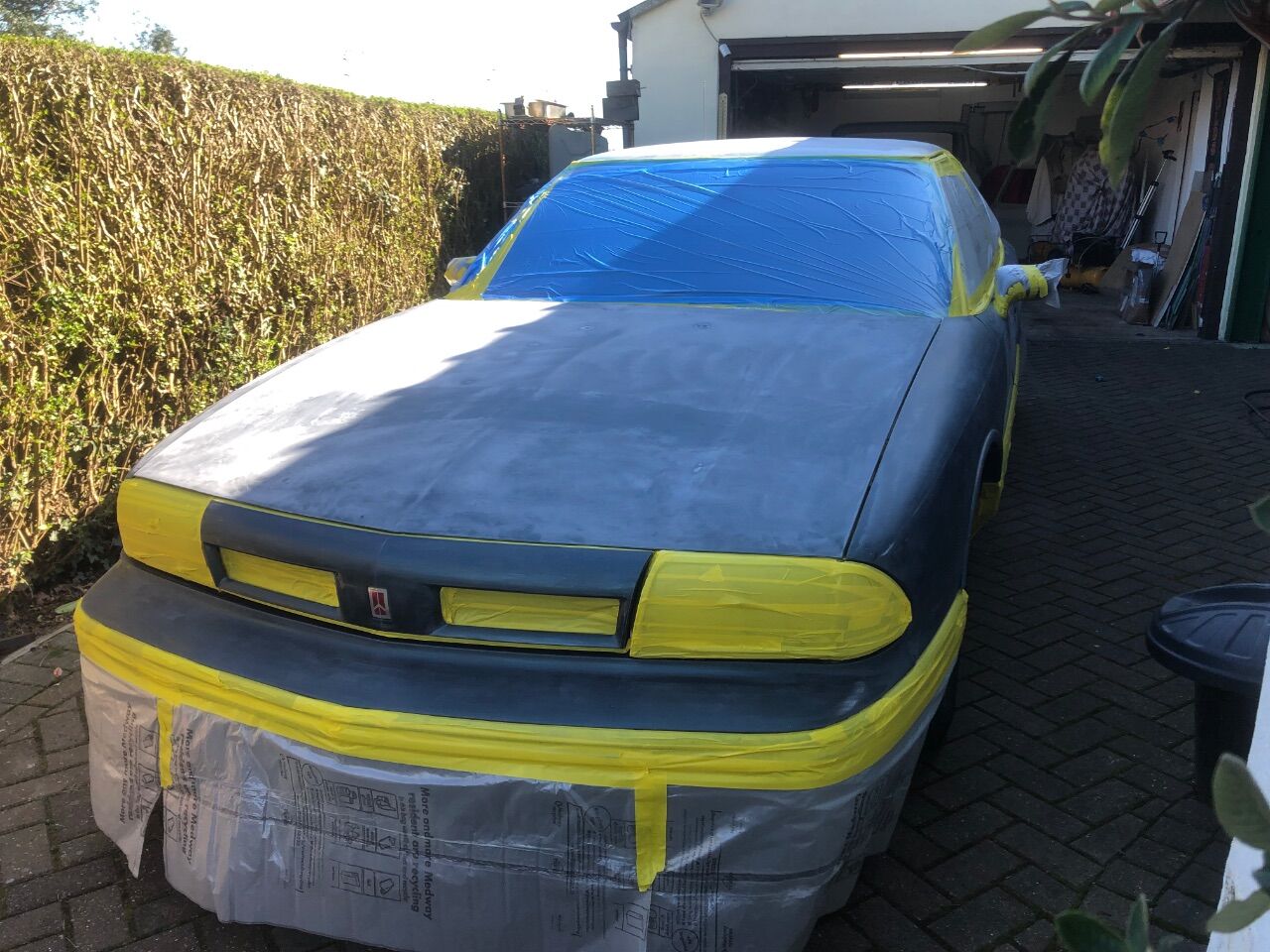

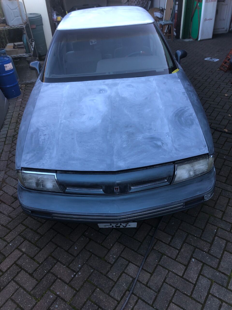

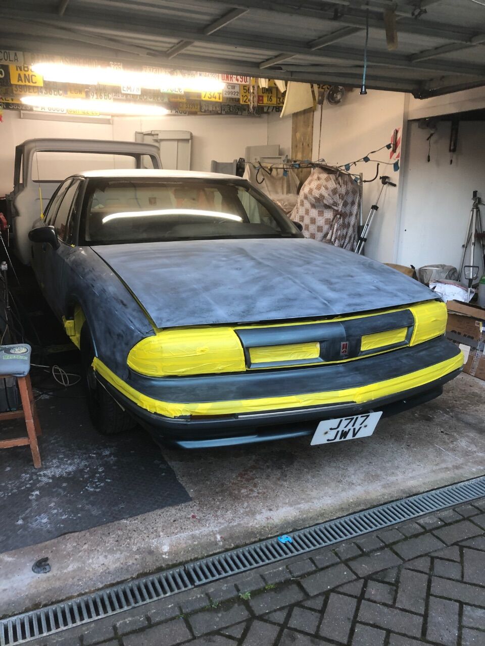

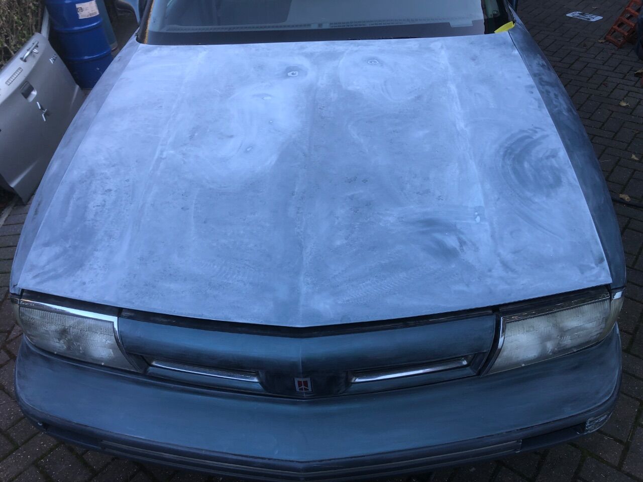

When I got home, I decided that with the good weather ahead for the week, it was probably a good time to get started on preparing the car for paint.

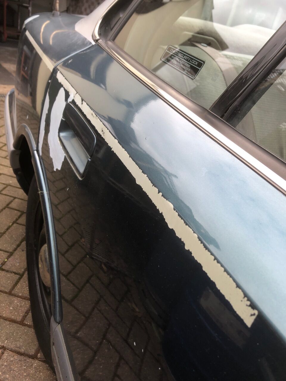

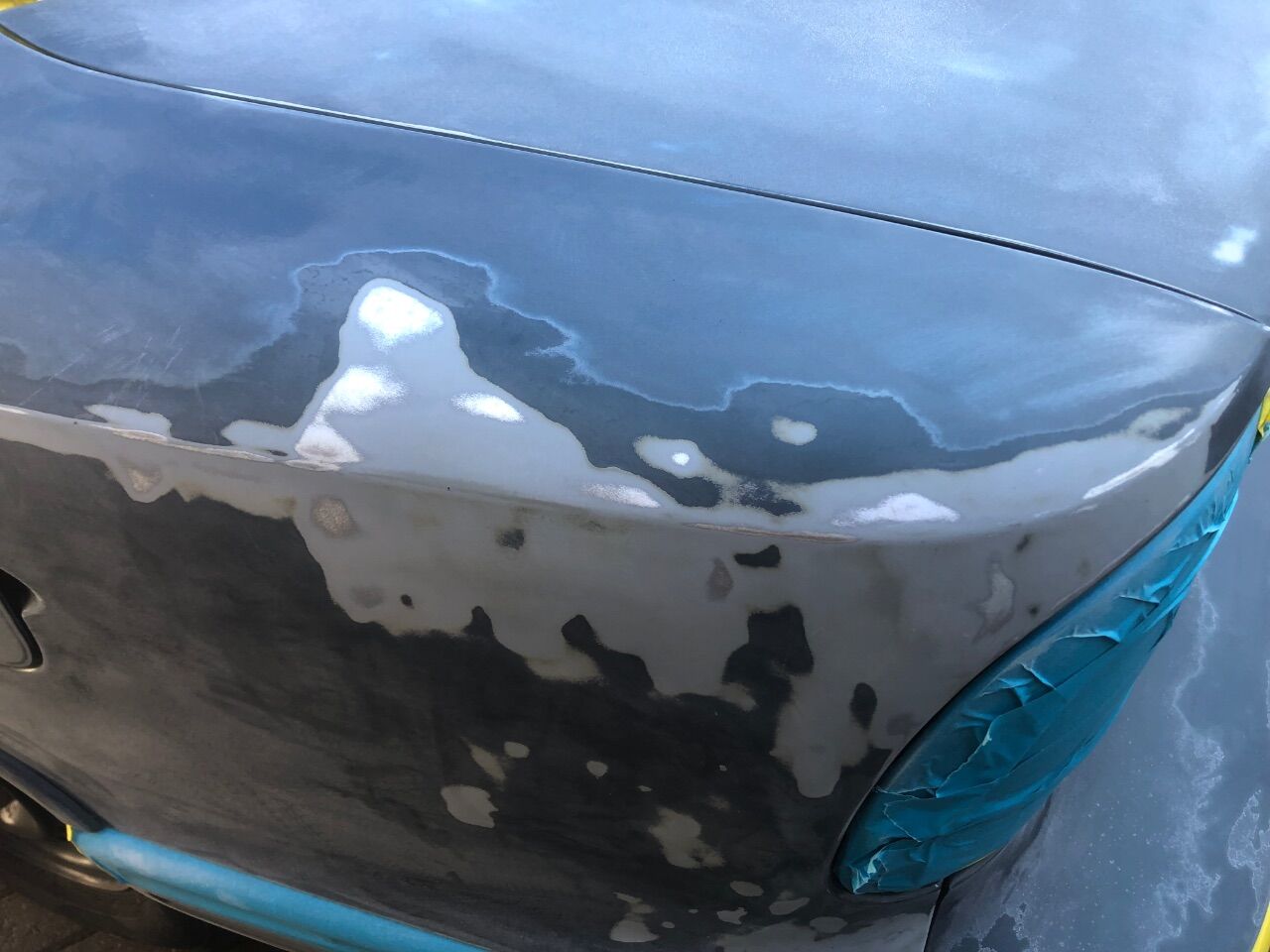

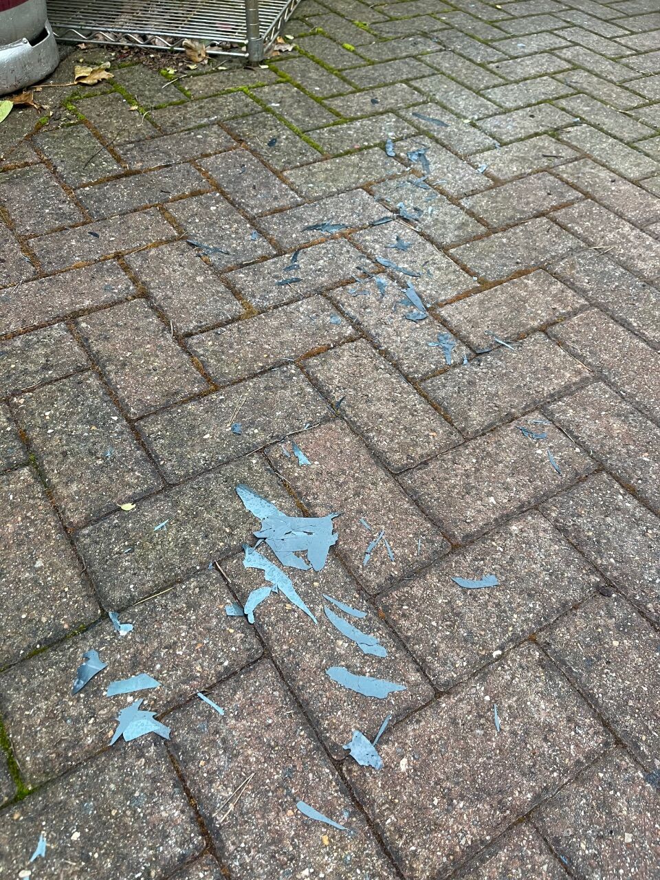

So reversed down to the garage and started by removing the yellow strip…….
AaAAAAAAAARRRRRRRRGGGGHHHH !!!!
Look at the pictures.
Too late to go back then.

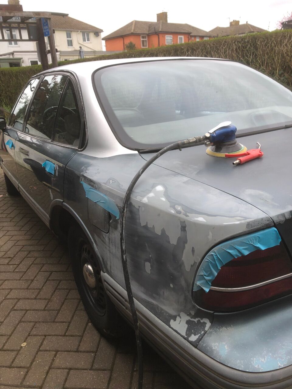

So I carried on, and got started with mostly 240 grit discs on the air driven DA and some 180 to strip the boot or trunk lid which was covered in dead paint and peeling lacquer.
In places Dennis suggested using a Stanley knife blade to flat scrape the paint that was flaking off in big chunks, forgot to take a good picture.
By 5.30pm I was not done, and reversed the car into the hoarders garage for the night.

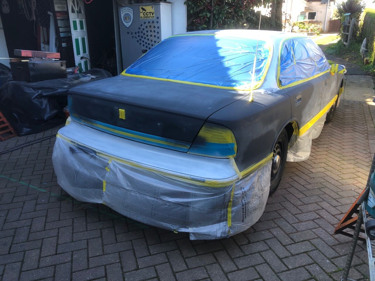

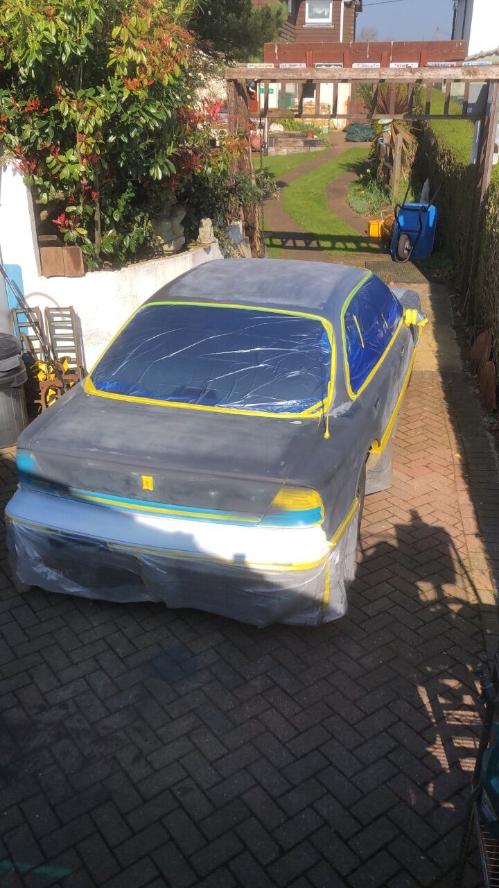

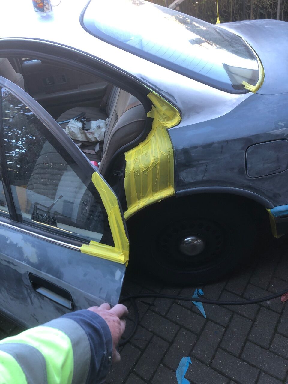

While doing the preparation of the paint, you also have to prevent damage to door handles, bumpers and other plastic surfaces. So all that masking takes both time and careful consideration.
Carrying on on Tuesday with the preparation which was taking much longer than just washing the car would have taken.
Especially feathering in the damaged torn off paint so that the new paint would be smooth over the various different textures.
The fun was yet to start.
Masking in a way that you would not be able to see a load of unsightly overspray and ridges, takes forever.
Especially if you are doing it on your own.
Trust me on this.
Few more pics

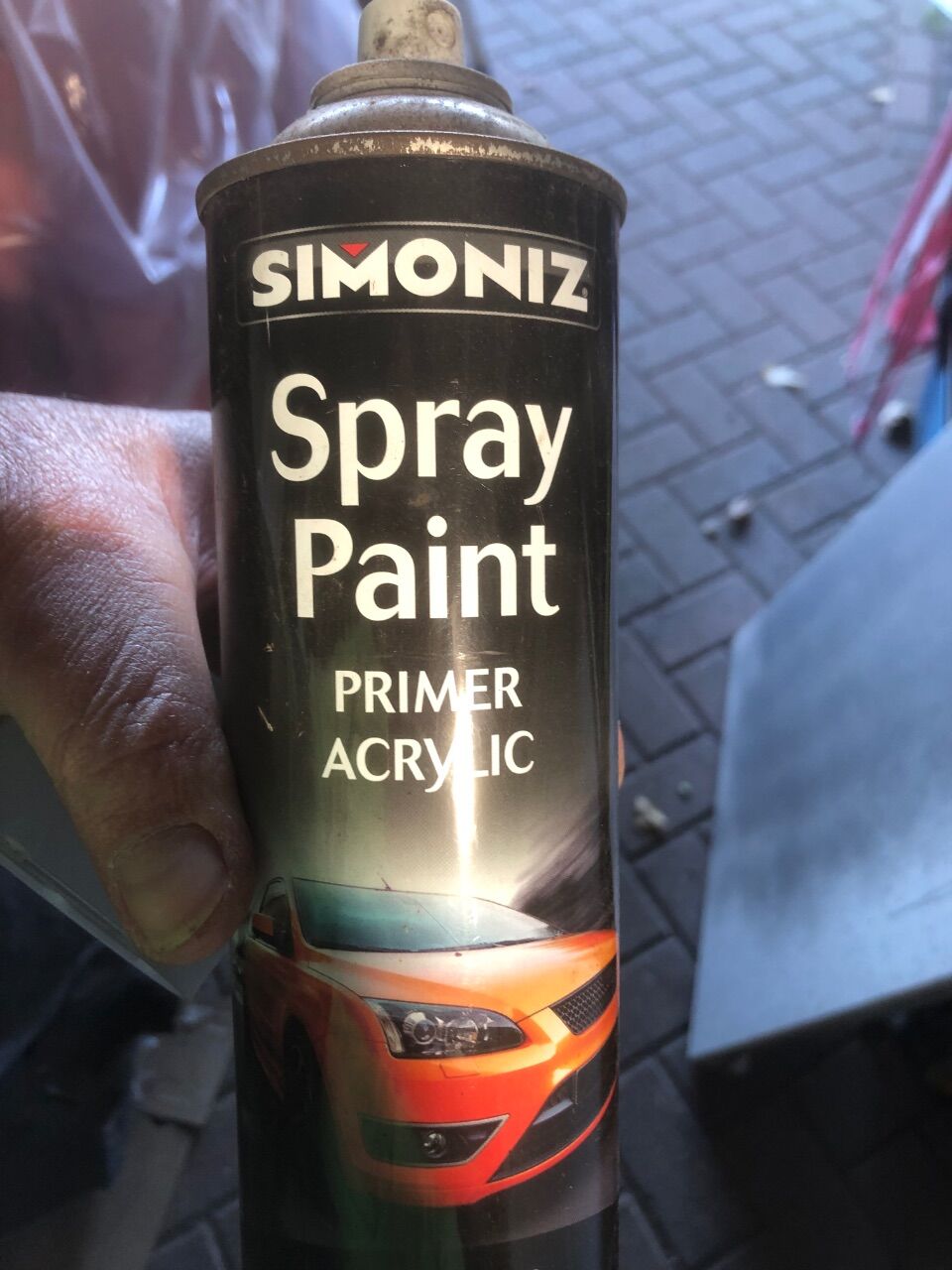

That paint really is abysmal, reminds me of some early ford metallic paint, would peel of in chunks, remember seeing an escort with almost as much primer showing as paint.

As previously 'discussed'.. you / 'we' are learning a shed load of new skills / techniques in a relatively short space of time. You will not achieve 'perfection' during this phase...
Get some paint down and as skills / techniques develop ... don't forget you're learning design as you turn thoughts/ideas into product.
🤔 perhaps , instead of going for the ultimate GRIZZ idea(s) in the first hit tone it down a bit and get some quick wins ! does wonders for the mojo ! 😇 and it's easier to see what works and what doesn't . What works on a single panel may look great but as part of the whole doesn't...
At this stage of this particular project I don't think you will ever be satisfied, but, the next one (same car / different version whatever) ... so if you have to revisit certain aspects just treat it as part of the learning curve...
Don't forget even the great artists reuse their 'canvas' ... 🤣

Continuing with the preparation…..
Man, (woman too) this takes a a while.
I am doing a complete colour/color change here.
One of my pet hates is masses of overspray on anything from refrigerators to gokarts and anything in-between including cars of course.
So masking in a way that doesn’t show much or any of the original paint, is paramount.
I had to mask inside of all the opening edges, fuel filler door, boot/trunk lid, bonnet/hood, engine bay, doors to prevent paint being forced inside all these joints and over rubber seals etc.
Because of my attention to detail ( very mild OCD) I also had to mask up the complete drivers door separately so that the car could be moved around in the yard. And glad I dod so.
Pics show the extent to which lips and edges needed to be masked.
It certainly took six or more hours longer than anticipated. Putting sanding and painting back by a day. And with the weather being as much hit and miss as it has been, it’s actually stressful.  No, I don’t expect you to understand.
Another thing I forgot to mention about this job was that I am doing it in phases. Or parts. Or episodes.
So originally I was going to do the roof and C-pillars as part one.
PROJECT CREEP…….
So my preparation was now down to the bumper edge and door rubbing strips.
Of course when you think you’re done……..
You’re not.
Yet.
Dennis suggested some acrylic primer on the rear bumper that had always been really bad, the sanding back of dead clear lacquer had gone through to plastic in a few places.
Those who actually read the text and look at the photos will also notice that I had added etch primer to all exposed metal areas, which was a sensible move.
