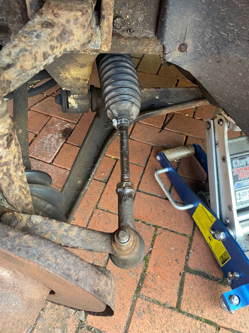

Sooo the daily Laguna was in for its MOT last week and it disgraced itself by failing on two items, an incorrectly fitted headlight bulb (that would explain why oncoming motorists keep flashing me- though it was just because I’m so popular) and a rust hole in the drivers sill.. eek!
The headlight bulb was easily fixed, especially as it was the passenger side which is easy to get access to, replacing an 80p sidelight bulb on the drivers side requires engine removal. The hole in the drivers sill was a slightly bigger issue.
There’s a patch welded on the drivers sill, apparently a previous owner drove over a set of car ramps and caved the sill in and the patch was there to give the sill its shape back, which it didn’t do a very good job of and looked terrible but there wasn’t any point in disturbing it. This patch has rotted out and behind it was a badly bent sill.
After discussing the situation with the tester I decided to cut the old patch off and see what was behind. The sill really was caved in, the top of the sill had been hammered down to allow the door to open and had been skimmed with filler. With all the corrosion and filler ground away the full ugliness of the sill was revealed.
I pullled the dent out of the sill as best I could via levers through a couple of drainage holes, the whole thing was just looking worse rather than improving. When I couldn’t get any more of the dent out I skimmed the whole lot with filler to give it its shape back,  I painted it with high build primer from Halfords (covers sanding marks apparently), a tin of silver paint I found in the boot and under sealed with some random stuff I found in the garage and stuck it back in for retest which it passed. Hurrah!
This sill repair looks absolutely gash but probably looks a bit better than the massive patch and filler that was there before. Plus there’s another 12 months motoring on the old jalopy which is a bonus on an 18 yr old high miler Renault I think, so overall I’m pretty chuffed.

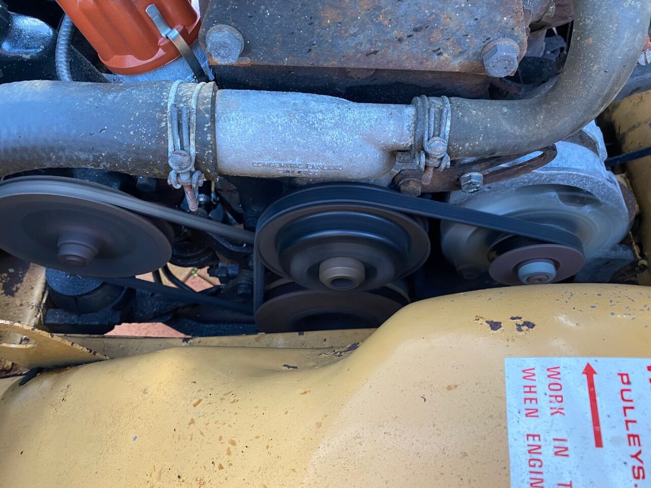

I’ve been busy today neglecting the family and working on this Princess. The perished fuel lines have been replaced and a battery borrowed from the 2cv strapped into place (the battery was in turn stolen from a scrap Honda Jazz and is way too small)
With the engine running I noticed the distributor cab moving slightly, turns out there’s a couple of large cracks in it and the 123 distributor body is really quite badly corroded. I can scrape big flakes of it off with my fingernail. Hopefully a clean up and some protective paint will help, along with a new distributor cap. Has anyone else seen aluminium corrode like this?
Well played with the wedge its properly cool. Thats had a nice moist enclosed world and something reactive to get that alloy so fluffy.
I've had modern alloy stuff corrode at alarming speed. I don't think any of these classic car parts are intended to live outside and even your standard lockup is pretty damp.
Yeah, it is a weird one seeing as these 123 ignitions systems are a qualify piece of kit and not cheap. I ordered a new cap from eBay but realised just in time it was the wrong one and managed to cancel the order. It turns out the aftermarket dizzy uses a Mercedes distributor cap which also fits the Porsche 911 weirdly enough. With a new cap delivered the distributor was cleaned up a bit and the new cap fitted securely into place. The engine now seemed to start and run well, apart from the other carb overflowing which needed to be fixed using the official BL method of mole grips on the fuel line until the engine splutters, then release the grips and the sudden flow of fuel dislodges whatever is obstructing the float valve. All very technical.

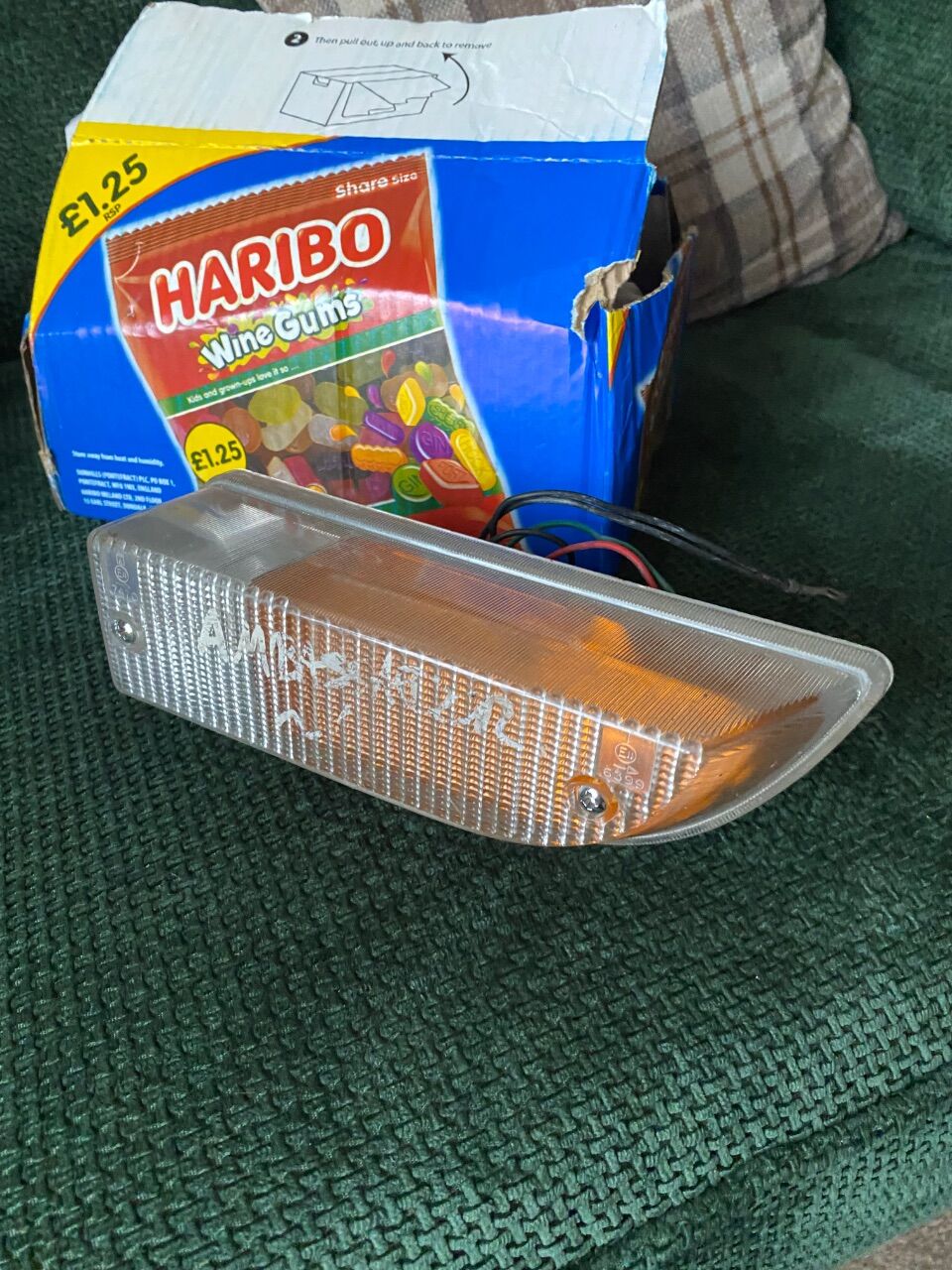

A little more progress. The glowing OS repeater lamp has been an ongoing issue and so far my investigations have mostly involved looking at it with my hands on my hips but yesterday I actually had a go at finding out what was happening.
Theres some rodent damage on the wiring to the repeater although it shouldn’t affect operation and just needs a little insulation tape to fix. Taking the sidelights and front indicator lenses off I found the NS unit was corroded and full of water. The bulbs had been replaced with LED items and were absolutely soaked. With these replaced with conventional bulbs the glowing repeater seems to now be fixed but the NS front indicator needs a little work. The bulb  holder is corroded and might need replacement, unless I can bodge something.

The corroded indicator/sidelight was replaced with a new looking one from eBay and today a new steering rack gaiter was installed to replace a perished and split original. The tyres and front brakes are in dire need of replacement however, the brakes work fine but are heavily corroded from years of dormancy and the tyres are 10 years old and have decided to fall to bits.
