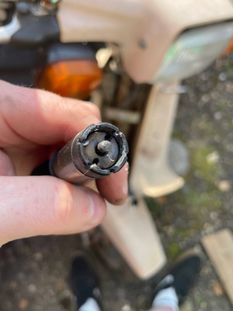

My Honda melody throttle cable needed a new splitter (throttle cable goes to a splitter where it then goes to two cables - one to the oil pump, one to the carb)

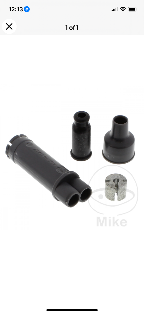

The original centre where the cables hook into had gone brittle and snapped so I’ve got a replacement here to fit.
This is the replacement:
The issue I have is that the original one was the opposite way round (so the removable cap was the end where the two cables go in, the fixed end was the single cable)
Therefore, the two cables don’t have enough free cable to fit through the tube and out the end to hook onto the centre piece.
I’ve taken the cables off the carb and oil pump so I’m at their maximum length, they just don’t stick out the end enough.
Frustratingly the new centre piece also is a bit bigger than the original so I can’t just use that in the original splitter tube either.

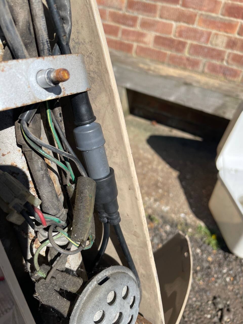

This is the original so you can see the open end is the end with two cables so it’s easy to feed the single cable in and it’s long enough to come out the end.

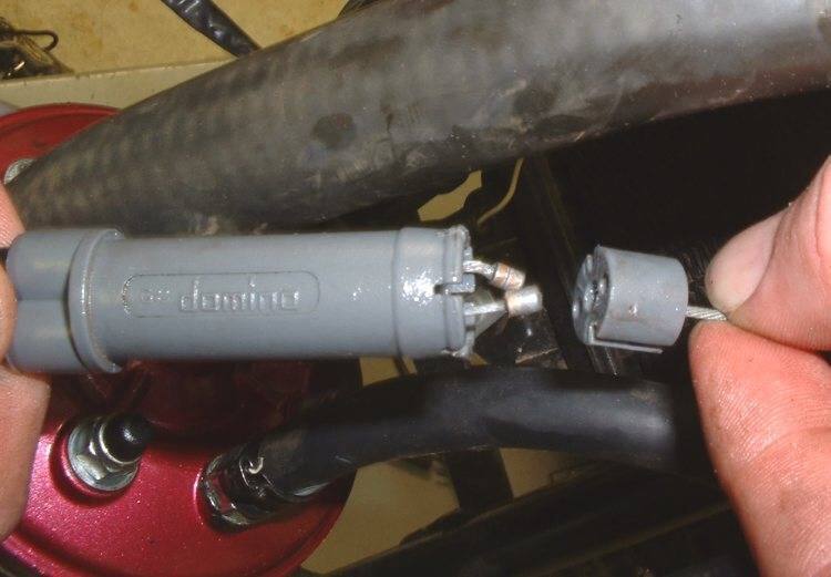

Here’s a pic from online of what I need to be able to do but there’s not enough free cable to poke that far out:
