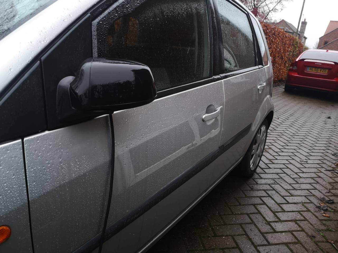

I also snagged a full set of body colour door handles, but wish I'd have got the boot handle too.
They are quick and easy to change, under 15 mins to do the set.
Looks a bit more modern for it I reckon.

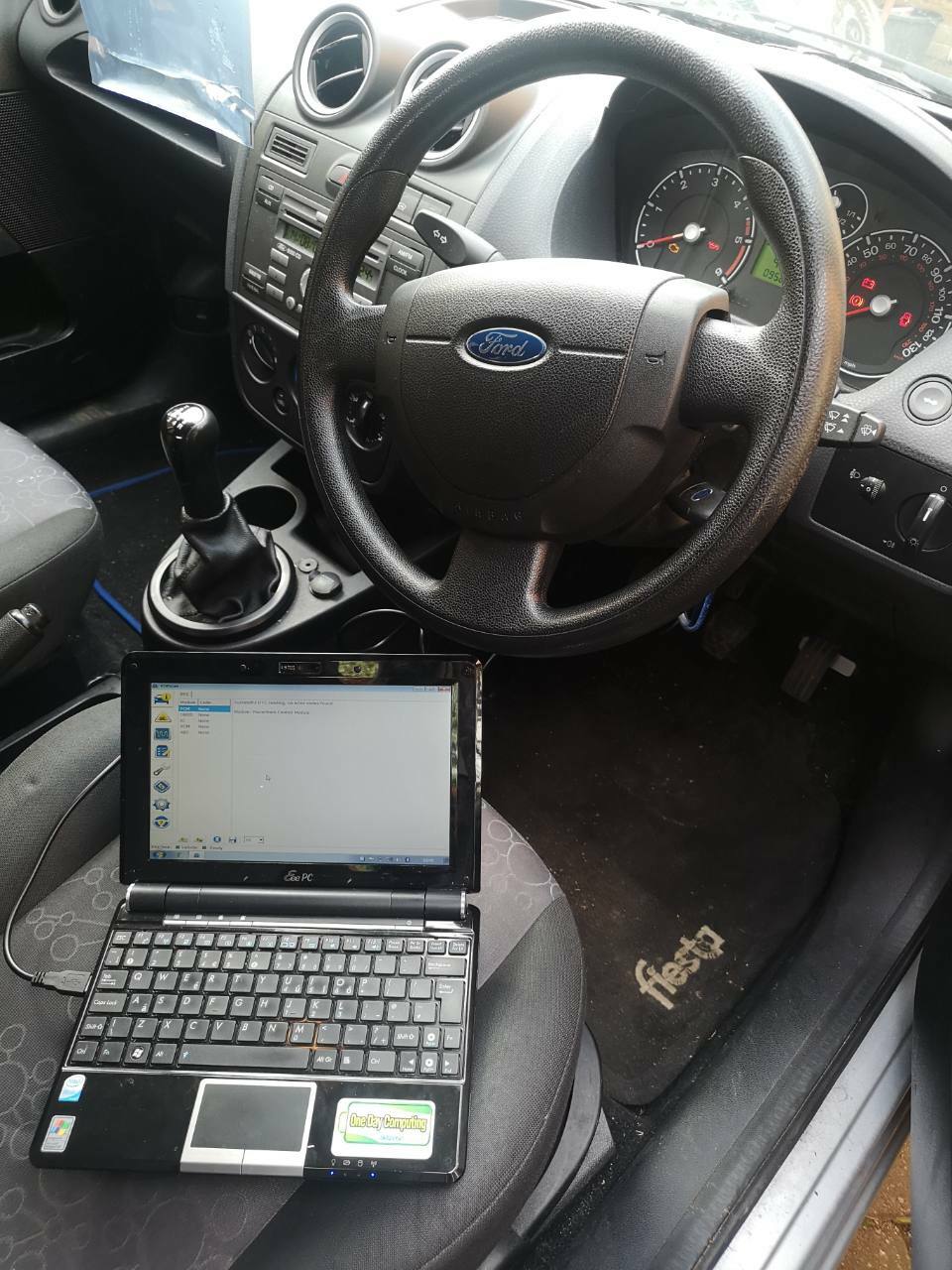

The laptop I bought on here last year has been loaded Forscan with a £16 lead from ebay and it talks nicely to the car, only 1 code stored for open circuit of the fuel temperature sensor.
Connection cleaned, and a new gland fitted to the plug and the issue is gone.
