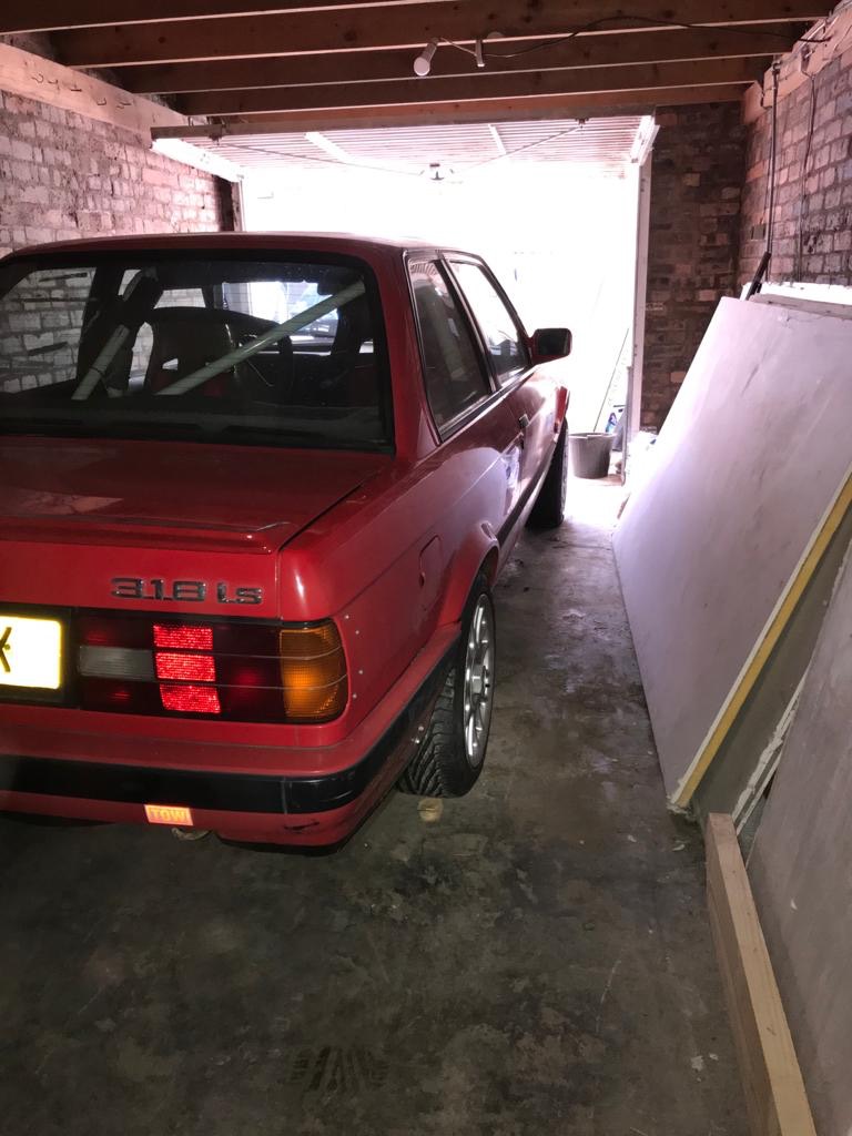

dc2100k Posted July 21, 2020 Author Posted July 21, 2020 Bit of an update on this car, much neglected for the last month - as seems to have been her fate since 2009! The car is still in my pal's yard and the virus means my time off for fixorating is limited. I managed to pick up a running M44 engine with all ancillaries for £50, and a Getrag 240 gearbox with prop and 4.27 small case diff also for £50, so the drivetrain is starting to take shape. I also bagged a nice set of 14" basketweaves which is what the car would have come with originally. However, on my searches for a rollcage for the car I have been offered a complete running 318is rally car with everything done, MOT'd and in need of nowhere near as much attention as this car. The price is less than I had budgeted to get this old girl back on the road, let alone rally prepared so I have decided to go for the completed car and I will put this car up for sale as an unfinished project. It's a shame as the new car is red and I don't like that anywhere near as much as the Diamondschwarz but I have to be sensible about the time & cost savings involved. Anyway the new car has a fizzy roof too so we can have a bit more ROOF RUST OMG fun sorting that out, but it is much better underneath and has a running M42 in situ and a bunch of spares. Should be picking the new car up next week and in the meantime I’ll try to find a new home for this old girl. dome, Tickman and beko1987 3

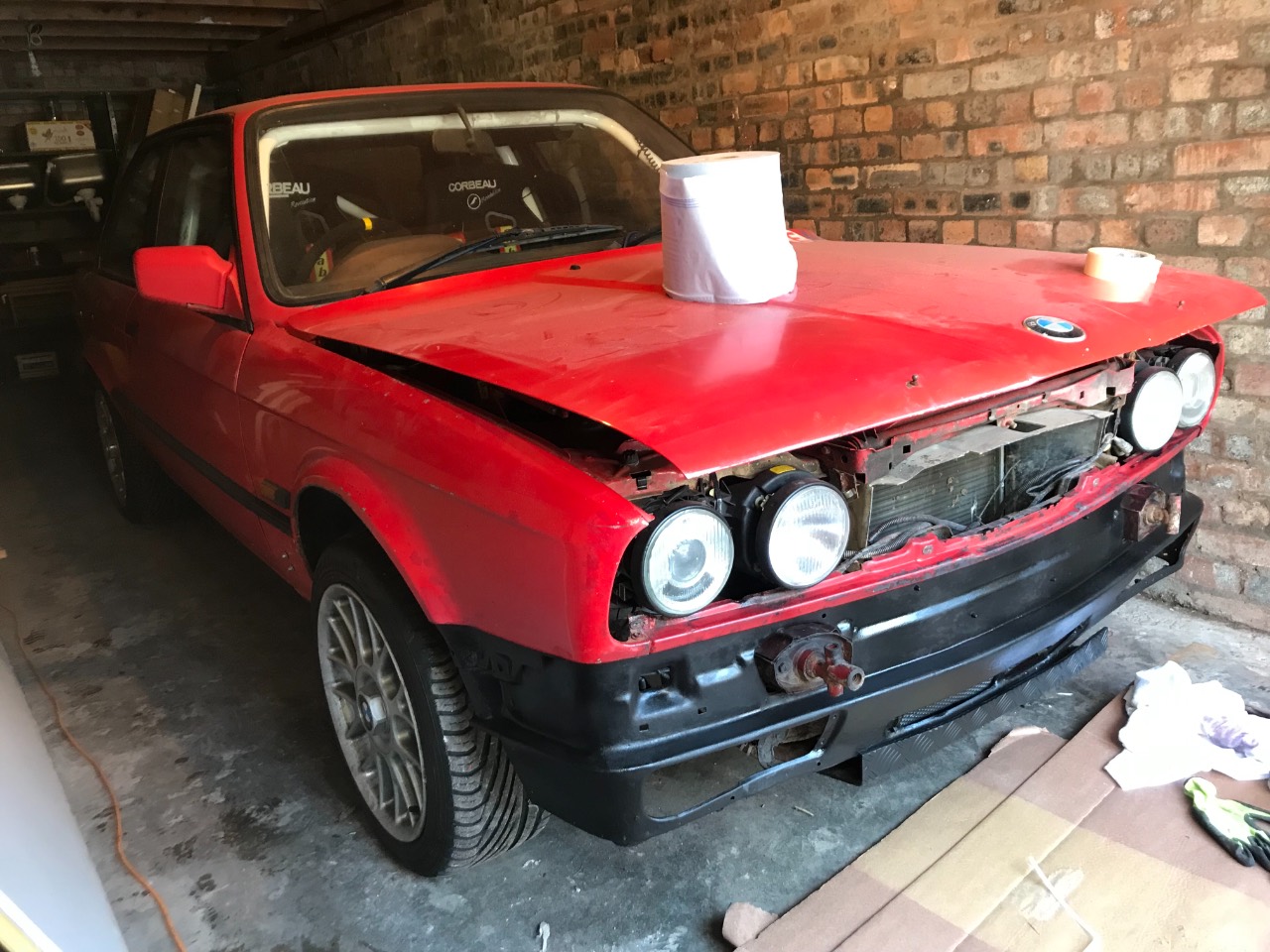

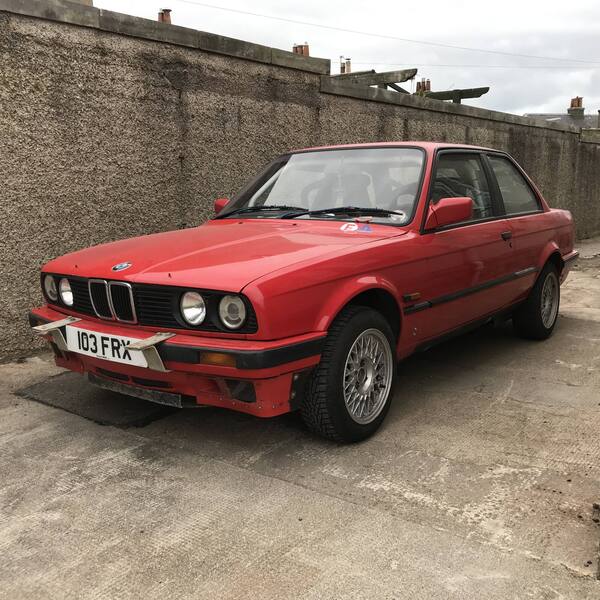

dc2100k Posted March 28, 2021 Author Posted March 28, 2021 Here we are nearly a year later and what a wasted year it’s been. The red bimmer has been out a few times for a blast but all events last year were cancelled after the Mull Classic in March so no proper action. Now that we are hopefully heading out of total lockdown in the next month or so I have taken to preparing the old girl for the 2021 season. Need to get a ticket so the most pressing issue is to wire up the front lights - tricky as it had sealed beams H4 and fogs to comply with the road rally regs but I'd like to go back to the standard setup. Otherwise I think it'll go through no problems (apart from the tester even getting into it). Plan for this year is mostly tarmac based so I've put some 7.5" rims and Rainsports on her and some fast-road springs. Also the cut up front valance and cracked bumper was doing my head in so I found a cheap Hellrot bumper/replica MTech 2 skirt and am mid-way through sorting out all the fabrications required to attach it to the car. Easier than prepping, painting and fitting an original valance I suppose 🤪 Finally the car has had the PAS removed so is pretty hard to steer at low speeds and was fitted with a pretty rough 300mm wheel. Imagine my joy when FB marketplace helpfully pointed my nose in the direction of a lovely 2-spoke MOMO dished wheel for sale locally. Channeling my inner Delta S4 & Integrale now... Tickman, dome, Dave_Q and 2 others 5

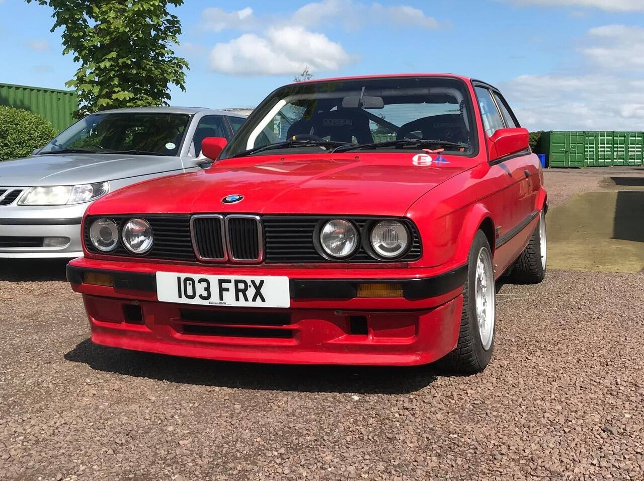

dc2100k Posted May 11, 2021 Author Posted May 11, 2021 Big day today, the E30 went for a drive on a public road to a garage for some last little bits and pieces/its test, officer. Most of the rust *repairs are done and she's been tarted up a little bit. Words are boring, pics better: Unpainted filler is the preferred look. Still need to be lowered c.40mm on the front. Dick Cheeseburger, motorpunk, EspenO and 5 others 8
