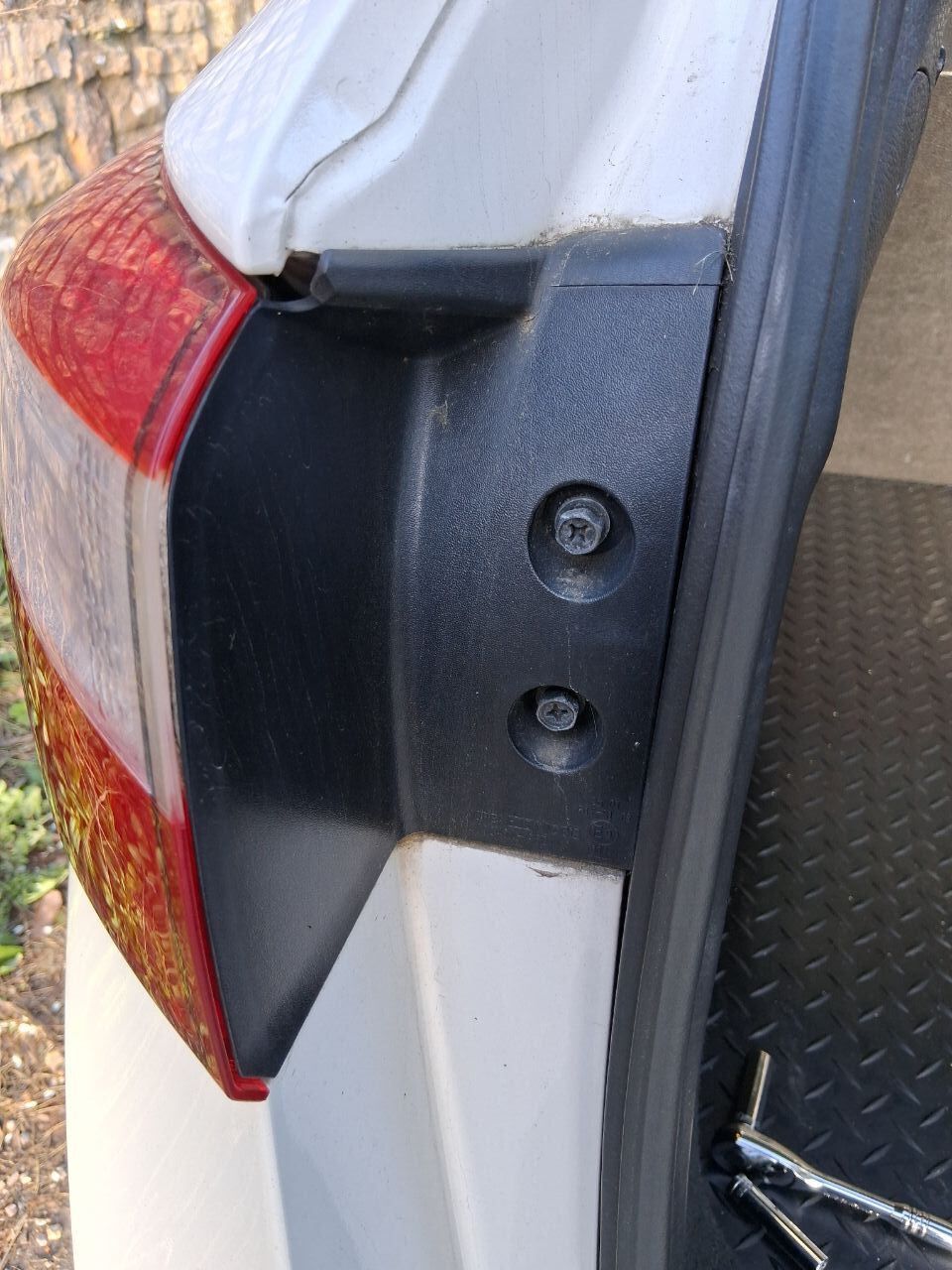

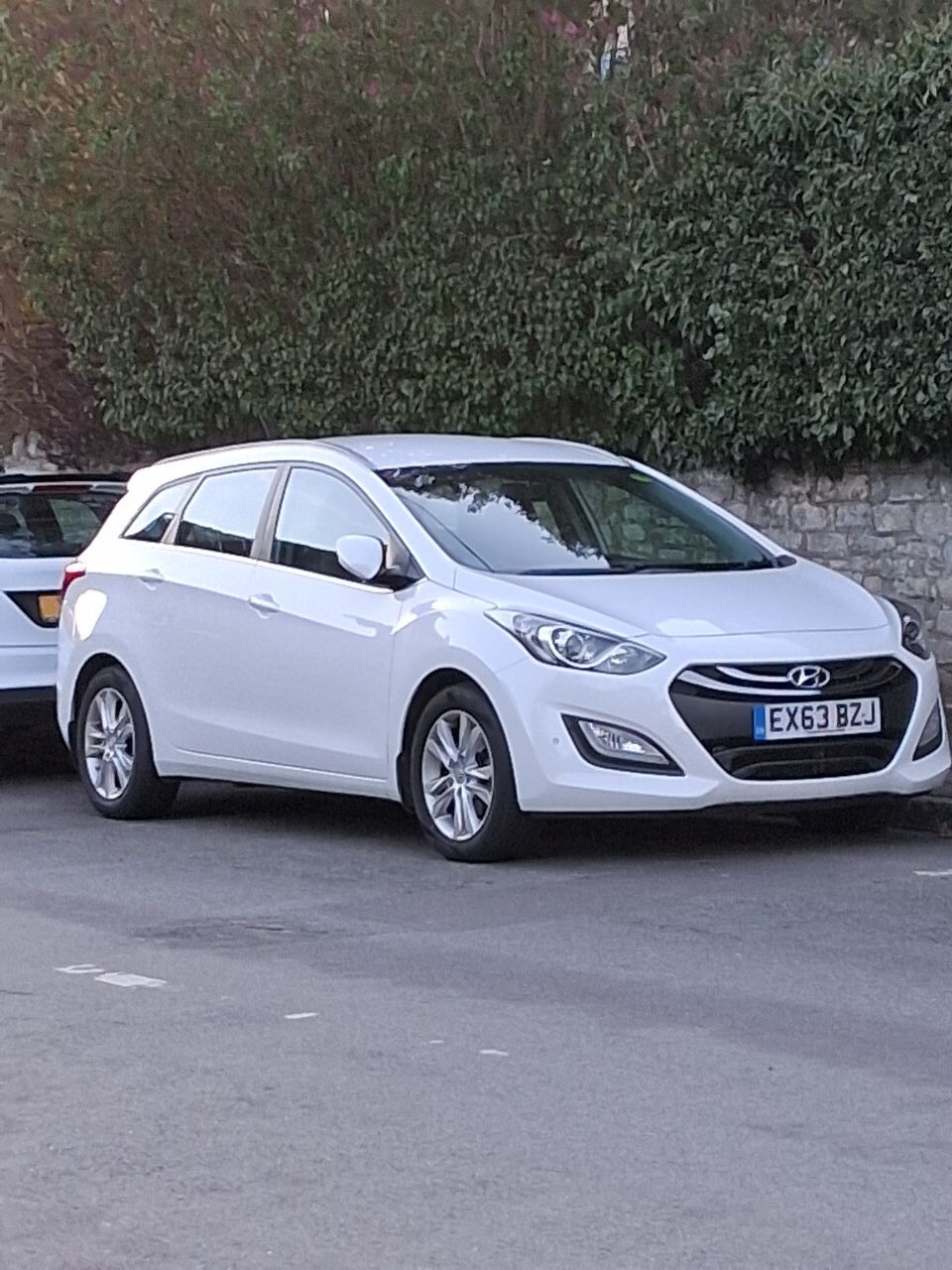

Onto the i30, with its blown light seal.
Replacement already prepped.

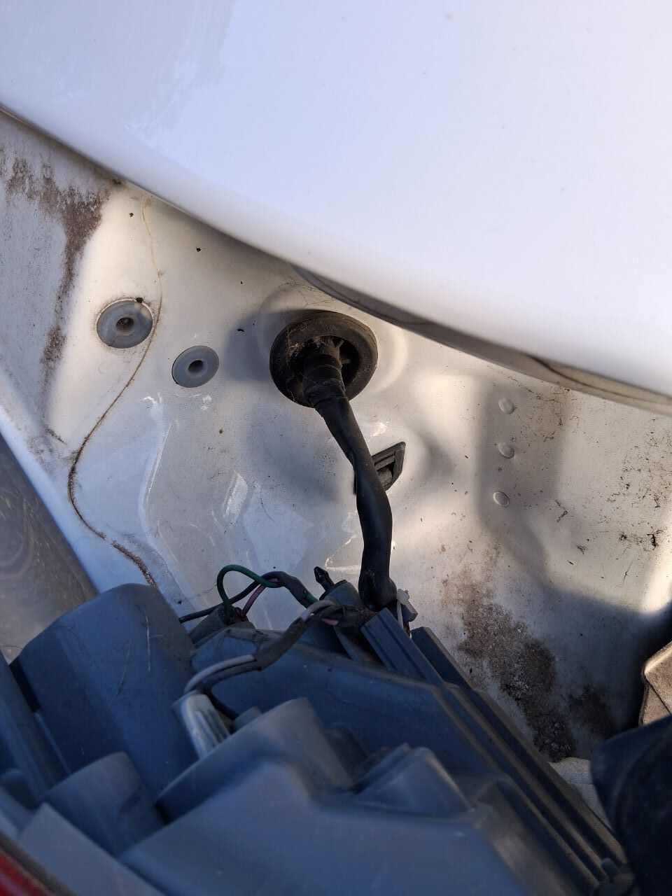

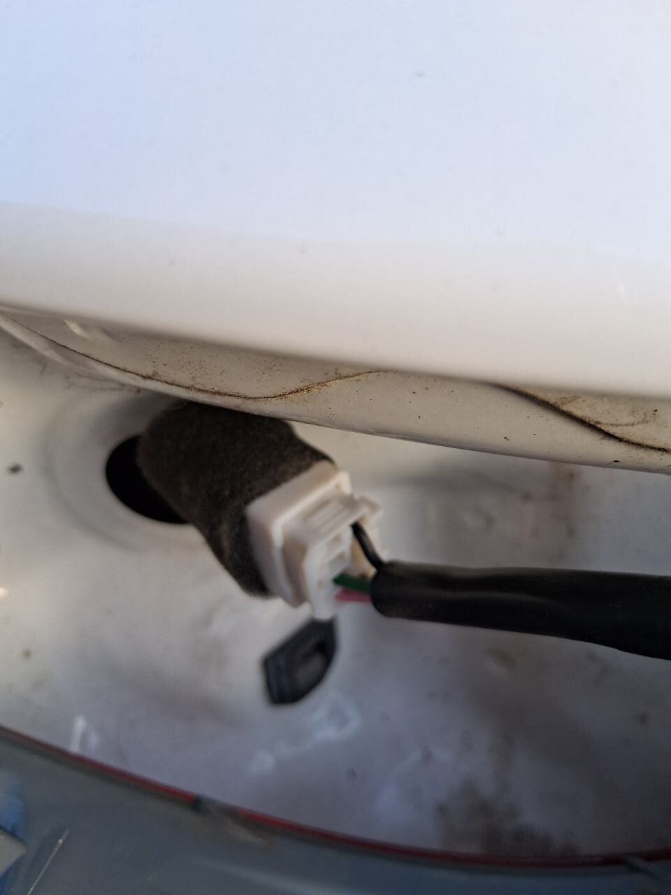

Easy to change. Two 10mm bolts
Give it a good tug, to pull the unit off the retaining lug.

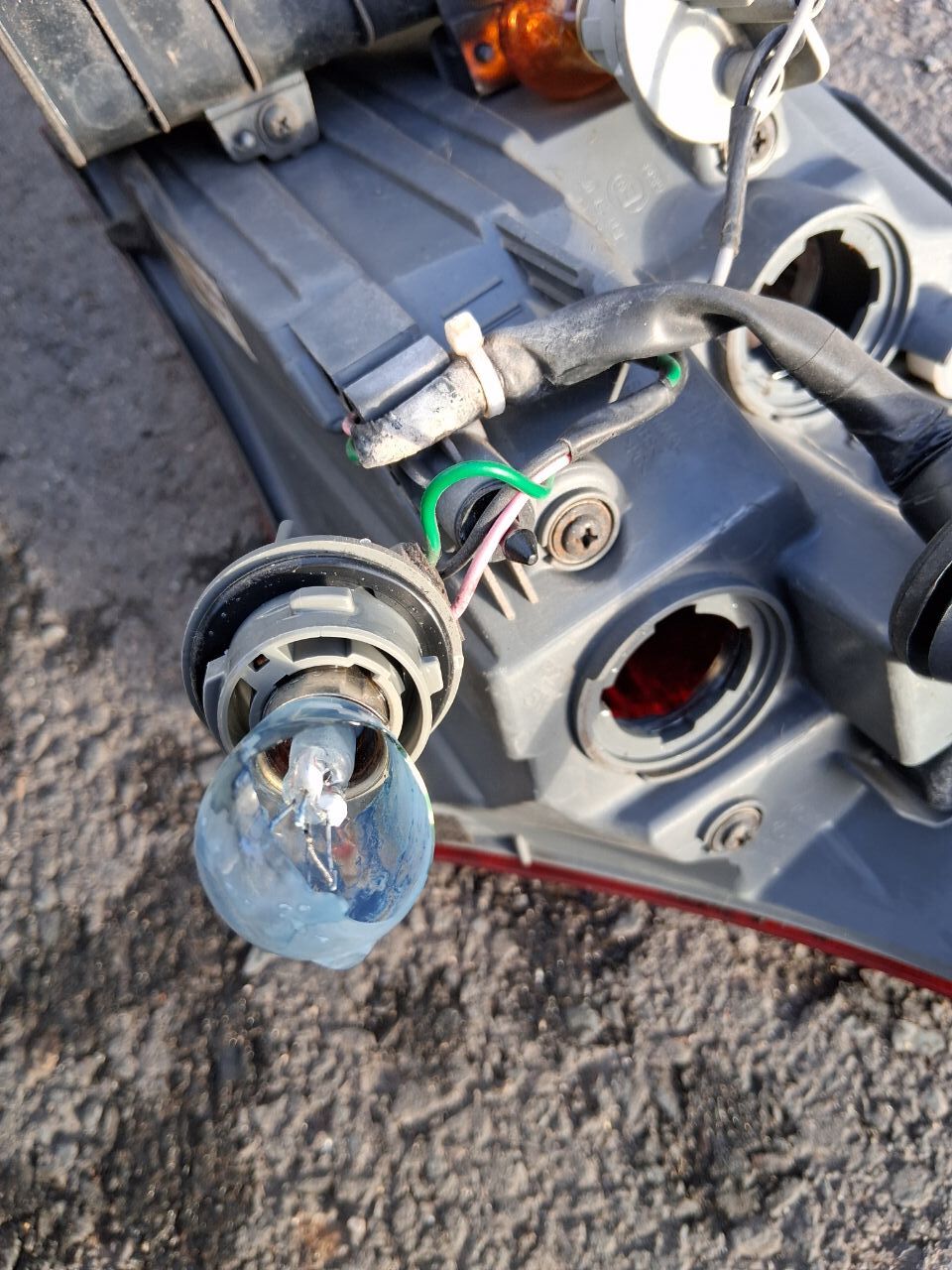

Then pull out the grommet to acces the electrical connector.

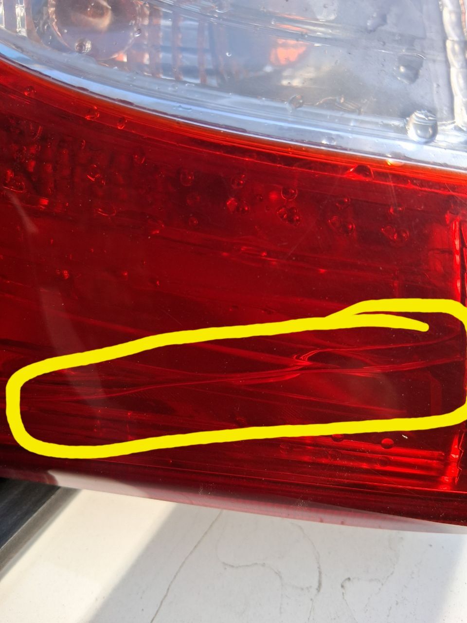

The old unit had its own swimming pool. The water line circled in yellow.
The indicator, which sits in the clear lens above the red, also had a smaller swimming pool of its own.
The tail / brake light clearly did not like sitting in water.
Replacement unit plugged in and bolted back in.

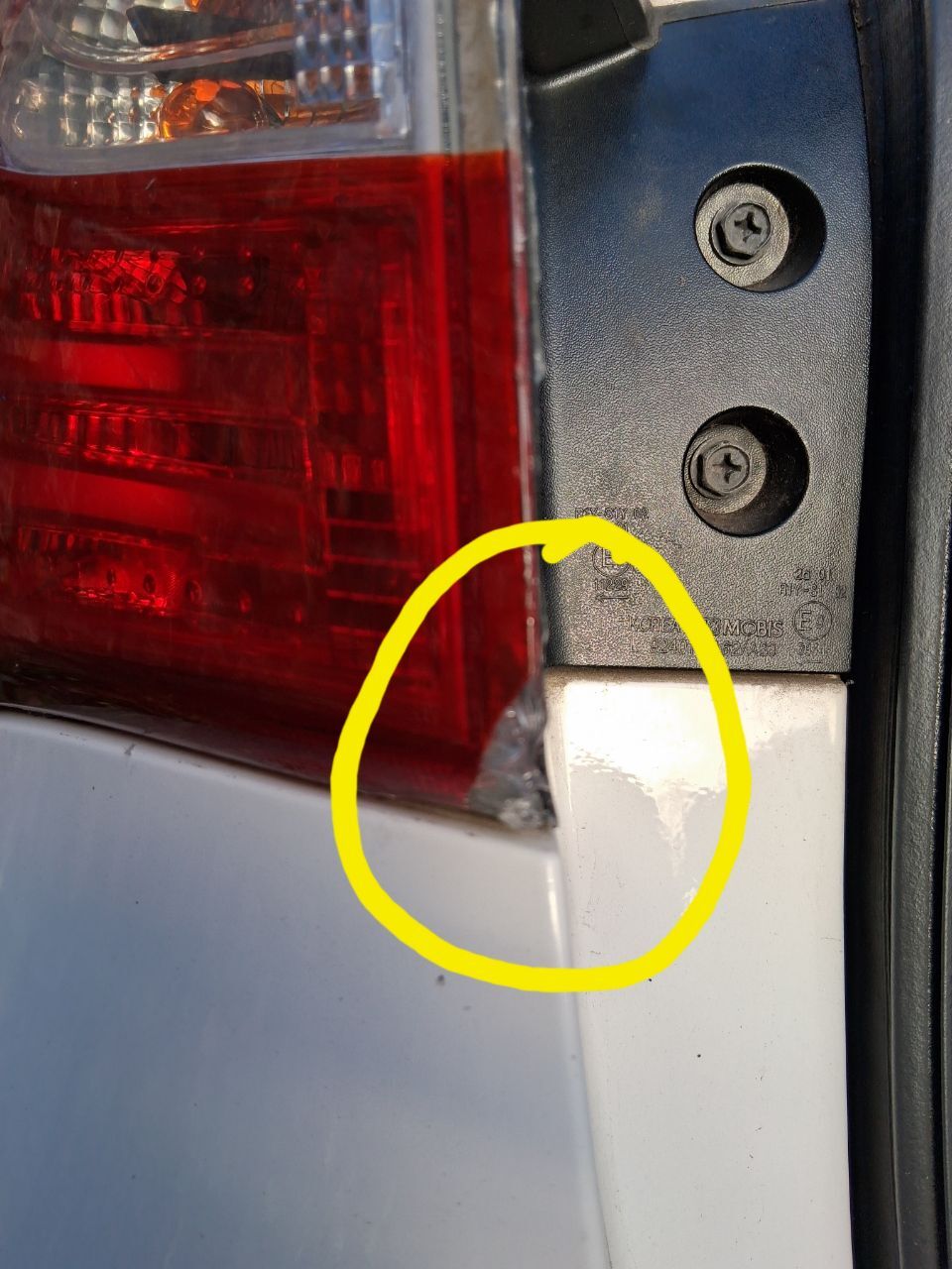

The replacement has damage on one corner. Ive used silicone to seal it. If it were not for this, I would just leave it.
I will try and dry out the original unit and then seal it up.
But first I need to find a replacement for the offside unit, as that is misting up, but no swimmimg pool yet.

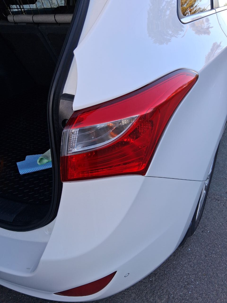

Offside light replacement on i30.
The new to me unit turned up from the scrappy.
The original unit has some condensation and water droplets in it - nowhere near as bad as the nearside
Bulbs in tact, so swapped them over to replacement unit.
Even though the unit is temporary, I practised my silicon skills again.
I'm getting better at it.
New unit in. Wont be permanent, as its got scratching on lens. But looks ok.
I didnt drill any holes in the original unit, as I learnt my lesson from the first one.
Luckily a hot day, left it out in the sun and all the moisture is out. Will silicone it tomorrow night.

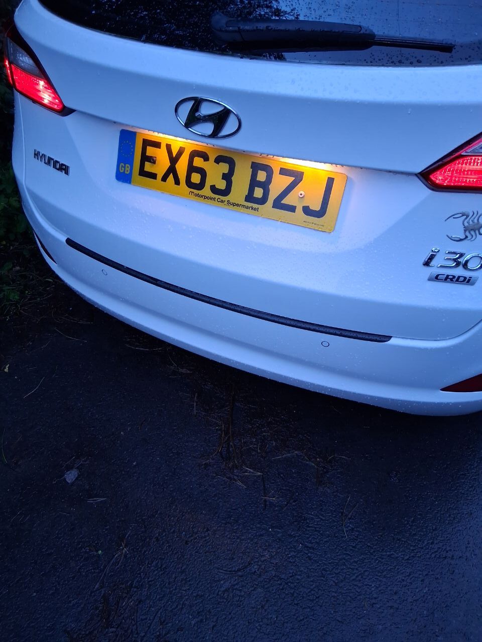

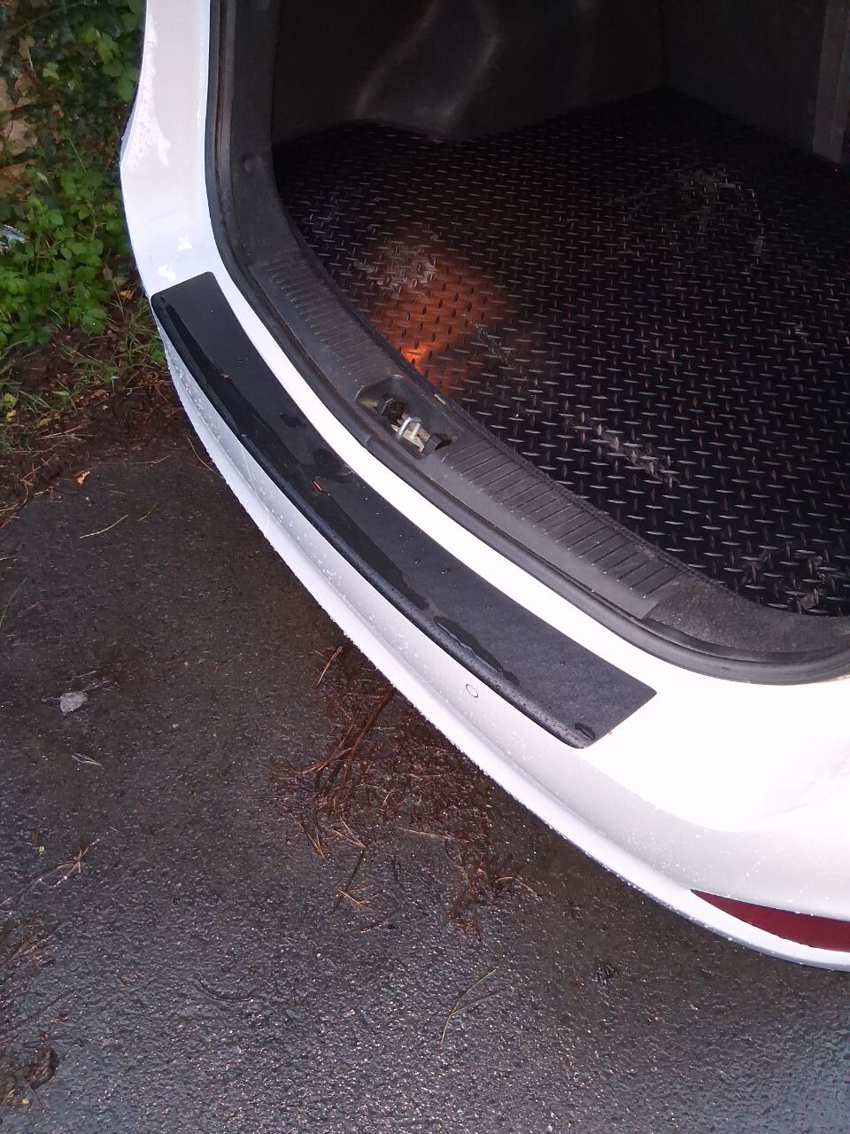

Between showers, the rear bumper protector was fitted, that arrived from Germany.
Only available in Black.
Bit smaller than I expected, but will provide some protection when loading the wheelchair.

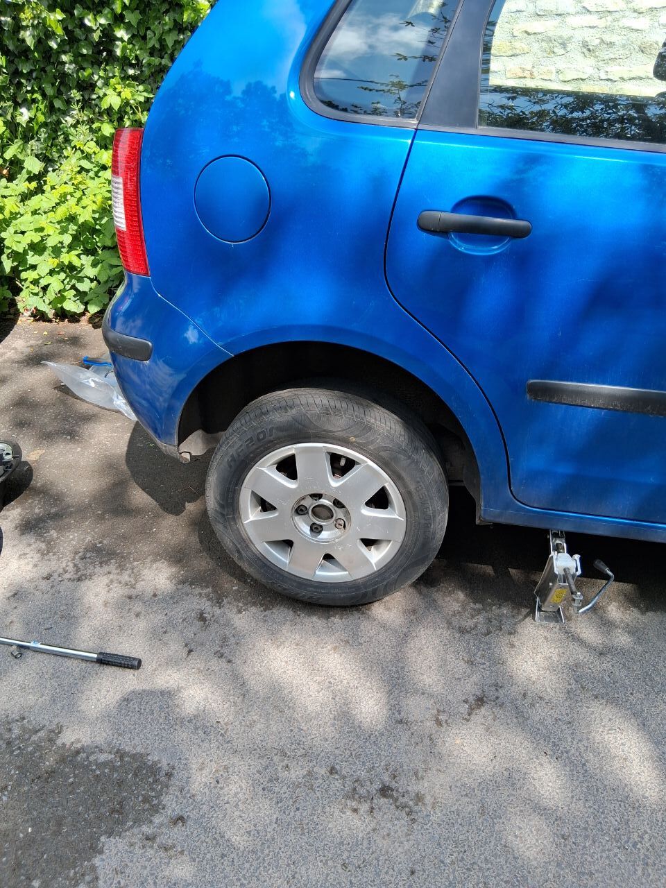

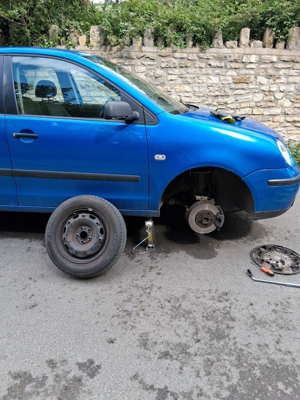

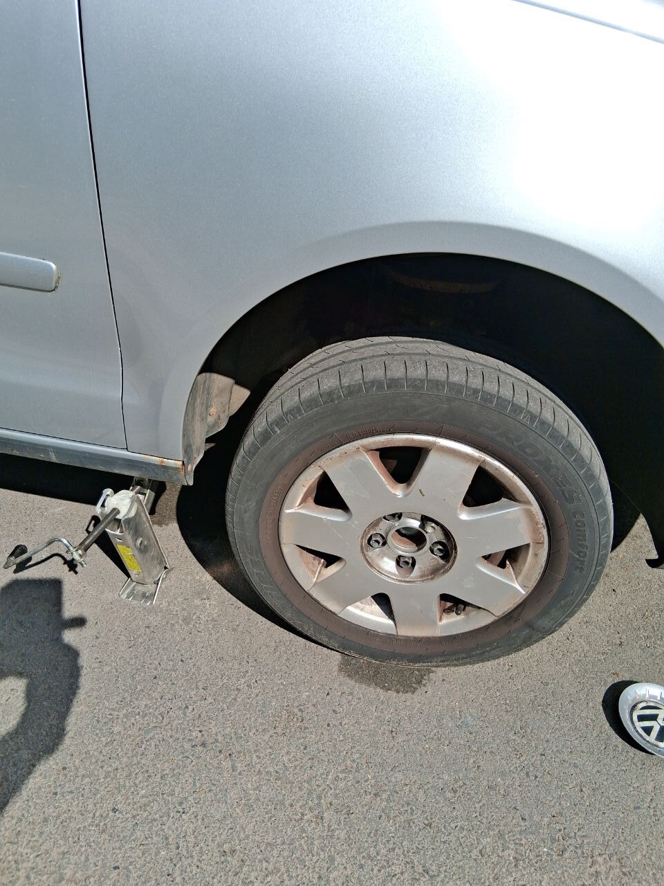

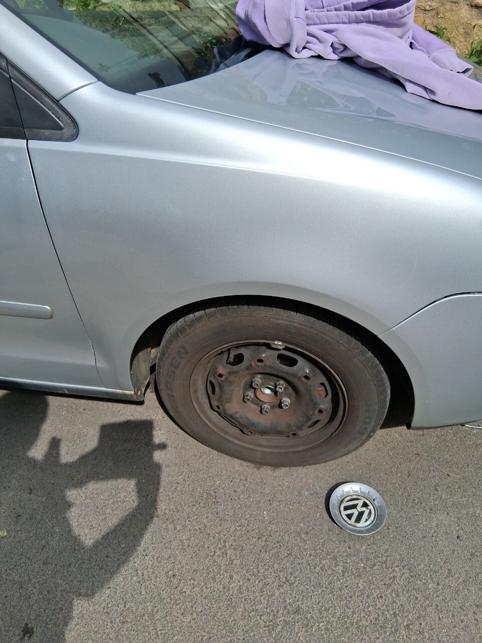

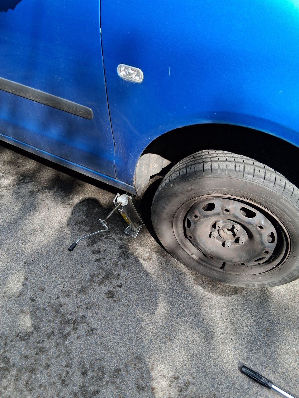

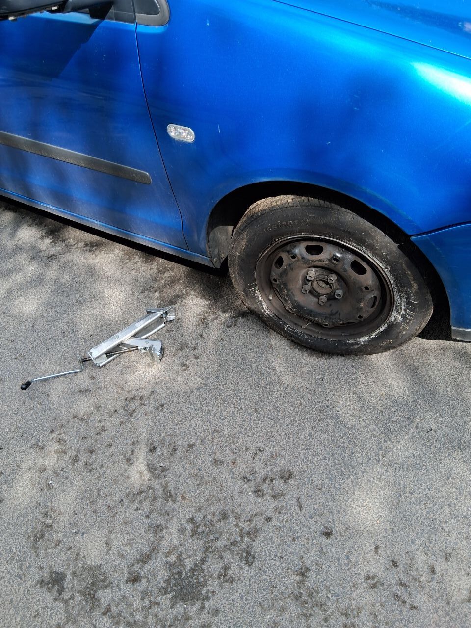

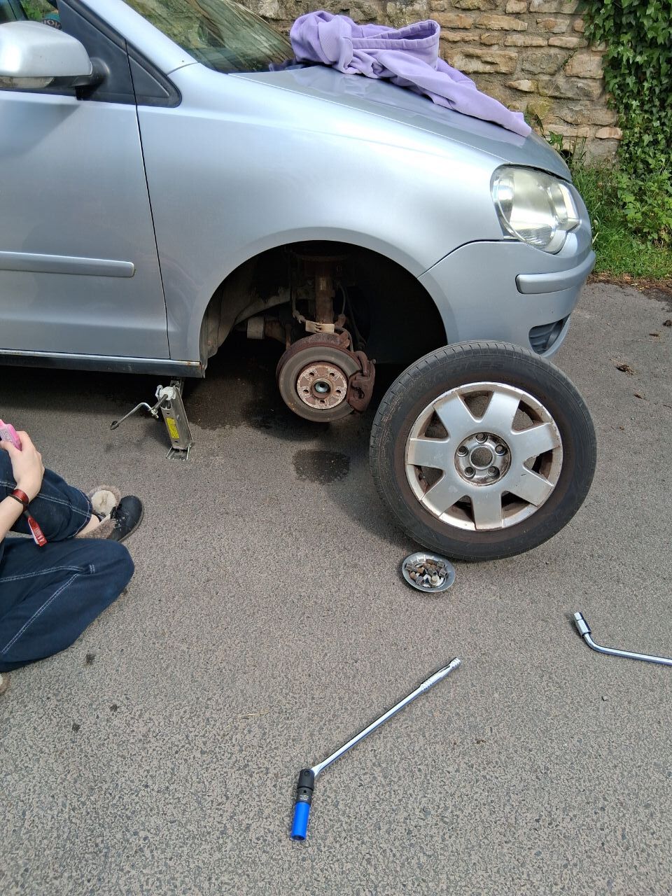

This morning was wheel swap day. Which turned into a teaching session for Jr.
Wheels to be taken from my (Jrs ex) 9N polo and swapped with her current 9N facelift polo as her alloys are knackered due to corrosion and the small accident last week.
Both jacked up at same time. Front drivers side first.
The alloy waa not put on the blue Polo OSF as it was the damaged one, with bulging tyre. So I used the spare from my Polo.
Silver Polo gets stealies.
Repeat 3 more times.
Blue polo now has a 3/4 set of alloys.

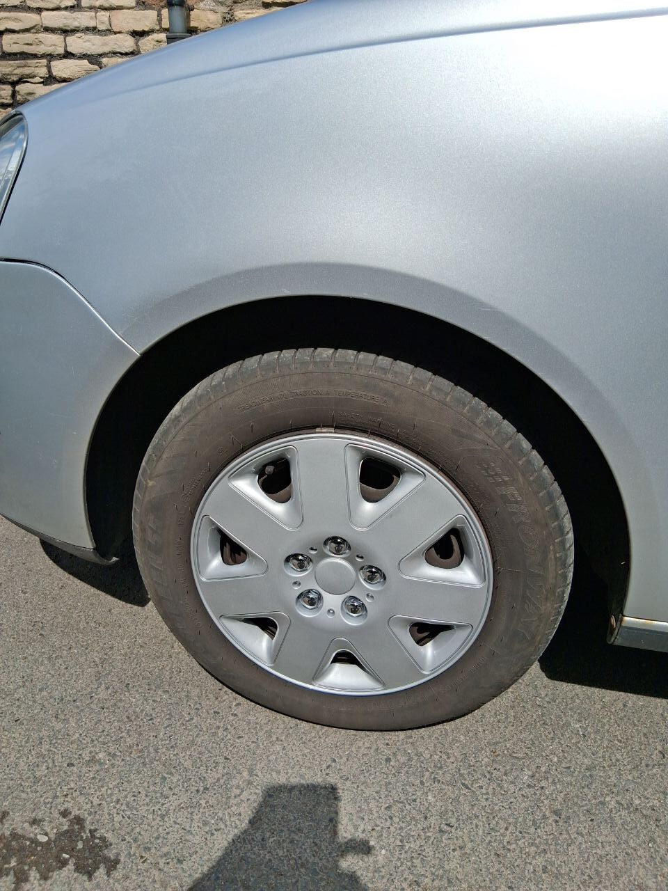

As the original wheel trims were knackered, a 19 quid set of Amazon Value trims were ordered and fitted to Jrs. By chance, very similar in style to the original alloys.
Two zip ties added per trim, later.

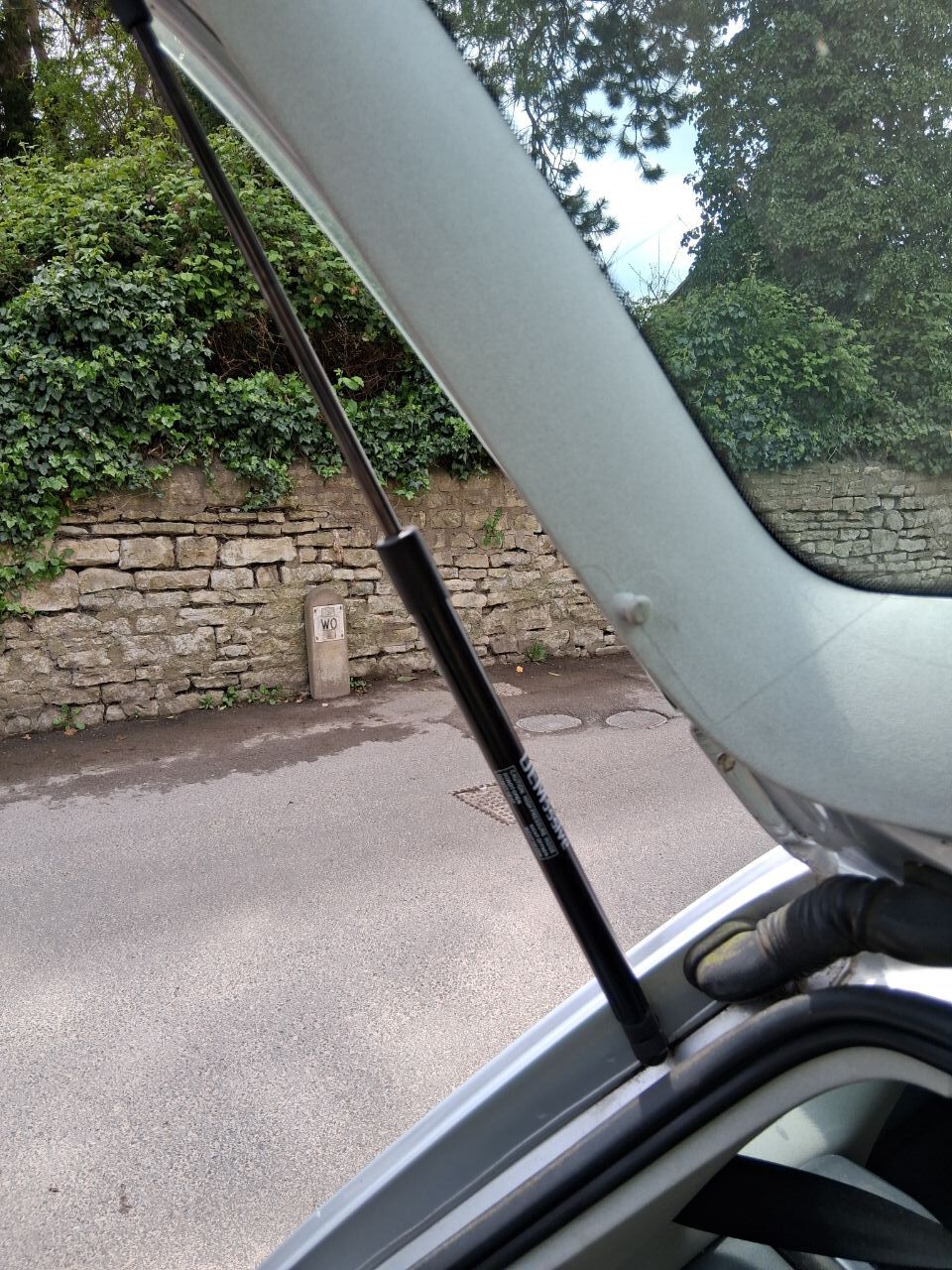

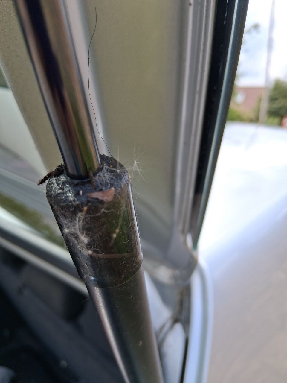

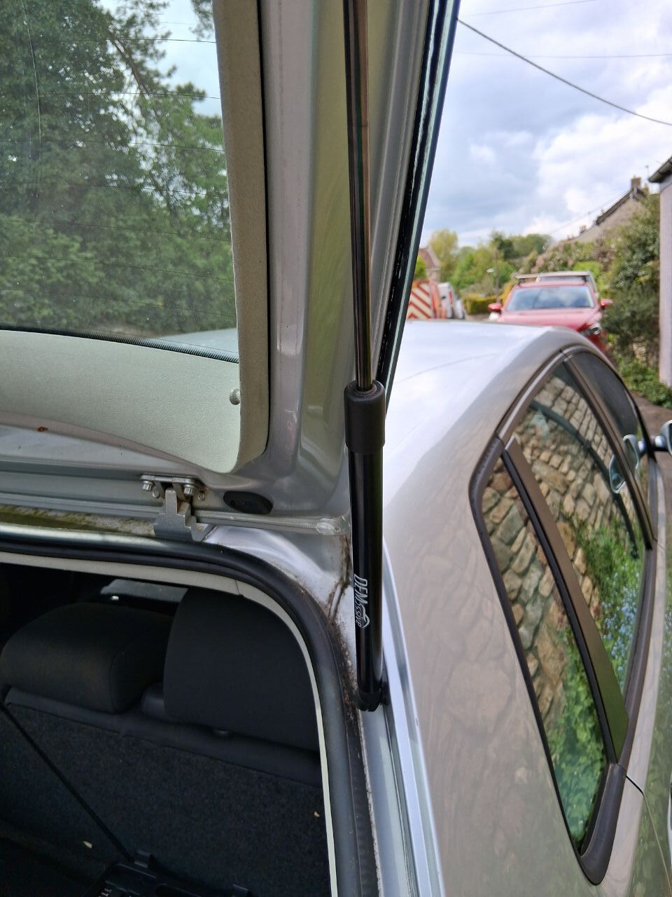

Her boot rams were leaking and struggling to keep the boot lid up.
Blue Polo had newish rams, so they were both swapped over.
Jr has now changed 8 wheels. Training complete. Plus 4 boot rams. She told her mum she enjoyed it.
Ive not torqued up the nuts yet, so kinda wishing Id not ziptied the trims on :(

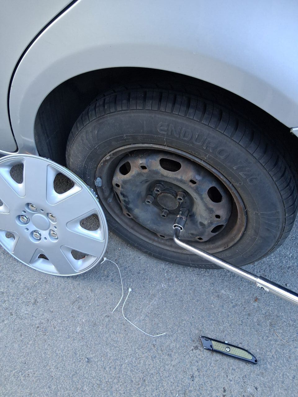

Jr asked if the car was ok to take out tonight.
I said of course and did you tighten the bolts up, once the wheel was on the deck, like I showed you on the first one.
I 'might' have done.
So, zip ties cut and trims removed :(
Entirely the teachers fault. I should have checked them.
Well the one I used for demonstration purposes was fine.
The other 3, not so fine lol
All tightened and trims back on. Only 2 zip ties left, so both fronts got one zip tie each.
