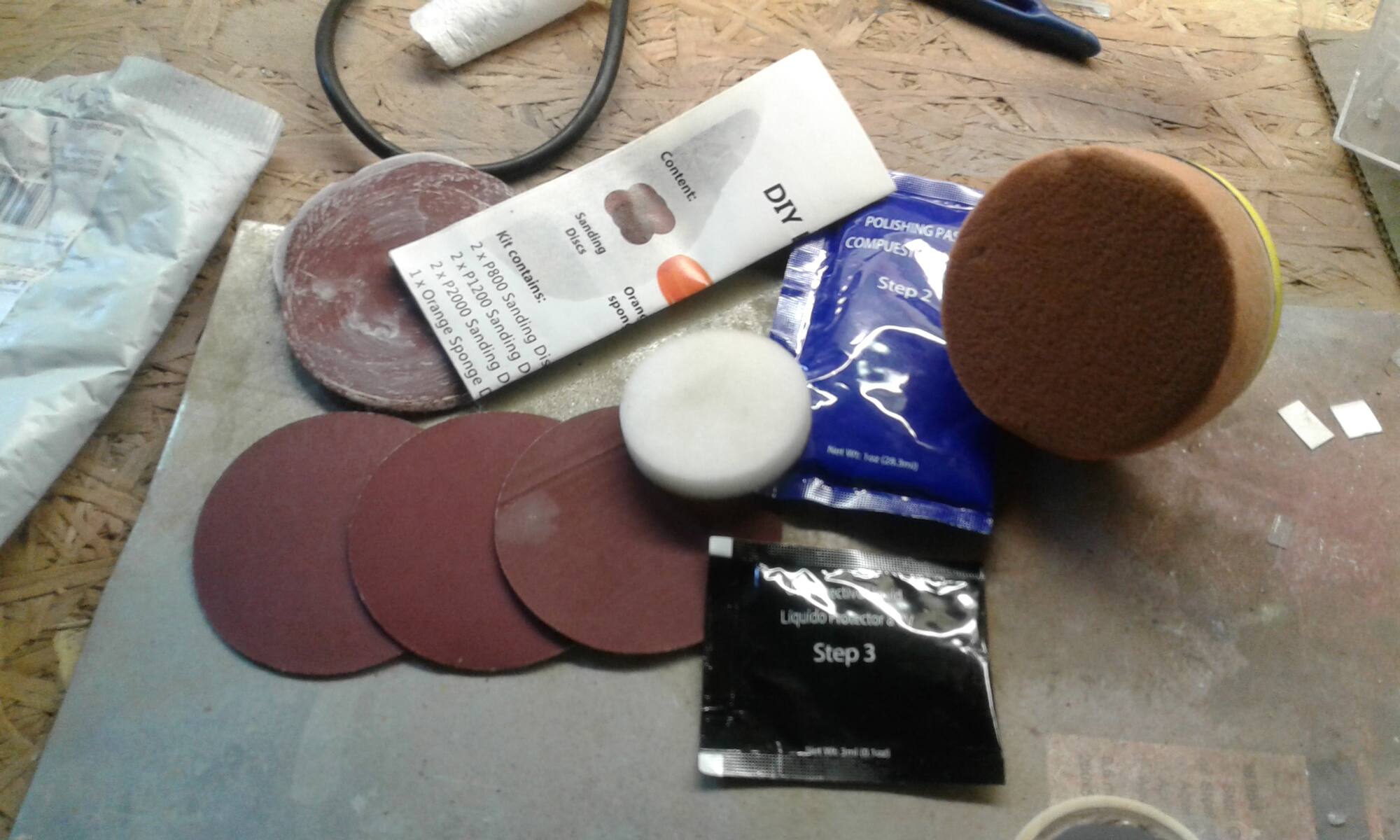

I just done the lights on my van on Sunday.  I was a bit nervous about attacking soft plastic with sand paper.
They turned out ok :)
I used a kit from ebay, think it was 5.99, it contained a rotary mop with velcro to hold the various grades of paper, polishing compound etc. Also a final sealing polish
which I guess is to protect from uv.    I'll have to wait and see if that works.
Got any pictures?

Got any pictures?
Kit contained two of everything, except the mop. I done both lights and there's enough left to do it again if needed.
No before pic of lights, they were heavily yellowed.
I can see in the dark now :)
I can't find the attachment for my drill to put the sanding head on it, so I did mine by hand, with just G3 compound, no sanding.

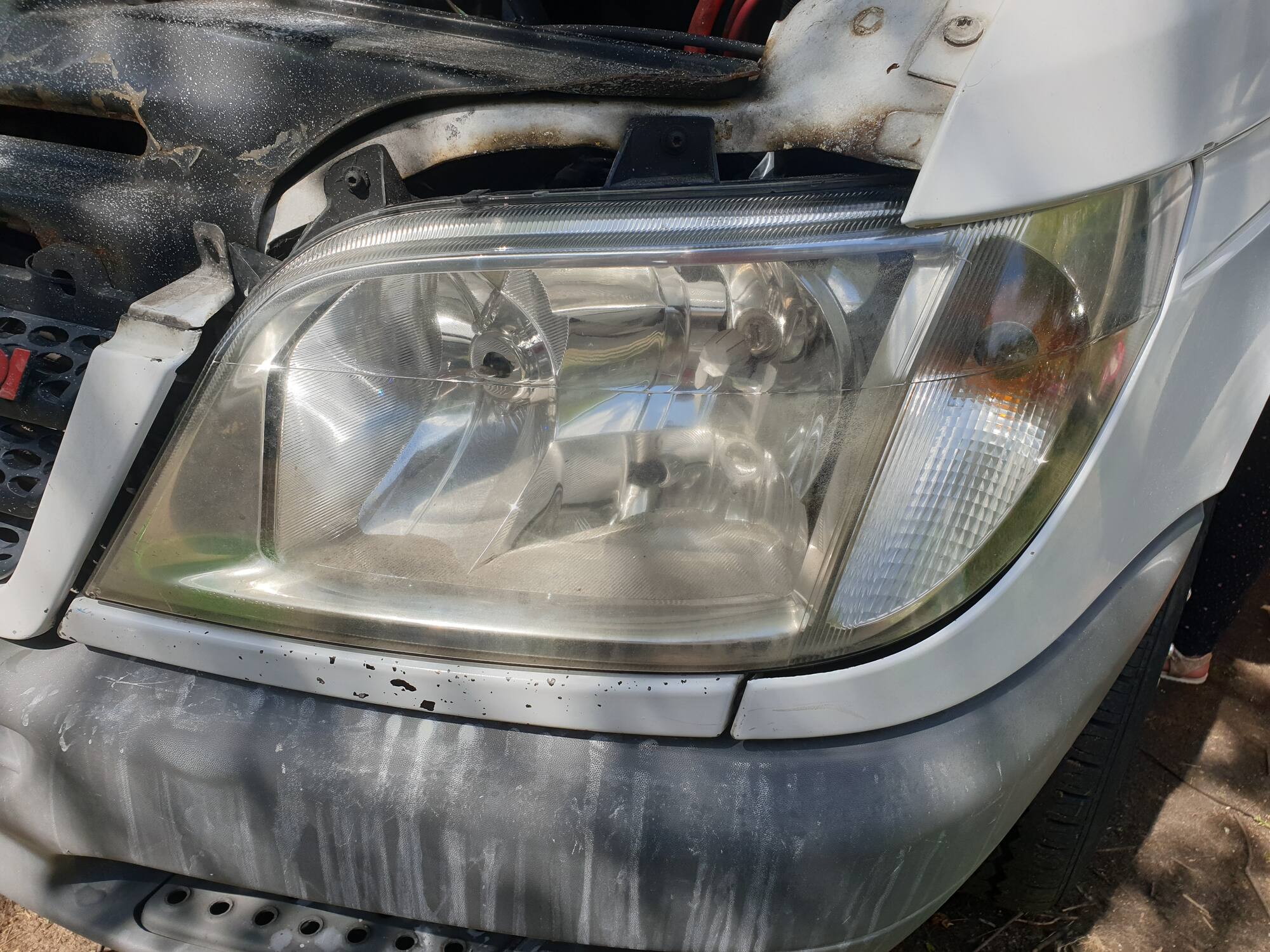

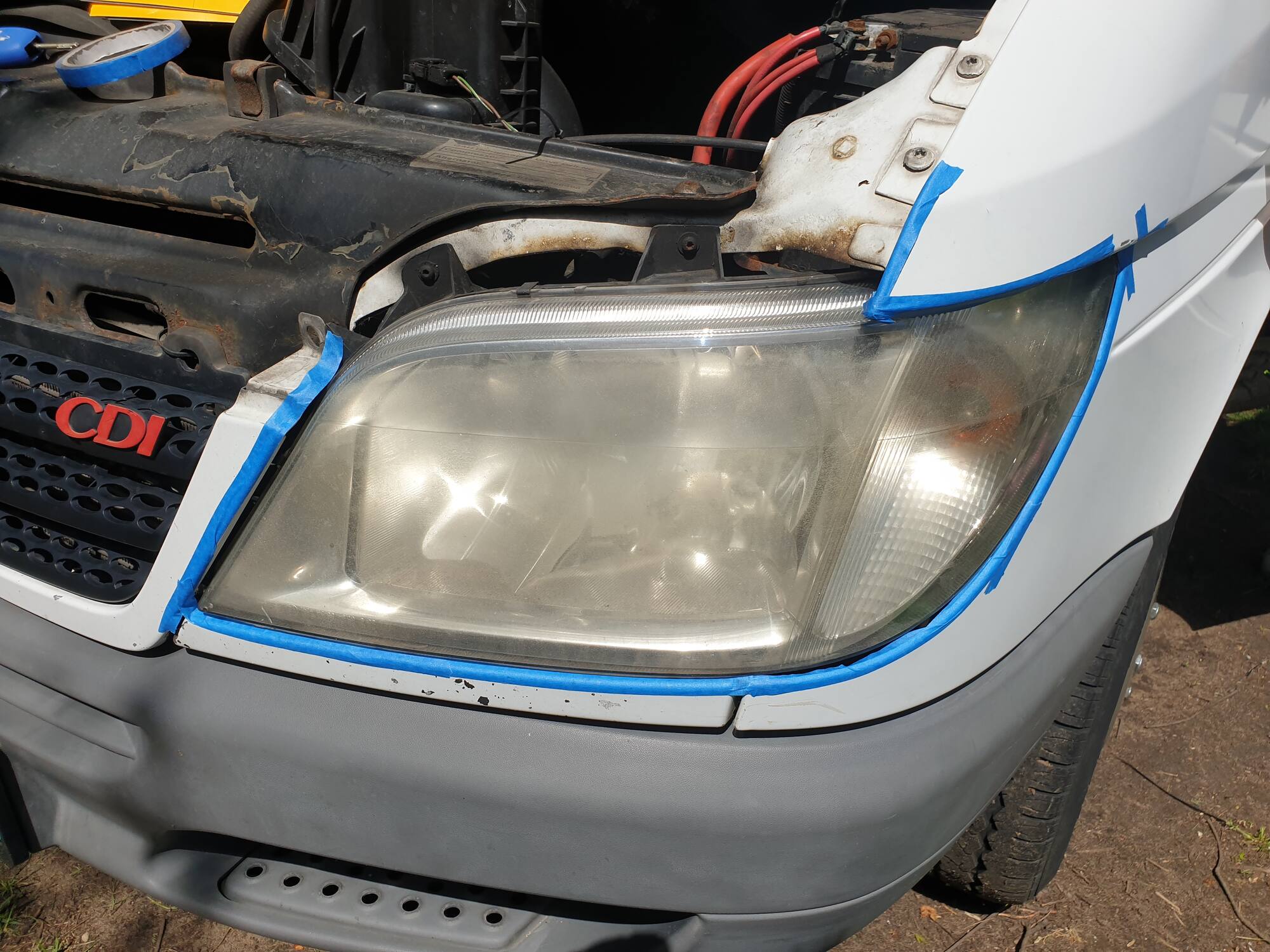

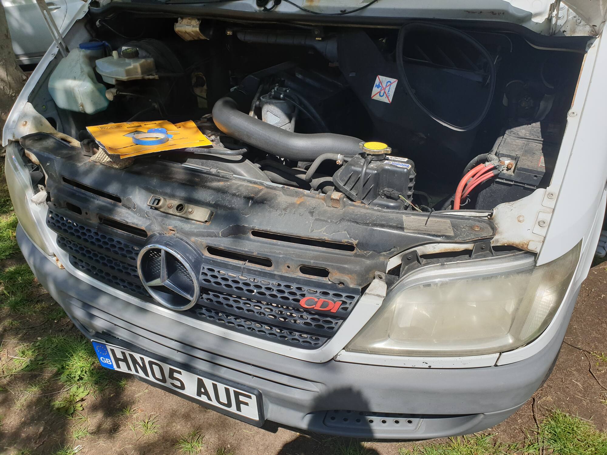

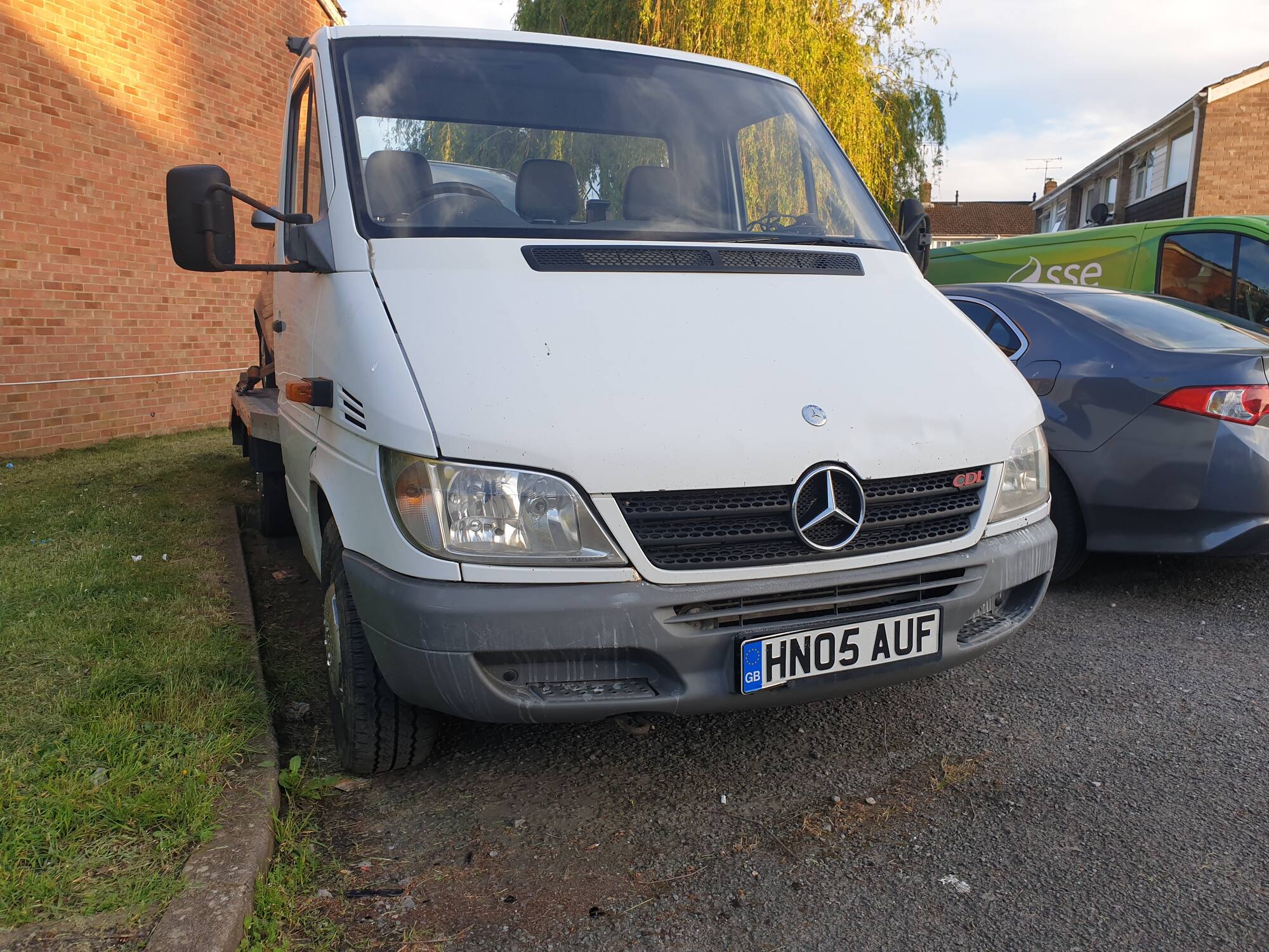

So, with the weather suitably dry and sunny today, I parked the truck infront of the house and myself infront of the truck with a bucket of water and the old 1500 and 2000 wet and dry paper.....
After taping her up with the blue tape, I just took my time as I did the Audi back when I did that last. Now, these headlights were pretty much past it and had been bad ever since I bought the truck. It was one of those jobs I had been putting off for ages.....
Anyway, they are better but will never be IMMACULATE because the light inside overtime has also discoloued and dulled the chrome surround and the plastic casing on the inside....
Despite this the light output bizarrely was still pretty good despite how bad a state they were so hopefully should be exceptionally good now!!
Now for a few pictures....not sure if the pictures do it justice....thoughts??
Before..
taped up....
And passenger side...done!!
halfway through....
and all finished.....

Absolutely aware of this so the plan is to do once and keep on top of, I machine polished a 3m cutting compound after the sanding then applied 2x coats of Collinite 476 wax left to dwell for some time then rubbed off.
I used t-cut would you believe back on the Audi with my machine polisher and admittedly it did a fairly decent job!
Like i say, there was only so far I could improve it because of the inside of the lense and the reflective chromey bit now full due to age and sindging from the heat output of the bulbs themselves......
Many had said they were too far gone but I think I've made some sort of improvement.....you can see the bulbs through the lenses now whereas before you couldn't see anything!
