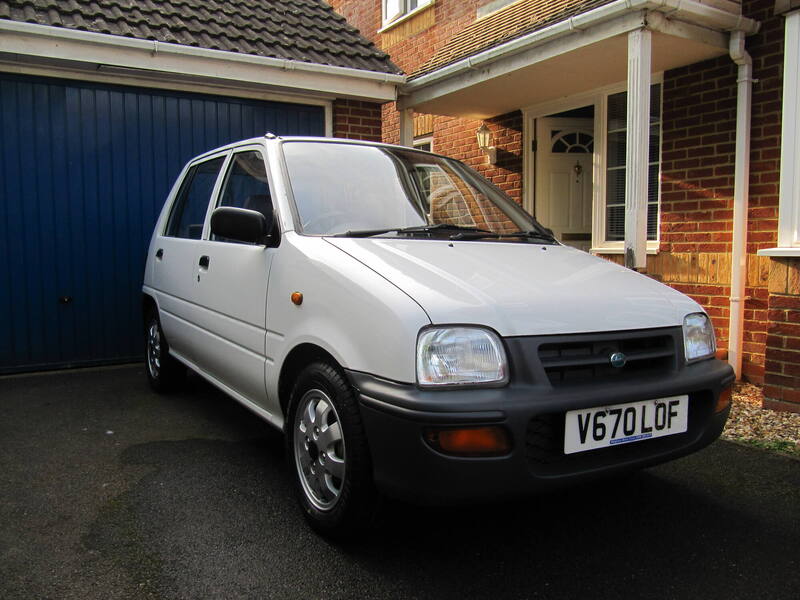

Steve G Posted September 24, 2019 Author Posted September 24, 2019 Not much to report other than the knocking from the passenger side is getting worse and the drivers side brake caliper is sticking ! I did fit new CV boots to the passenger side driveshaft and these nearly fit although the clips supplied didn't. I think the correct term is well packaged. I had to fit a couple of stainless steel band type bands to clear the gearbox casing. I've also bought some front shocks. I think they are going to fit but won't know for sure until I remove the old one and have a proper look. Perodua UK don't have stock and there aren't many aftermarket options. I will report back with my findings. Bamboocarman and 500tops 2

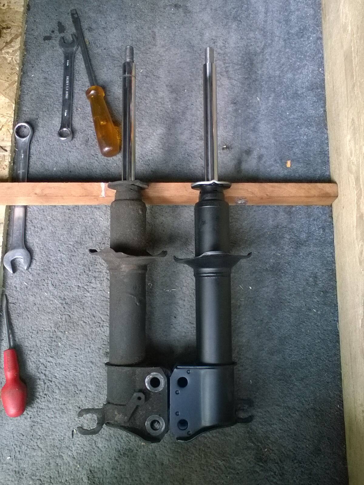

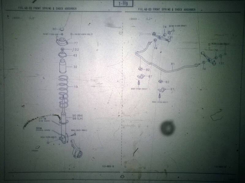

Steve G Posted September 27, 2019 Author Posted September 27, 2019 I've been collecting parts, or at least trying to. Something front shock related is banging and crashing about so I now have a pair of new KYB ones to fit. I don't know if they are the right ones but were listed for a Daihatsu Mira of the right age so I have my fingers crossed. I've also ordered a set of rear ones, from Germany and got a dipstick from the Isle of Wight. I really wanted a parts book of some sort and spotted a Mira microfiche for sale, also in Germany. I got this today so dug out the old reader I have and gave it a try. It seems that some of the more important bits at least have the same numbers as the Perodua so I might have got lucky. I could photograph each page but think I might go mad before finishing it ! GrumpiusMaximus, Bamboocarman, RayMK and 1 other 4

Steve G Posted October 6, 2019 Author Posted October 6, 2019 I finally got the chance to fit the new front shocks I bought today. I was a bit worried they might not be the right thing as I had to special order them and they couldn't be returned. Fortunately my luck was in and the ones I got are the same apart from the lower spring pans being between 5 and 10mm lower on the strut. This has lowered the car slightly which is no bad thing. The front brakes have been sticking slightly so as a first step I de-rusted the caliper sliders. It's had new pads fairly recently so it's likely the pistons are sticking but I am hoping that the sliders will fix it. Dan302, auntiemaryscanary, 500tops and 2 others 5

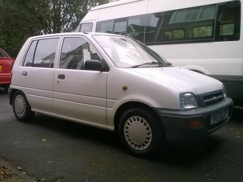

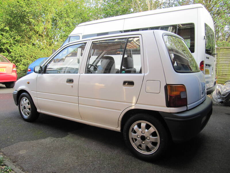

Steve G Posted October 21, 2019 Author Posted October 21, 2019 Thought I ought to update the pictures although it's a bit dull outside. The new bumpers that I got with the car are now fitted. The front one was broken and the rear just faded. The main reason I got involved with the front one was that the drivers side corner had been walloped at some point. There wasn't much visable on the bumper but the inner wing /healdamp panel were a bit bent. Worse still was that the headlamp mount was broken. I'd spotted some headlamps on ebay so grabbed them quick. After a fair amount of bashing I got the headlamp to fit OK and the bumper was then fitted. 500tops, theshadow, egg and 3 others 6

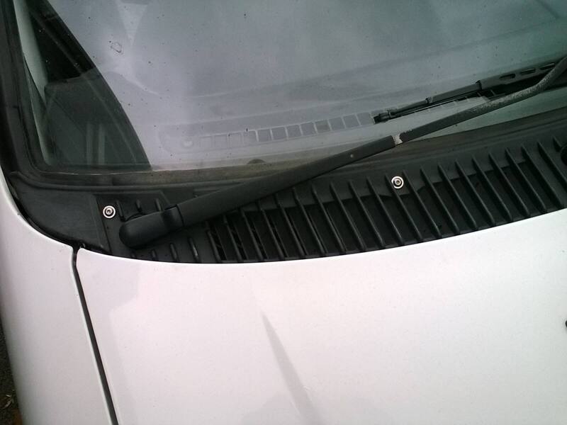

Steve G Posted October 21, 2019 Author Posted October 21, 2019 While I was messing about under the arches I remove the mud flaps. They have steel re-enforcement's in them which were very rusty so unless I can find some new ones I will leave them off. The scuttle panel was also flapping around as some of the plastic rivits had gone missing. It got caught and damaged by the bonnet hinge so I fitted rivnuts and fixed it down properly with some fancy stainless bolts. Dan302, 500tops, Aston Martin and 2 others 5

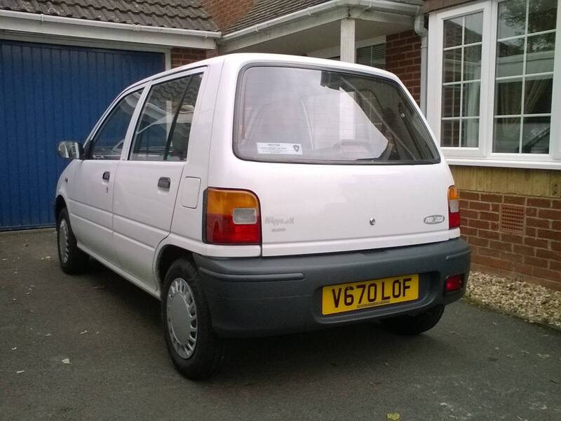

Steve G Posted October 21, 2019 Author Posted October 21, 2019 The rear bumper was fairly easy apart from having to modify the fog lamp hole to make it fit. I'm not sure what to do about the stickers on the back. The Nippa ones is in a pretty bad way so I am tempted to pull it off. I will let my son decide. egg, Aston Martin and jumpingjehovahs 3

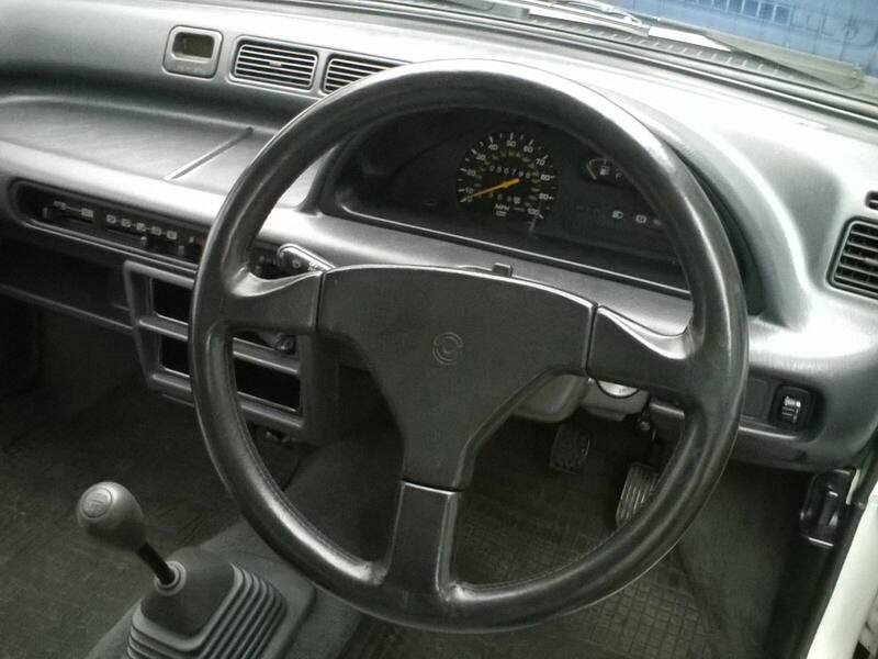

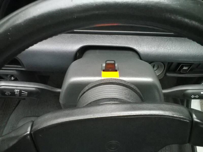

Steve G Posted October 21, 2019 Author Posted October 21, 2019 One thing he has been waiting for is the new steering wheel. The original one was a bit grotty so when I spotted this one come up on ebay with a nice padded centre pad I bought it. The boss was another abay find and was listed for a Mira so on the strength of my shock absorber purchaces I took the chance. I had to re-drill the one in the back for the indicator cancelling mechanism but it fitted OK apart from that. Does look too out of place fortunately other then being black not charcoal grey. I had to repair the column cowl as it had cracked by the hazard switch. The switch isn't very obvious so to cover up the repair I stuck a bit of orange vinyl over it so it's almost supposed to be like it. egg, theshadow, auntiemaryscanary and 7 others 10

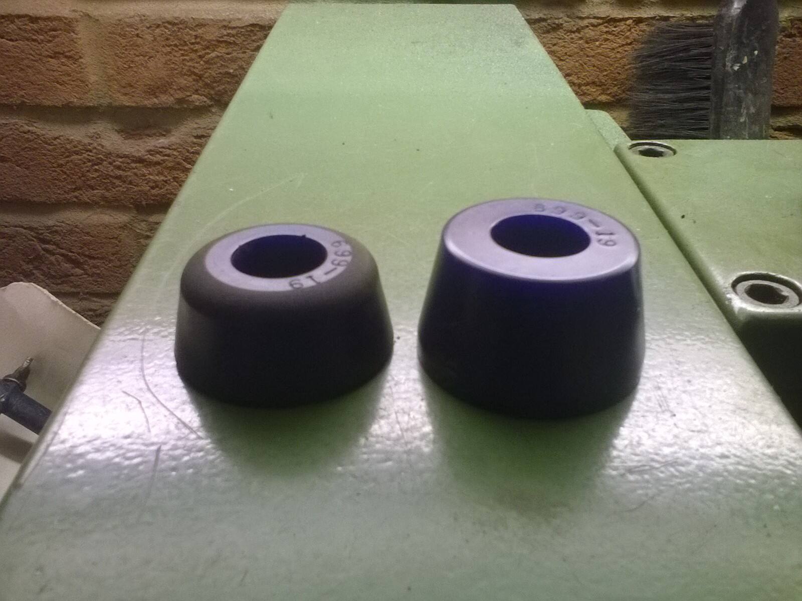

Steve G Posted November 1, 2019 Author Posted November 1, 2019 I bought and fitted a set of new ARB to lower arm bushes but wasn't happy with the way they fitted. I have been investigating the options and bought a set of Polyurethane ones but they are a lot too small . They are listed for a Daihatsu Mira but either they are for an earlier spec Mira or Perodua have changed them. After a lot of searching I have bought a set of bushes from Superpro and another set from Superflex who used to be the UK devision of Superpro. Confusing isn't it. I got one set this morning which should work once they are trimmed off to the correct length but I will wait until the second set turn up as they might be a closer fit. I have also placed an order for springs from a UK manufacturer. They list a set to lower the car 40mm front and rear which I think is a bit low on the back. I have asked if they can do some 10mm higher on the rear so I will see how these work when they arrive. I'm not sure if modding is in keeping with the Autoshite way but it's my sons car so I have to do what he says. I bought him a model kit of a slightly earlier Mira for his Birthday and he want a set of wheels like the ones on that. Getting any wheels that will fit is going to be a struggle. I've had nasty thoughts or 6x12 trailer wheel rims on standard centres but her wants alloys ! Found a picture of a kit someone else has built. egg, Dan302 and mjrose78 3

Steve G Posted November 2, 2019 Author Posted November 2, 2019 I sorted the bushes out for the front suspension today. The Toyota AE86 ones turned up this morning and it turns out they are the better fit. I had to cut them down length wise as they needed to be 20mm. The standard tool on the lathe just about cuts them so once I had mounted them on a suitable mandrel I trimmed them down and rounded the end off that goes into the lower arm. It's back togethr now just need to set the tracking prperly and hope I don't have to mess with them again for a while. shedenvy, rainagain and egg 3

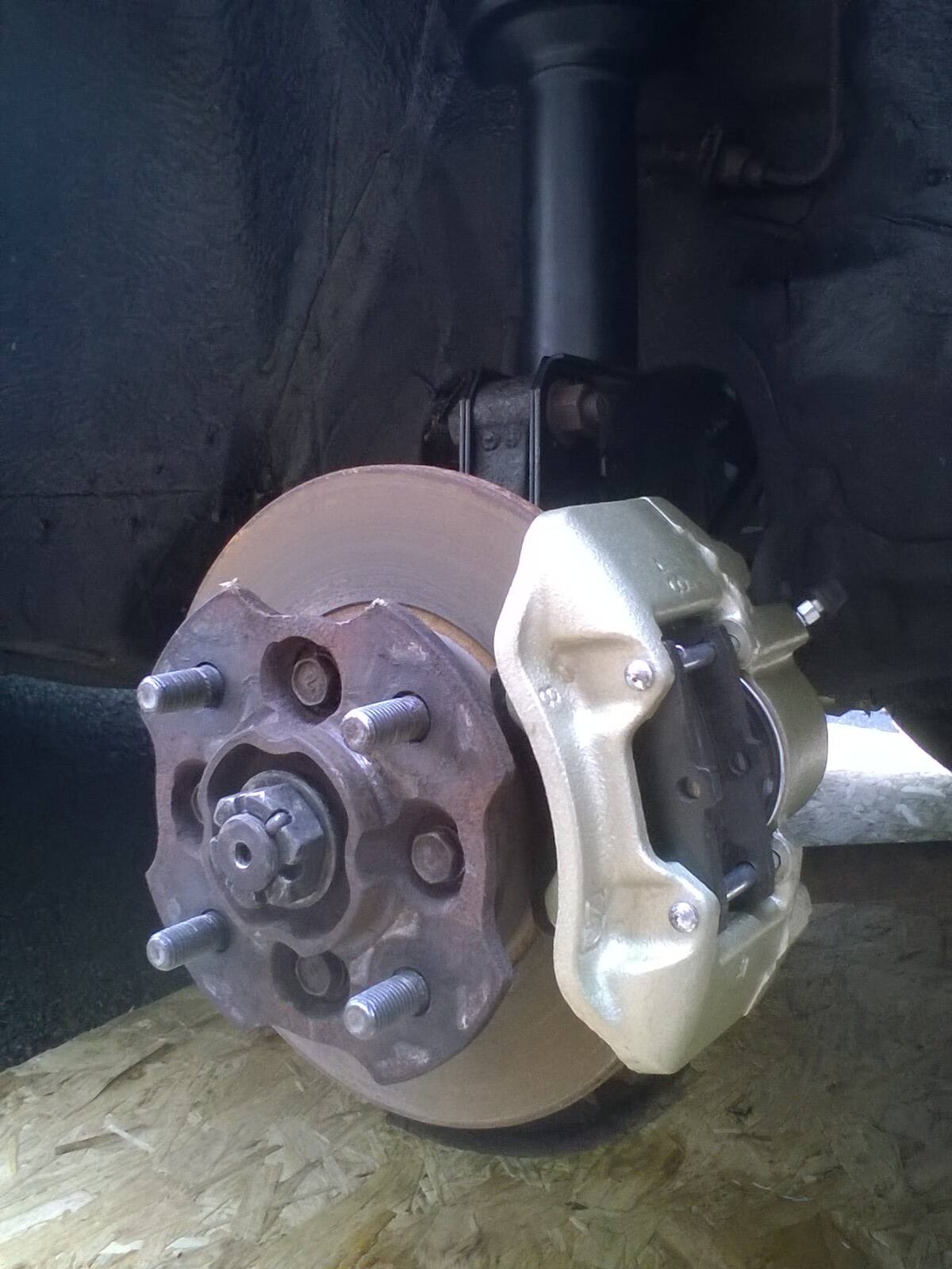

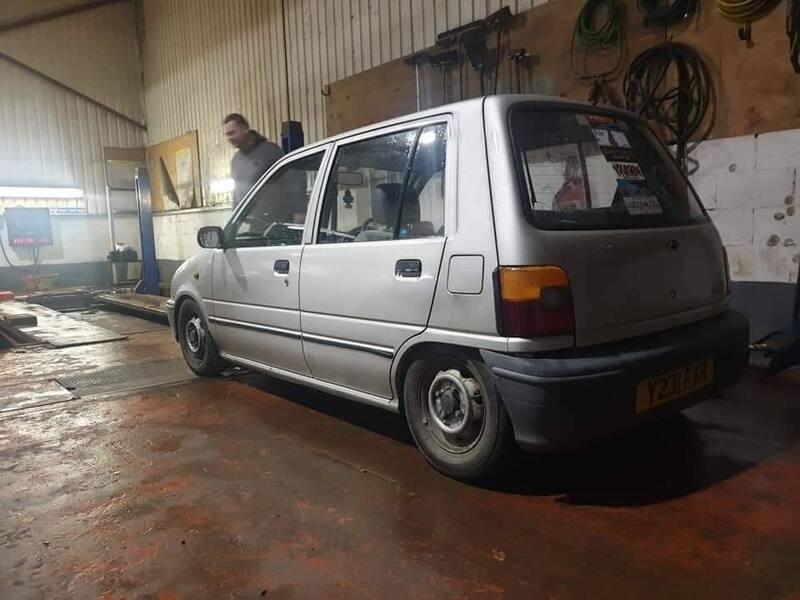

Steve G Posted November 24, 2019 Author Posted November 24, 2019 I've finally got the sticking brake caliper rebuilt and on the car ! I had to get a repair kit from Germany in the end as I knew the pistons would be rusty. The bleed nipple broke off despite my best attempts to remove it whole. A benefit of my new job is that I have access to a shot blaster so one side looks like this now. Lacquer Peel, rainagain, egg and 1 other 4
Steve G Posted November 24, 2019 Author Posted November 24, 2019 I ordered some springs from Springcoil. They list some for this giving a 40mm drop all round. I wasn't sure about the back so I asked for some slightly taller rear ones. The 10mm difference means the car is actually 10mm higher at the back (measured from the swage lines) but looks lower due to the rear wheel arches. I only put it all back together earlier so haven't had a chance to drive it yet. Vince70, Aston Martin, auntiemaryscanary and 3 others 6
Steve G Posted November 27, 2019 Author Posted November 27, 2019 A quick drive up the road confirmed the rear springs are too soft. I was a bit suspicious that there seemed to be slightly more coils and the length was only just shorter than the standard ones. The fronts however seem fine so I have re-fitted the standard rear ones and will get in touch with the suppliers tomorrow if I get the chance. 500tops 1

DodgyBastard Posted November 28, 2019 Posted November 28, 2019 On 28/11/2019 at 10:53, Steve G said: What did you do for springs? The coils on the back were touching. It would have been better to cut the original ones. corsa b rear springs up front, almera lowering springs chopped a little at the rear. Sent from my G3121 using Tapatalk
yes oui si Posted November 28, 2019 Posted November 28, 2019 On 28/11/2019 at 11:15, DodgyBastard said: corsa b rear springs up front, almera lowering springs chopped a little at the rear. Sent from my G3121 using Tapatalk Expand What he said. Not my car. Although looking at the strut diagram posted in this thread, Corsa B coilovers could be made to fit...
Steve G Posted November 28, 2019 Author Posted November 28, 2019 I dont have anything lying about to try, interesting way to do it though. I ordered the springs without looking at the ones on the car first.

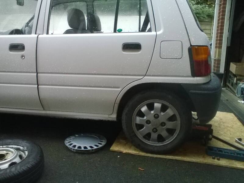

Steve G Posted April 12, 2020 Author Posted April 12, 2020 Bit of an update. This has been tucked away in the garage over the winter. I managed to get hold of some Daihatsu wheels before Christmas, had them refurbished and fitted new tyres but haven't had a chance to fit them. Quick test fit before the were painted. Part of the problem was finding suitable centre caps and wheel nuts. They are both odd sizes. I bought some centre caps off ebay that were slightly oversize and turned the OD down so that would fit. The nuts were a pain though. The originals are very short and re-chroming them very expensive. A far cheaper option was to buy some new open nuts and some plastic covers. I had to cut all of these down though as they were too long. The end result was this, far better. The paint of the car isn't great but it's come up a bit better now it's had a bit of a clean and polish. I gave up with the rear springs as the new ones were just too soft. For now I have refitted the standard rear ones and it looks OK really so I might just leave it alone for now. The new bumpers really tidy it up a lot, very lucky the previous owner thought to grab them when he did. Next on the list is to do something about the exhaust. It doesn't fit very well and it seems a good excuse to relieve it of a silencer as it's far too quiet ! There is one in the tunnel, one huge one under one side of the rear seat and a silly little one right at the back. BeEP, 500tops, jumpingjehovahs and 7 others 10

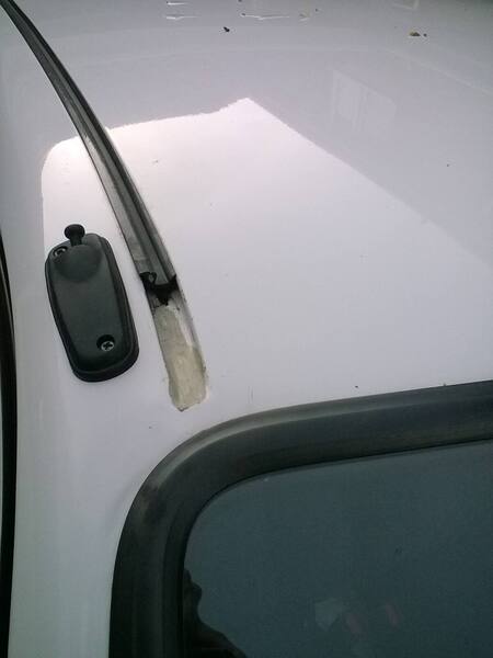

Steve G Posted May 17, 2020 Author Posted May 17, 2020 After the first lot of heavy rain we had, it's a while ago now, the inside of the Nippa turned into a small lake ! The previous owner had fitted a new screen rubber and I had noticed a small amount of water on the passenger side rubber mat. This was different though and the rear foot well was full. Nothing for it but to remove the seats and carpet, dry it out and then find where the water was getting in. Running the hose on the windscreen it looks like it was coming in the top edge of that. I did spot a suspicious looking gap where the roof panel joins the side though. It should have a trim stuck in the channel but both are long gone now. Because the mastic used to attach them was sticky I had removed it which had reviled the gap in the seam sealer. Seems the big leak was my fault so I re-sealed the gap ad so far no more water has got in.
