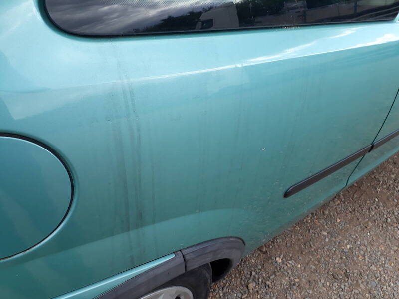

Today I fix the heater, changed the handbrake cables, checked it over for the MOT and gave it a dam good wash. Poor thing was minging. But the colour hides it well.
20190901_142449.thumb.jpg.750f323fb57f8299652558c6d95270de.jpg20190901_151057.thumb.jpg.8bf932a196b5c5606eefb50e8e6dff12.jpg
Body Scrubbed, wheels and lowers soaked in g101 and agitated, washed again and given a clay with a g3 mit for speed. Large marks and scratches compounded then a quick IPA wipe followed by two coats of g3 wax.
If you want a simple to use wax I stand by this stuff, No white Marks on trim, no dusting, do the whole car not panel by panel, leave for ages or do it in the sun doesnt matter. Brilliant stuff.
