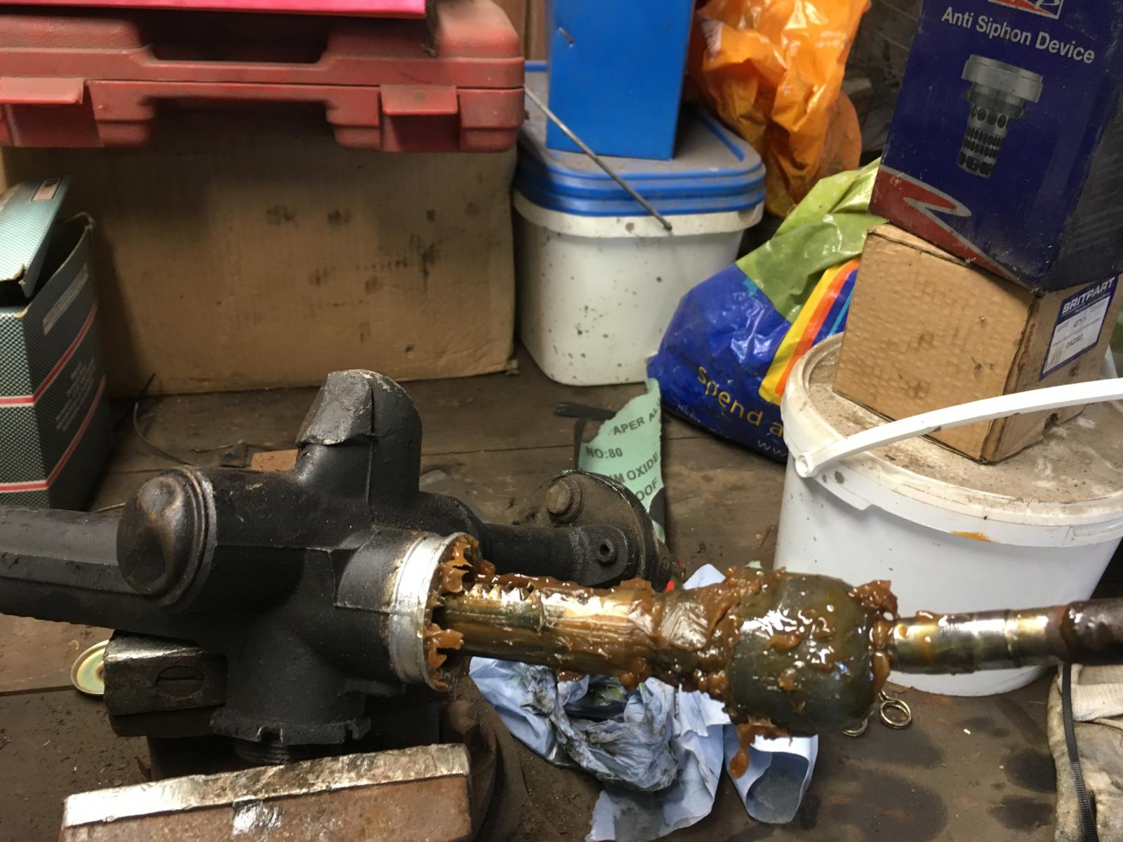

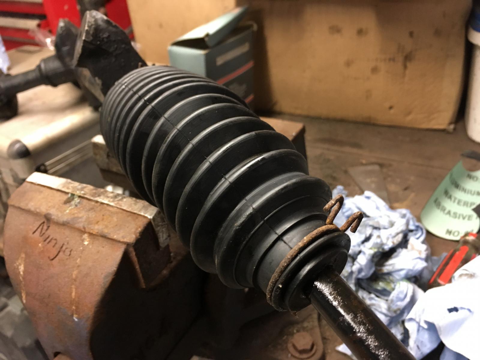

I bought a reconditioned steering rack from a car show hundreds of years ago, and stored it in the roof beams of my unit. I pulled it out today to attach to new axle but the gaitors have all perished. No Dramas. I bought a rack gaitor kit years ago I'll chuck that on. Turns out the rack end diameter and the boot end diameter are different sizes.... balls. So i check the kit fitted to the old rack on the axle ive just taken off. On that one, theres little rubber spacers fitted to accomodate bigger holed boots. Grand. So tomorrows job is to get those off and get the rack built up and fitted. Then fit the axle.

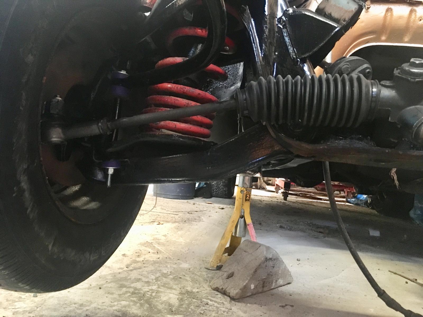

Another few hours spent tinkering today. Removed the “grommets” from the old rack and fitted them to the new one. Cleaned the old grease out and slapped some new on then fitted new gaitors.

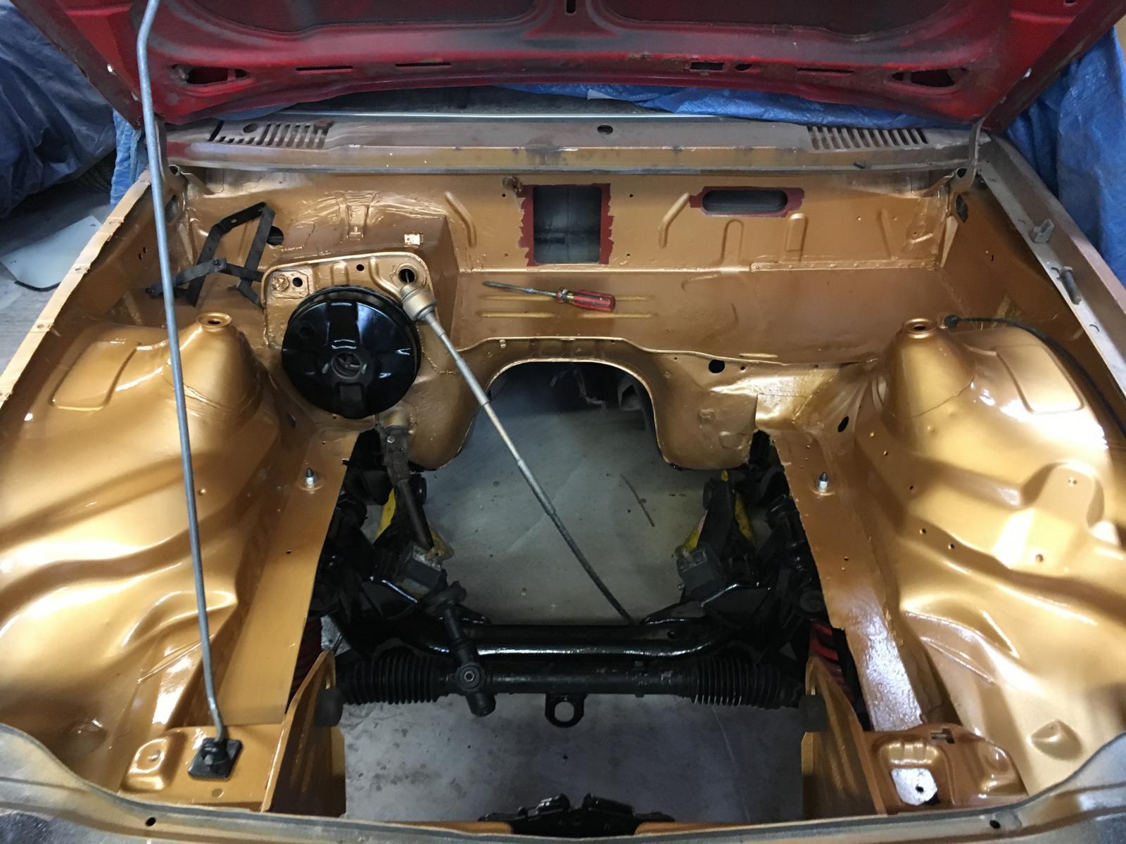

Then set too and fitted the axle, then the rack to the axle. Had to get some new nuts for the main axle mounts as put the old ones in that really safe place where they are going to live the rest of their lives out. New ones didn’t break the bank though.
Also fitted the brake servo
Had a visit from the farms dog Lunar, labradoodle.
And a picture of the fitted axle, rack with new track rod ends.

Done a few more jobs today. Fitted Koni adjustable front shockers off my red manta (fitted newer shocks on that last year), fitted painted anti roll bar and new arb links (Powerflow bushes as didn’t have any nos ones). Fitted hubs and a set of wheels to test fit everything. Even Mrs sutty helped.

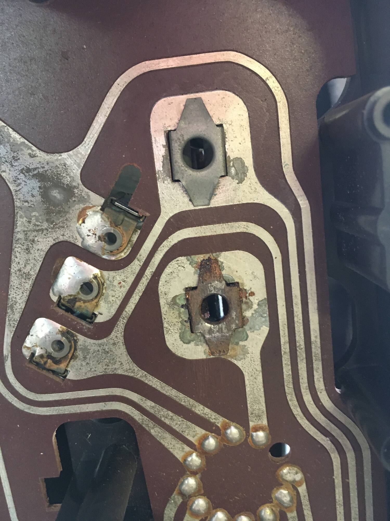

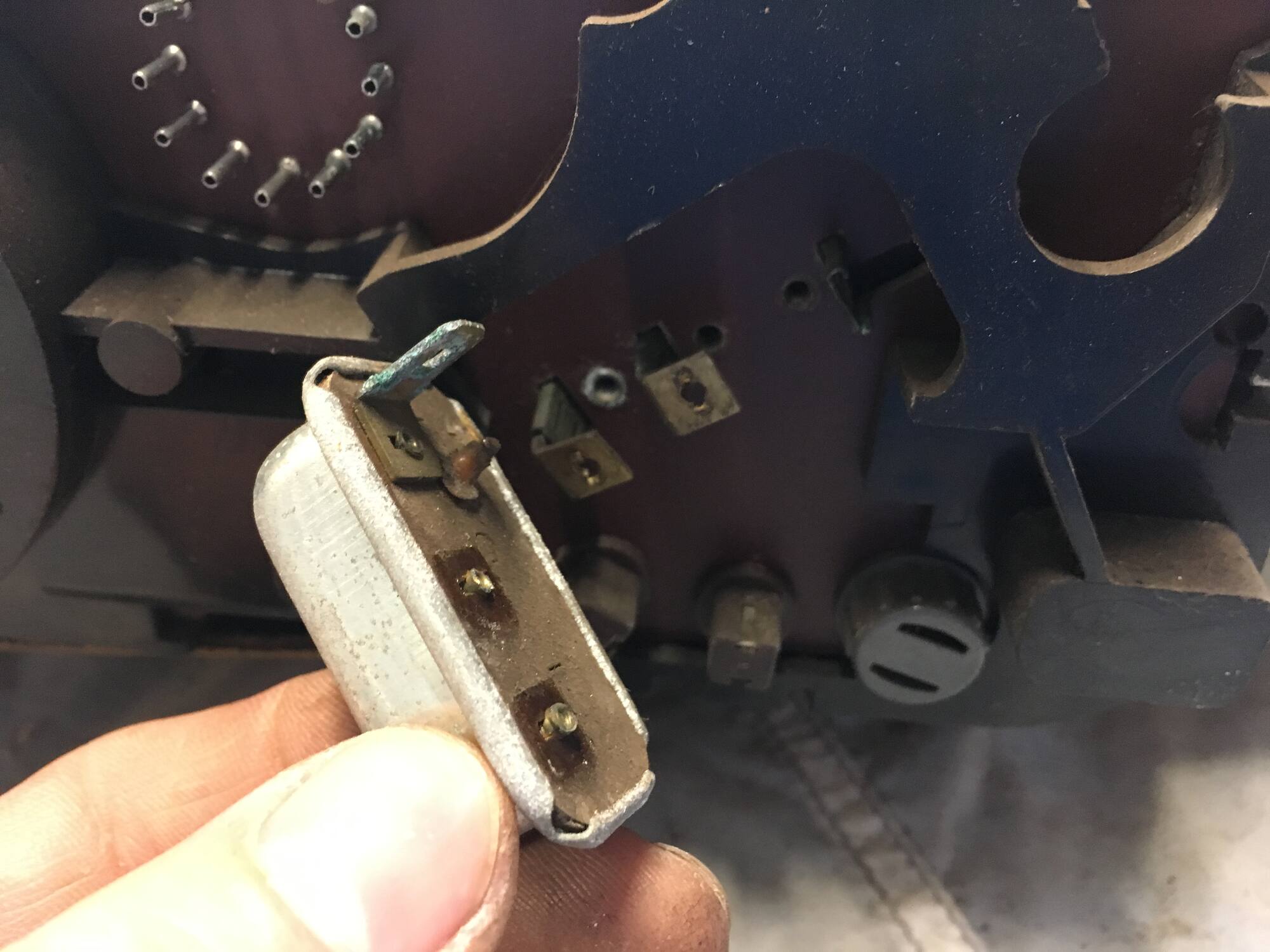

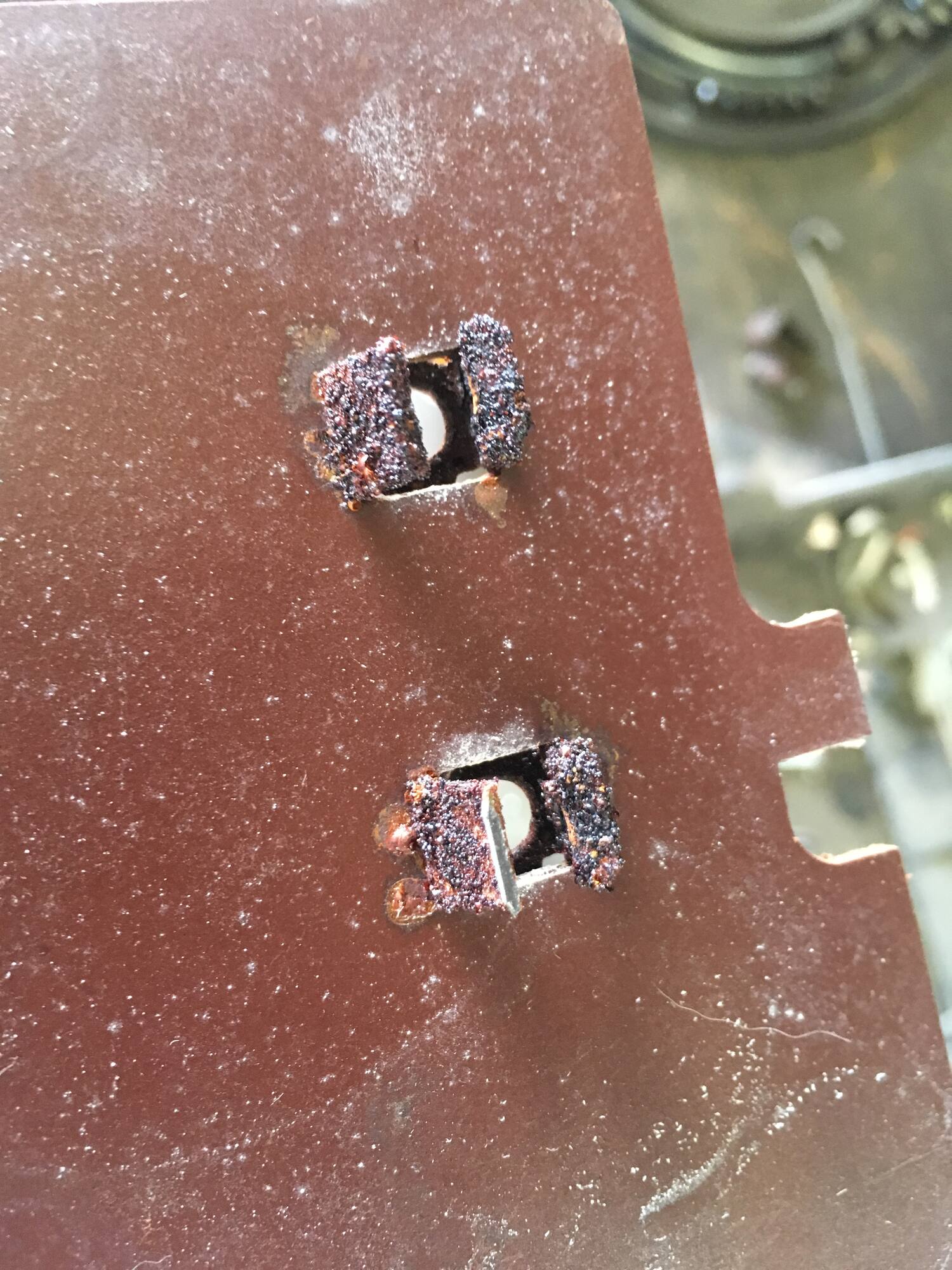

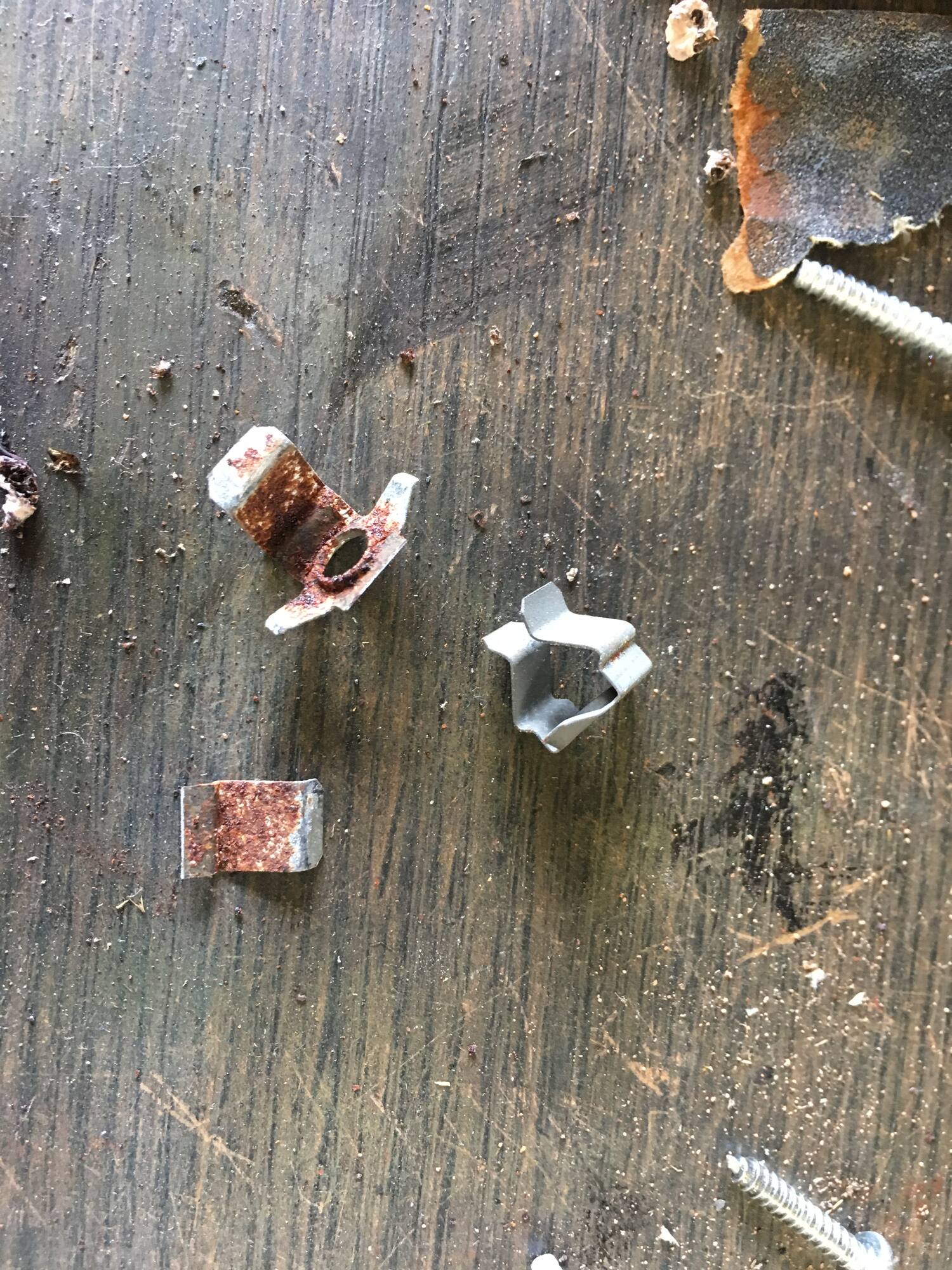

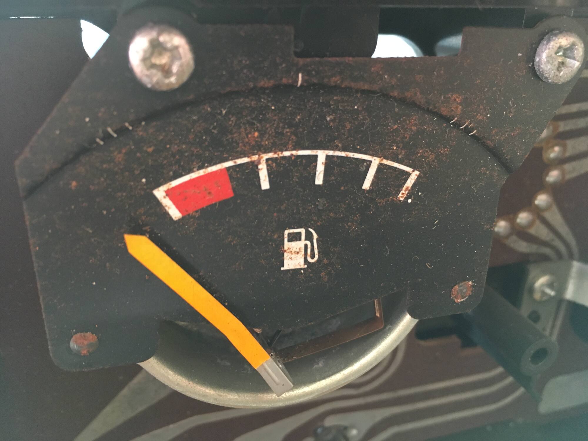

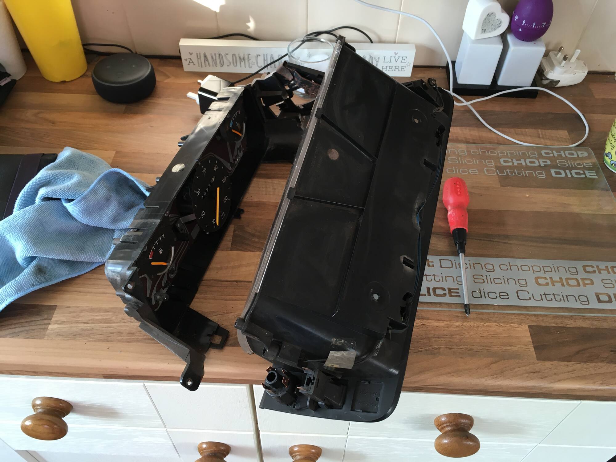

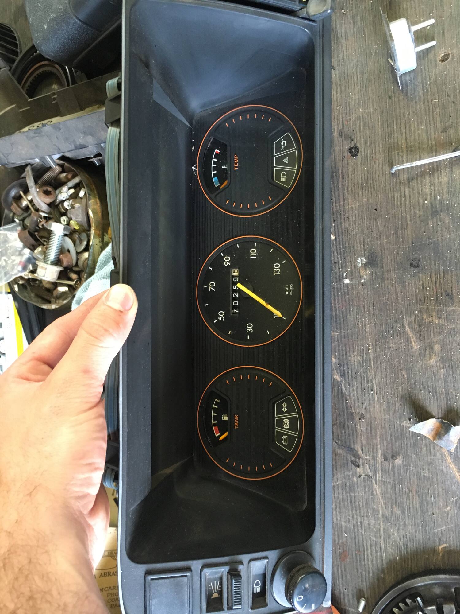

So I’ve not been up to much on this. Lack of money brings a downer on things all to often. I have started fitting a replacement wiring loom from an automatic I broke a couple of years back. Pulled the instrument cluster off to check it over and 80% of connections were rotten or rusty. Mainly for temp gauge and fuel gauge. Luckily I’ve got a few spare clusters about that I could strip for parts. The benefit of old motors.
I've got a couple of the solid state voltage regulators kicking around that the OMOC had made a few years ago,just in case.....you know....
