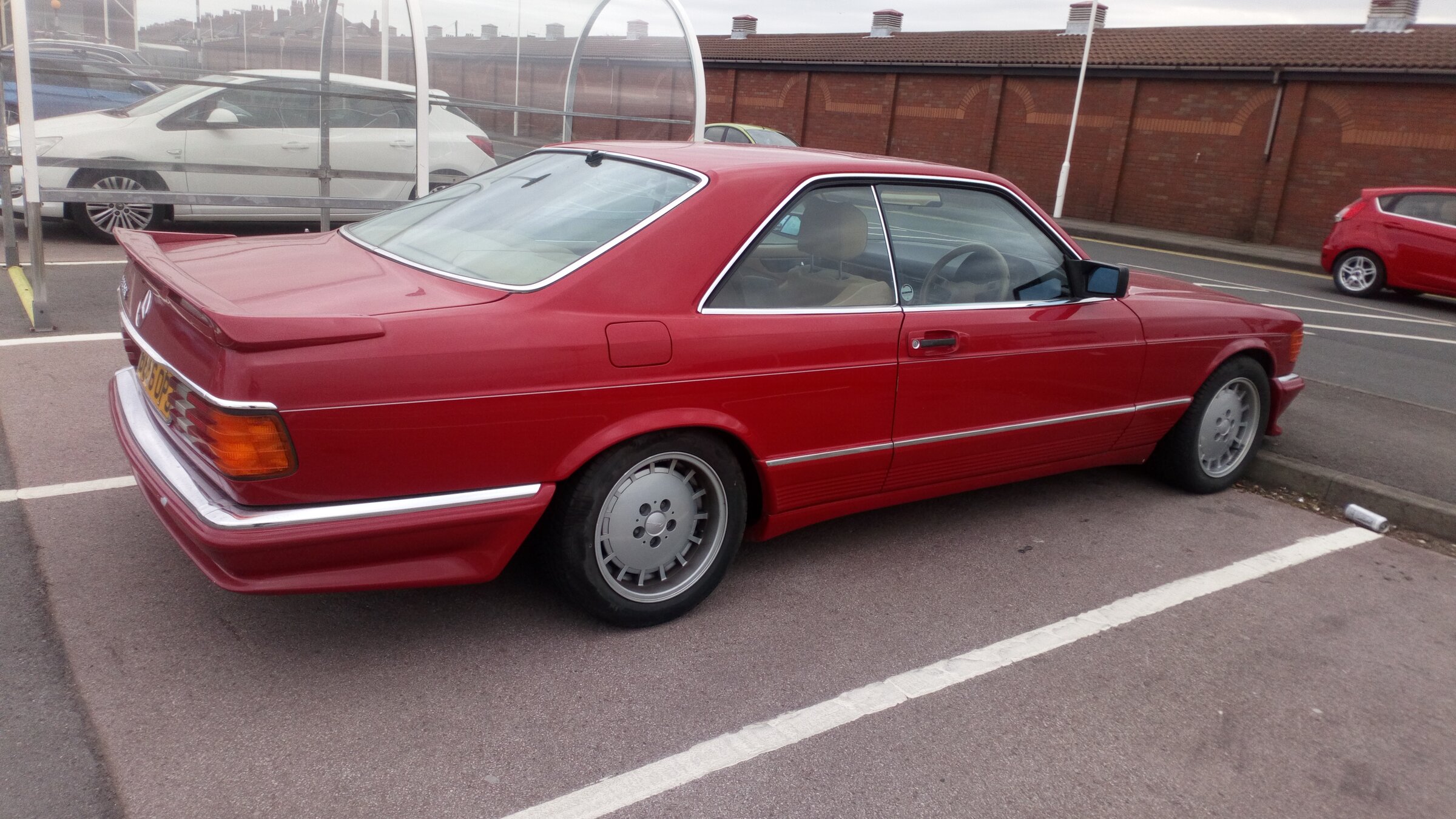

I've used the car 3 days this week locally with no problems so today I manned up, filled up and set course for No1 son and family about 60 miles north . Uneventful trip, no AA like on the collection run so I'll consider it put to bed. This is what the it looked like on return in its usual habitat , a supermarket car park.

Look at the dish on those rear wheels. Bloody lovely old thing that is, glad it's behaving
The rear dish probably looks deeper than it is because the they're covered in pad dust despite being driven quite slowly, the fronts have covers inside to stop this this. It has the same size tyres front and rear at the mo, dunno if they should be staggered.  It needs a set of tyres, I'm just not a fan of 1999 Nankang M+S.

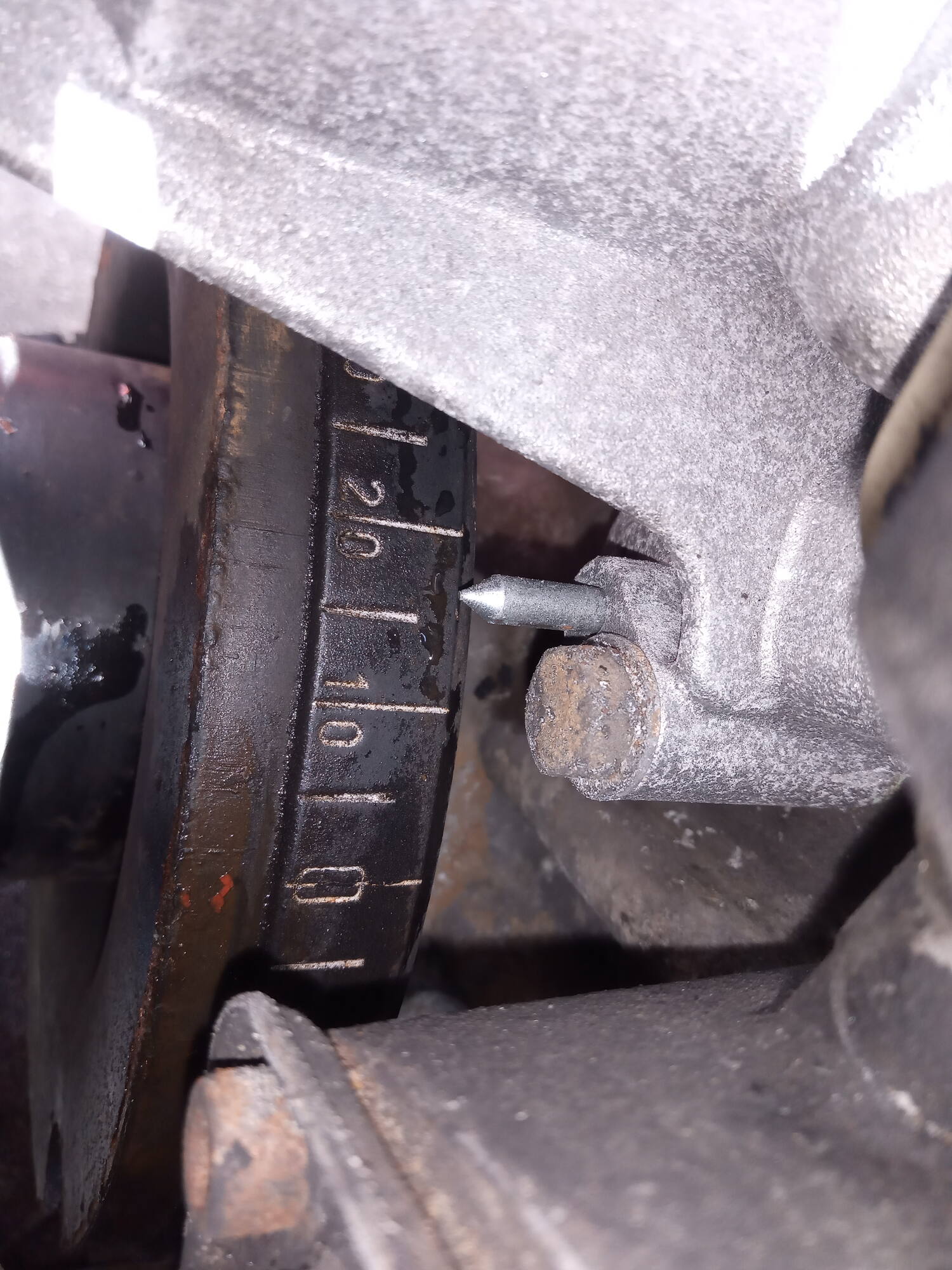

A bit of a thread resurrection here as I'm actually doing a bit with the big red thing.  I used this last summer for work, local runs and the like while picking away at 35 year old car problems.  In late summer I changed the oil for a second time about 8 months and 1200 miles since getting  it and it wasn't happy on restart, it chattered away like a good un for a few seconds before shutting up. Ahh... I continued using it  and every 10th or so start it had a light rattle. I went for the easy option and fitted a new tensioner but no better so I had a looky see  at the timing chain, a weak  M117 point I now find out. I set the RH cam to the timing mark  and  looked to see the crank timing, helpfully  marked in degrees.
The cam timing
The crank timimg. Bollocks, this should be on 0 degrees not about 16.
Over the next couple of months I slowly amassed the bits I thought I needed and backed off the use of the car until last week when I made a start on it.

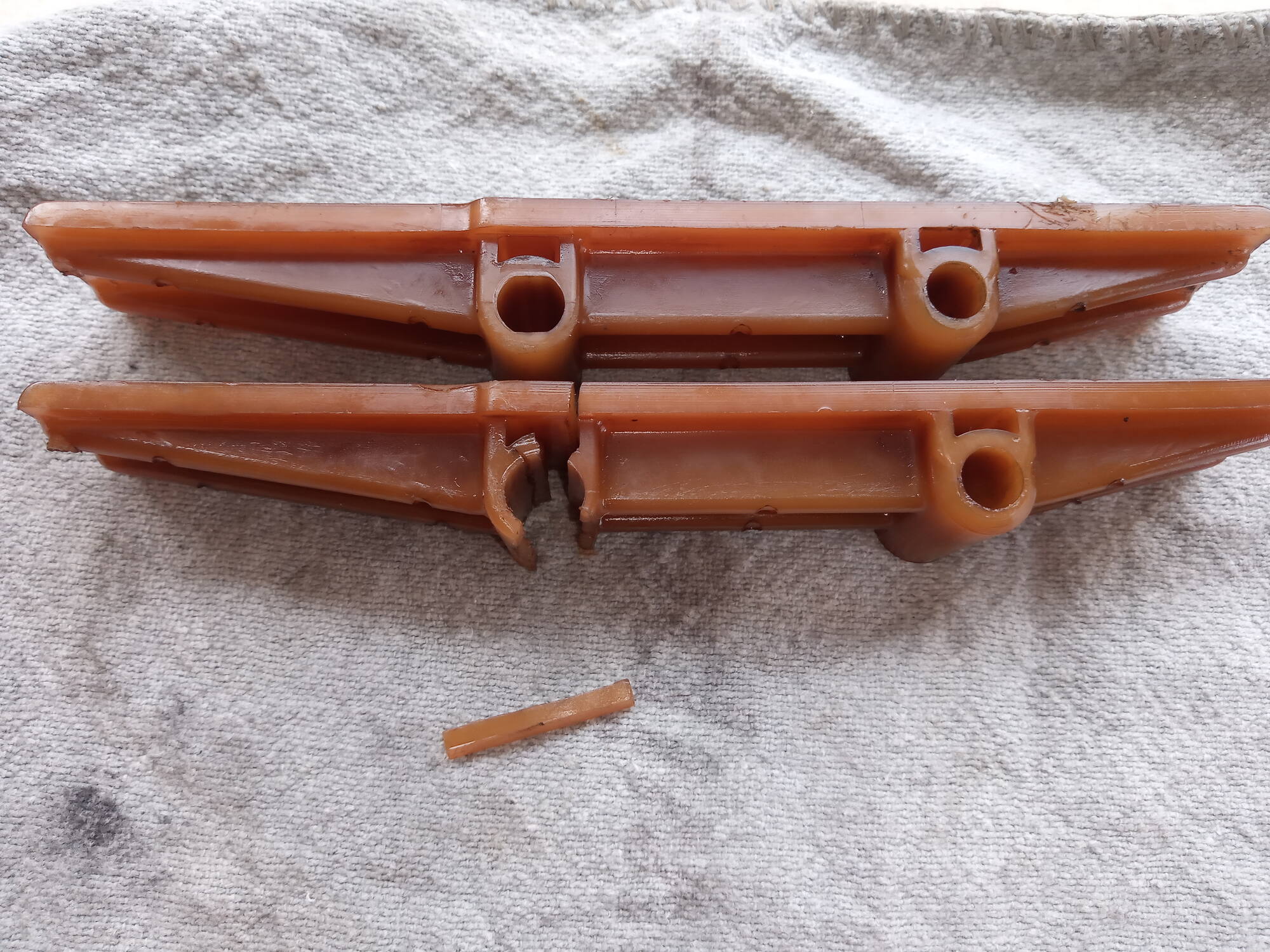

It sounds easy, you split the old chain, join the new one to it and wind it on. Well, it fought me every inch of the way, then when I changed the guides I found one snapped in half and of course I couldn't  find the bits even with lower sump off.
A endoscope was blagged and it the missing  piece was found jammed  about a foot down the timing chest and after a battle it was dragged out into the light yesterday.  The bit jammed in the timing chest is the chunk on the left below, the sliver was in the oil strainer.
Here it is next to the intact one from the other side, the problem I now have is a missing bit. The sliver is from the top of the eye where the pin goes , the missing bit  is larger from the bottom of the eye.  I do I just ignore the bit loose inside the engine? It's not visible from the sump pan or with the endoscope  from the top, book time to remove and refit the timing cover is 12.4 hours, 3.5 to remove the upper sump . As well as the timing chain it has a chain driven oil pump to snag it but I reckon it's already done  500 miles with the bits floating round, or wedged somewhere like the other bit was. Do I feel lucky? Can I be arsed  to strip the engine for a small piece of plastic ? TBC.....

Metal is stronger than plastic. Will it not be dust now anyway?
I suspect and hope it'll have found a dark corner to see out it's days in peace. Aside from getting brittle after 35 years the plastic is tough stuff, a chain running on it for 120k miles hasn't worn them much. I made a good start putting it back together yesterday, a bit more today with everything crossed. It's quite slow work because it's pretty much two four cylinder engines side by side.
When I finish the engine I'm going to pull the gearbox sump off and change the filter, see what's going on in there. It'd be nice to just be able to drive the bugger!
The missing bit is big enough that the strainer should stop it getting sucked up, I'd just drive it.

Yes, that's where the smaller sliver was but it's the thought of getting between either chain and a sprocket I'm not keen on. Pretty sure it's been in there for about 500 miles already so hopefully ok.
As a positive i was impressed  how clean it is under the cam covers for an old donkey.
Even if it was whizzbang glassfilled nylon a chain and sprocket would make mincemeat of it, and the old tensioner looks to be plain 66 nylon. I had the same conundrum with an Essex timing gear in a Scimitar, where had all the nylon shrapnel gone and would it fuck anything up? Most of it came out of the sump but a few bits vanished into thin air. We just opted to drive it and nothing happened.

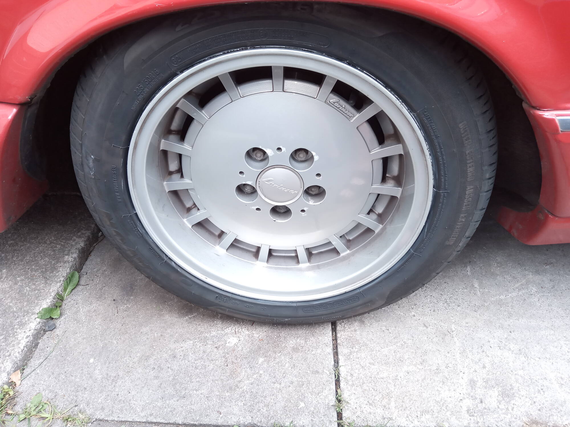

Today I tret it to a set of new boots, Avons all round to replace the shit 20 year old M+S's it had.  The tyre fitter didn't want  to put weights on the outside face of the Lorinser rims so we tried  on the inside only,  guess I'll be back on Monday as it dothers at A road speed. Bugger.
Have a pic of a wheel with a shiny new Avon but no outside balance weights.  Yet.
