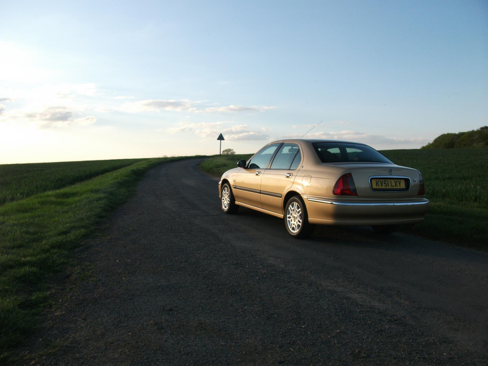

Maybe I should just scrap it . There's a long list of jobs that need doing. Caliper , discs , pads , CV joint , sill welding , rear silencer , 2 tyres , air con regas , cambelt and failed caliper I suspect. 125,000 miles . Cosmetically the body work is excellent for a 18 year old car. I've been quoted around £900 for the work. Ideally also needs clutch slave and master but I have those in the garage. Time is an issue for me now , work , kids etc... Head gasket was done at 55,000 miles.
It certainly looks nice in the pictures, why not roffle for scrap value?
I'm starting to feel that way. It's been a lovely car for the last 8 years , but our 207 Mazda 6 2.0 petrol feels like safer more capable car , it still feels tight after 140,000. Eventually it'll need replacing so I'm probably best to save the money for that , rather than throw it at the 45.
Why would you bother when the scrap man is at the end of the drive with £150 in his hands?
Because this is autoshite and someone may want to save the little beauty, these are one of the many common cars that were plentiful and disappear almost overnight
do the jobs over a couple of weekends yourself...……….not a lot of parts there.
worth keeping if body is good and certainly too good to throw away.
other opinions are available but they are wrong!
ROFFLE, ROFFLE, ROFFLE, ROFFLE, ROFFLE.. Come on, just roffle it, £3.50 a ticket or £2.50 a ticket ?? Whatever just roffle it, if there's no interest then chuck it on ebay as a 'Modern classic' for £5k..
