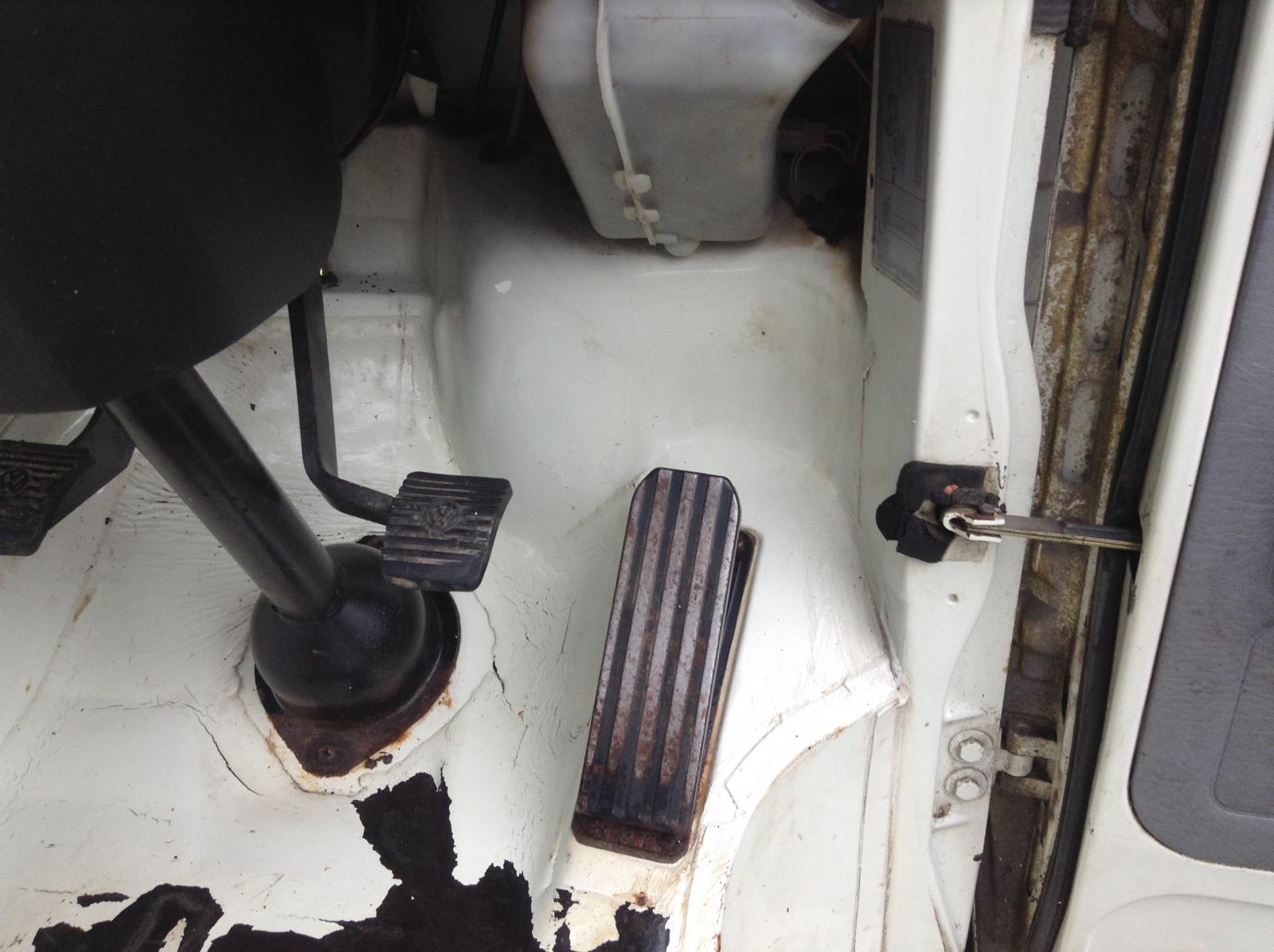

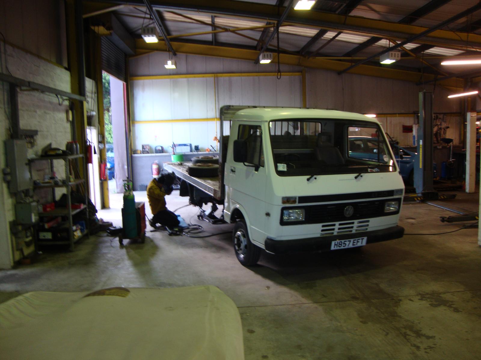

New accelerator pedal fitted, brakes stripped and cleaned..... its getting a wee bit of attention with the sparkly stick on a wee hole that was provoked to be there....  4 new quality* hingfly tyres are on the way for the back, then down for an mot and see what's what.
  • 2 weeks later...
Tyres and exhaust on, sparkle stick stuff done and a new mot with no advisories obtained . :) I needed* to use the flatbed on the way home to collect more unwanted shite..... Two wheeled shite. I am finding myself drawn to old bicycles.... It was free
