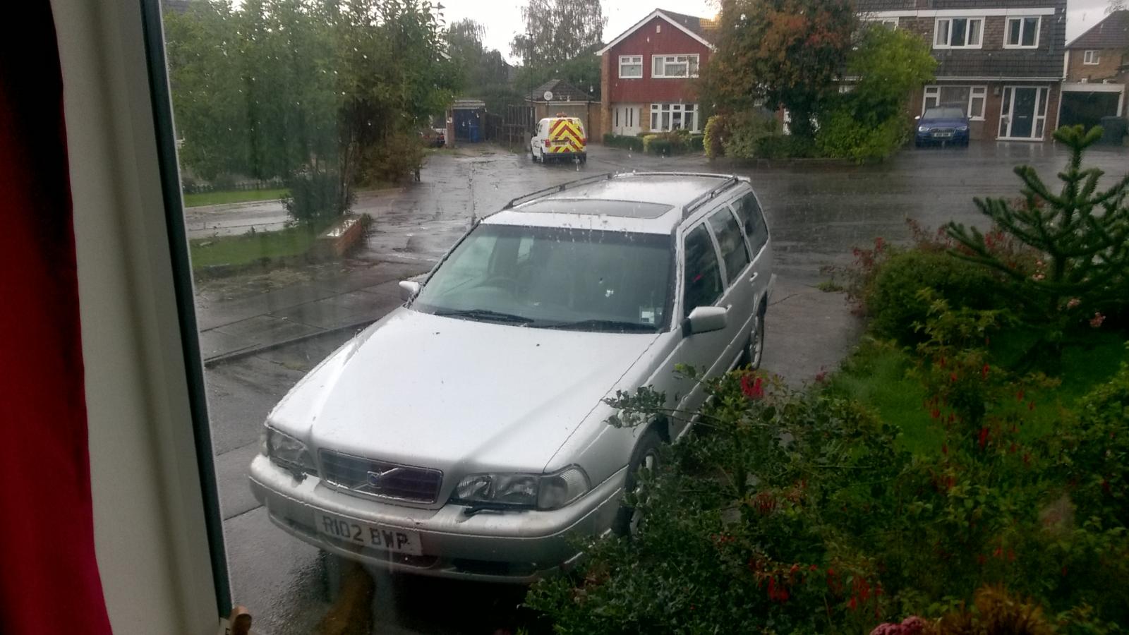

Tamworthbay Posted September 22, 2018 Author Posted September 22, 2018 It's grim up north......Well north of where I usually am, bloody horrible at mo. Jim Bell 1
