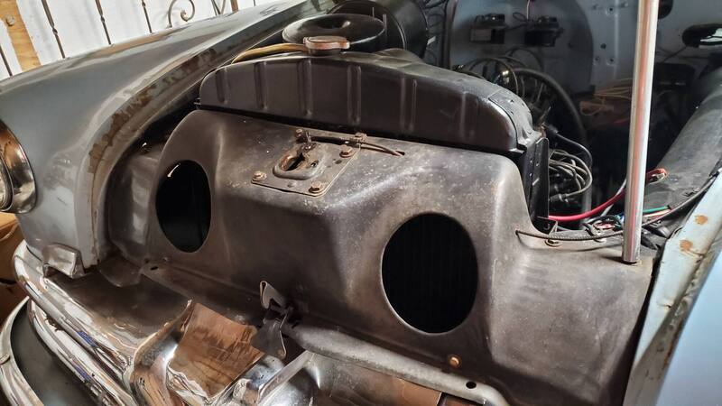

PhilA Posted March 8, 2020 Author Posted March 8, 2020 I reviewed today and decided to hell with it. I had a rummage in my random nuts and bolts and reassembled the slam panel, connected the hood latch, set the striker pin so now the thing locks and can be opened by pulling on the handle inside. I also ran the engine and set the cold idle and choke. I now smell of Eau D'Autoshite (heavily choked exhaust from a cold engine with no catalytic converter). Feeling a little better mentally now. Phil lesapandre, LabRat, GrumpiusMaximus and 5 others 8

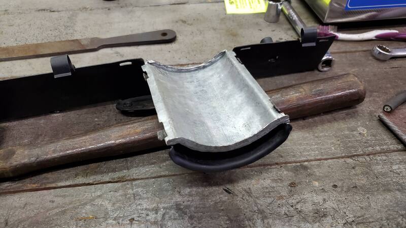

PhilA Posted March 21, 2020 Author Posted March 21, 2020 Removed the spark wire tray and the old wires and attacked it with hammers. It's now the shape it should be. (Previous keeper had let the engine fall over and it bent all the sheet metal on the side of the engine). Hammers are good therapy. Phil somewhatfoolish, xtriple, LightBulbFun and 1 other 4

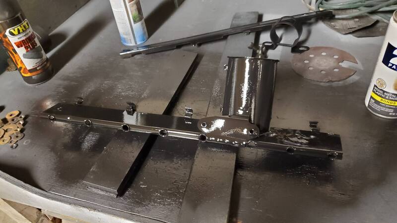

PhilA Posted March 22, 2020 Author Posted March 22, 2020 That's all the sheet metal parts of the wire manifold cleaned and painted, drying overnight. Phil paulplom, DeeJay, lesapandre and 2 others 5
hairnet Posted March 22, 2020 Posted March 22, 2020 i saw that at first while scrolling down looked chromed i need glasses - oh wait SHINEY!!!!!!!!!!
PhilA Posted March 22, 2020 Author Posted March 22, 2020 1 hour ago, hairnet said: i saw that at first while scrolling down looked chromed i need glasses - oh wait SHINEY!!!!!!!!!! This morning it should be matte black. It was still wet in that picture. Phil

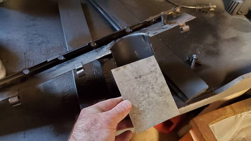

PhilA Posted March 23, 2020 Author Posted March 23, 2020 Today I got ready to go out to the grocery store. Took a piece of sheet steel and marked it out to size. I chopped the rectangle out and de-burred the edges. Bend bend bend bash bash bash That looks about right and the wires fit through. A squirt of black paint and I'm calling that done. Metal work can be good therapy. Phil egg, DeeJay, somewhatfoolish and 5 others 7 1

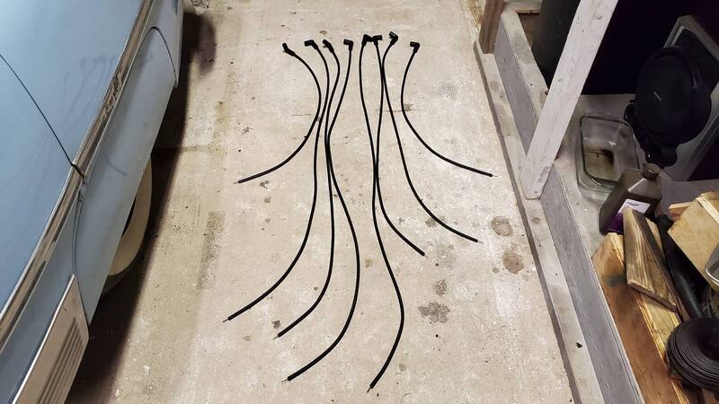

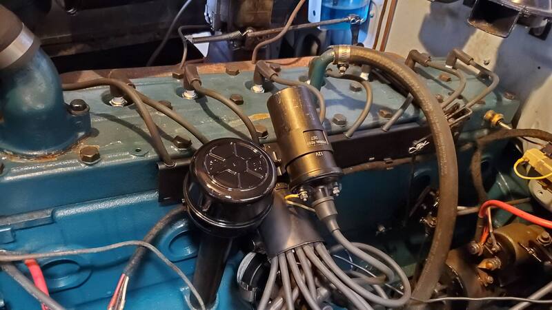

PhilA Posted March 23, 2020 Author Posted March 23, 2020 I laid the new wires out on the floor. There are a few lengths, so I set the longest ones furthest from the distributor (made sense, really). I measured the length of wire needed from the bracket to the plug for each wire and marked it with tape. Clamped it all together as an assembly. Tried it on for size. Looks good. Phil LightBulbFun, somewhatfoolish, Rocket88 and 14 others 17

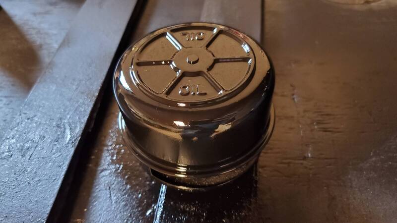

PhilA Posted March 23, 2020 Author Posted March 23, 2020 Got a replacement oil filler cap on the way also, as that one is irreparably dented. Phil

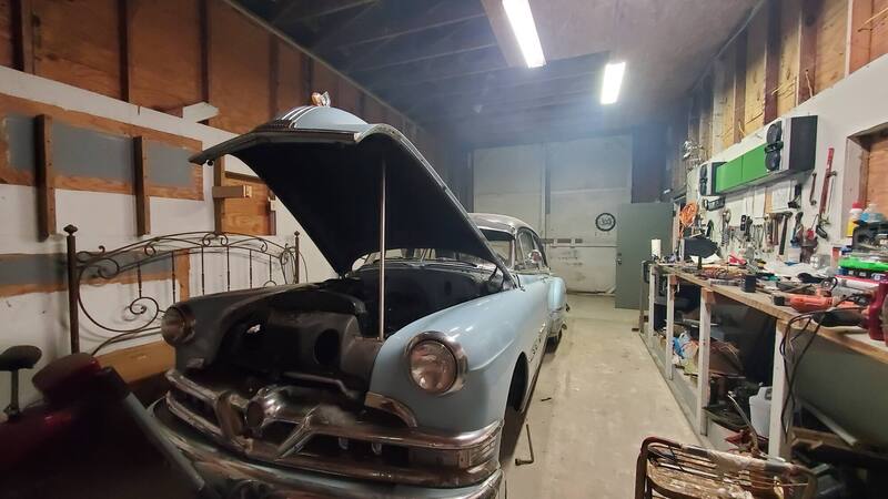

hairnet Posted March 23, 2020 Posted March 23, 2020 @PhilA show us the pic on the wall in full again please

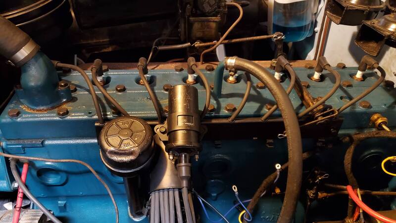

PhilA Posted March 23, 2020 Author Posted March 23, 2020 Got it all plumbed in. Waiting for the rest of the spark plugs to arrive. Phil DeeJay and LightBulbFun 2
PhilA Posted March 23, 2020 Author Posted March 23, 2020 1 hour ago, hairnet said: @PhilA show us the pic on the wall in full again please Uh, okay? Saabnut, spartacus and stonedagain 3
hairnet Posted March 23, 2020 Posted March 23, 2020 just realised why it was flipped for one minute there id hoped youd done another
PhilA Posted March 23, 2020 Author Posted March 23, 2020 10 minutes ago, hairnet said: just realised why it was flipped for one minute there id hoped youd done another Nope, front camera on my phone. Reversed the image. Phil
PhilA Posted March 24, 2020 Author Posted March 24, 2020 Swapped a couple of the old plugs round. We now have something resembling idle. Phil LabRat, egg, BlankFrank and 4 others 7
PhilA Posted March 25, 2020 Author Posted March 25, 2020 Múy bien. All new plugs. Cold start Phil LightBulbFun, HairySteve, mercedade and 4 others 7
PhilA Posted March 25, 2020 Author Posted March 25, 2020 New oil cap. Cleaned up real nice. Looks smart too. Realigned the filler tube so the intake catches air from the fan as it should. Phil Skizzer, DeeJay, LightBulbFun and 2 others 5

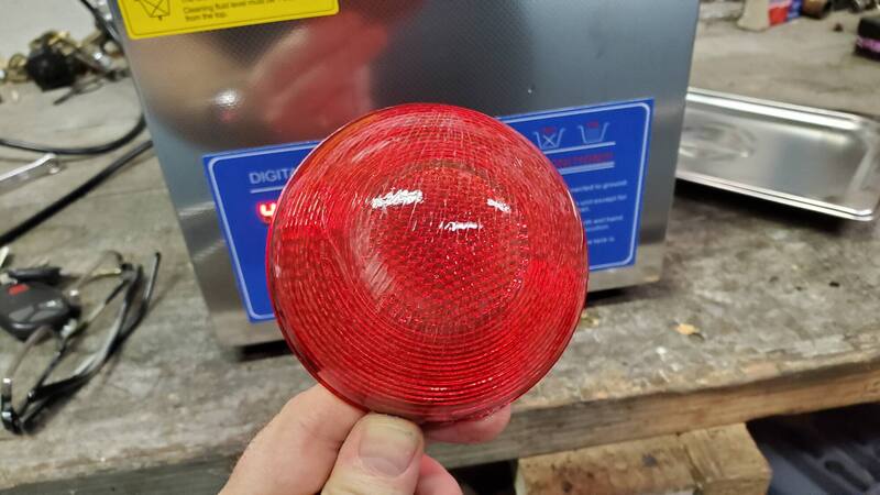

PhilA Posted March 26, 2020 Author Posted March 26, 2020 I took the passenger side tail lens off and stuck it in the ultrasonic bath to clean off the dirt. Buzzed it down as smooth as I could with a worn-out DA disc. Washed it again. This time, wet, it looked better which is promising. Dried it off and gave it a first coat of lacquer and left it to dry. I also rubbed down the other lens and gave it a coat of red. Once that's hard it should rub down smooth and polish up nicely. Phil paulplom, adw1977, cobblers and 5 others 8
