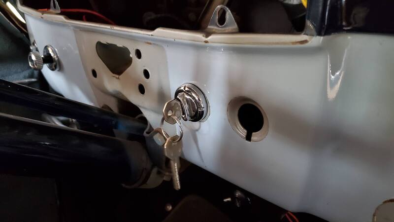

PhilA Posted September 7, 2019 Author Posted September 7, 2019 Fan completely crapped itself. Bearing fell to bits. Poo. It's hot outside. However, I have not been shirking the work; I have wired in the ignition switch and a bunch of other stuff. Reverse lights, starter inhibitor and such. Need to wrap the loom up under the dash. Put the dash back in and everything is connected the way it should be. Got brake lights, turn signals, headlights. Even the clock works. Phil scdan4, LightBulbFun, Asimo and 3 others 6

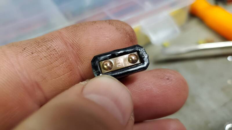

PhilA Posted September 8, 2019 Author Posted September 8, 2019 Fixed the switch. Looks like it had become a bit hot. Sure enough, the contacts were spring loaded but took a bit of levering to get out. Reshaped the part it sits in and reassembled. Yup, that works. Just needs a new lens now. Phil vulgalour, LightBulbFun and Tickman 3

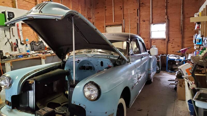

PhilA Posted September 8, 2019 Author Posted September 8, 2019 mat_the_cat, busmansholiday, purplebargeken and 12 others 15
PhilA Posted September 8, 2019 Author Posted September 8, 2019 Had a brief moment and fitted the radio antenna because the hole in the wing was annoying me. It goes up and down up and down up and down. Phil Skizzer, vulgalour, DeeJay and 5 others 8

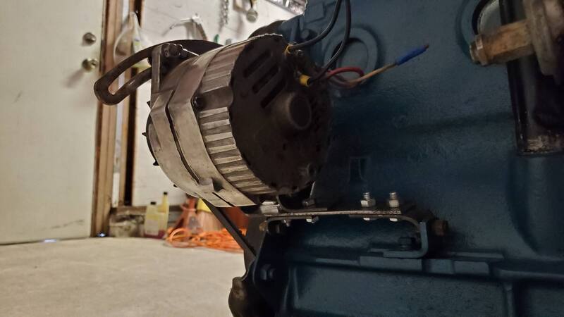

PhilA Posted September 10, 2019 Author Posted September 10, 2019 So, last night I went and took a look at the alternator. It's a Delco unit, used in early 60's Chevrolets. However, the lower mounting point does not line up with any of the generator mounting points on the engine so the previous owner just turned it upside-down and mounted the adjustment bolt to the engine and put a thin bolt through the lower eye onto the adjustment arm, which has been bent badly to shape. This ain't gonna work for me. There's a company that makes an adapter bracket, which is basically just 4 pieces of L bent metal bar held together with a myriad of bolts in a sliding adjustable fashion. I'm going to attempt to make one as a test. I have a bit of steel bar that is kinda suitable (it's about half as thick as it really needs to be but if it works in test I'll consider shelling out $45 for a proper piece) so I'm going to try make my own that attaches to the original mounting points but allows for the alternator to be correctly lined up with the belt and held in place properly. --Phil tooSavvy, paulplom, scdan4 and 1 other 4

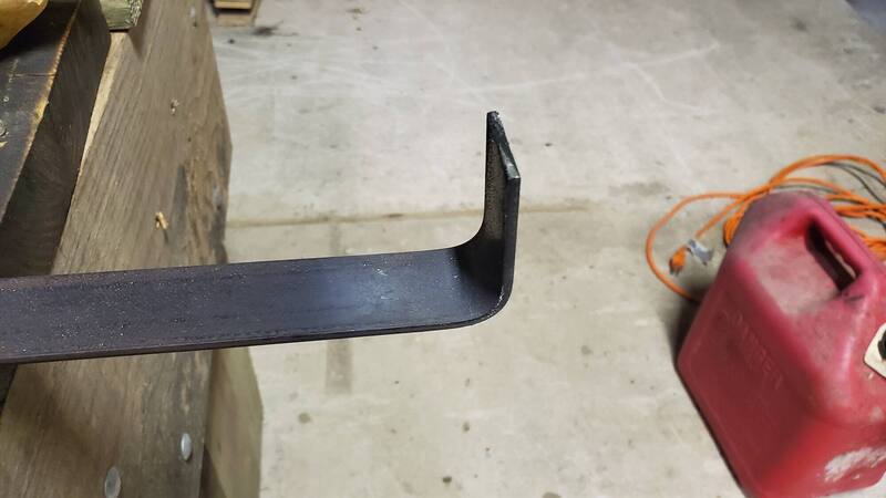

PhilA Posted September 11, 2019 Author Posted September 11, 2019 A little bit of metalwork tonight. Cleaned up the garage, heated bar stock to cherry red with my torch. Bend bar stock neatly and leave to cool naturally. Gotta cut that to size tomorrow and make some more pieces like it. Phil LightBulbFun, loserone and paulplom 3
PhilA Posted September 11, 2019 Author Posted September 11, 2019 Made 4 pieces. Painted the radiator black while I was waiting for the pieces to cool. Got a fair way through making the bracket and ran out of time. Phil paulplom, Saabnut, LightBulbFun and 4 others 7
PhilA Posted September 12, 2019 Author Posted September 12, 2019 Bracket almost complete. Needs one more bolt hole drilling through on the rear alternator bracket and the lockwashers putting on. It tightens up ok. I'm going to assemble things and get it running and see if it squeaks and if it charges well. Phil Skizzer, paulplom, LightBulbFun and 3 others 6
