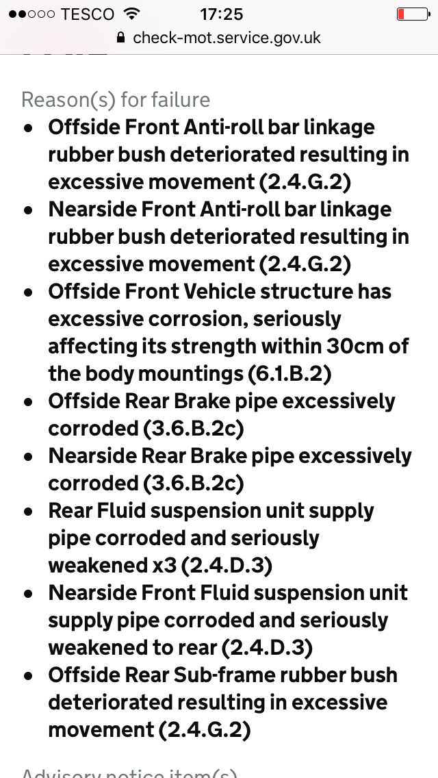

This went in for the MOT...
Ouch! I suspected the rear subframe mounting bushes were shot as certain types of pot holes would sent a thump through the back end, and whilst I was under replacing the spheres and bleeding the self levelling system last month, I saw the various rotting pipes. My tame indie says it's not too bad "for one of these" but that it makes sense to drop the rear subframe to do the bushes and to replace said rotten brake and suspension pipes whilst at it. The build process means they go in before the subframe and are nicely tucked under (over) it, if you follow me.
So it was very tempting to use this as a reason to bin the car, (I'd eyed up various replacements including an e430 estate- the poor mans e55) but basically they're all getting on now and famed for oxidising, so buying another is no guarantee of not having to face this next MOT either, so I've decided to bite the bullet. The key thing will be to hang onto it for a while (and go mad with rustproofing fluid) to offset the mounting costs, which of course I'm good* at doing.
