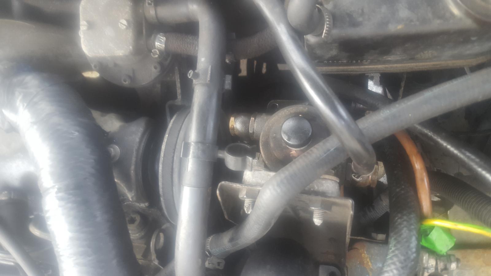

derskine Posted July 5, 2017 Posted July 5, 2017 Just fitted another lucas pump to my 205 TD, was hoping to prime the bulb on top of the fuel filter and it would fire into life but alas, no. I've cracked the banjo off on top of the pump and primed the bulb until a nice stream of diesel came out. I also cranked each injector off one by one whilst cranking until I couldn't see any bubbles. This wasn't a spurt of fuel though, just a seep. This is the filter fitted, not a standard lucas one, is it a bosch one? Sorry if pic is shit. Am I doing something wrong? Coprolalia 1

Cleon-Fonte Posted July 5, 2017 Posted July 5, 2017 I had a similar problem with one of those fuel filter housings, diesel would gush out of the bleed screw at the top but the engine still wouldn't start due to air ingress. Nothing appeared to be wrong and I kept replacing other stuff, but eventually the only thing which got the engine running was binning the original filter setup and replacing it with something else (in my case a BMW E46 320d filter with a later XUD primer bulb). Can you hear the solenoid click at all?
derskine Posted July 5, 2017 Author Posted July 5, 2017 It sounds like it might be the solenoid. It doesn't click.My 205 has a plug in immobiliser on the dash, perhaps I should swap the solenoids.I actually already bought a grenade and a BMW filter a while ago, so could well be worth fitting. Even if only for the superior bleedyness of the grenade.

derskine Posted July 7, 2017 Author Posted July 7, 2017 Well, it wasn't the solenoid! I took the plunger out but it still wouldn't go. I primed the fuck out of it and eventually it started but ran like shit, the rev were all over the place from 1k to 3.5k.It was doing similar before changing the pump so I thought for fuck sake. Turns out it was indeed the filter housing. Fitted the BMW filter and grenade and now it sits at just slightly below 1k revs always. Back of the net! Thanks for all the help people. M'coli, Arthur Foxhake, The Moog and 2 others 5
