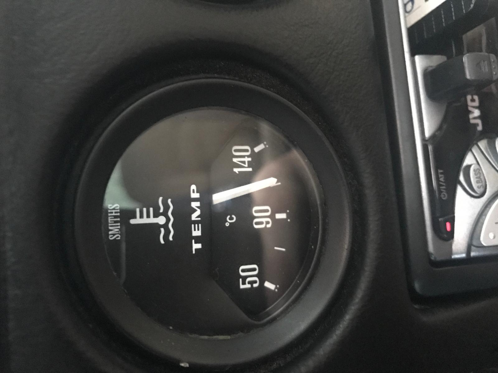

Stuff that got done
Timing as it was way out
Rocker cover gaskets
Rear diff pinion seal.
Auto box sump gasket
Kickdown adjusted
New Ball joints
Exhaust repair
New battery
New temp sender
New temp sensor for the fan
Carb rebuild
He told 99% of the bushes look past there best and it could do with all the water hoses being replaced. Bloody hell.....

But now the fan stays on for like 15 mins after you switch it off, it sounds like a bleeding 747 is taking off on the drive.
It's one of those temp sensors with a temperature dial on so you can decide when the fan kicks in.
Where is the best place to put the sensor, it's currently in the top water hose.

Top hose is good as that's the water temp coming out of the engine.
I seem to recall my dad's Renault 21 had fans that stayed worked after switching off & that tended to run for 10mins or so after parking on a warm day.
