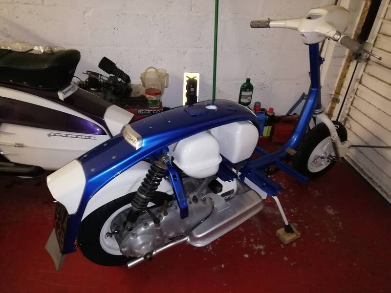

Motor now cleaned up ready to go back in - just need to switch the carburettor.
Dived into the big box of new bits from Scootopia, and got a few more pieces fitted. Hopefully be getting the motor back in and cabled up over the weekend.
Got my polishing head on this afternoon, and smartened up the brake and clutch levers. They were a bit of a mess with lots of oxidisation, but cleaned up pretty well.
Finally got my act together and stuck the motor in this evening.
Exhaust went back on before going to the pub.
Cables + wiring up next - should be making a start tomorrow.  :)

Cables now roughly in position, I've ordered new trunnions for the gear + clutch cables, and new brake cable clamp/adjusters. I'll finalise the position of the cables once they're all buttoned up and adjusted.
The wiring is pretty much sorted, I just need to tidy up the routing above the rear mudguard once the regulator has been mounted.
Looking forward to getting the bodywork back on at some point!  :)

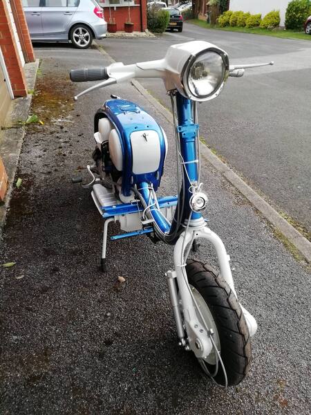

Cables now done up and sorted, wiring wired, and lights lit.
Should get it running next week, then it's bodywork + trim time. :)

I decided to go with a standard 22mm carburettor in the end, I can always fit the 30mn one if I get bored of it.
Got it running earlier. I need to adjust the carburettor once the motor has  fully warmed through, but after 10 minutes or so of running, it seemed to be pretty happy.
A short ride up and down the street revealed that the headstock bearings had settled, and needed nipping up a touch. This was done, then the handlebar top finally went back on.
IMG_20200321_165659.thumb.jpg.956cfc67da648d1fd64545583ac09210.jpgIMG_20200321_165900.thumb.jpg.704bd045e1bee552ff82e8a56d033cae.jpg
Should be getting the bodywork back on tomorrow, complicated by the painter having filled in two of the holes for the floor runners. Not sure if they've been welded up or just filled, but either way I'm gonna be drilling into fresh paint. :(

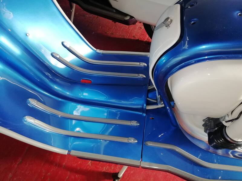

Horn casting and mudguard now in position - just need to spend a bit more time getting the rubber gaskets sitting nicely before tightening everything down.
More faffing about coming soon.  :)
  • Like 6
Didn't get much time on this in the evenings, but did get the beading clamps on.
Horn case badge now also in position.
Should get the floor runners finished up over the weekend.  :)
Floor related stuff now completed.
Just lower beading clamps, bridge piece, brake pedal and legshield badge to go on (and side panels! ) and I'm waiting for the seat to be re-covered, then it's back to the mk2 Cav. :)
Few more bits went on today.
Not a whole lot left to do now. Before it's maiden voyage I'll be smearing a little araldite on the exposed threads of the bodywork fasteners. This prevents stuff from being jettisoned due to vibration. When you need to undo the fasteners at some point, the glue just flakes away. :)

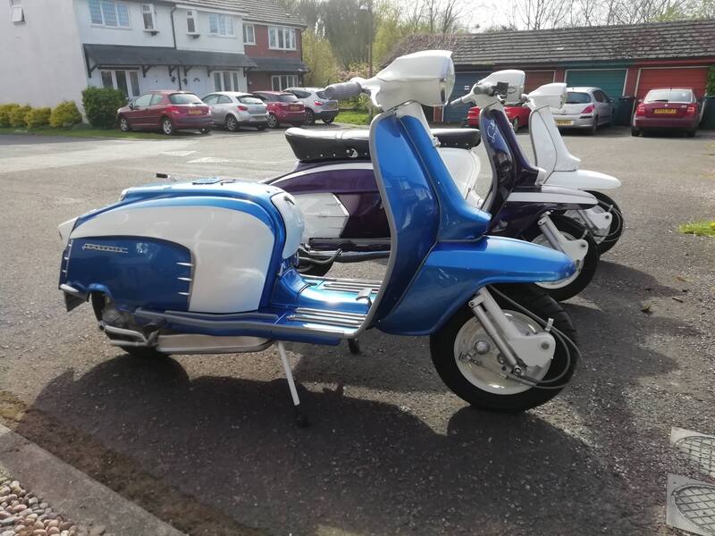

Panels now fit better, hopefully they'll stay on too.
Lined up with its brethren still lacking a seat.
Itching to get out to the shops on it ASAP.  :)
They're so nice I'd hardly noticed the Vespas behind them.
