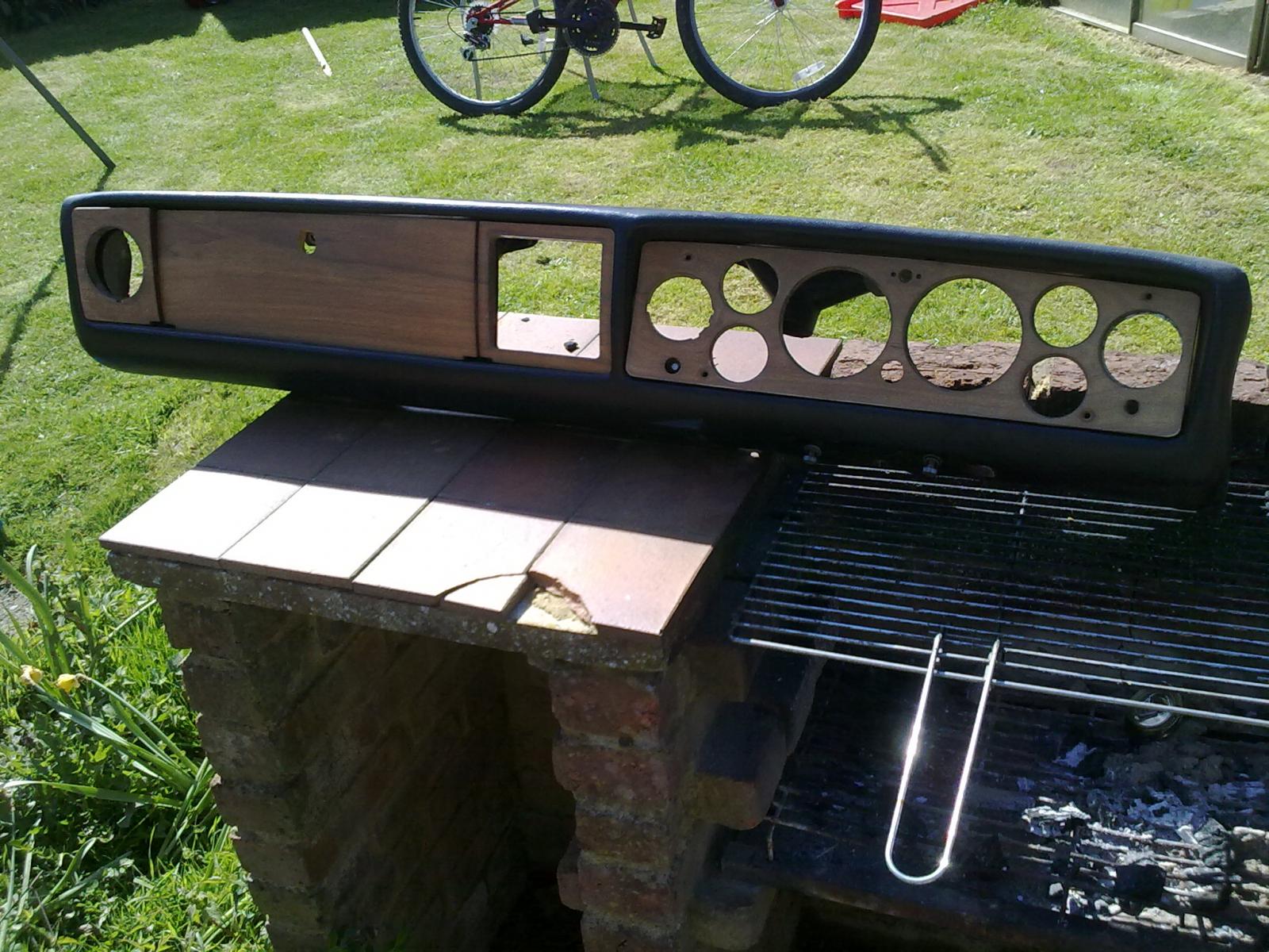

First up is the dash
removal from the car is pretty easy, all the instruments are connected to the loom by a single multiconnector, plus of course the mechanical oil gauge feed and the speedo cable
I ended up removing the whole dash from the car though for shits and giggles
heat gun used very gently indeed removed the worst of the old varnish, as you can see the veneer is intact. super gentle sanding with fine paper got it back to this
was so happy that i assembled it all back into the dash
rustins 2 pack was used to recoat the dash, less likely to crack or fade in the sun. needs about 20 coats with flatting back every 6 house or so, this took a week
all the dash pieces had matching date stamps on the back and grain patterns on the front. The only mismatched piece is the gearstick surround
gauges were cleaned up before reinstalling, at this age of stag the bezel should be matt black, I cleaned that back to the chrome finish. but they dazzle in the sun so maybe they will be matt black again soon
dash surround goes back in first so I have access to all the mounting bolts
steering wheel was off to save scratches and swearing
chuffed

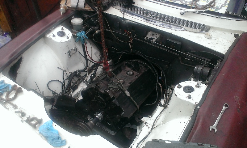

not planning to go any further than the head gaskets I set it at Top Dead Centre which oddly is done on Cylinder #2 Front nearside, same as TR7/ 1850 etc on which It would be #1 if you get my drift
inlet manifold gave up its grip, the water pump is in the v at the front of the engine, yep inlet manifold has to be removed to access it
Anyone who has worked on a triumph slant 4 will know this "bastard thing!!!" broken stud scene
At this point things get serious, looks brutal, and it is! But the heads do move very easily as they bend the studs, the idea is to jack it up until the exhaust manifold is about to touch the chassis rail then cut through the stud, freeing the head and leaving enough stud to get an extracter onto
4 broken studs and unusually one broken bolt - they never break I am told!
No amount of heat nor any other trick would move the stub of the broken bolt.
nor this stud, the other three wound straight out on the extractor

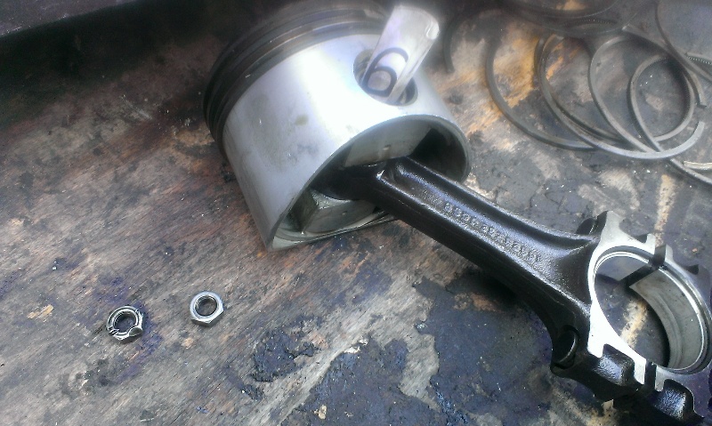

Sump off and bearing removal gave me a nasty surprise, some of the journals were like the surface of a 78rpm record
Stag Cranks are part of the reason the engine has such a shit reputation
firstly the engine capacity was increase from 2.5 litres to 3 litres late in development and without re engineering the bottom end, thus the big end journals (that the conrods and pistons run from) are very narrow indeed, each bigend journal runs two pistons on opposing banks. The main bearings (that secure the crank to the engine block), all five of them are also on the small size for a 3 litre engine. thus engine rebuilds at 100k miles became the norm. Not bad when you consider that ford kent etc would struggle to get to 80k between major rebuilds. In fact it was not unusual to change the bearings every 20-30k on the 1340cc in the Consul Classic.
Then on top of the underspec issue the cost accountants at BL decided to only harden the nice soft steel crank to 20thou . Not an issue in the early 1970s when you could still get the original very soft bearing shells. But as the 70s moved forwards cost accountants bit again and those nice soft shells were too expensive so hard shells used be all other manufacturers became the norm. but of course the crank was still only hardened to 20 thou.
Even NOW engineering shops insist that a stag crank does NOT need to be hardened when ground beyond 10thou (and most by now will), and with owners doing a couple of thousand miles a year it can be 5 years before the bearings wear the crank out and oil pressure drops. by which time ownership has changed and the new owner moans about how shit the stag v8 is.
BUT and this is the big but, my crank was bought as hardened and running 10 thou bearings, even by factory standards it should be able to support 10thou grind and standard shells. As you can possibly see some journals are fine for 30k miles and other are utterly fucked. BL 1970s quality control setting the standard again  :?

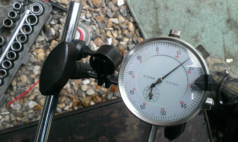

Late July 2013 and the block is back and in rude health.
nicely honed cylinders double checked with standard sized piston ring and well within tolerance
checking endfloat of crank with it just installed on main bearings and standard thrust washers.
perfect

Fount these two nuts, one mangled, right up inside the crown of this piston. the mangled one was properly wedged in, no idea where they came from, must have dropped down into the sump at some point but I havent got a scooby
Piston #1 showing signed of HGF also so I guess a good job I chose to do both gaskets originally. even if this minor job turned out to be a lot bigger
valves kissing pistons, I am pretty sure I know exactly when this happened, most of them were like this oops
scuff on the side of the piston below the oil control ring are very light and no cause for concern

next I battled for a day trying to get the engine installed back onto the gearbox splines. the sump is a very tight fit behind the front cross member so after several hours I dropped the gearbox out and assembled on the floor.
David #2 son also fed up by this point, though mainly with me being grumpy
gearbox out took 30 mins
assembling it to the block took a couple of hours
entry angle for engine and box, you can see the issue
I get around it by lobbing a rope over the top of my ancient a frame hoist, I lift the gearbox up level and yes it is very heavy. then two mates take up the slack on the rope to hold the box level. mindful of course that they dont pull the whole frame towards them!!
Once the gearbox tail is over the front panel, the ropes around the gearbox tail end can be removed and the whole thing just drops back and in. total time to get the engine and gearbox in from the point of mates on the rope = 30 mins. not the sort of job that you want to be taking your sweet time over.
I had David #2 son on the steering wheel, while I pulled the car under the frame and 2 mates taking the slack on the gearbox to keep the whole shebang horizontal
by the way the chassis rails in the engine bay are too narrow to allow the engine and box to be installed from underneath. makes engine removal an utter cunt, I have mastered some of the tips and tricks though. I recently helped a mate get his 2500 straight six out of his stag and get the v8 back in. the straight six was a mother to get out, made the v8 install seem like a walk in the park..

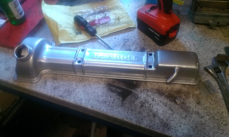

I bought a new o/s cam cover on ebay for a tenner, looks nice huh? power coated an all
err even on the inside and all that black grit on the bench came out of the breather filter. it was bead blast material!! No fucking way is that going near my engine, I salvaged the HT lead clips off it and then flattened it with a 10lb hammer. - to get that powder coat off the inside would need an acid tank, then I would need to drill out the welds on the gauze cover and throw away before finding new gauze and welding it back into place then repaint. Put it all down to experience
original cam covers painted and reinstalled
