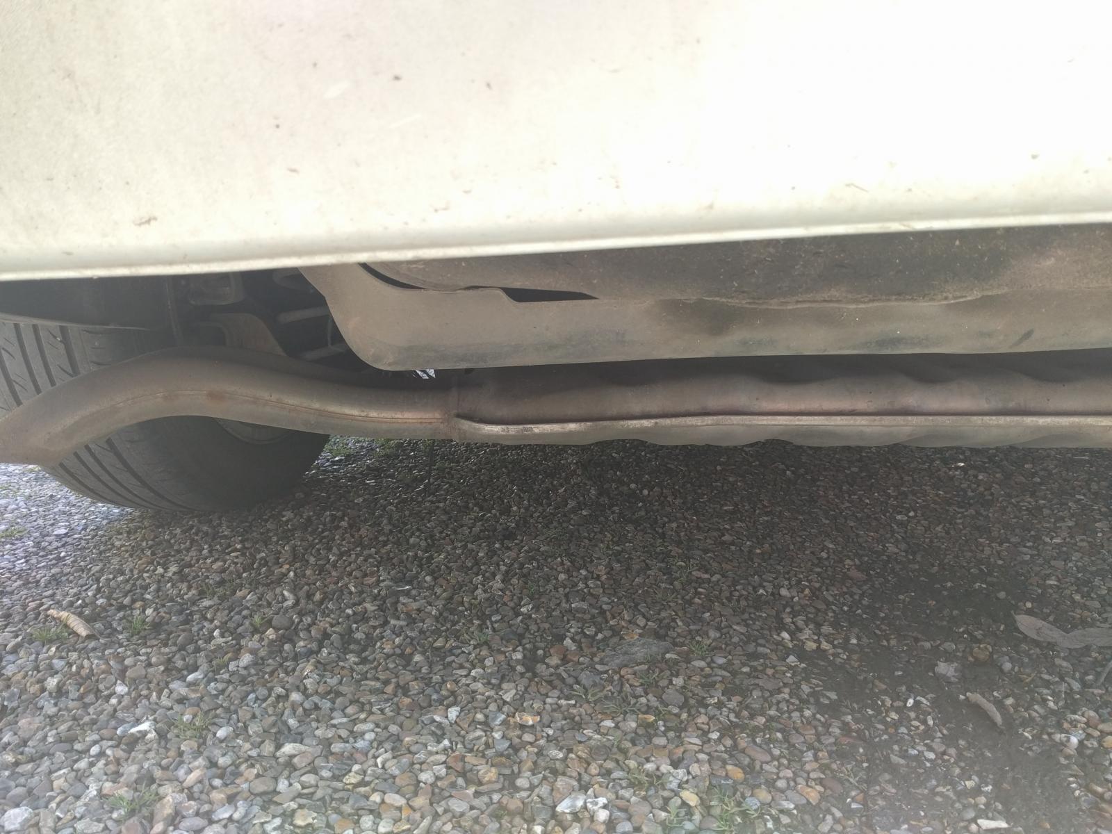

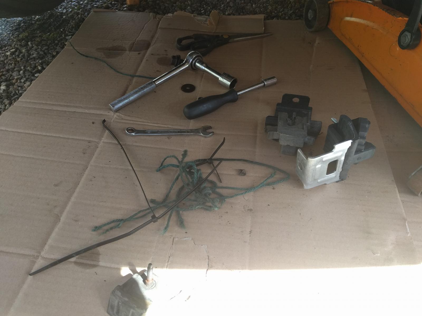

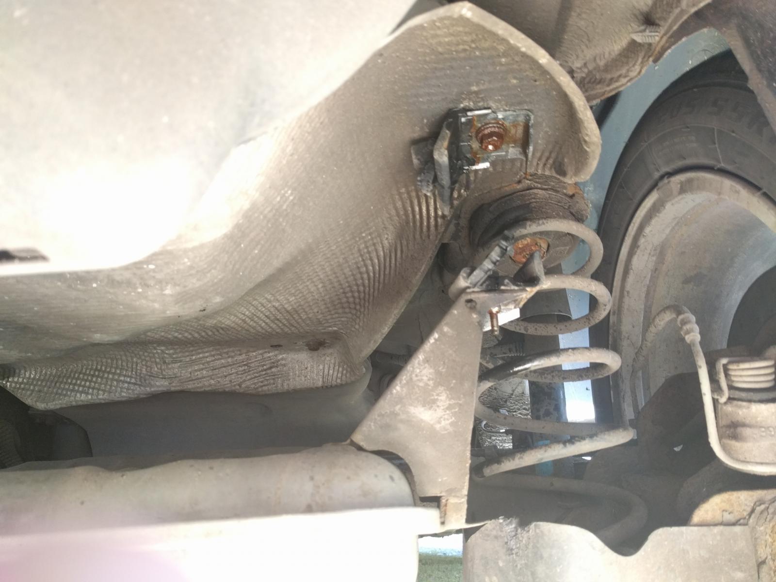

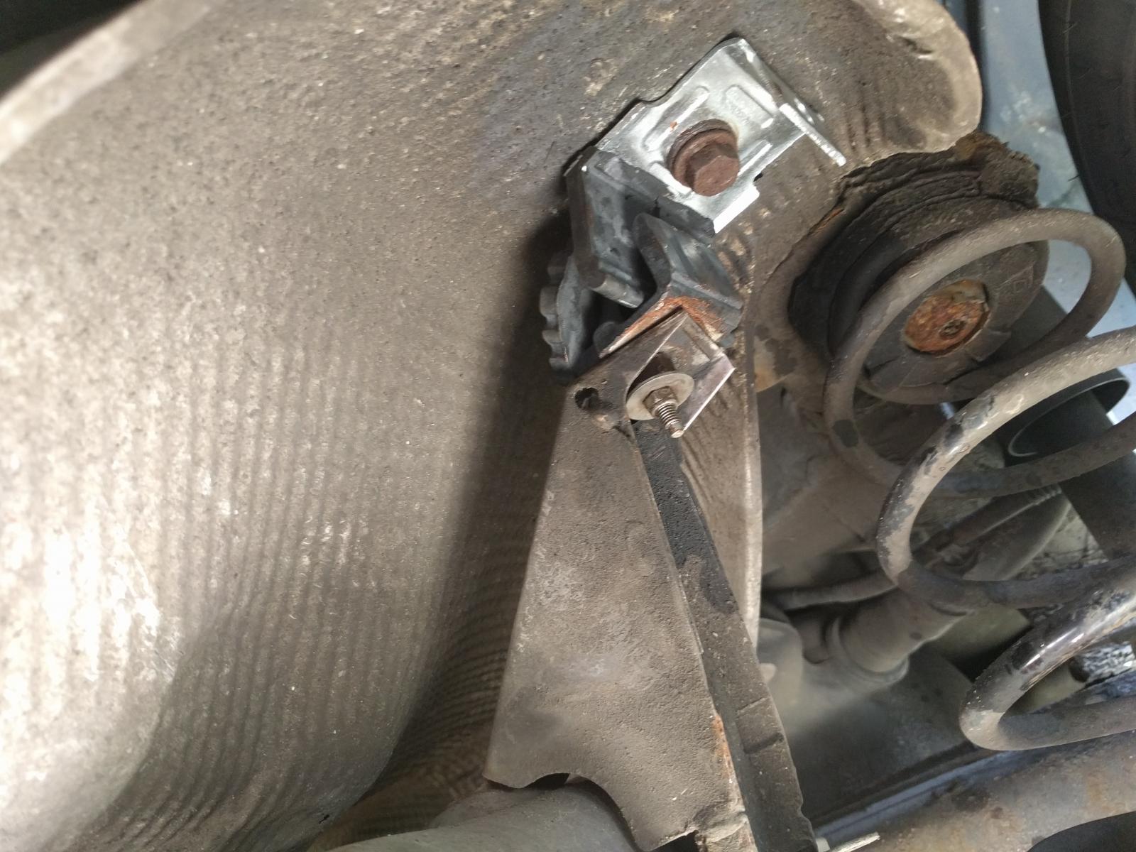

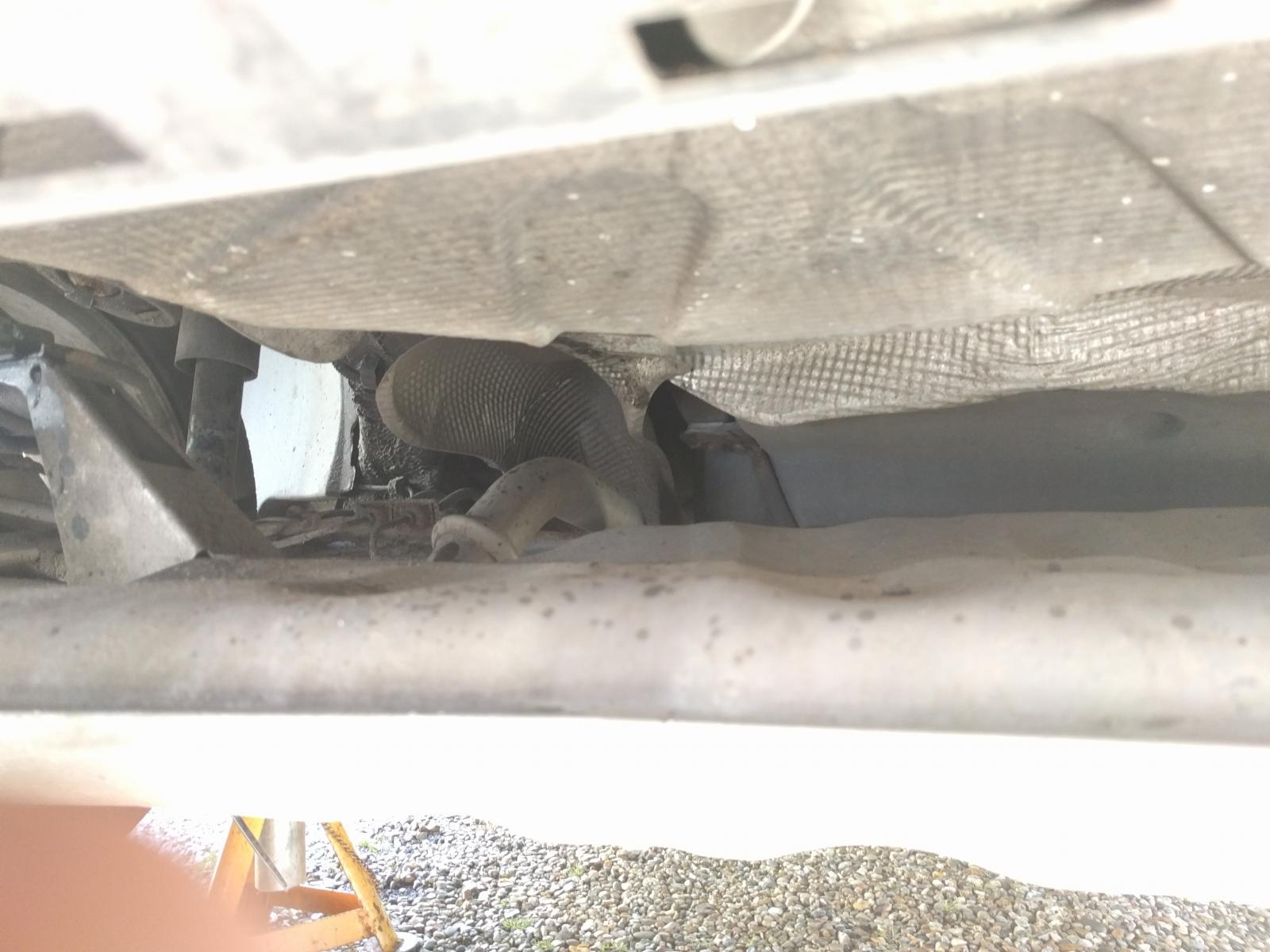

beko1987 Posted April 5, 2018 Author Posted April 5, 2018 So it turns out my genuine renault exhaust is in tip top order, having the whole rear of the system held up by the centre pipe and backbox join was a good test... Luckily all my tools are at mums in readiness for Gareths bloody exhaust turning up one day, so I popped over in the sunshine That's a bit lower than it should be. Got the back up on stands to give me a bit more room, put some cardboard under so I didn't get my work clothes too dirty and slid under Was a simple job really... Everything undid, so one side off Other side off The mounts bolted onto the backbox, then I jacked it up in the middle and it lifted perfectly into place. Lick of copper grease on the bolts and the job is done! Initial impressions are it no longer knocks when I turn the car on, so that's positive! Will see if any other noises have gone on the drive home HillmanImp, Dick Cheeseburger, mrbenn and 1 other 4
